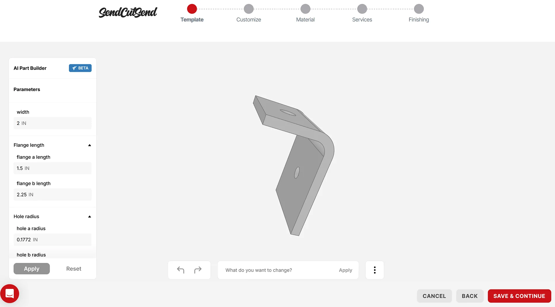

i am going to try fitting the westscott designs exterior molle panel to my TH. i used gemini / nano banana to spec out some custom L brackets and uploaded the design to sendcutsend.com. i made the L brackets in textured black .187" 50502 H32 aluminum. they should fit the standard ARB t-adapter. if it works out i'll go ahead and do the driver's side as well. look for a followup in a few weeks.

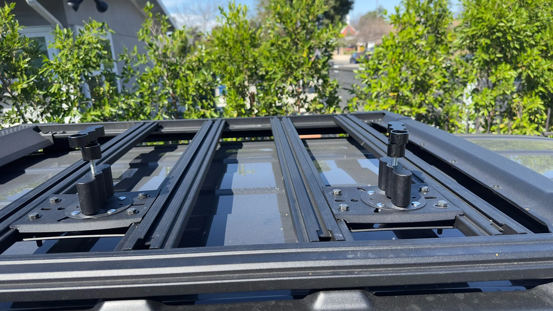

Ok I went on the ARB site. This is exactly what I got :
https://store.arbusa.com/base-rack-wide-bridge-plate-1780430/

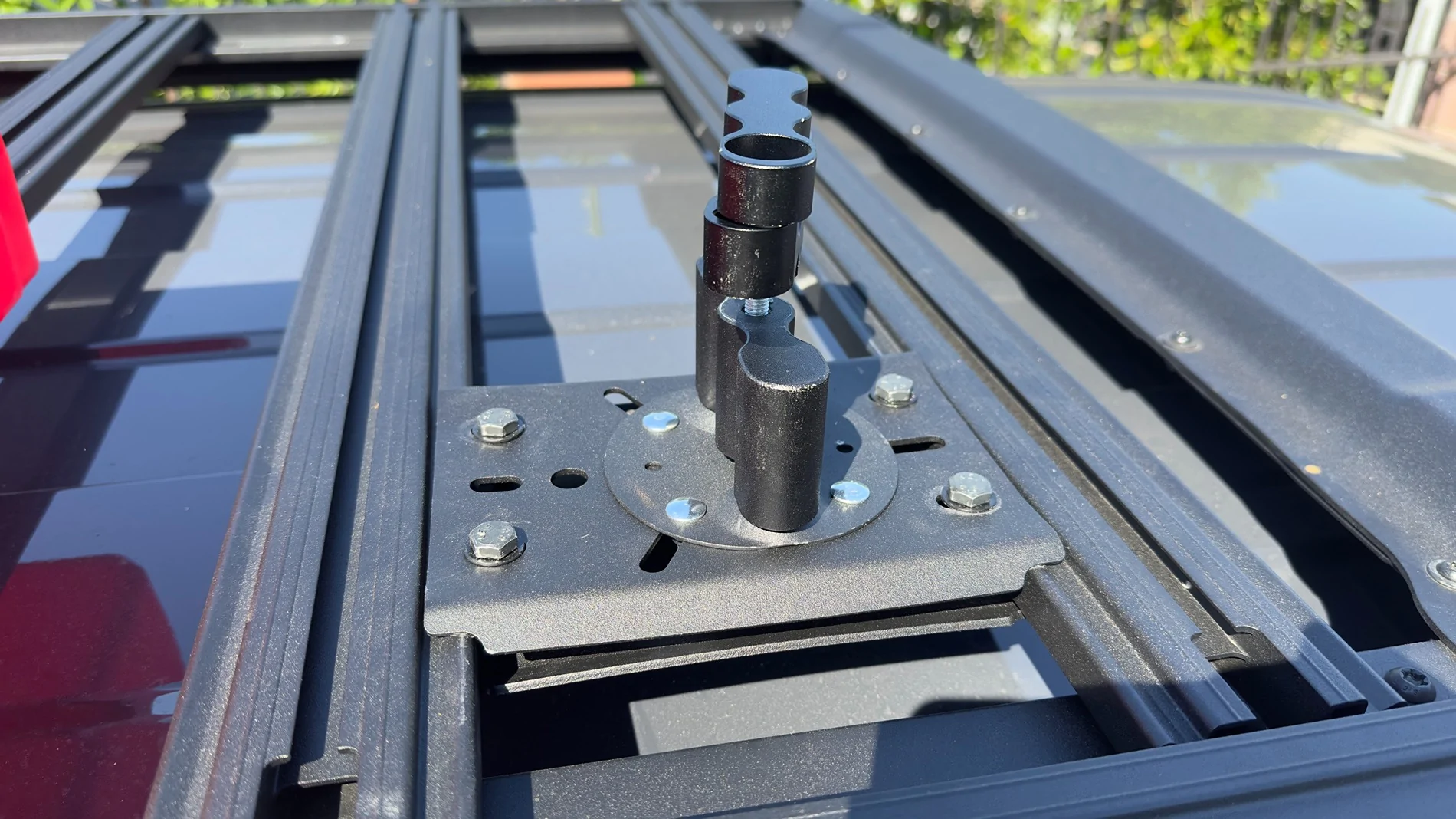

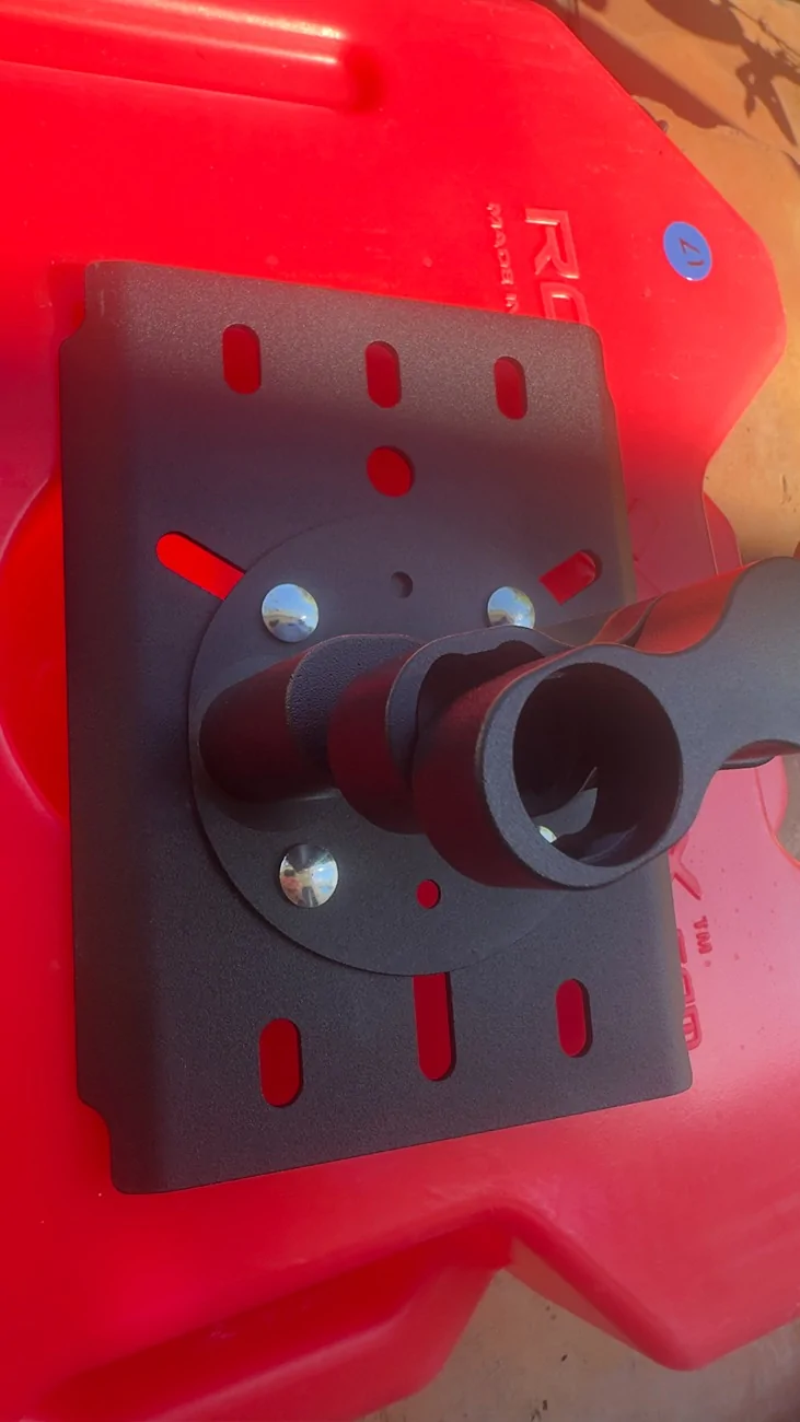

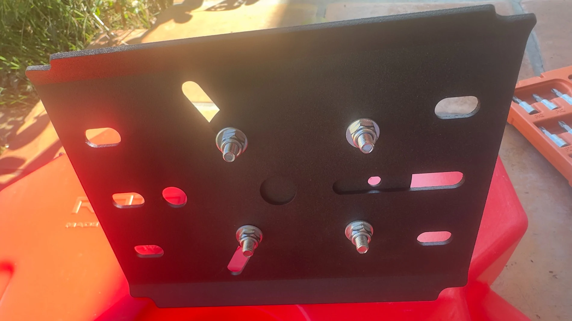

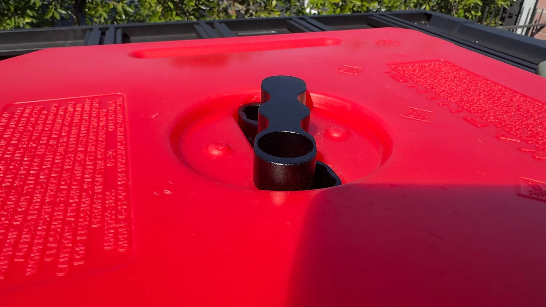

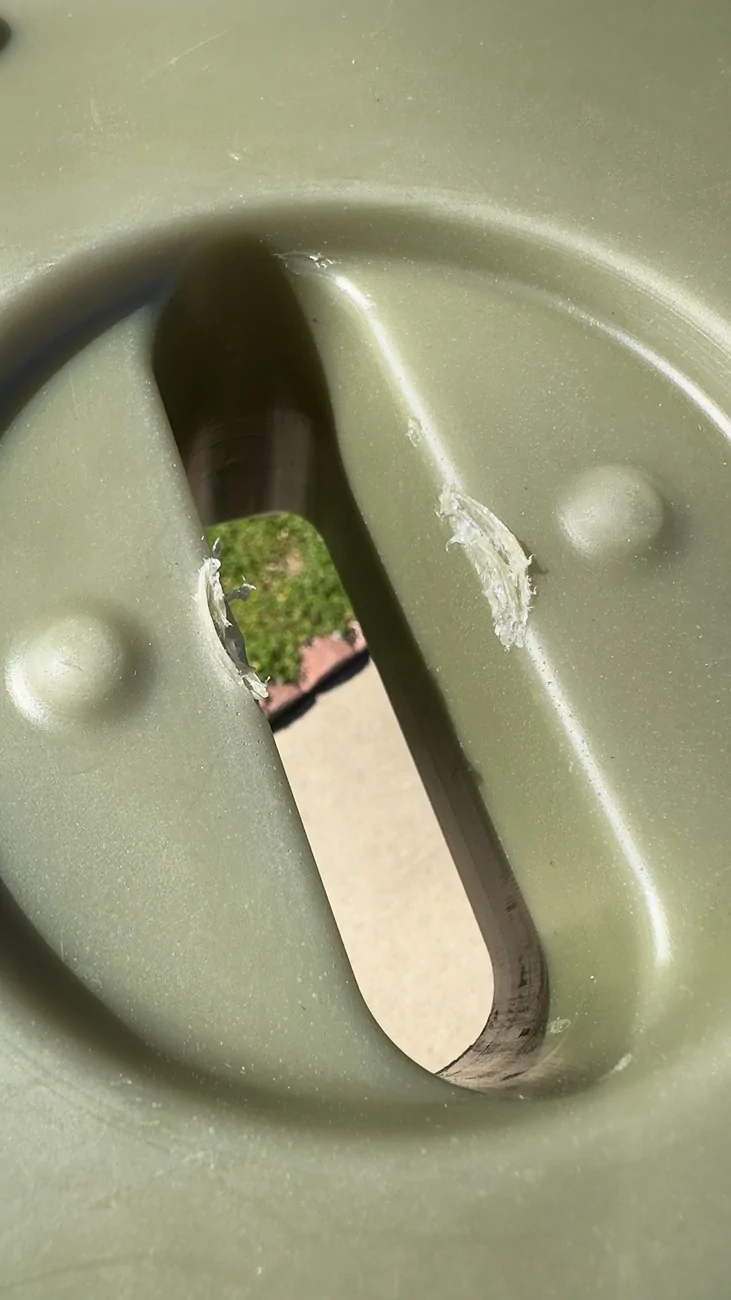

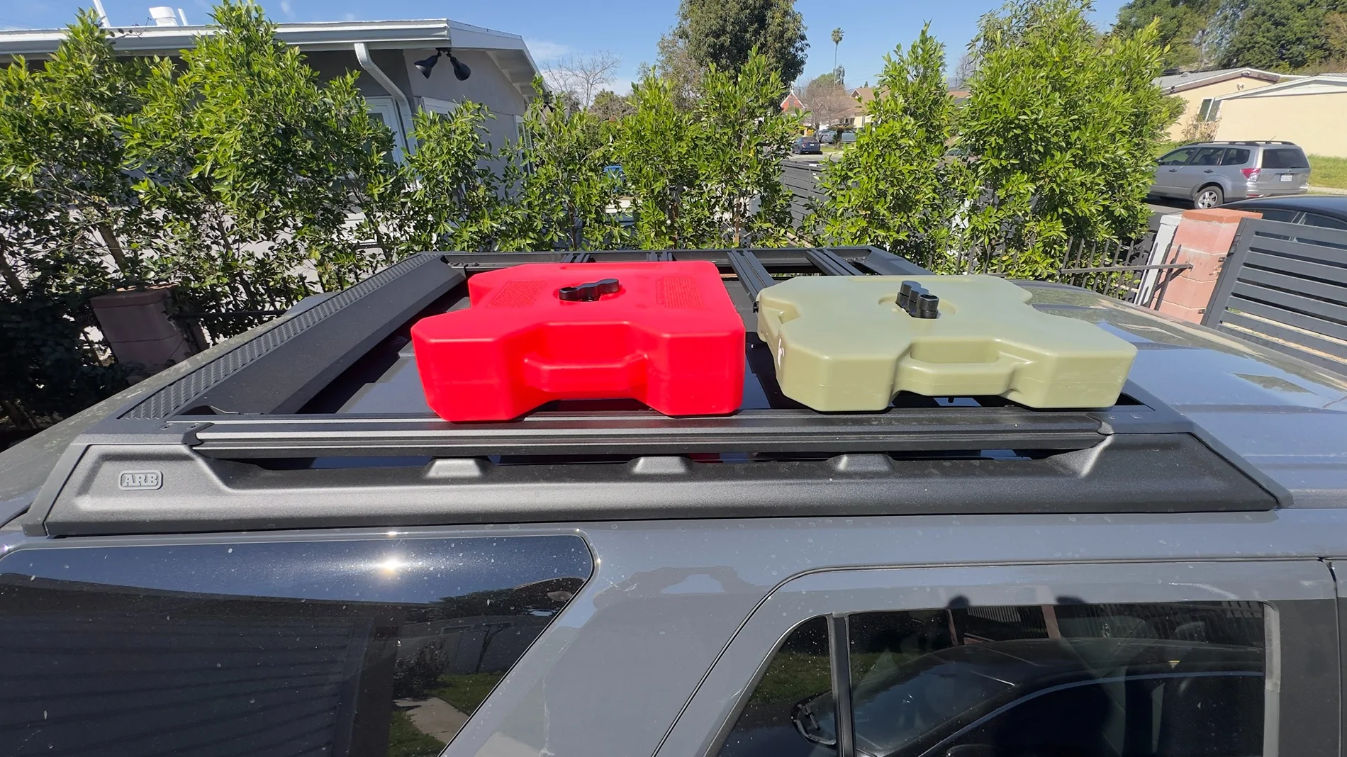

So here are these, done, but i find that the gas pack locs are short (photo red can, just placed not tightened) for 3 gal rotopax, the base height is 2 inches i think it needs to be longer, (just ordered one link below) This one is good with 2 gallon Rotopax.
Although the base that is square is messing up the gas can see the photo of green can. (correction here, happens to be i didn't know how to close and lock the mount, i learned it by messing up my canister).

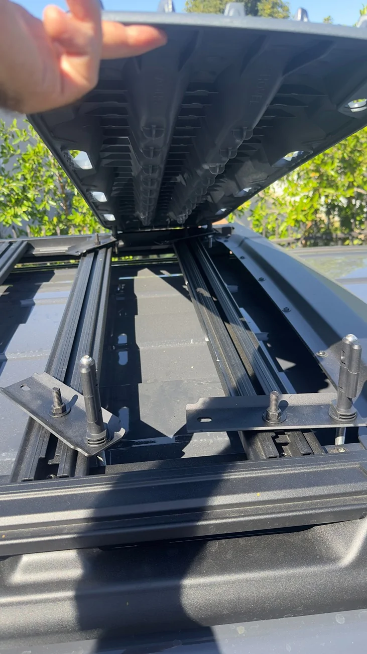

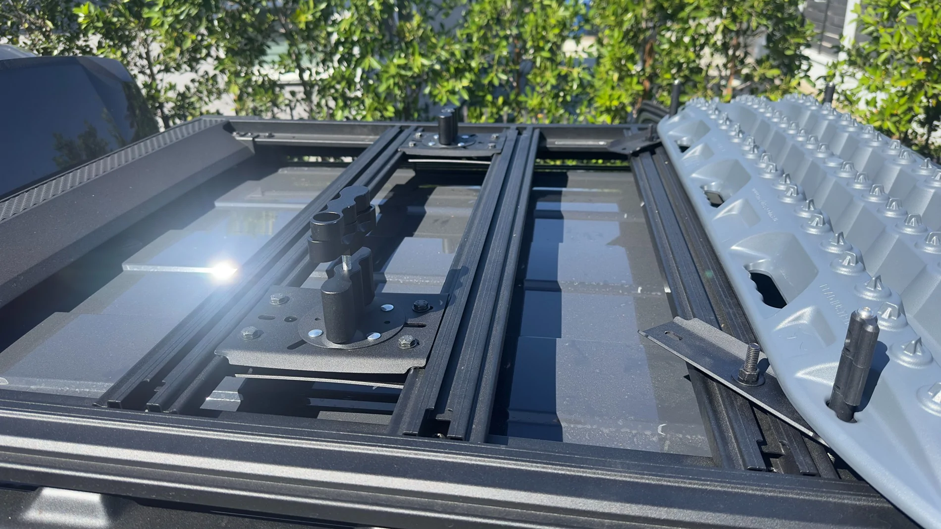

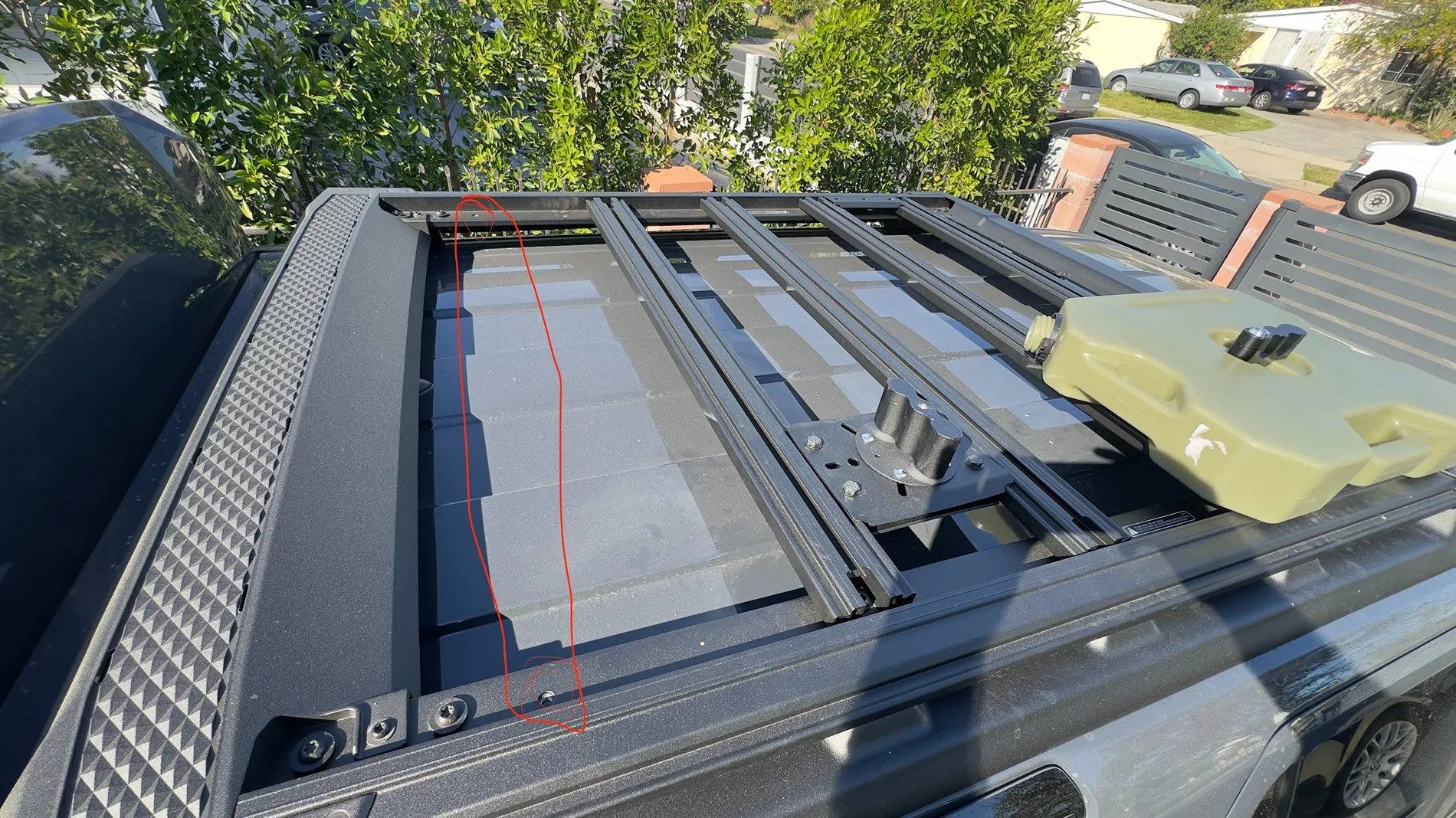

For the Maxtrax the rack and mounting it on ARB 3/4 rack 2026 4Runner Trailhunter. I NEED HELP.
My rack currently has four T-slot / T-track channels installed (image attached for reference). However, I can see a fifth position on the rack where an additional slot appears it could be installed. When mounting my Maxtrax using the Narrow Bridge Plates, I am coming up short and an additional slot would solve the mounting spacing issue. (see attached image)
2025 2026 4runner 6th gen Exterior MOLLE Panels compatible with stock Trailhunter Roof Rack IMG_4236
Could you please confirm:
Is the rack supposed to come with only four T-slots from Toyota, even though there appears to be space for five?
Also I bought this Mounting Pins for recovery boards (https://amzn.to/4se6oEf) but the bolt is thicker than the holes of BASE Rack Narrow Bridge Plate 1780420.
Any alternatives or solutions?

1) mount locks with keys, good for 2 gal short for 3 gal rotopax (amazon: https://amzn.to/4l6Lc0L)
1.1) I just bought this extension I will let you know if it works. (https://amzn.to/4723eeI)
2) 1 Ă— BASE Rack Narrow Bridge Plate 1780420 (for Maxtrax) but half a pack is missing :((( https://store.arbusa.com/base-rack-narrow-bridge-plate-1780420/
Uninstalled, still waiting for resolution from ARB.
3) 2 Ă— BASE Rack Wide Bridge Plate 1780430 (for Gas and Water cannesters) https://store.arbusa.com/base-rack-wide-bridge-plate-1780430/
wide plates worked great,
4) Rotopax 3 Gallon Gasoline https://www.rei.com/product/246379/rotopax-3-gallon-gasoline
5) Rotopax 2 Gallon Water Gen 2 https://www.rei.com/product/246378/rotopax-2-gallon-water-gen-2 (looks like they are out of green ones)

Update:

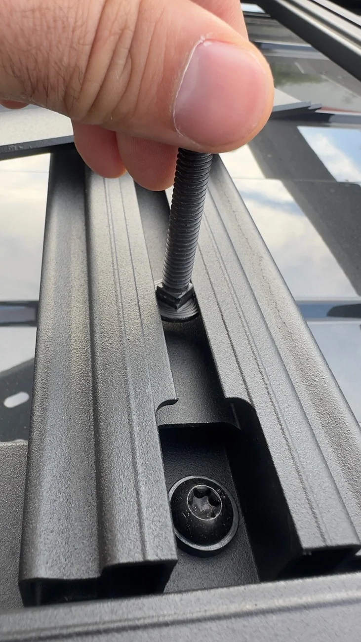

The BASE Rack Narrow Bridge Plate 1780420 did not fit my Maxtrax (model: https://amzn.to/4aKWRik). The spacing comes up short. Even after I enlarged the holes in the plates, the total length is still slightly off. If I mount from the outer ends, it ends up too long.
The bolts shown in the photo are one size too small. I did get the correct size from Home Depot and enlarged the plate holes accordingly, but it still doesn’t solve the fitment issue.
Looks like I’ll need a different solution for mounting the boards on the roof. I’ll take a fresh look at it in the morning.

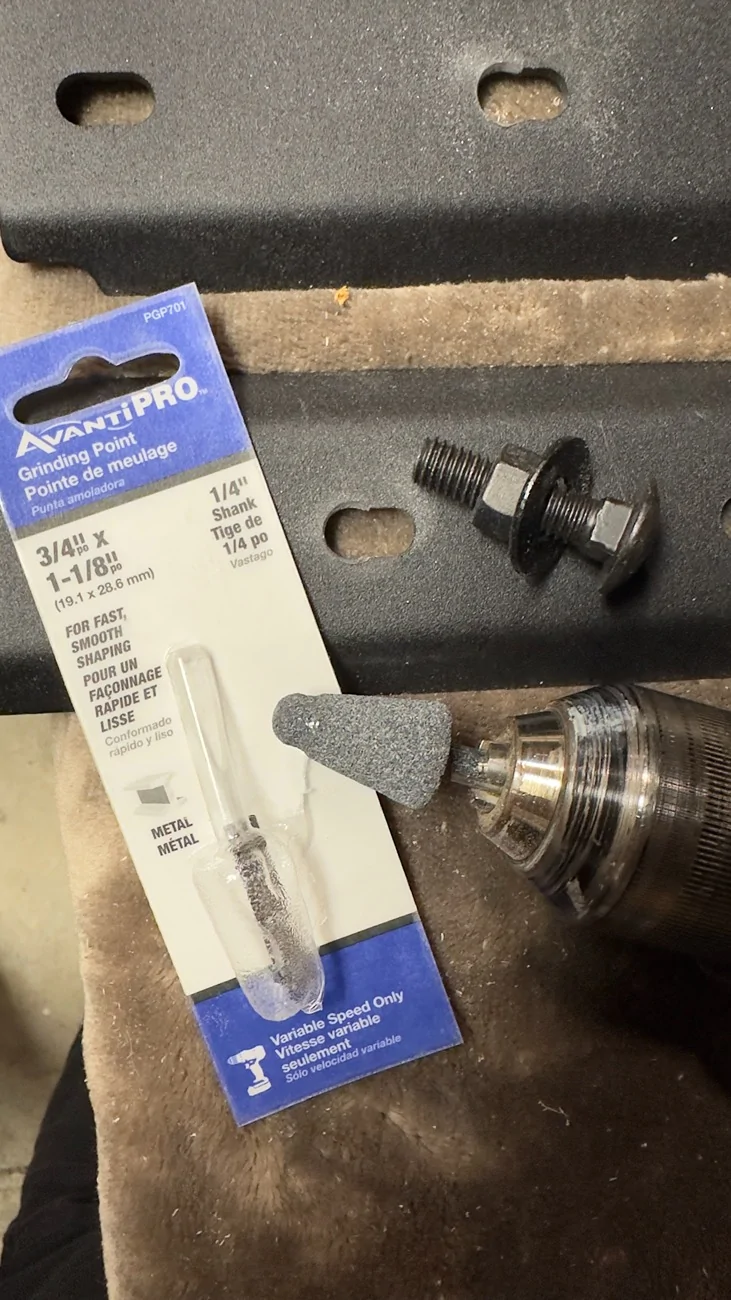

Final Update – All Set

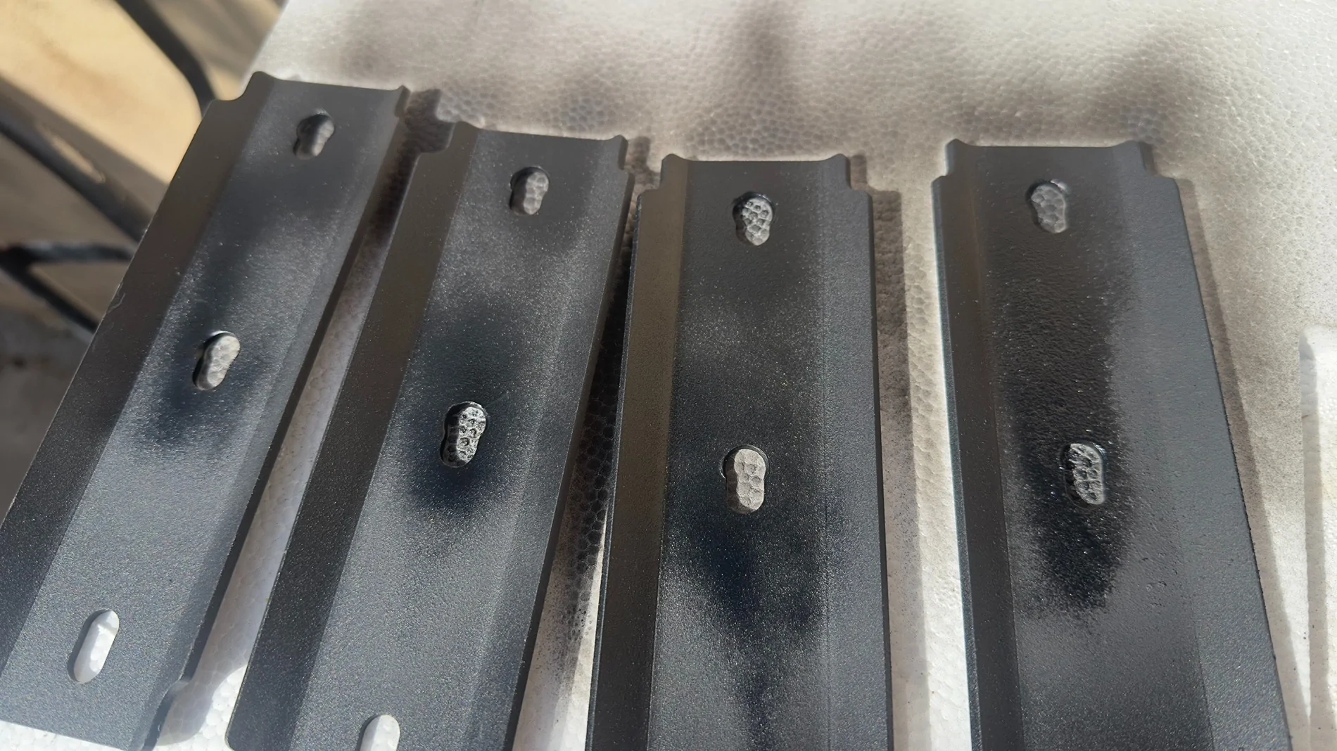

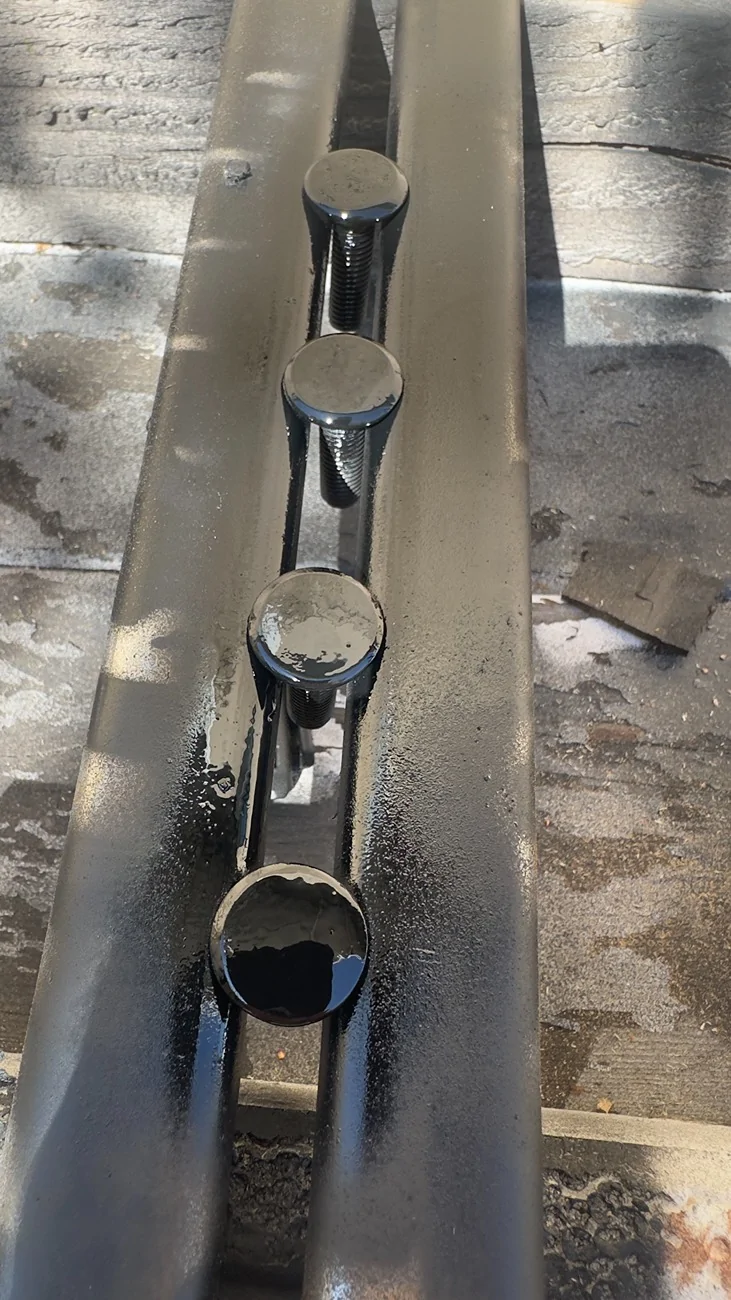

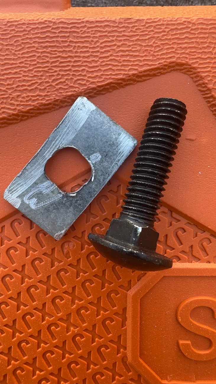

The bolts I bought from Home Depot had rounded / domed heads, so they wouldn’t seat properly inside the dovetail slots. I ground and flattened the bolt heads so they could slide into the slats and sit flush with custom washers.
2025 2026 4runner 6th gen Exterior MOLLE Panels compatible with stock Trailhunter Roof Rack IMG_4253
I fabricated rectangular washers from square stainless steel stock, shaped and filed them to fit the slots correctly, and matched them to the modified bolts (see photos).
2025 2026 4runner 6th gen Exterior MOLLE Panels compatible with stock Trailhunter Roof Rack IMG_4254
2025 2026 4runner 6th gen Exterior MOLLE Panels compatible with stock Trailhunter Roof Rack IMG_4255
After confirming proper fitment, I degreased all the hardware and painted everything black.
2025 2026 4runner 6th gen Exterior MOLLE Panels compatible with stock Trailhunter Roof Rack IMG_4256
2025 2026 4runner 6th gen Exterior MOLLE Panels compatible with stock Trailhunter Roof Rack IMG_4257

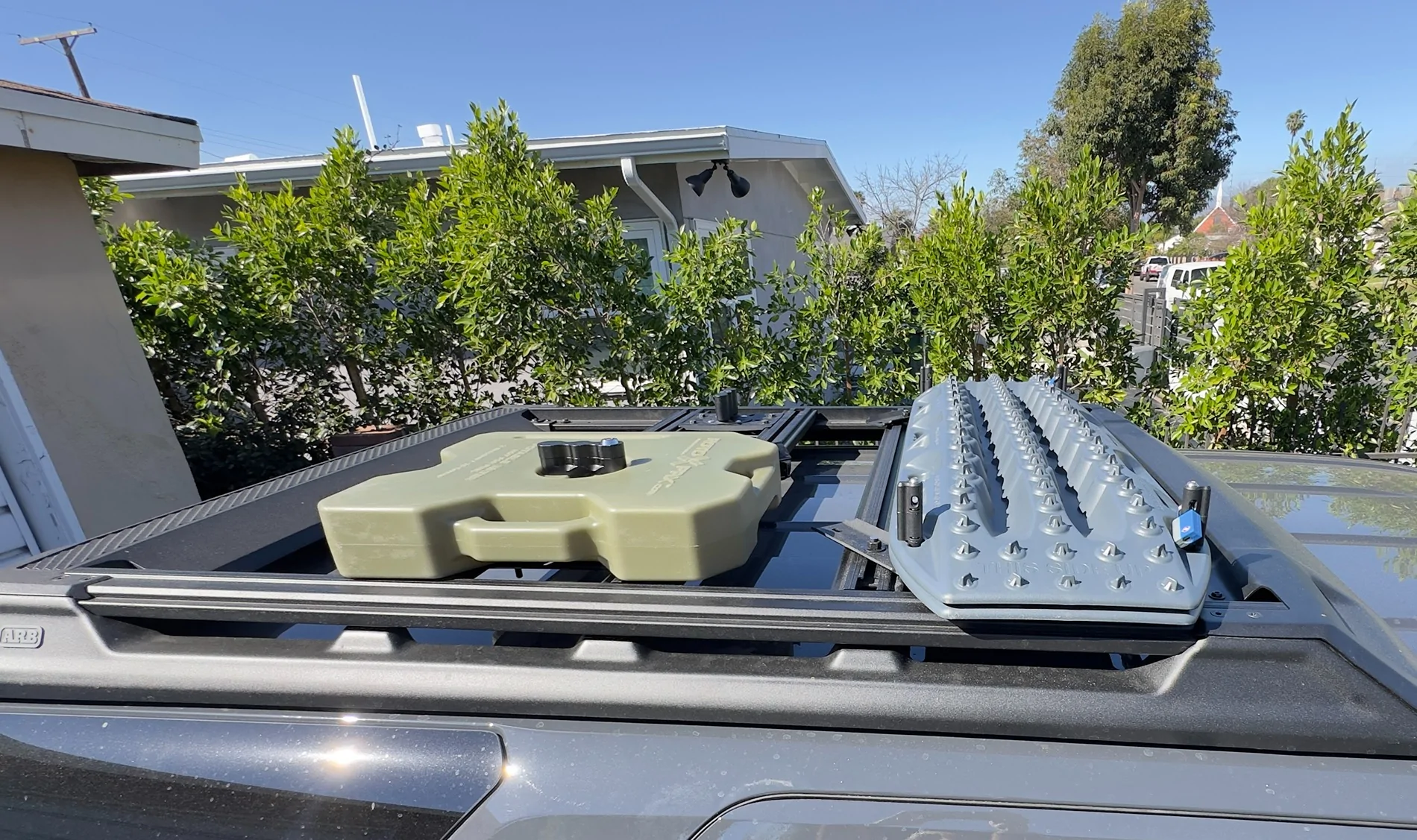

To make room for the Maxtrax boards at the front of the rack, I moved one gas can to the opposite side. After adjusting the mounting angles and tightening everything down, everything aligned properly. I also trimmed the bolts so they wouldn’t contact the recovery boards.
2025 2026 4runner 6th gen Exterior MOLLE Panels compatible with stock Trailhunter Roof Rack IMG_4260
2025 2026 4runner 6th gen Exterior MOLLE Panels compatible with stock Trailhunter Roof Rack IMG_4261
Result: Fully mounted, secure, and functional.
2025 2026 4runner 6th gen Exterior MOLLE Panels compatible with stock Trailhunter Roof Rack IMG_4267
2025 2026 4runner 6th gen Exterior MOLLE Panels compatible with stock Trailhunter Roof Rack IMG_4266
It takes some grinding and light fabrication, but it’s absolutely doable.
