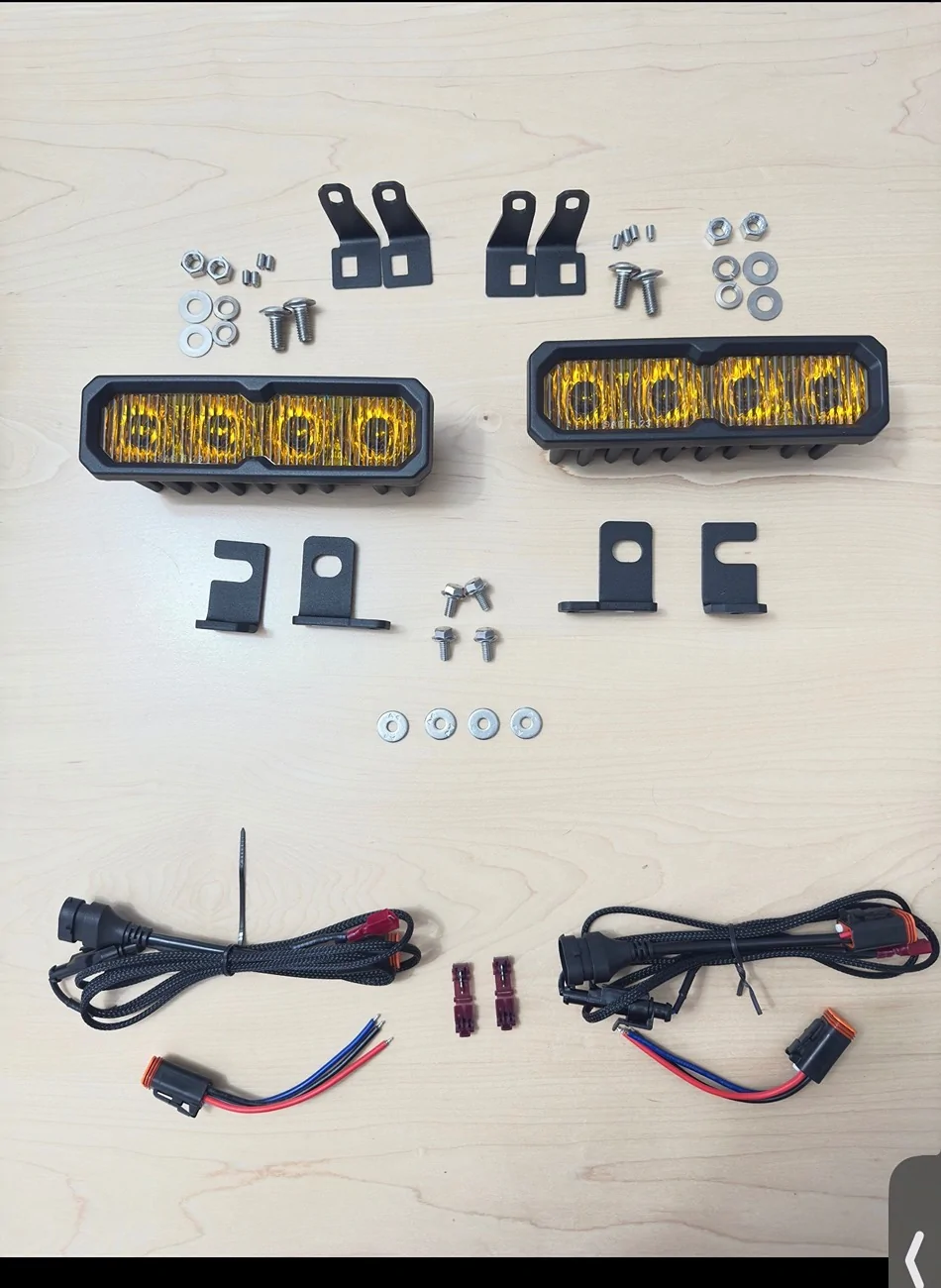

I can't find any updated video/instruction to install the NEWEST DD SS6 Fog lights. I saw ONE video with the newest one, but it showed a piece that wasn't apart of my kit. Has anyone with a 6th gen 4runner have the newest SS6 Fog Lights.
This is what my kit came with but of course double it. But i'm confused on what those two brackets at the bottom of my pic is, and those bolts/washers on the right.
Can someone tell me if they messed up on my kit? I reached out to Diode, but no response yet.

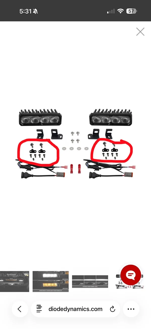

Yea I ended up getting a response from them and they said i’m missing some parts and some of the ones that were included are a universal thing. I took a better picture of everything my kit came with. They too also said I don’t need the lower bracket.

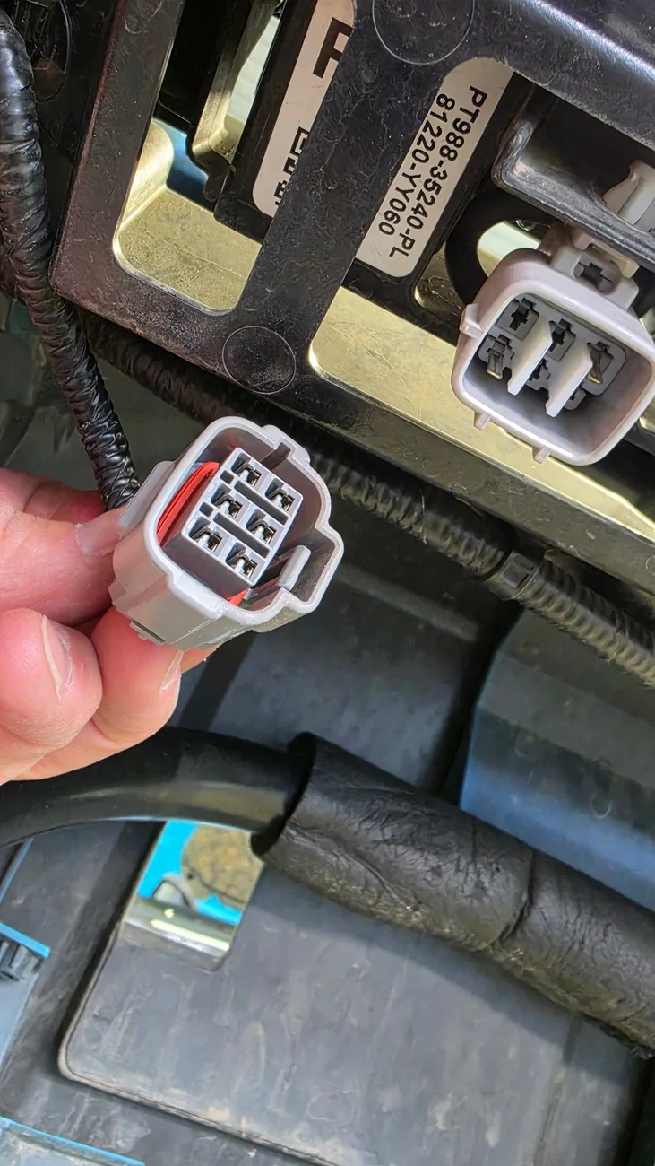

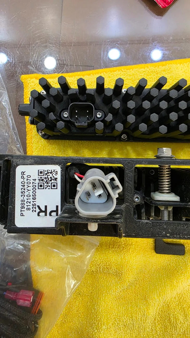

Just a heads up, my rigid fogs did not have H11 connectors. You'll need to cut the factory fog harness and connect some H11 connectors to them. I opted for the D-switch.
What in the world?!!! Is it because we have TRD Pro’s that come with Rigid fog light? I’m not wanting to splice into my factory fog wiring, and also not wanting to buy a D Switch just to run my fogs, that is crazy if that’s the case.

You could probably buy the proper connectors to wire to the DD pigtails. This way you won't have to cut into the factory harness. DD is on the forums, if people keep bringing it up, maybe they'll offer the proper wiring harness.

Okay, ill try and look around on the internet. Hopefully I can find something. Thanks for informing me about the plug, especially before i started removing everything. Wait was your Rigid fog lights the dual color ones or single? I know they say it won’t work with the dual colored fog lights.
