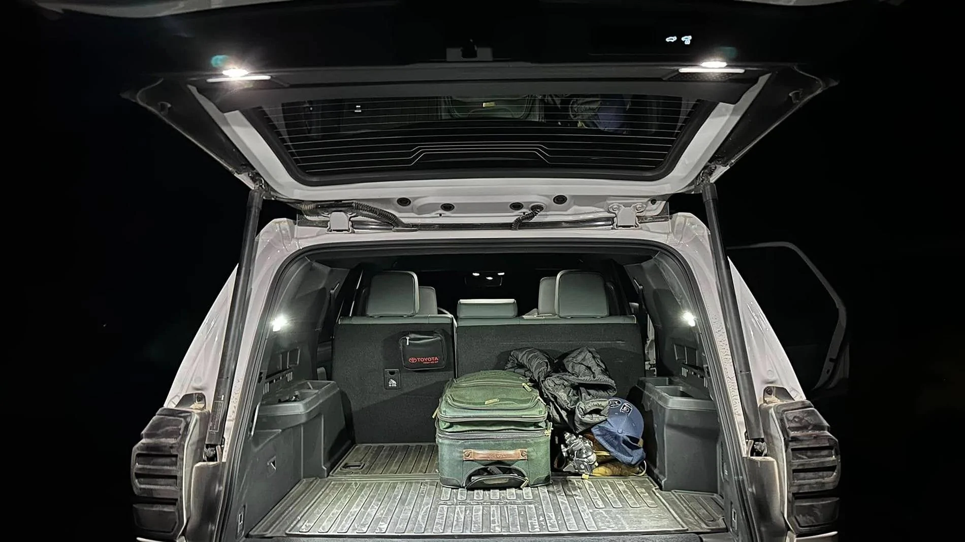

But according to the 2025 4Runner Product Information Sheet ( 2025 toyota 4runner trims comparison - features options exterior chart.pdf ) the "LED Liftgate Light" is standard on Trailhunter and optional on Limited, Platinum and PRO. And there is a photo in this thread: Difference between LED Liftgate Light and Rear Cargo Lamp? However, the THunter standard light appears to b e two lights on either side of the bottom of the hatch (liftgate). The panel for the cartrimhome solution is just "above" the latch in the center.
The question of why not make liftgate lights standard or at least optional on all trims is one that will remain a mystery. And apparently the part number may also remain a mystery - I asked that way back on June 9, 2025 in that thread above but have not found the answer. But I also know that I do not have any sort of openings where that photo shows the THunter liftgate lights:
2025 2026 4runner 6th gen Difference between LED Liftgate Light and Rear Cargo Lamp? 8102-a4597b6c8ea9d65f910e8adcc5ece21
