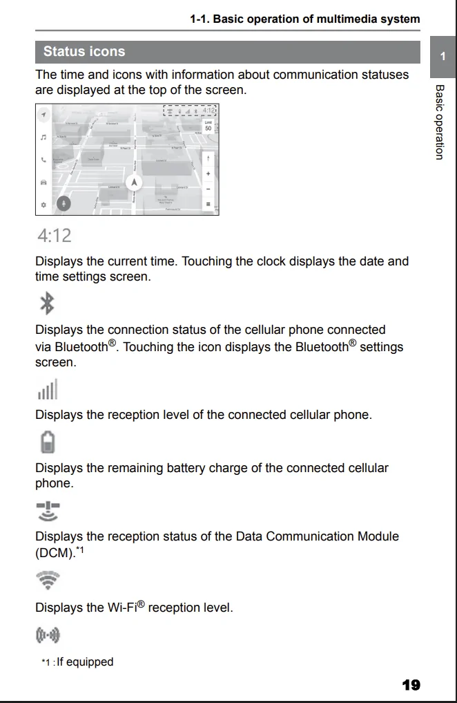

Interesting, not a lot of info on the DCM in either the full manual, or the multimedia one. This does give an overview of the icons though.
