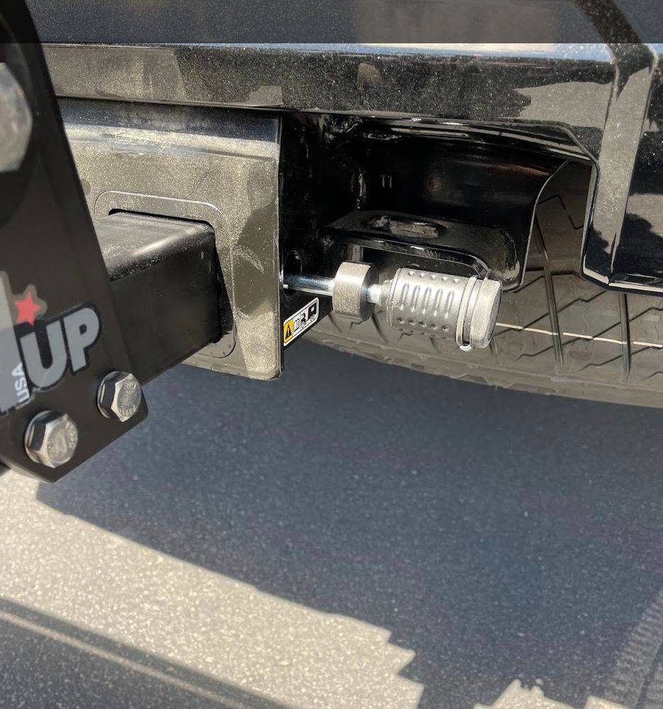

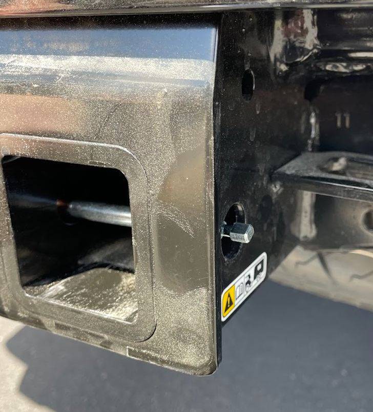

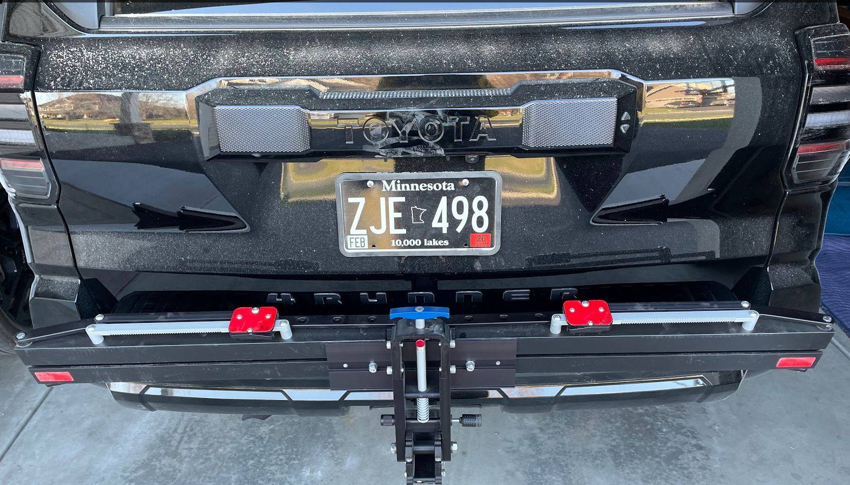

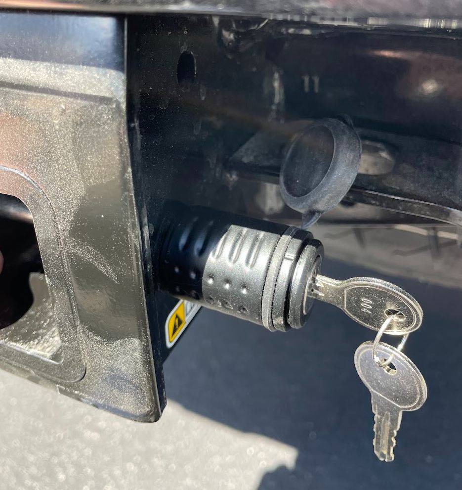

I just installed my 1up Equip'D and the hitch lock appears to be too short to allow the lock to turn. I am having to use the wheel lock I also got for now and reached out to customer service. Anyone else with this issue?

Are you saying the hitch is wider than standard, not allowing the weird and not very secure 1UP locks to work?
Picture 3 seems to look like it works.
I have never liked the 1up lock. Rack is good. Always been tempted to drill through the hitch and 1up for a real lock.

Correct. The lock they sent is probably ~1/2" too short to work. I can get the lock on the rod.. but not far enough to allow the key to actually lock the rod down. That 3rd picture was using the accessory wheel lock I purchased which I am now using as a temporary solution
