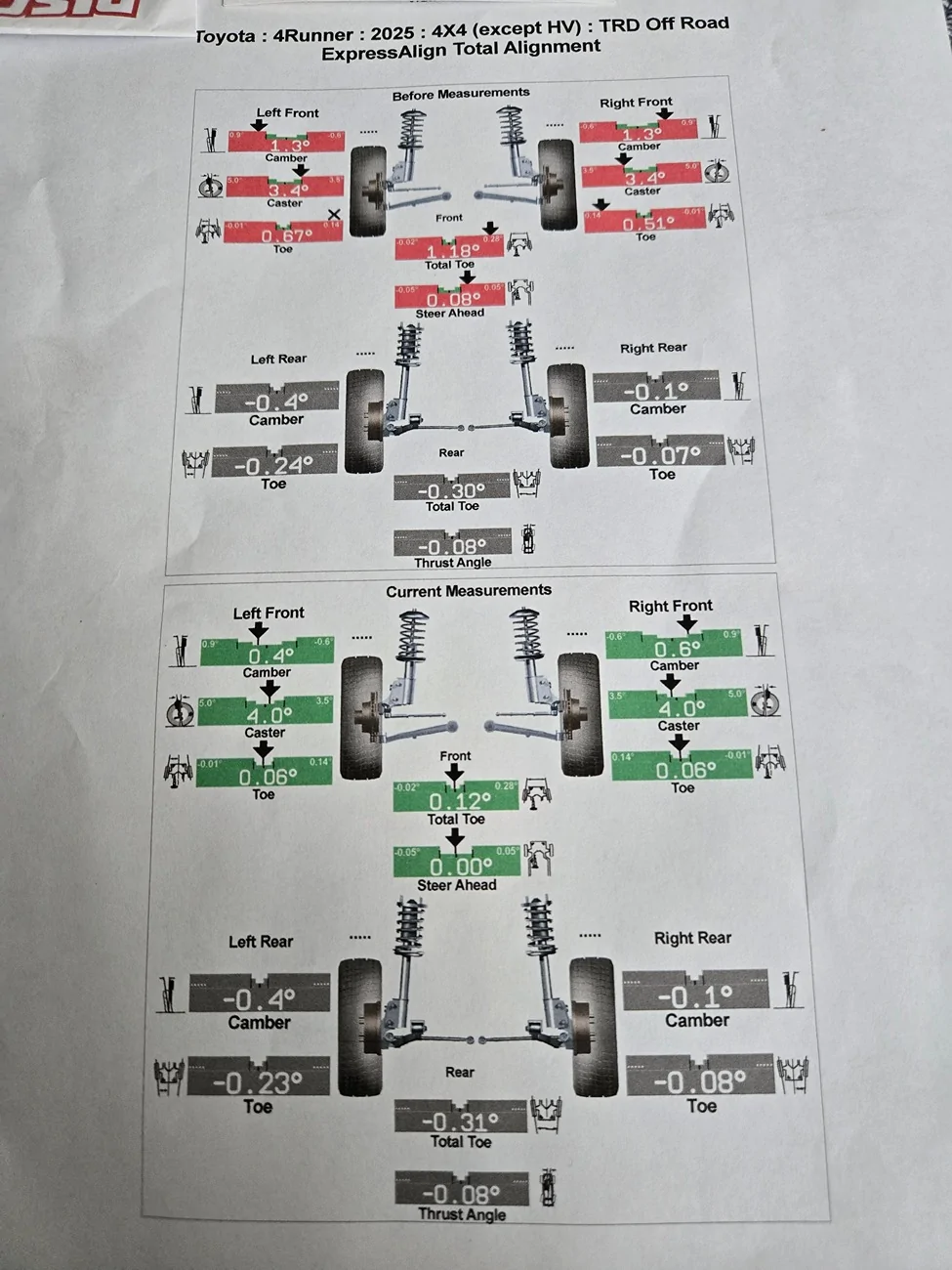

I did the "all dogs Off-Road 2 in coil lift", running factory 18-in wheels with Factory Michelin LTX trail tires.
Alignment shop using top of the line digital alignment machine said that I am at the max of alignment. Any higher will require UCA. I should mention that after sag and coil spring settling in it came to about 1 3/4 in.
A 1.25" lift is considered a mid-travel lift for Toyota's. At that height, the aftermarket UCA requirement would come from additional down travel your strut might provide. If additional down travel is added, your stock UCA doesn't have the range and will be damaged.
