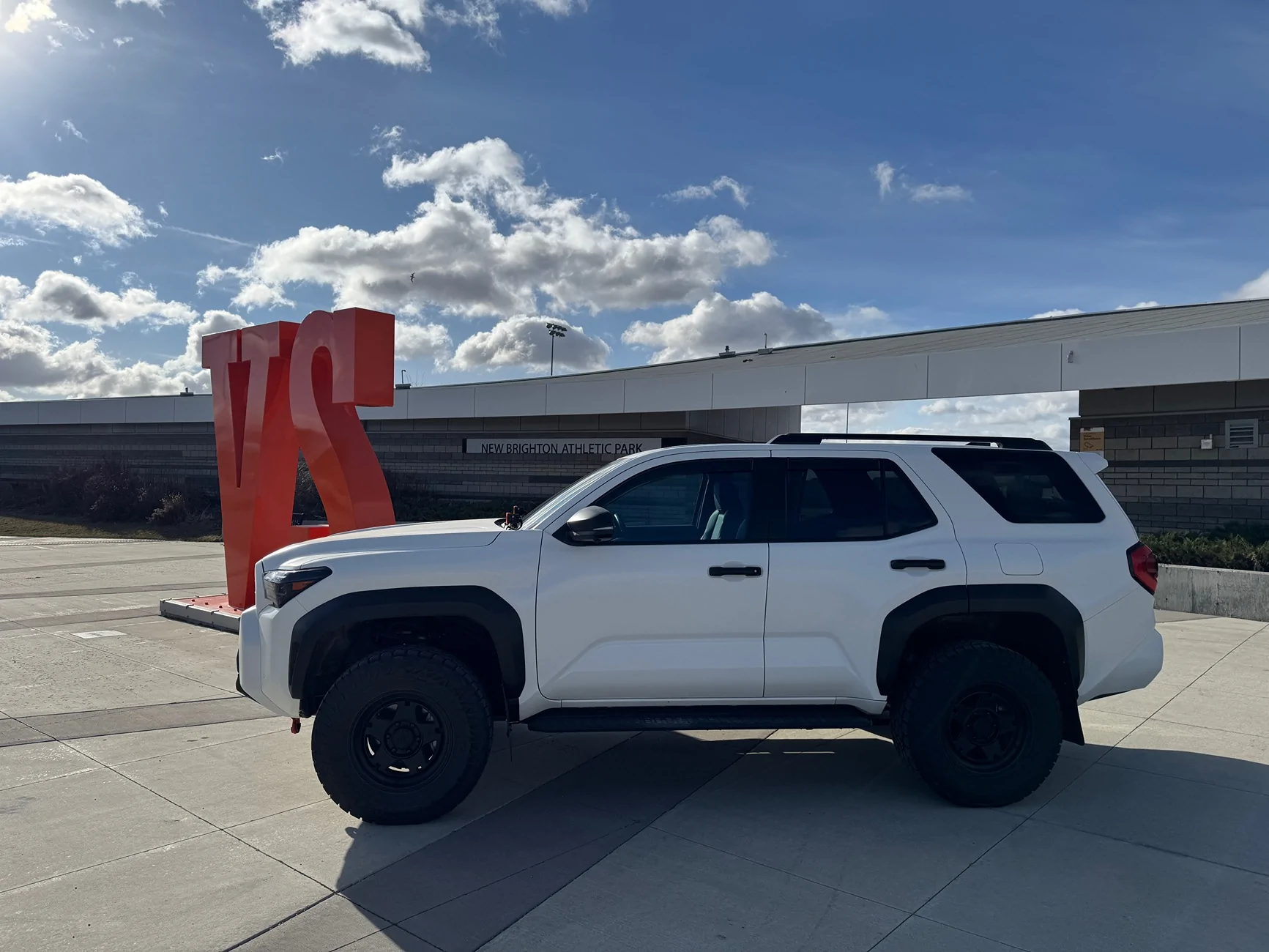

Finally got around to installing the MT64 lift on the car. A whole day install ordeal but very worth it in the end.
2025 2026 4runner 6th gen ARB OME MT64 Suspension Lift Kit (2.5 inches front / 2 inches rear) on 2025 4runner SR5 34766-1ed6694e5149365dd8cf830a4e4ec
2025 2026 4runner 6th gen ARB OME MT64 Suspension Lift Kit (2.5 inches front / 2 inches rear) on 2025 4runner SR5 34764-1aba8ac2746e4316b5155323ed7b1710
2025 2026 4runner 6th gen ARB OME MT64 Suspension Lift Kit (2.5 inches front / 2 inches rear) on 2025 4runner SR5 34765-a4cadeea39259c670b053343217e54ad

I installed the OME MT64 myself with the help of friends and by far the most difficult part was loosening the stock UCA bolt. It is torqued on there pretty good so definitely use a breaker bar and/or cheater bar to break it loose. Just remember to put load on the suspension before you torque down the UCA bolt. Full suspension install can be done by yourself but goes much smoother with another person or two. Otherwise the install is pretty straight forward.

Left mine at 3" so we can add the winch soon, without the extra work.
yours does look good too!
Questions for the UCA where do the brackets it comes with actually go? That was the only thing we didn’t install because we couldn’t figure it out
