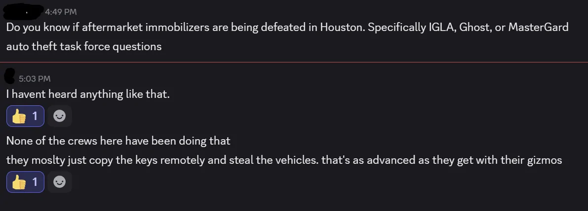

There is always a way around security. If you had unlimited access to a car, you could tear it apart and find the immobilizer. My 2020 Charger Scat Pack was stolen and recovered from a canbus attack. I had it locked down after recovery and there were 4 failed attempts to retake it after that. I eventually sold it but immobilizers do work. The IGLA is tiny and hidden deep in the factory harnesses.
I have a friend who is a Houston PD detective and these are his comments:
