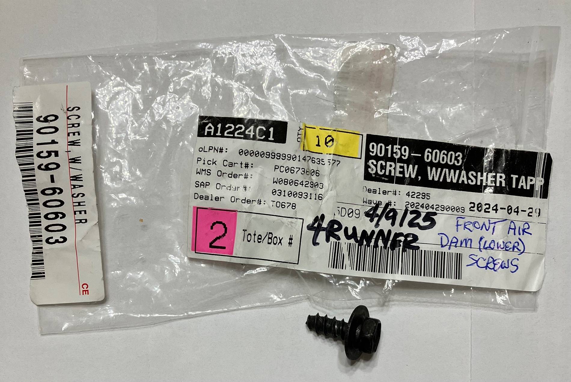

ToyoX3
May 1, 2025
North Texas
2025 4Runner SR5, 2012 FJ Cruiser, 2004 Tacoma SR5 PreRunner
There are a couple different threads open on this very topic. I had the same thing happen to my new 4R6G, too.
Here is an image of the bag that contained four screws that I got from my Toyota dealership’s parts department to reattach my front air dam/ valance.
