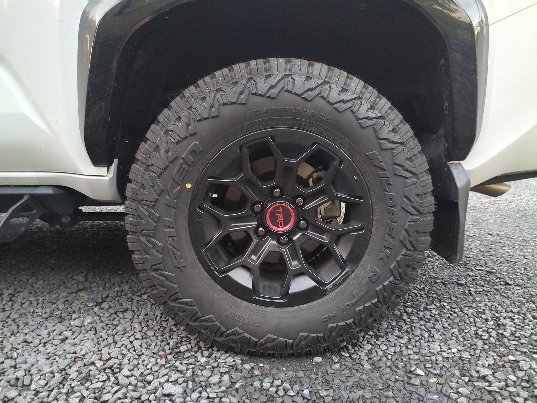

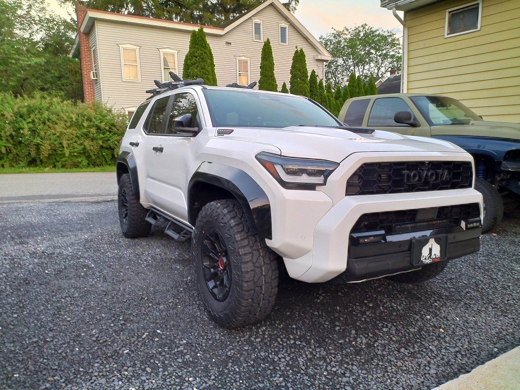

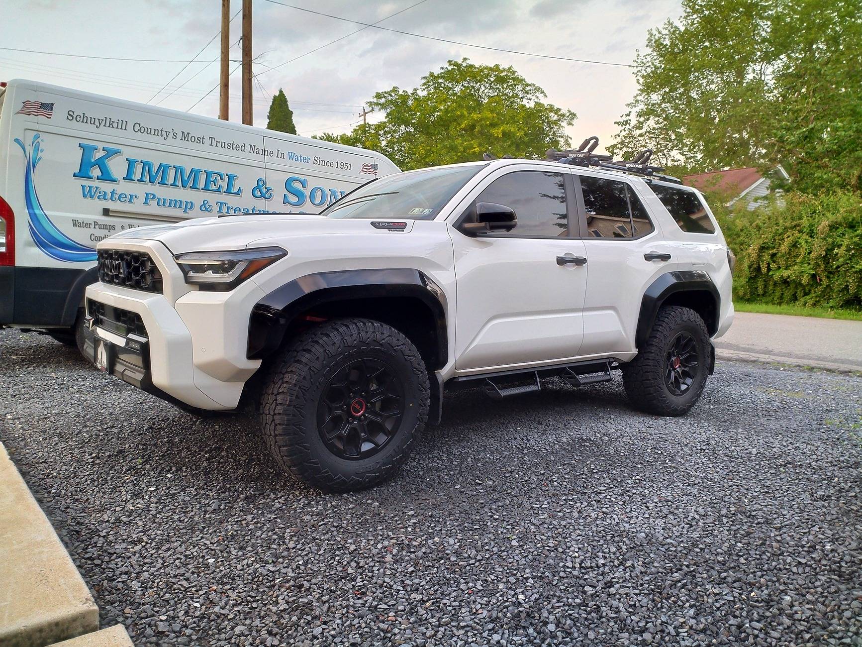

Went with the thinnest, tallest tire so I could stay with the OEM rims for now. Figured that would be the best way to stay in the sweet spot for articulation. We'll see if I'm right.
Liking these tires, Really well rounded tire,
some noise but minimal,
smooth ride, grip and corner good in heavy rain (10 minutes after I had them installed on the way home...lol)
Much firmer ride than the ATIII's.
Going to the "E" rated really stiffened the ride up.
Will test it out full articulation to check for rub later this week.

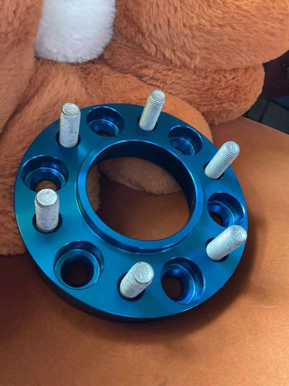

Can you confirm part number on the KSP spacers? Looking at the MT-6104K but their website doesnt list any as compatible with the 6th gen yet.

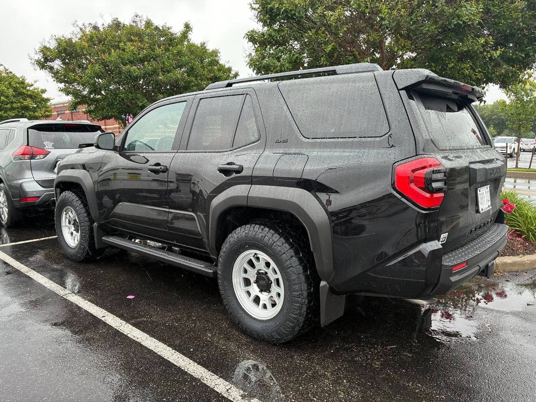

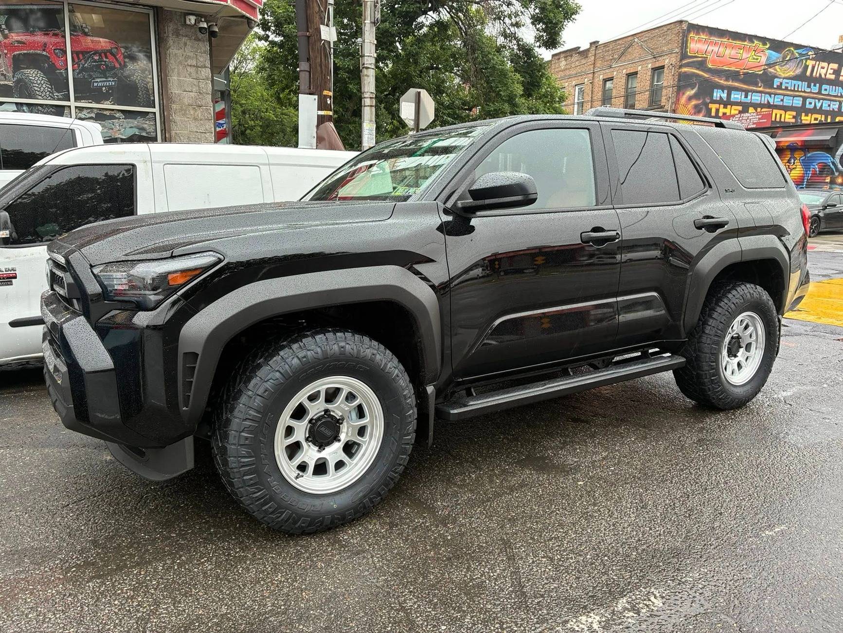

Black SR5 on:
Nitto Grappler tire 285/70/17
RRW rr5 s-flow 17x8.5 wheels +25 offset
No lift, no rubbing

1.5" KSP spacers installed today. 275/60/20 Falken Wildpeak A/T4W on stock TRD Sport wheels.

Full Articulation, less than a 1/16" to the crash bar at full stuff and turned. No rub...
I also noticed that my rims didn't get knicked like they did with the Toyo's on my first run. Tire sits a little bit further from the edge of the rim which seemed to help.
P.S. OEM Toyo's once unmounted could be pushed to fold in half. Very weak sidewall.
