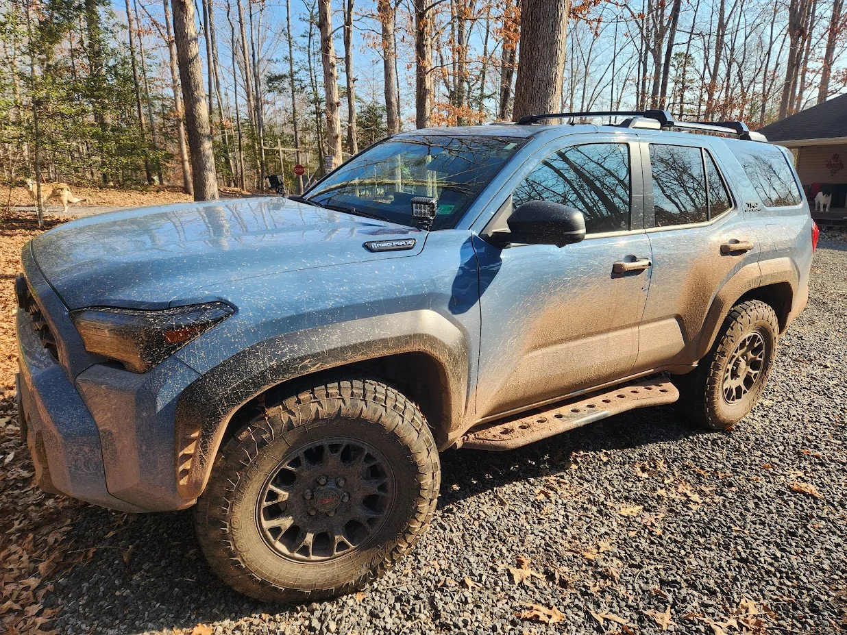

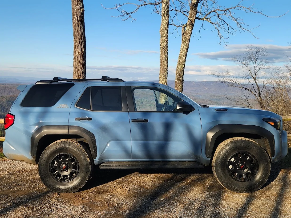

I didn't mean to put on "35s" - I ordered Toyo A/T III 285/70R18 which are 33.7" ("34s") but the shop received and installed 285/75R18 (34.8") on my new TRD PRO wheels (+20 offset). Yep - they rubbed on crash bar and front fender liner. I removed crash bar and pushed in fender liner and bent back the air dam tab and they worked mostly... but then when offroad the rear tire rubbed on the fender flare when articulating up and I knew I needed something to change. Got the +45 offset TRD flat black option wheels and swapped (put my OEM 265/70 Michelins on the PROs). Almost all is good - rear tires completely clear the fenders now but at full articulation up under power uphill they rub the inside of the wheel well. No damage potential that I can see - its literally the tire just touching the felt as it rotates. (but I'm now motivated to put a bump stop in to prevent that - and get extended travel shocks to not lose articulation range.) The -.2" of difference in diameter for you likely will mean a bit less of this - and the narrower tire means even less potential for damage, I think.
So the question with your setup is: will the 30 mm (1.2") difference in width make up for the -10 mm offset - you really need to consider the front tire geometry but, (with crash bracket deleted) I think it will work. I would recommend not going any less than +35. With that, your "poke" should be a few mm less than mine (see below) and avoid the rear fender flare rub at articulation that I had with +20 offset wheels.
Caveat: this is for my TRD OR - not sure any of this would be true for another trim since the suspension components are all different. Also - I had the Peak 1.25" level installed with the original new wheels and tires - might make a difference in the front.
You are taking several risks but things could absolutely work out. Post pics when you do it!
