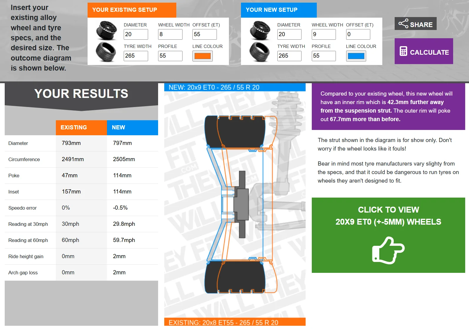

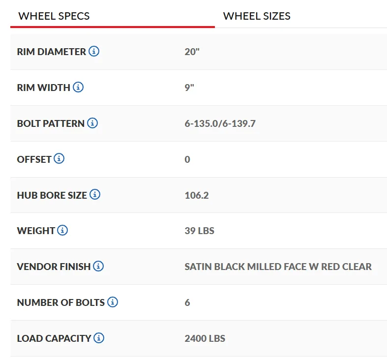

i was wondering if any of you smarter people would have any insight on this configuration being able to be installed on a 6th gen 4runner.
i do know that the new 6th gen has a smaller bore 95 (but you can use a hub centric ring to fill in the gap from 106 down to 95)
the bolt pattern is the only odd thing, the wheels shows 2 different sizes for the same wheel (which i have never seen) but lists the correct bolt pattern of 6 x 139.7
this should work correct with hubcentric ring ???

ouch they are going to poke a lot if the platinum offset is 55 like the limited. 67.7 mm more poke than the oem wheels.
yeah that not even close to working. 🤦‍♂️
