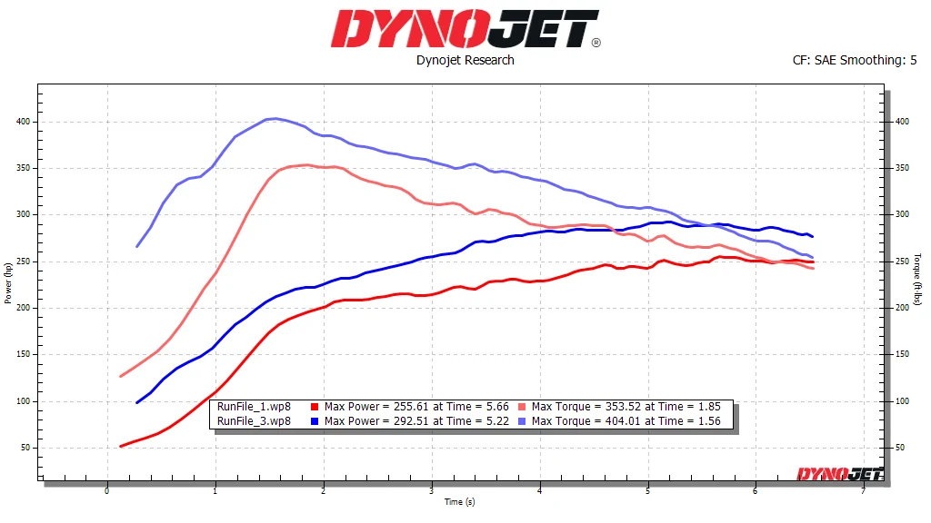

Had the opportunity to get a 2026 4Runner TRD Sport on our dyno.
Truck is bone stock, ~3,000 miles, running 86 octane.
For context, I have extensive remote tuning experience with this platform, and have many Tacomas on our dyno, both gas and hybrid.
This was a great opportunity to have a local one on the dyno and validate what we’ve consistently been seeing in logs.
Baseline
  • 255whp / 353wtq
  • KCLV: 13
  • Lean behavior through peak torque
  • Roughly ~15whp lower than most Tacomas we’ve tested
So not just low octane — also a softer baseline than expected for this platform.
After Tuning (Still 86 Octane)
  • 292whp / 404wtq
  • KCLV increased to 17
  • Fueling corrected — especially in the peak torque region, now safer than stock under load
Gains
  • +37whp
  • +50wtq
Observations
  • The lean condition in the torque region matches what we’ve seen on the dyno and remote tuning.
  • Same engine/platform — Baseline and gains are in line with 91, but lower peak numbers due to octane limitation.
Bigger Picture
Having tuned a large number of these remotely, the patterns were already there in the data.
The dyno just confirmed it:
  • Stock calibration isn’t always ideal under load
  • Even on 86 octane, you can improve power and safety at the same time
Not trying to turn this into a stock vs tuned debate — just sharing what shows up when you actually measure it.
Bottom Line
  • Same 2.4T platform (Tacoma / 4Runner)
  • Same trends in logs and on the dyno
  • And even on 86, there’s meaningful room for improvement when it’s calibrated properly

Wish you would have done a run on premium before tune to have another dataset of the difference octane makes in these engines.
It showed up with a full tank of 86, so no opportunity to do that.
I've had a number of Tacomas on the dyno on 91 and have a stable baseline what what they make with both factory size and oversized tires. I typically see 267-270whp on 91 on stock tires with the stock tune.
He's going to switch to 91, and when he does, I'll gather some dyno data on the stock tune. With the Accessport it only takes a couple of minutes to load the stock mapping back and do some runs.
Octane makes almost no difference, I've done similar tests. That's always been a myth that you get better performance with higher octane. That only makes a difference if you have a high performance engine that requires it.
100% wrong when it comes to this engine. Camtuning even just confirmed it with their tacoma dynos. So did Stillen. It is right around 15-20hp increase.
On an 11:1 Compression engine with a turbo, it absolutely matters. I have a deep understanding on how the ecu works on this platform, and while it "can" safely run lower octane, there are a number of reasons I wouldn't.
Lower octane = lower knock resistance.
When knock starts, the ECU pulls ignition timing to protect the engine.
When timing is pulled:
  • Combustion happens later
  • Less power is made
  • More heat goes out the exhaust
That directly means:
  • Higher EGTs
  • More heat through the exhaust valves and turbo
  • Less efficient combustion overall
