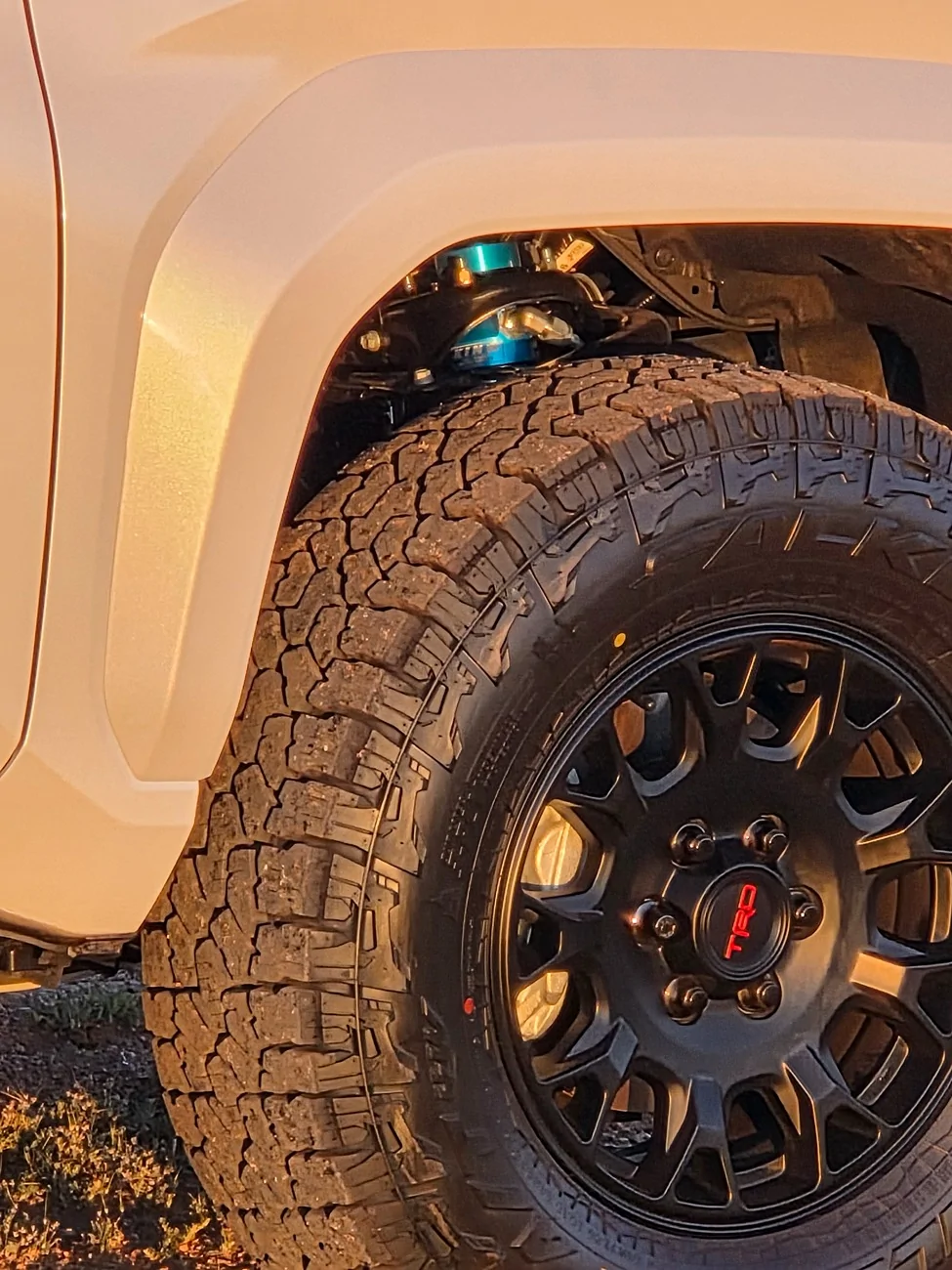

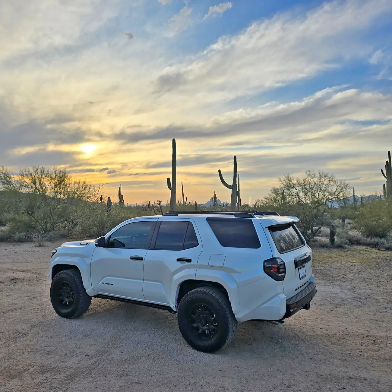

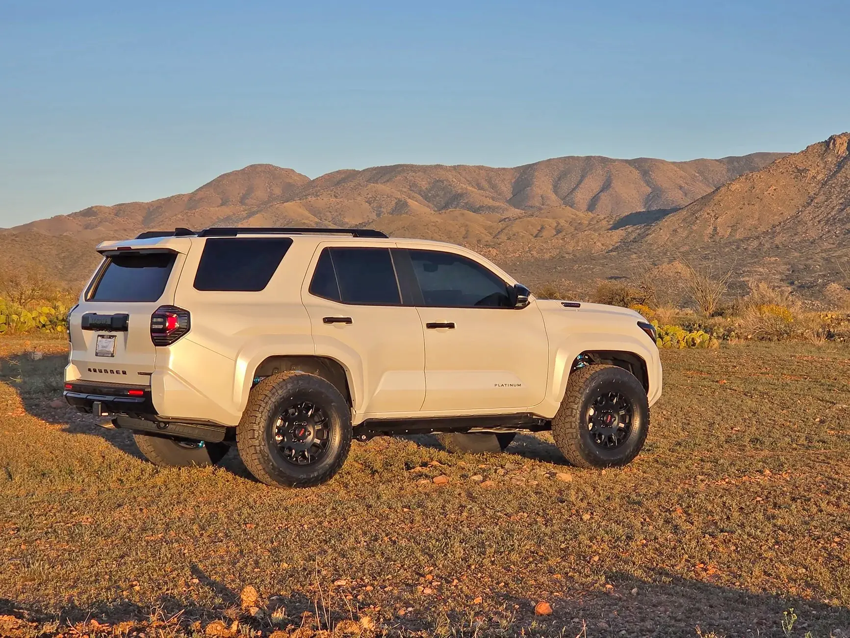

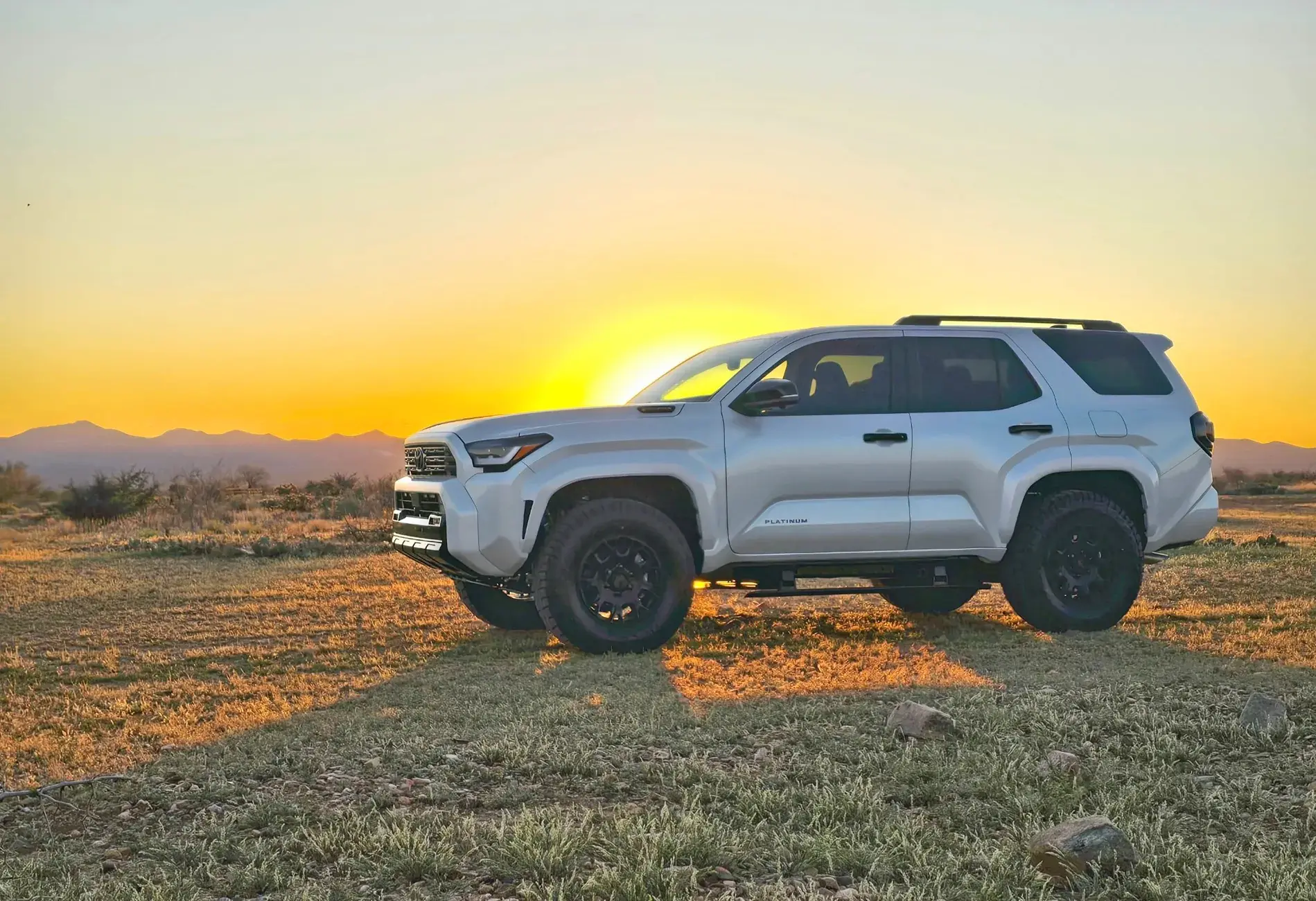

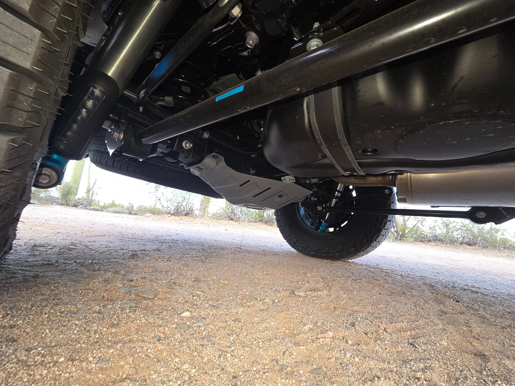

Next were the King 2.5" shocks and springs. Raised the front about 3" and the back about 1". 18" TRD Pro 4Runner wheels with Falken 285/70R18 AT4W tires. The offset puts these out by about an inch compared to stock.

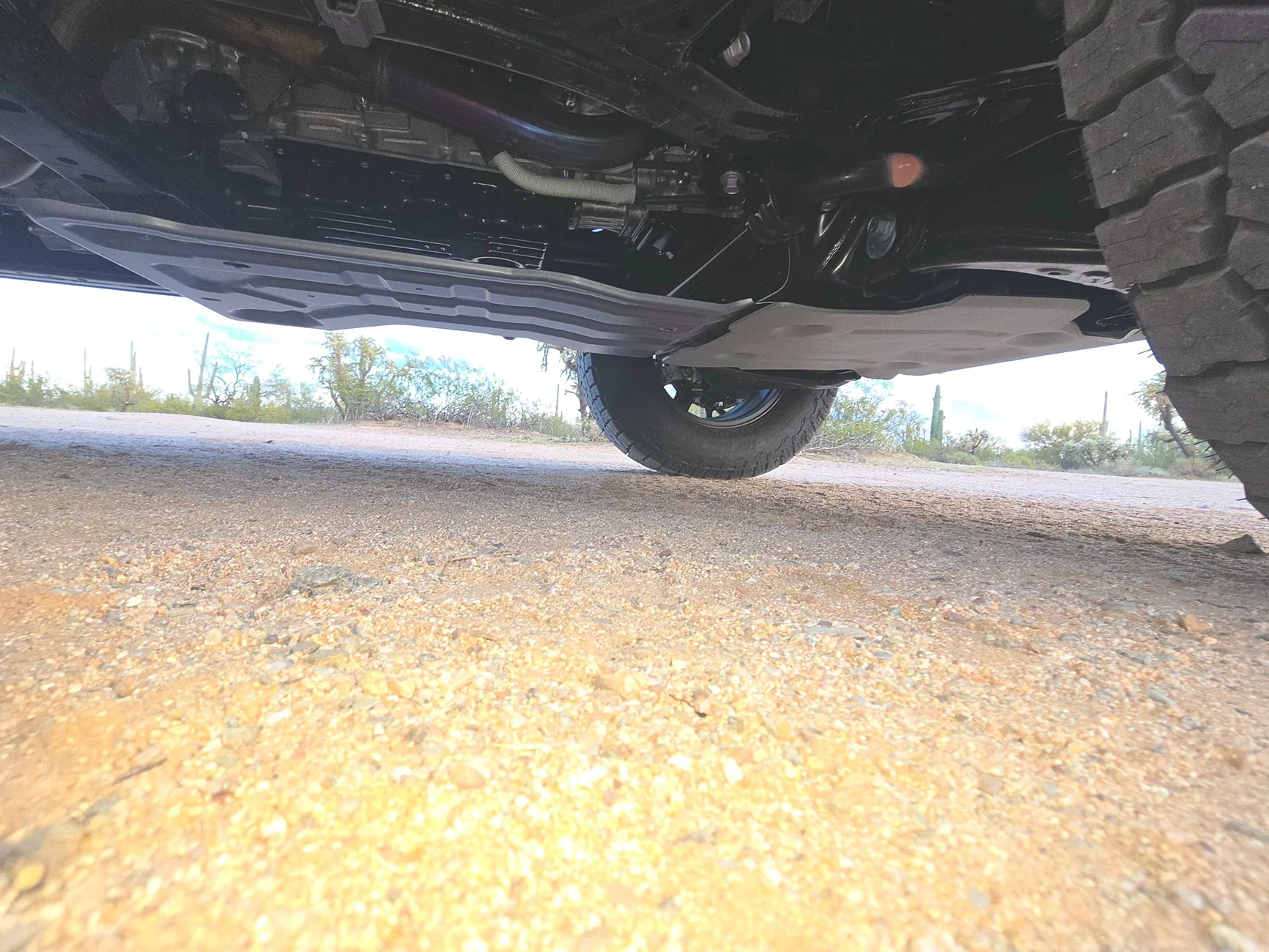

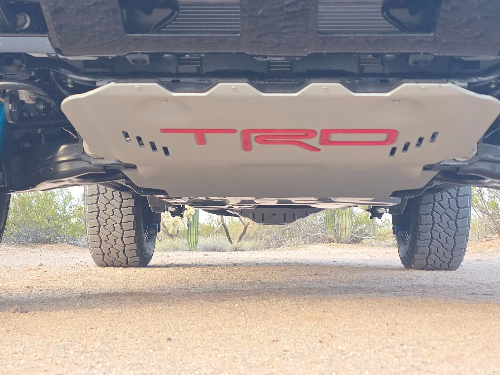

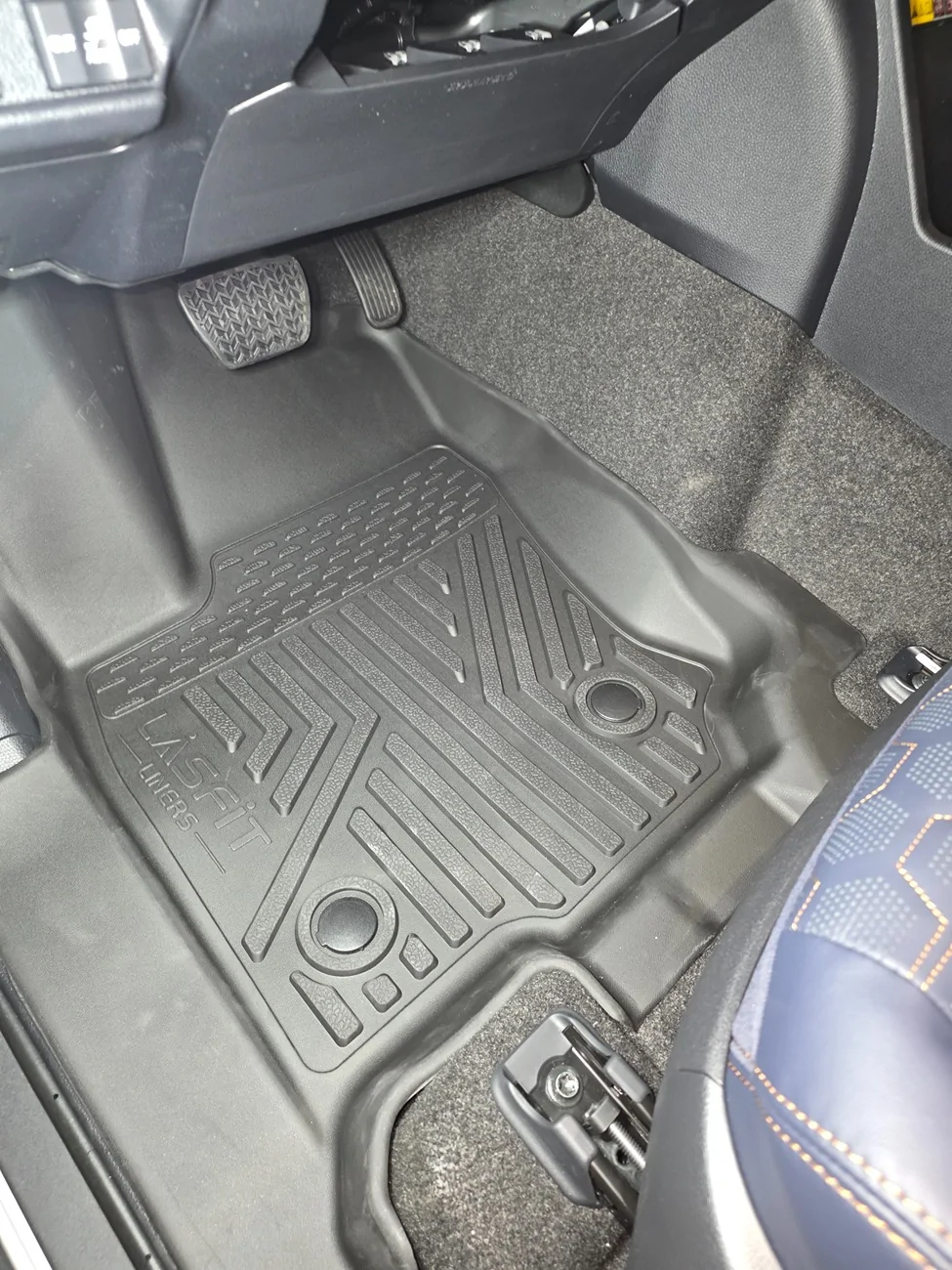

Underneath are TRD Pro front skid plate, transmission skid plate, and the rear diff skid plate. Add some Lasfit mats for the driver and passengers, and Weathertech for the cargo area.

Those wheels look to be poking out more than usual. Are you running wheel spacers? The pro wheels have a +20mm offset and poke a good bit, but those TRD Premium upgrade wheels that you are running have a much narrower offset (+45mm)
