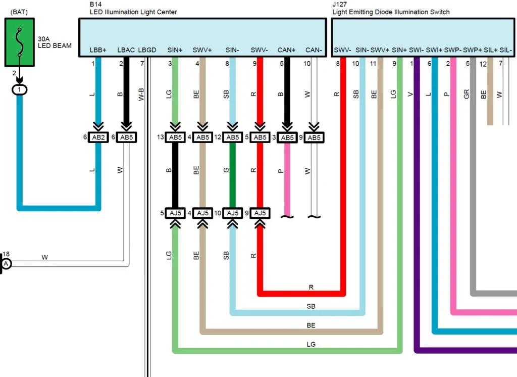

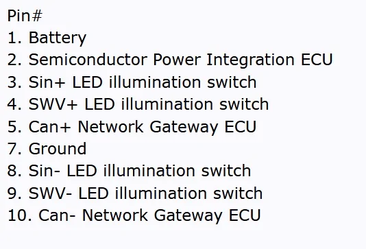

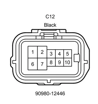

Here's the connection point on the bar and the wiring pinout/diagram for the female connector.

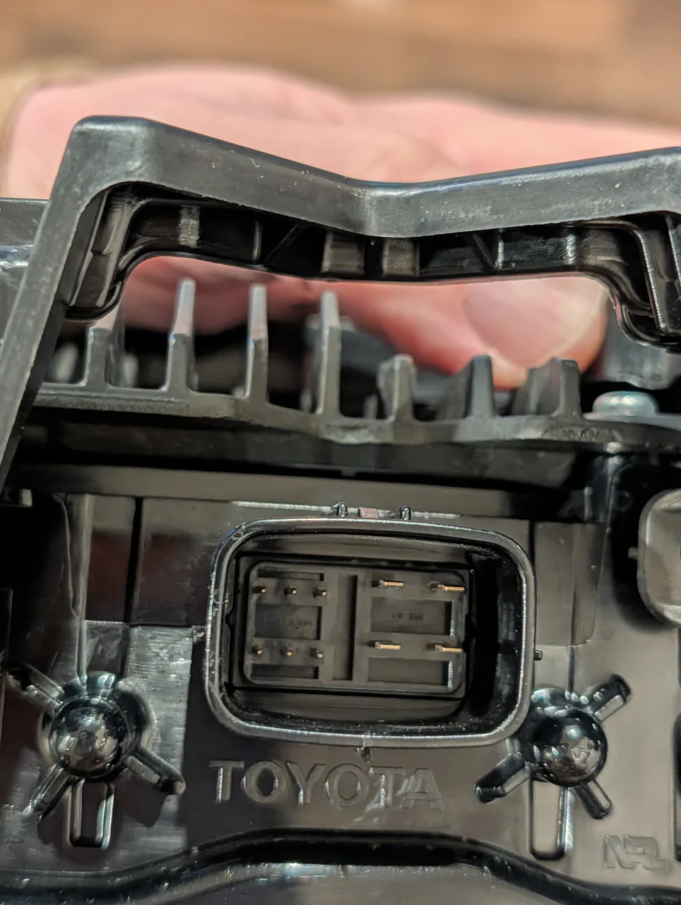

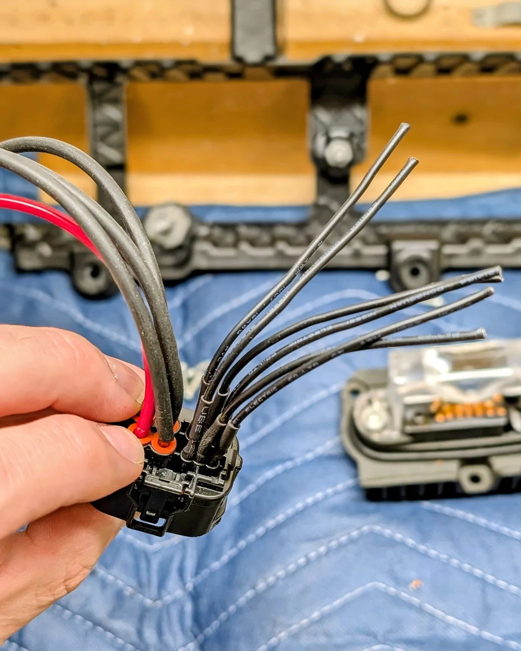

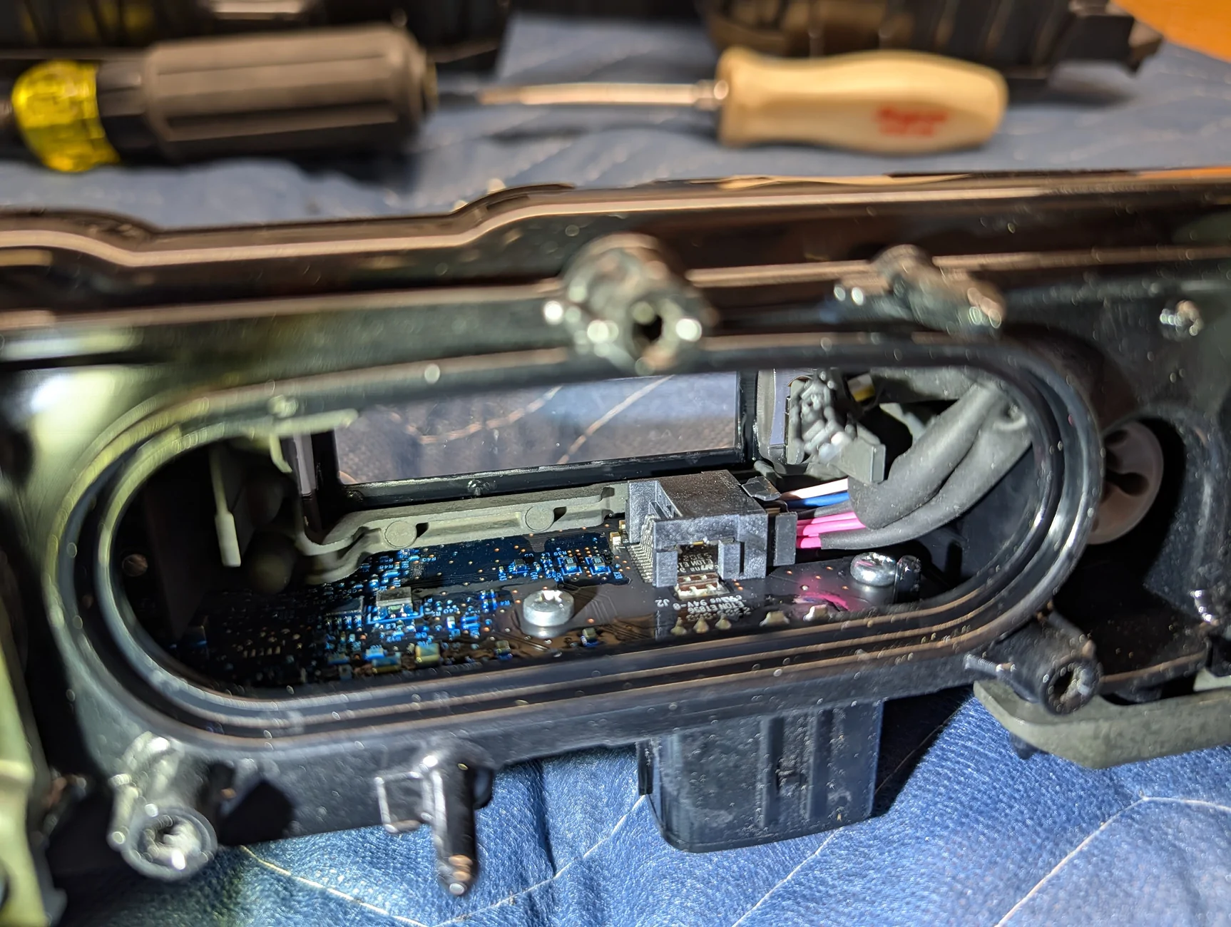

Here is the inside of that connection, note that there are 12 wires, not 10 to match the pins because WHY THE HELL WOULD WE MAKE IT THAT EASY?
2025 2026 4runner 6th gen Retrofitting factory Trailhunter / Pro Grill and Light Bar onto lower trims 1771462213825-b6

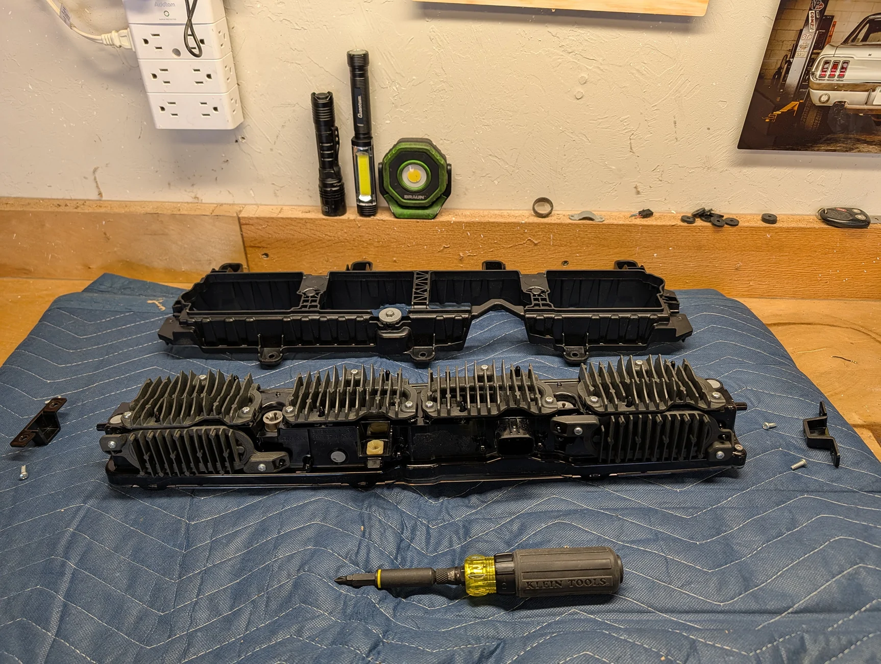

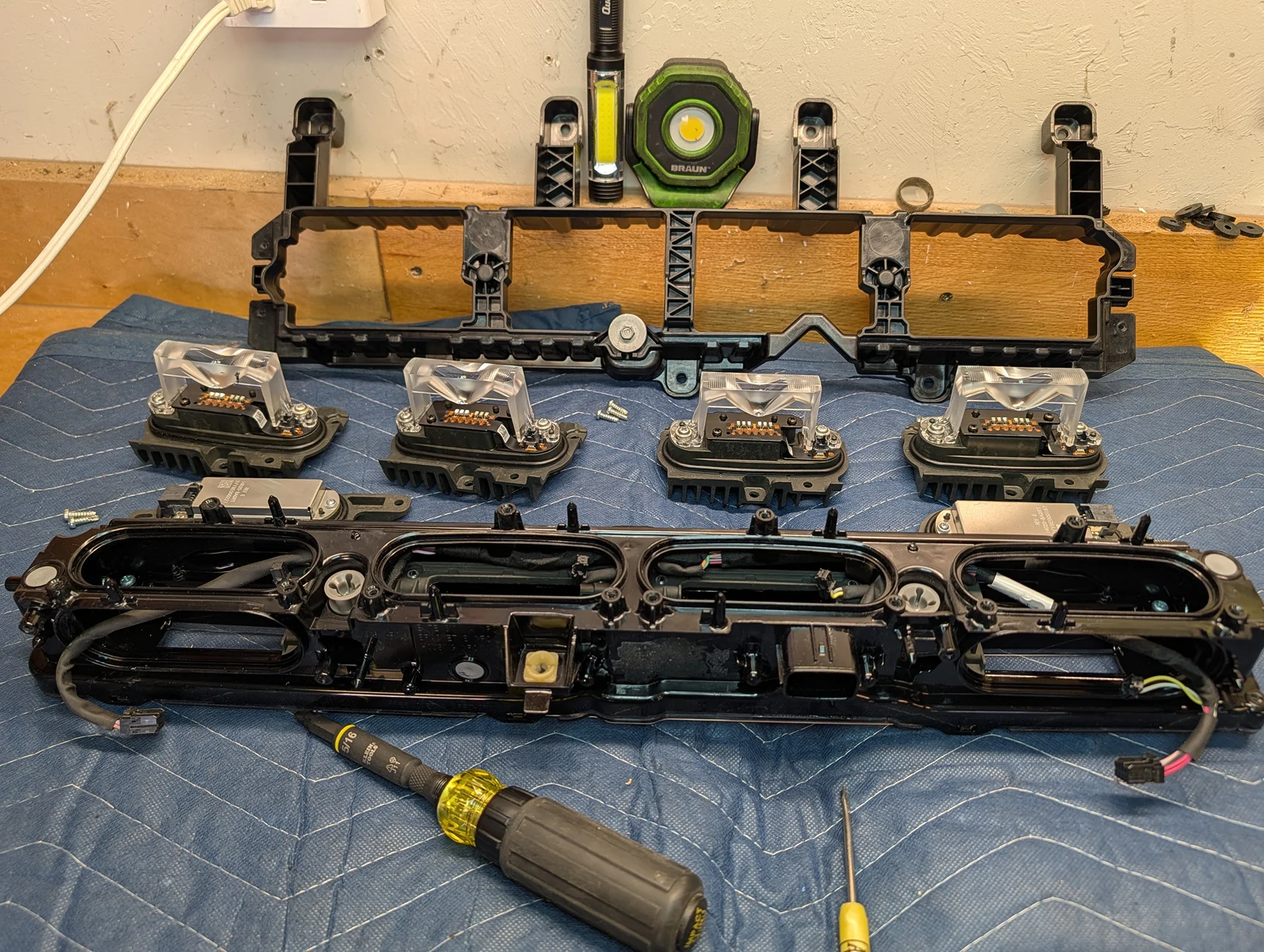

Four of the lights pop right out when unscrewed. Three remain inside the bar and require further disassembly that I couldn't do in order to access.

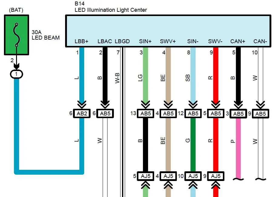

On the factory connection, pins 7, 8 and 9 are ground. Past that? I don't know what's expected over those connections. 12V to any combo I tried based on that diagram resulted in bupkis. That's when I started taking it apart. The Tundra guys had the same kind of issue (starting a few years ago) and from what I can find...They gave up, drilled a hole in the back of the light and fished out the 12v and grounds and ran with it. This seems a bit more involved. Tacoma forums have a few similar threads and I found no solutions there either, and they've also had a couple of years head start on us.
Putting 12v to the individual lights, once removed, fires them right up. Each light has two pins. Simple. And I'd 100% just splice into all of them and run my own harness out the back...Except that I can't get to three of them. The way this light is assembled, four LEDs come right out, but the other three require the shell to be split. Pretty sure they're bonded/sealed together. I couldn't get them to budge, broke three trim tools prying on them. So I can just trace the wires and tap into them upstream, right? If I could find them. There's probably 40' of wiring in there that I can't see. The circuit board is 6-8 inches long and has a second wiring harness in it, no idea what that's for.

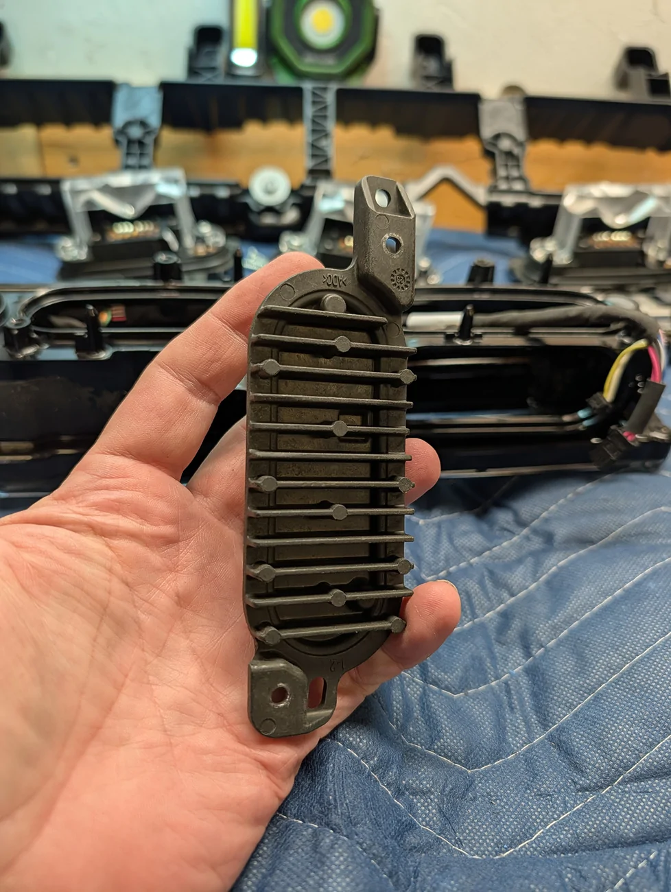

Speaking of NOT A DANG CLUE...Two of those heat sinks aren't lights at all, but mystery electronical wizard magic stuff wired in because WHY NOT.
2025 2026 4runner 6th gen Retrofitting factory Trailhunter / Pro Grill and Light Bar onto lower trims 1771464041869-4j
2025 2026 4runner 6th gen Retrofitting factory Trailhunter / Pro Grill and Light Bar onto lower trims 1771464061119-6f

Hey if that light bar has lights in it then there is a way you can open it! You might have to cut open the case with the Dremel. Do a full forensic on it and then rebuild. Good luck

I’m seeing the “CAN-“ and “CAN+” pins… those are CAN connections into the LED bar itself?
I’m guessing it will not operate without the proper communication with the network, unfortunately.

If I were you, my next step would be to get someone with a Trailhunter and hook up a scope to the vehicle side of the connector to see if the pins are signals or just high/low 12v.
I might be able to help with this, in a few months.
Good luck!

Have you tried sourcing the factory harness? #1 is most likely 12 volts. Based on my research, LBAC is low battery alert circuit. Guessing LBDG is low battery ground??? The rest of diagram is pretty clear on polarity. Looking at DiodeDynamics and even they don’t offer a plug and play option. The path you are on right now, I think there’s a possibility of throwing lights on the dash trying to integrate

Dremel might come out for a post mortem if I ruin it, but otherwise...I'm pretty sure I'd have to stick it in the over and heat it up to get the two (or more) parts to separate. So it's going to have to stay together for now.
Also my guess. But hey. Somebody had to try it.
Good luck!
Yeah, it will require somebody with a Trailhunter/Pro that's smarter than me with a scope to figure it out after they're willing to tear into their new truck to tinker with a working part. So I won't hold my breath :D
Need y'all's help!
LBAC, LBGD, SIN, SWV, LBB...Be useful to know what those are, so @Vincenzo (or anybody! Please!) if you're aware of a place, could you shoot that my way? Irritating that there are literally thousands of acronyms in the manuals, and a whole lot of them are simply never explained. Very irritating. 22,000+ pages in the manual and it's not in there. No legend or glossary for the wiring schematics that contain it.
I also found a troubleshooting procedure for the light bar that says the canbus + and - are expected to have a 54-69 ohm resistance with the battery disconnected. My dumbass wants to wire a 60 ohm resister in there and throw 2.5-5v at it and see where the smoke comes out. If Radio Shack was still around, I'd have already tried it...But I don't know where I can buy something like that locally LOL
