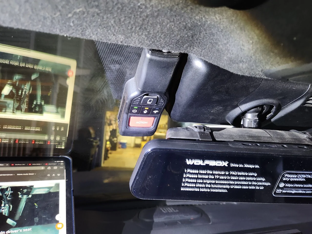

12/7/26: Installation Day 1/Strapping Everything Together

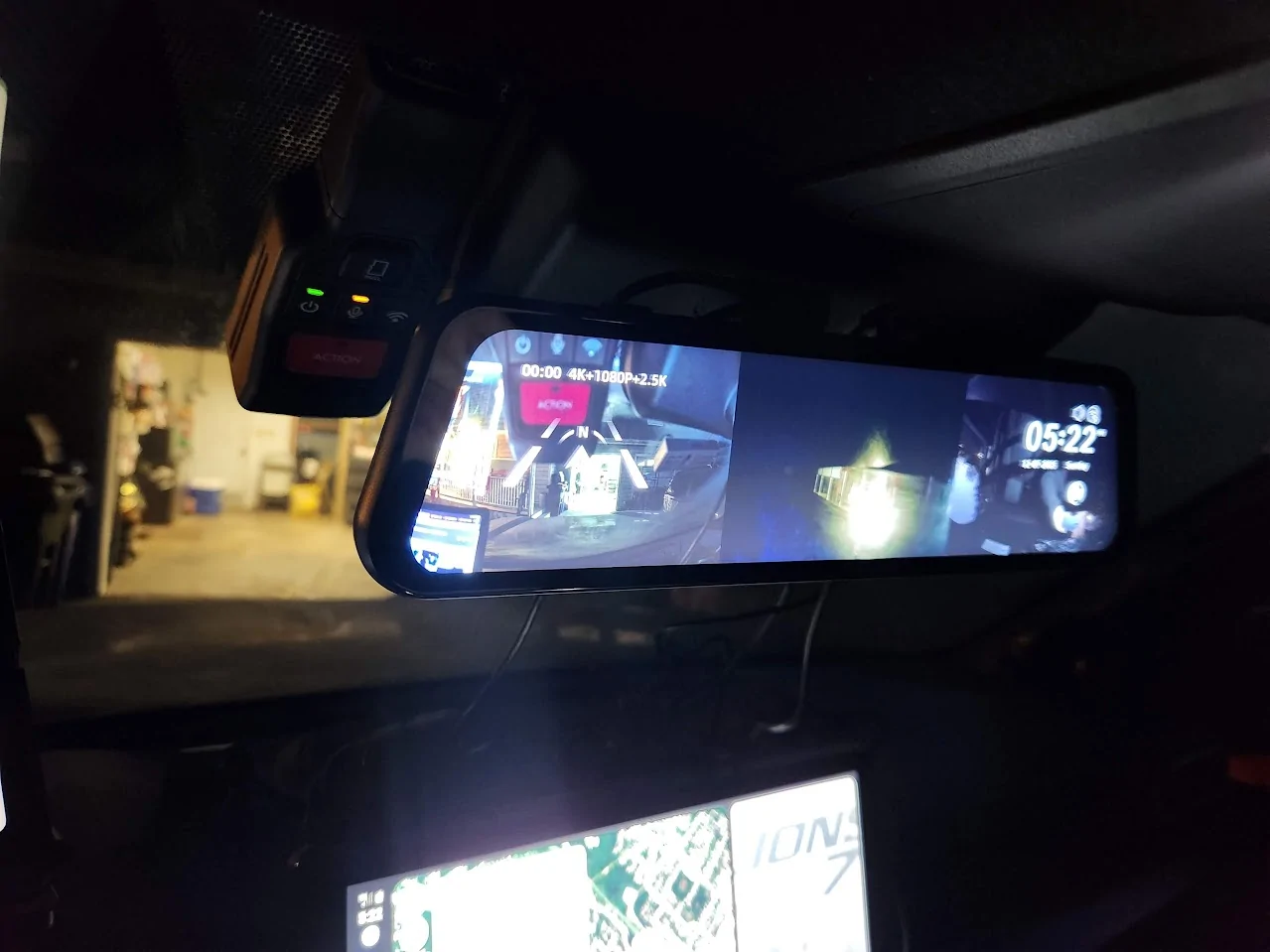

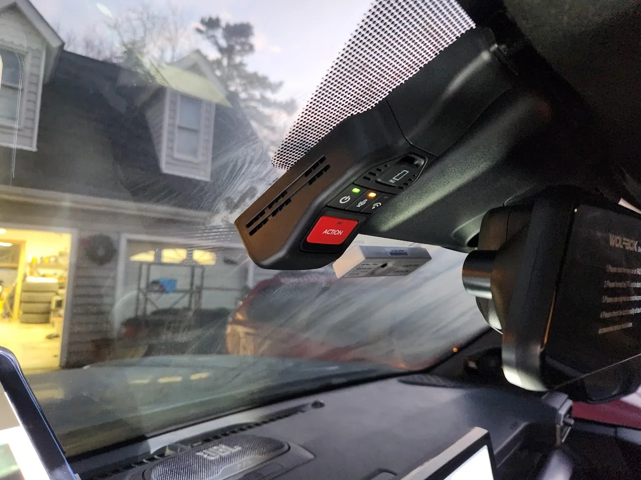

Original test run showing Wofbox strapped to my original mirror with my Toyota dash cam right in front of the Wolfbox mirror cam.
2025 2026 4runner 6th gen WolfBox G900 Tri-Pro Rear Mirror Camera - MikeD's Install Experience & Review 20251207_171251
2025 2026 4runner 6th gen WolfBox G900 Tri-Pro Rear Mirror Camera - MikeD's Install Experience & Review 20251207_171307

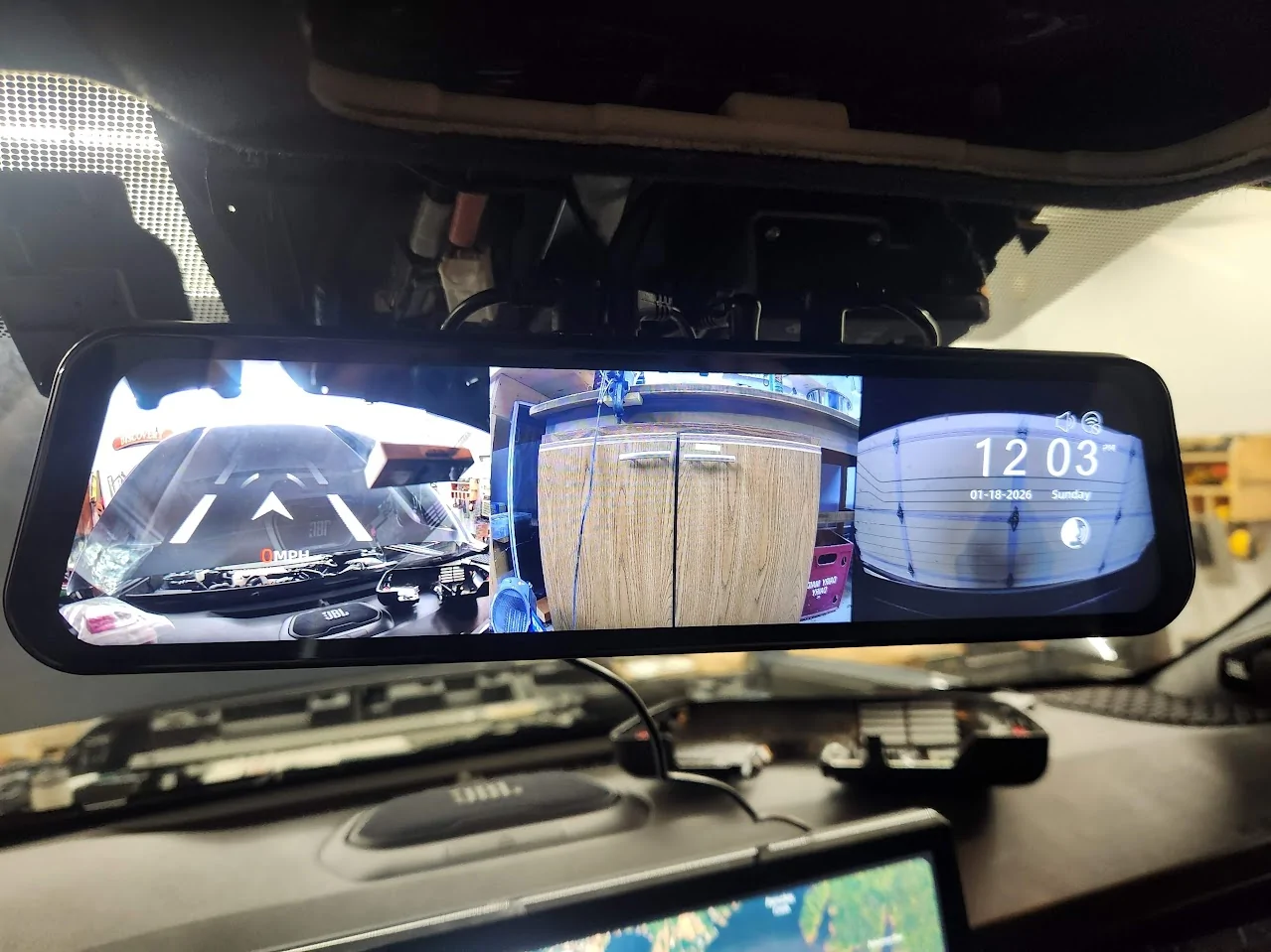

Test run with all three cameras working

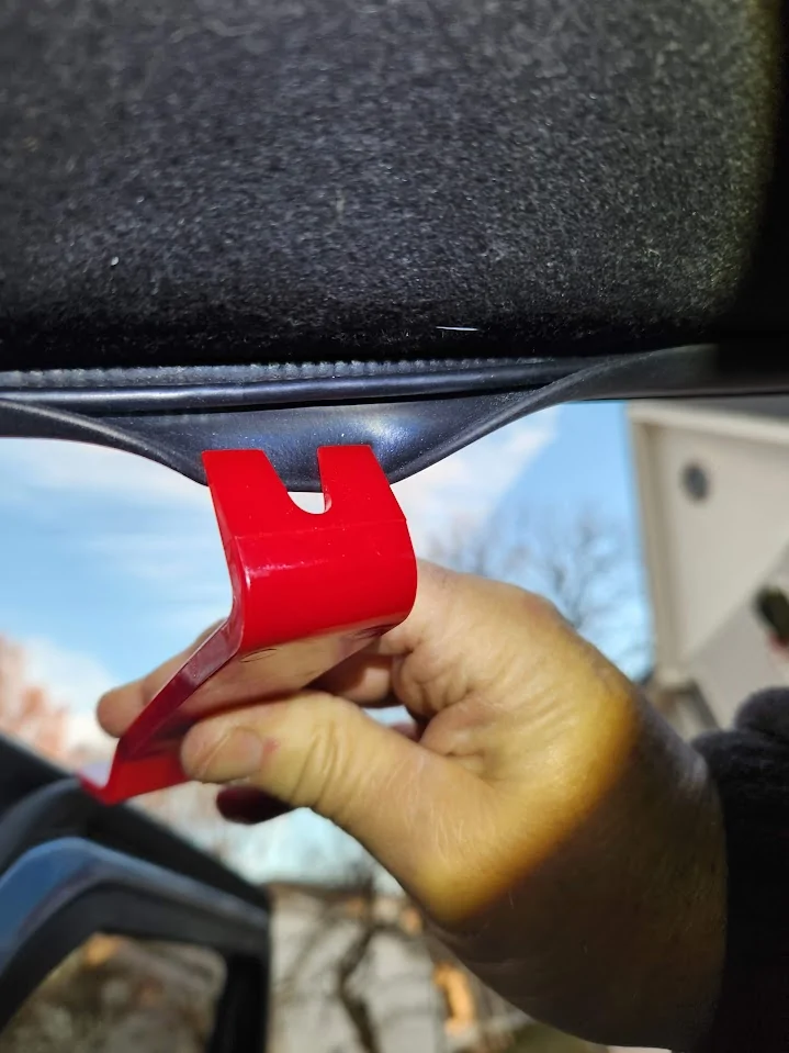

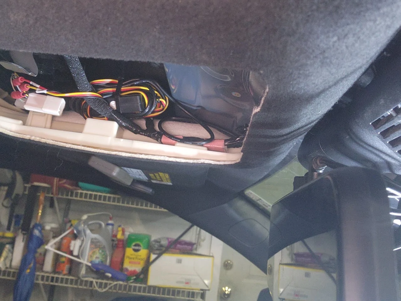

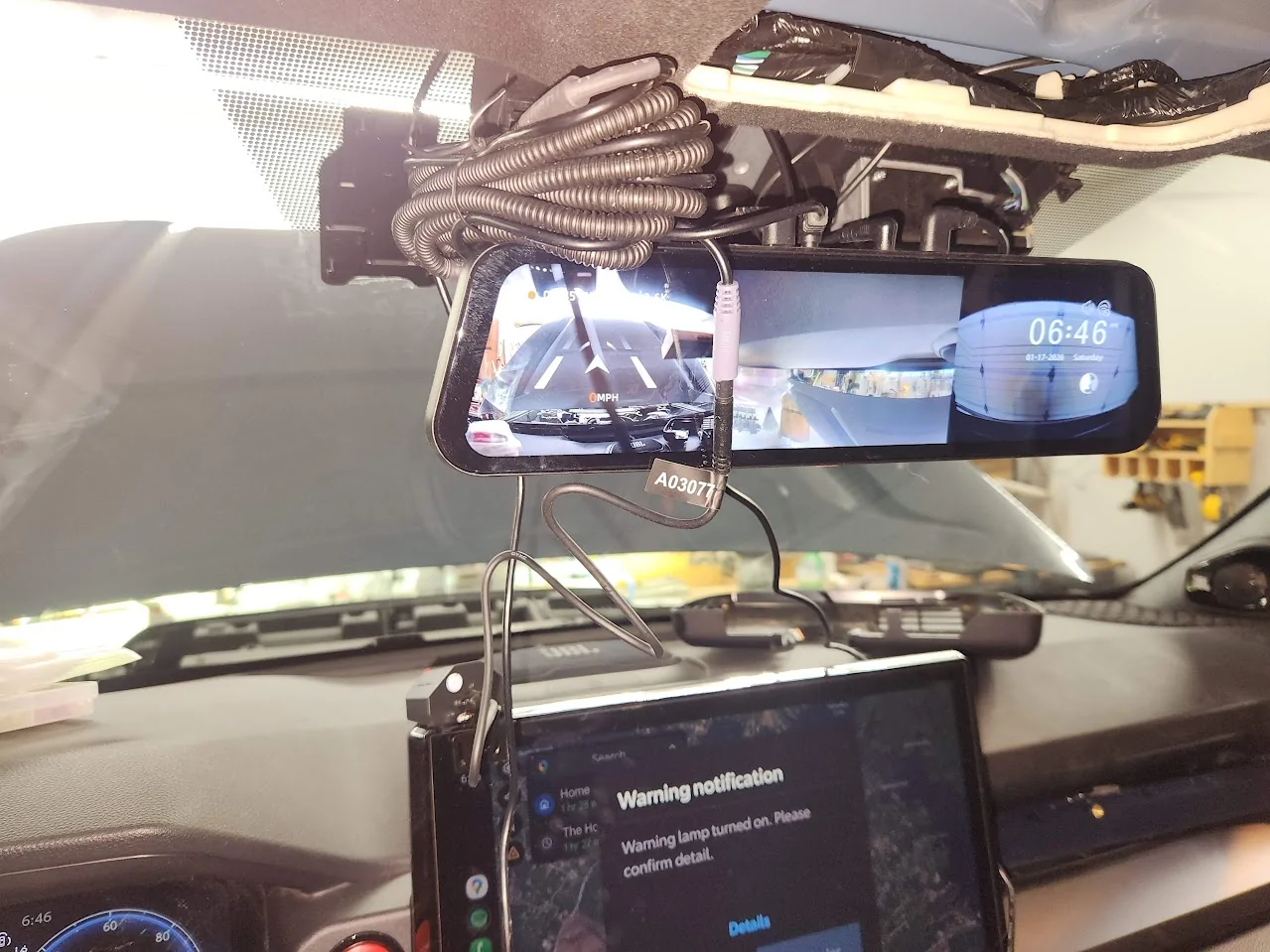

Taking apart the upper console to route wires (decision to use the replacement mount)
2025 2026 4runner 6th gen WolfBox G900 Tri-Pro Rear Mirror Camera - MikeD's Install Experience & Review 20251220_161308

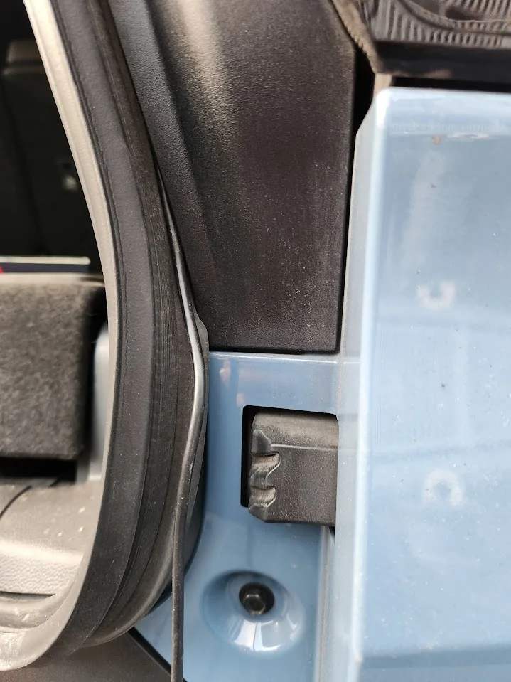

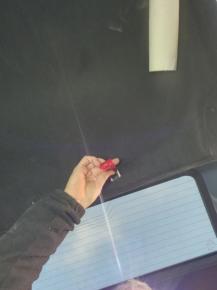

Routing rear camera - can't figure out how to get the cable to the license plate or the lower outside (decision to just get it attached inside and look through the window for now...)
2025 2026 4runner 6th gen WolfBox G900 Tri-Pro Rear Mirror Camera - MikeD's Install Experience & Review 20251220_162551
2025 2026 4runner 6th gen WolfBox G900 Tri-Pro Rear Mirror Camera - MikeD's Install Experience & Review 20251220_163157
Tried routing out the outside of liftgate but could not find a good path.
2025 2026 4runner 6th gen WolfBox G900 Tri-Pro Rear Mirror Camera - MikeD's Install Experience & Review 20251220_164159

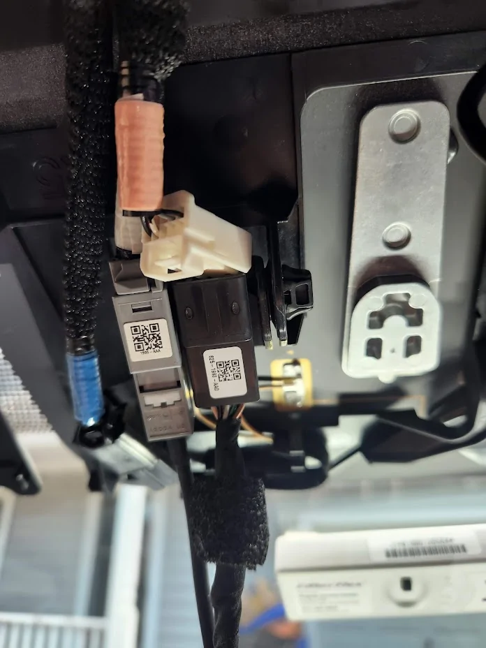

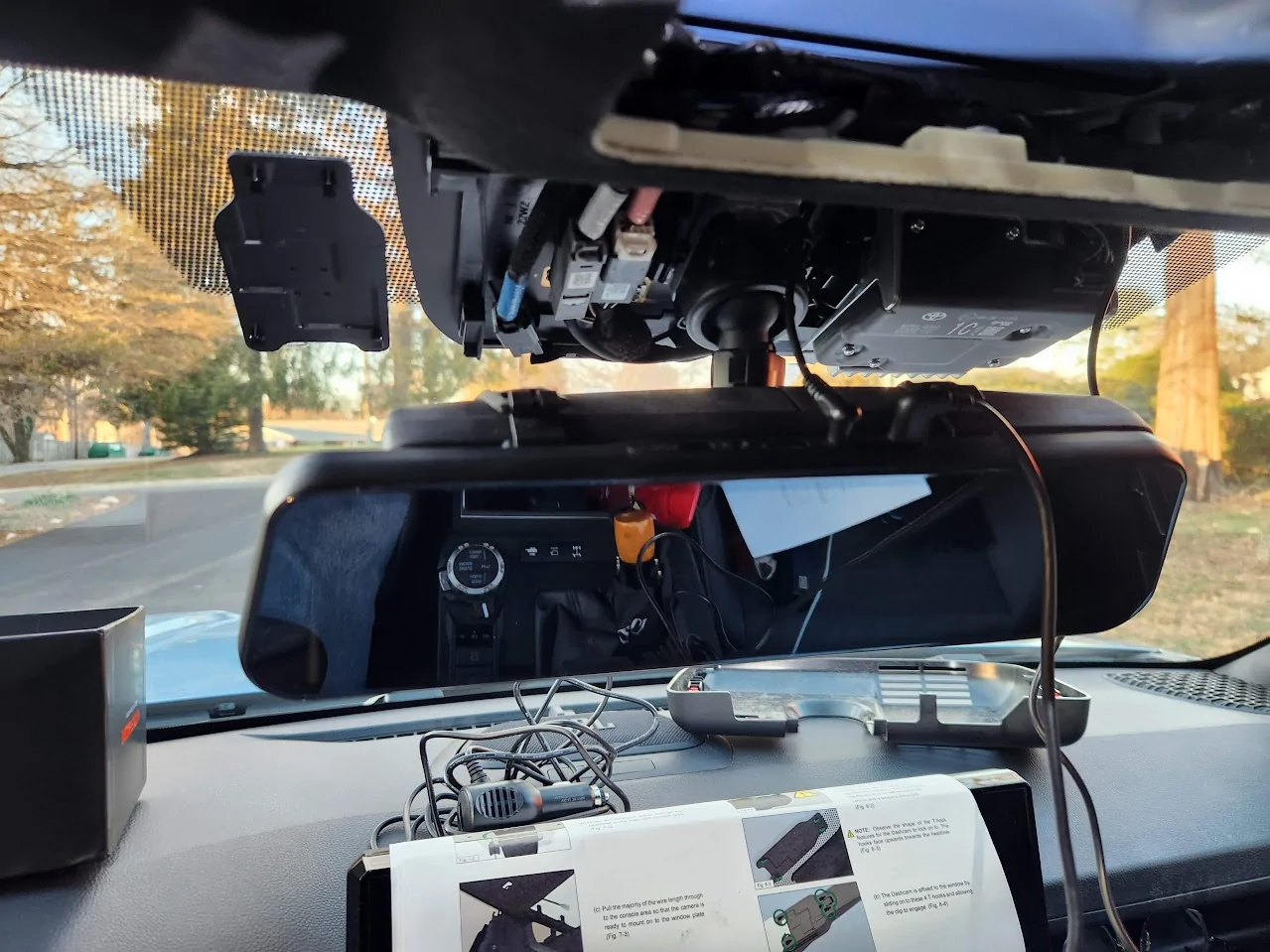

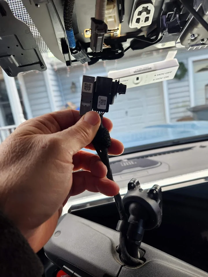

Removed OEM mirror to expose mount for "OEM Bracket"
2025 2026 4runner 6th gen WolfBox G900 Tri-Pro Rear Mirror Camera - MikeD's Install Experience & Review 20251221_144502
OEM Mirror connectors removed
2025 2026 4runner 6th gen WolfBox G900 Tri-Pro Rear Mirror Camera - MikeD's Install Experience & Review 20251221_145116

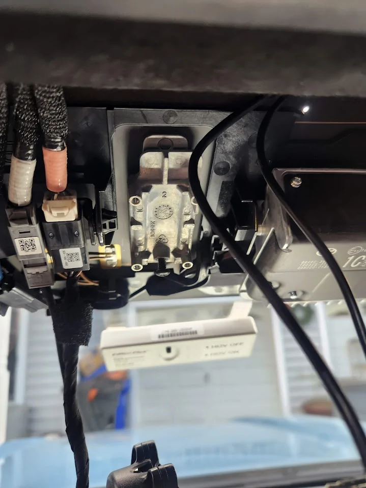

12/21/25: Inst Day 3

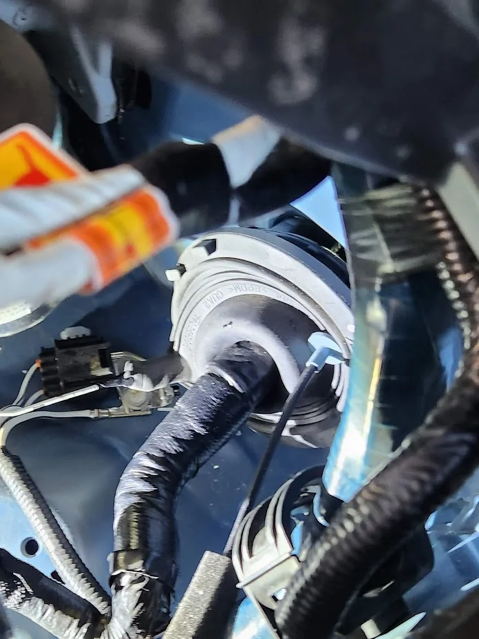

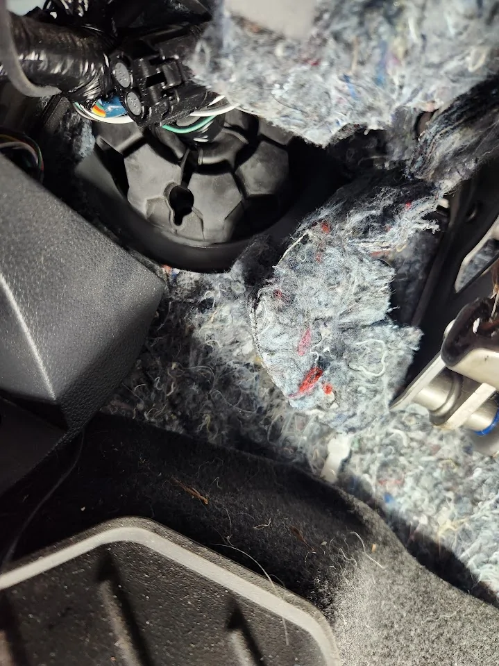

Firewall grommet - above left foot rest on driver's side:
2025 2026 4runner 6th gen WolfBox G900 Tri-Pro Rear Mirror Camera - MikeD's Install Experience & Review 20251221_151337

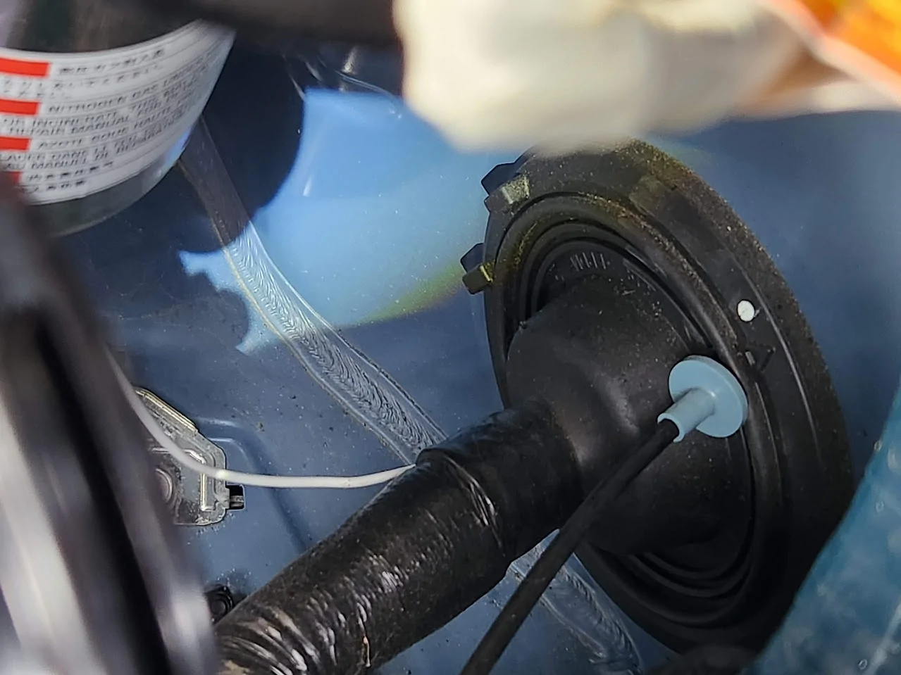

Firewall grommet from inside engine compartment
2025 2026 4runner 6th gen WolfBox G900 Tri-Pro Rear Mirror Camera - MikeD's Install Experience & Review 20251221_151650

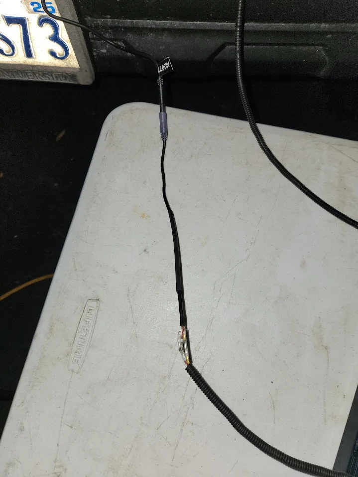

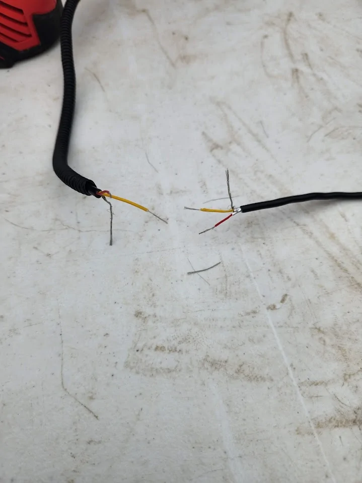

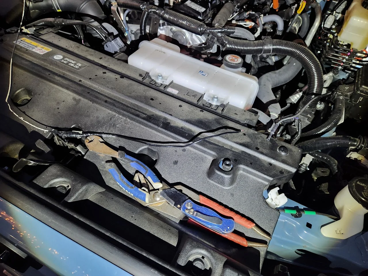

Wire hanger attached to bumper camera cable stuck in hole in firewall grommet. Pulled too hard and broke the cable (UGH). Lesson is to make sure that you are not pulling against a tangled cable - it was a tight fit for the connector through the hole I made in the grommet but it was the fact that the cable was tangled/knotted that caused the abject failure. Lesson learned.
2025 2026 4runner 6th gen WolfBox G900 Tri-Pro Rear Mirror Camera - MikeD's Install Experience & Review 20251221_164253-EDIT
Broken bumper camera cable.
2025 2026 4runner 6th gen WolfBox G900 Tri-Pro Rear Mirror Camera - MikeD's Install Experience & Review 20251221_171511

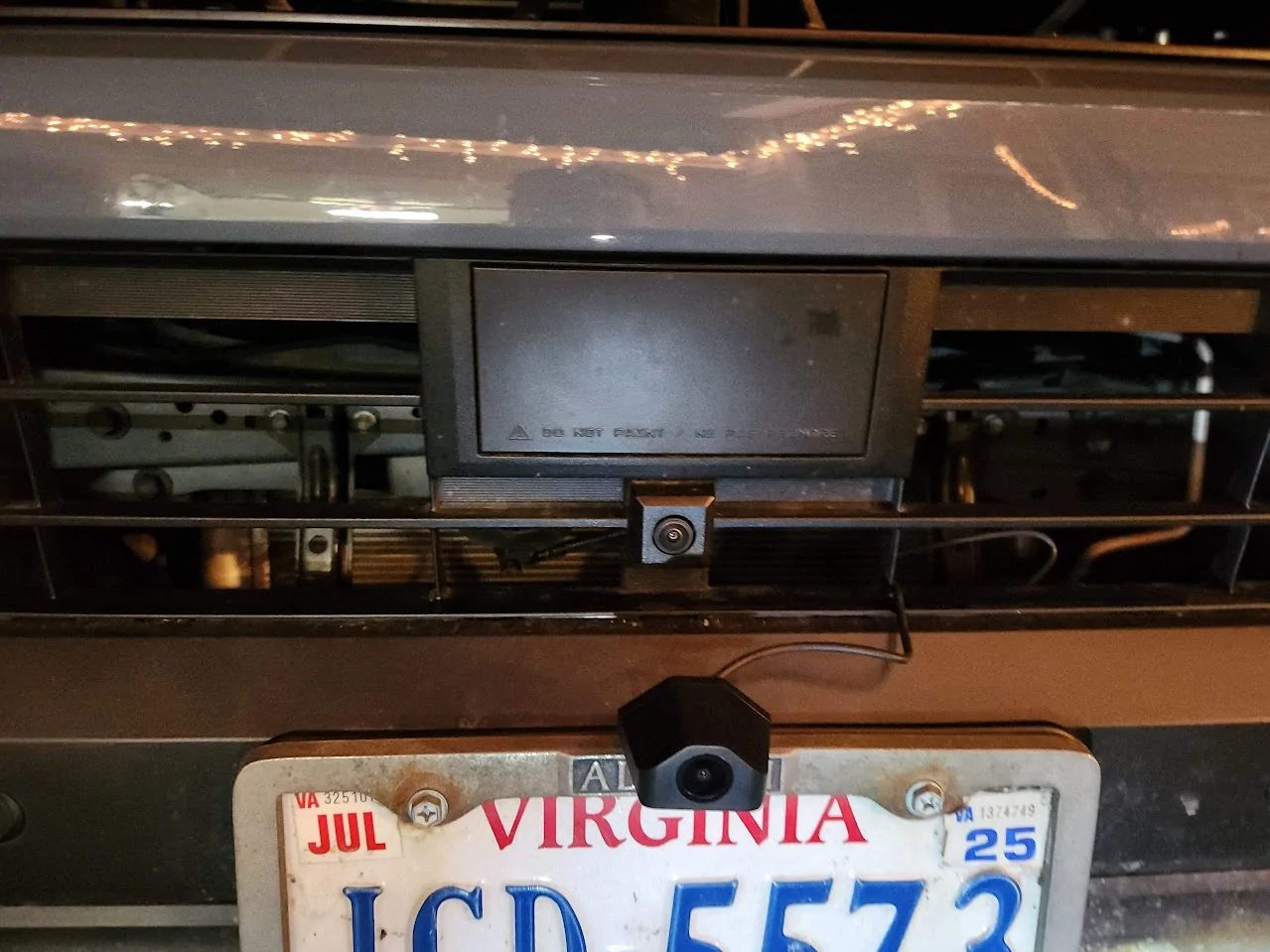

Front camera mounted on license plate bracket (just below OEM camera - yea - ends up interfering)
2025 2026 4runner 6th gen WolfBox G900 Tri-Pro Rear Mirror Camera - MikeD's Install Experience & Review 20251221_184456
12/22/25: Two camera's working. See how bumper cam is in the way of main forward camera view - had a slightly negative impact on auto cruise lane control feature.

12/27/25: Inst Day 4: bumper camera cable repair (attempt unsuccessful (used solder seal connectors) - believe 4th pin needs to have continuity but did not have solution for connecting the shielding)
2025 2026 4runner 6th gen WolfBox G900 Tri-Pro Rear Mirror Camera - MikeD's Install Experience & Review 20251227_160410
2025 2026 4runner 6th gen WolfBox G900 Tri-Pro Rear Mirror Camera - MikeD's Install Experience & Review 20251227_171536

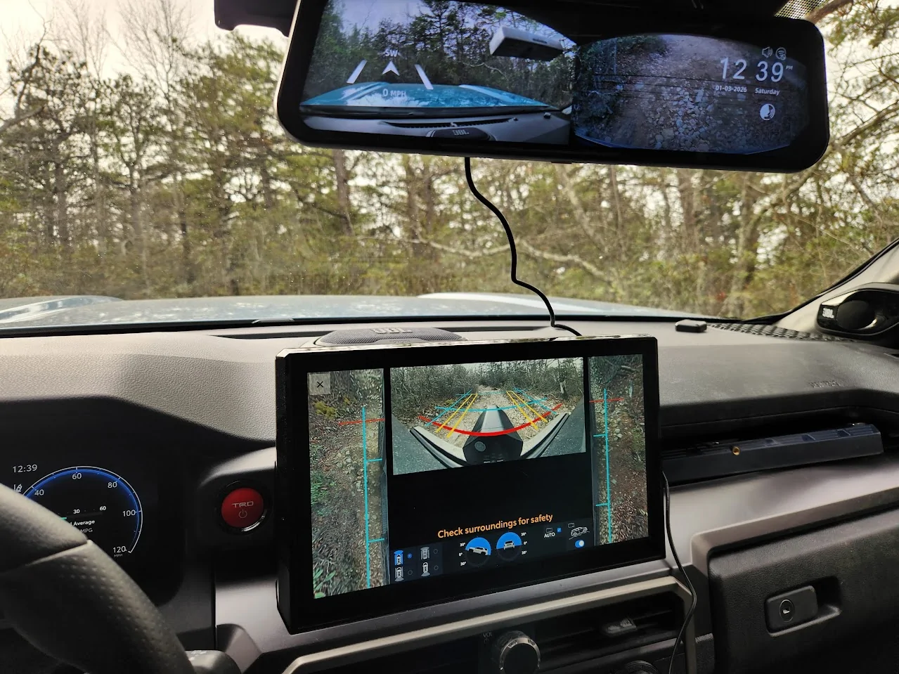

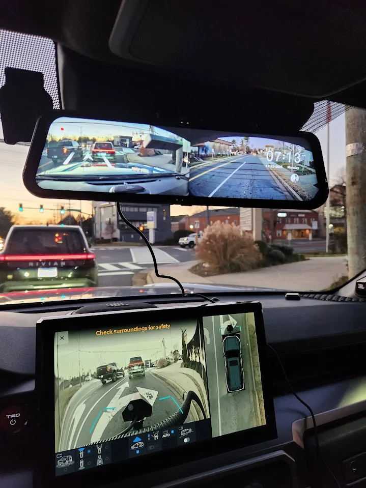

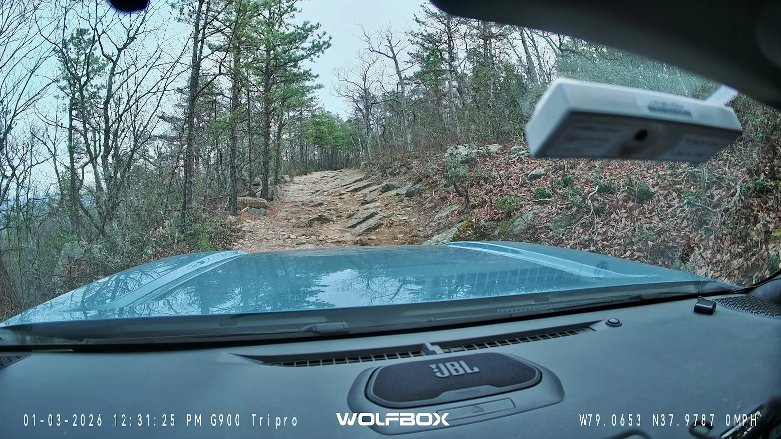

1/3/26: Off road day.
Still shot from Wolfbox mirror camera (think how cool the view from the bumper cam would be:>)
2025 2026 4runner 6th gen WolfBox G900 Tri-Pro Rear Mirror Camera - MikeD's Install Experience & Review 2026_01_03_123126_00_F
30 degree incline view with Multi Terrain Monitor front camera view obscured by Wolfbox bumper camera (and another reason I need to move it). Rear camera looking down at the ground:>)

New bumper cam mounting spot under license plate - avoid interaction with Toyota front camera and radar sensor.
2025 2026 4runner 6th gen WolfBox G900 Tri-Pro Rear Mirror Camera - MikeD's Install Experience & Review 20260118_120333

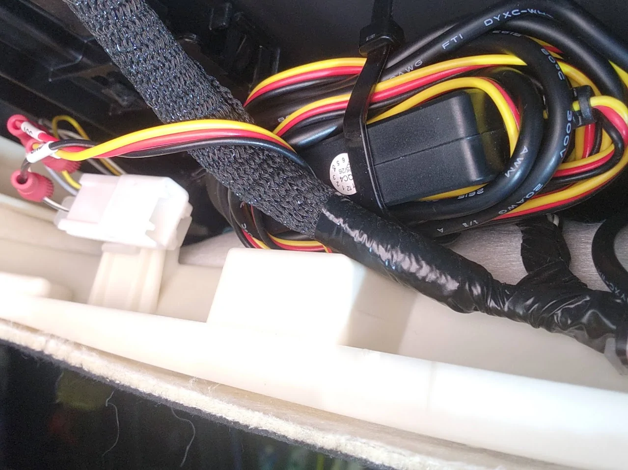

Unfortunately, I failed to take any photos of the PosiTap connection to the power feeding the OEM camera connector. I was able to snap the connector off of a bracket it was attached to and get access to the three wires. ~18 guage, I think. Cut the ends off the hardwire connector kit (red, yellow & black wires as described here: WolfBox Hardwire Kit Installation The PosiTaps I got worked great. I wrapped up all that extra wire that came with the hardware kit and stuffed it in to the left side of the area above the upper console - in front of the connector.
Will suggest again that a custom 6G4R solution that comes with less wire and the connector that goes into the existing connector that is MADE for this purpose would simplify things substantially (like this one: FitCam toyota connector )
Updating to show my power connection setup using PosiTaps. They DID work great but the power connection failed after a few weeks so I have ordered the FitCam toyota connector and hope the small PosiTap holes in the small wires (which I taped over) are not creating a permanant problem. We shall see. UPDATE: FitCam will not sell me the connector part without a FitCam order (Huh?) so looking for the connector - would hate to cut it off my OEM mirror but might have to do that.... Unless anyone knows how to find that connector that FitCam won't sell me??

Do you have the replacement mount product #?
I have mine mounted on top of the OEM digital mirror and it sticks out so far I can't fold my visor up.

I don't think that is for the digital mirror in the Pro. Digital mirrors are mounted with screws. I sent a message to Wolfbox, I'll post up what I find.
Apologies if I'm completely misunderstanding you, but I'm pretty sure my ORP digital mirror is the same as in the PRO. And this mount ( WolfBox OEM Bracket for G900 ) is what came in the package that let me replace it with the G900. See the photos of my install showing removal of the OEM digital mirror and the slide-on bracket.
First photo below shows the screw bosses for the OEM. That part slides onto the slide on bracket in the next photo. Once its slid off the WolfBox part can slide on.
2025 2026 4runner 6th gen WolfBox G900 Tri-Pro Rear Mirror Camera - MikeD's Install Experience & Review 20251221_144803
BUT, as I said in my recommendations for improvement, the Wolfbox OEM bracket is clunky and not smooth like the Toyota mirror mount. Once you find the spot to make the mirror work as a mirror it is fine, but its not smooth getting there. (And I hate having this expensive, well made Toyota part sitting on my desk doing nothing but I wanted to work through the use of this WolfBox product - which for the price is a great deal (especially for someone who didn't get the digital mirror like we did.)
