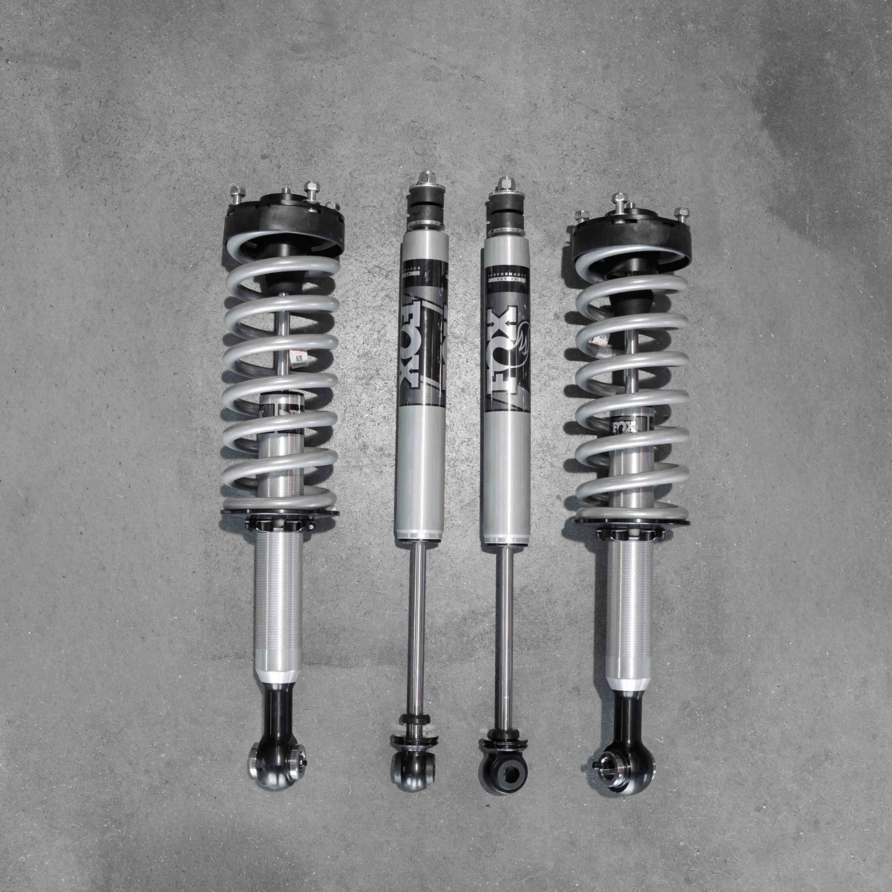

Updated with install video:
Hey guys!
Fox has released their 2.0 Performance Series shocks for the 2025 4Runner and we picked up a few of their first sets. We recently installed them on our SR5 and will be posting an install video on youtube in the near future.
If you're familiar with the Fox 2.0's, not too much has changed. They're still an impact extruded aluminum body IFP shock with 5/8" shafts. They redesigned the tophats in a similar manner to what is found in the 24+ Tacoma / 25+ 4Runner where they are using a captive bonded bushing which runs longitudinally rather than the loose horizontal sandwiched poly bushings with washers at top and bottom which they've used historically. The coils are now a 3.75" ID coilover coil, rather than 3" ID like used previously in other applications.
I'm a big fan of this series of shocks and have used them in a number of different applications. The fit and finish is really nice, and they use o-rings at the lower coilover mount to seal the spherical bearing from dirt and grime. They are rebuildable and revalveable (as long as you or your local shock builder have the specialty tools to do so). I really like the internals on these shocks, everything is clean and really well machined. They use a bleed shim rather than ports drilled into the piston. I also like that they use poly bushings to isolate NVH from being transmitted to the chassis vs the bigger race-inspired shocks like Fox 2.5 Performance Elites, King, Icon, ADS, etc. I do a lot of highway miles for tradeshows and expos and from experience NVH definitely adds to driver fatigue over long distances.
I've put about 4k miles on them already and they are a significant improvement in ride quality over the factory SR5 shocks, which felt too firm on compression and too light on rebound. They'll be my primary shocks over the next couple years. I may play with the valving at some point as my build progresses, but at the moment I don't feel like any changes need to be made.
Out of the box, they lift a hair over 2" in the front. If you installed them as-is, you'd be dead level if not a hair nose-high. If you wanted to upgrade and keep factory height in front, you'd want to move the preload collar down about 1" from where it sits. Otherwise, you can add a lift coil or spacer to the rear to keep a little rake.
2025 2026 4runner 6th gen Fox 2.0 Performance Series Shocks installed on 6th Gen 4Runner SR5 6th-gen
