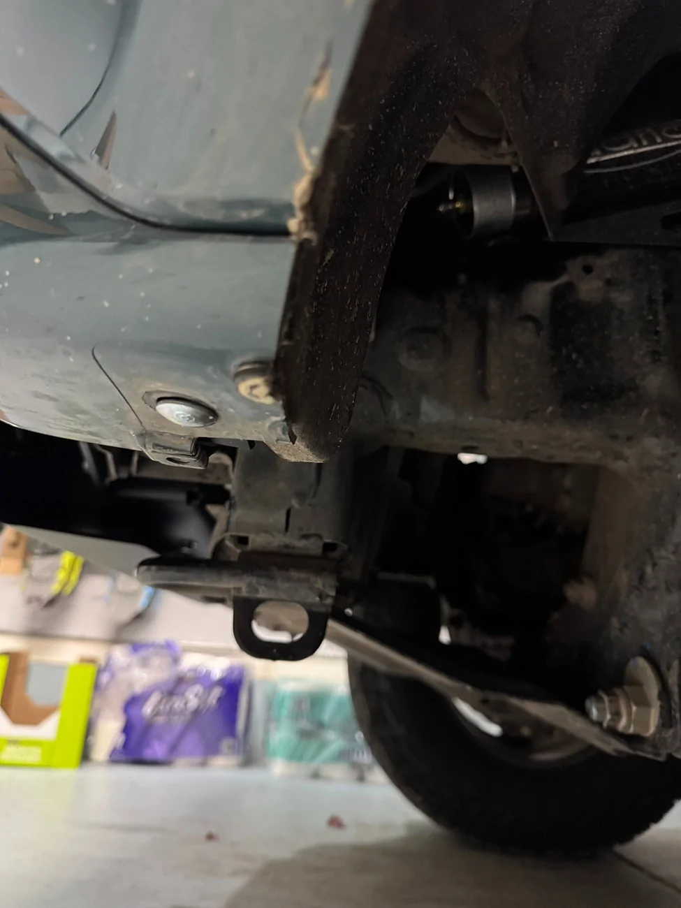

Those 35s look right at home. Did you have to do any trimming in the front?
Minor trimming on forward-facing plastic flap behind the wheel well liner where it protrudes into the tire path. This is the most common rub point at full lock. Use a heat gun to soften and a Dremel/reciprocating saw for clean cuts. Also removed factory mud flaps on front wheel wells (kept rear mud flaps).

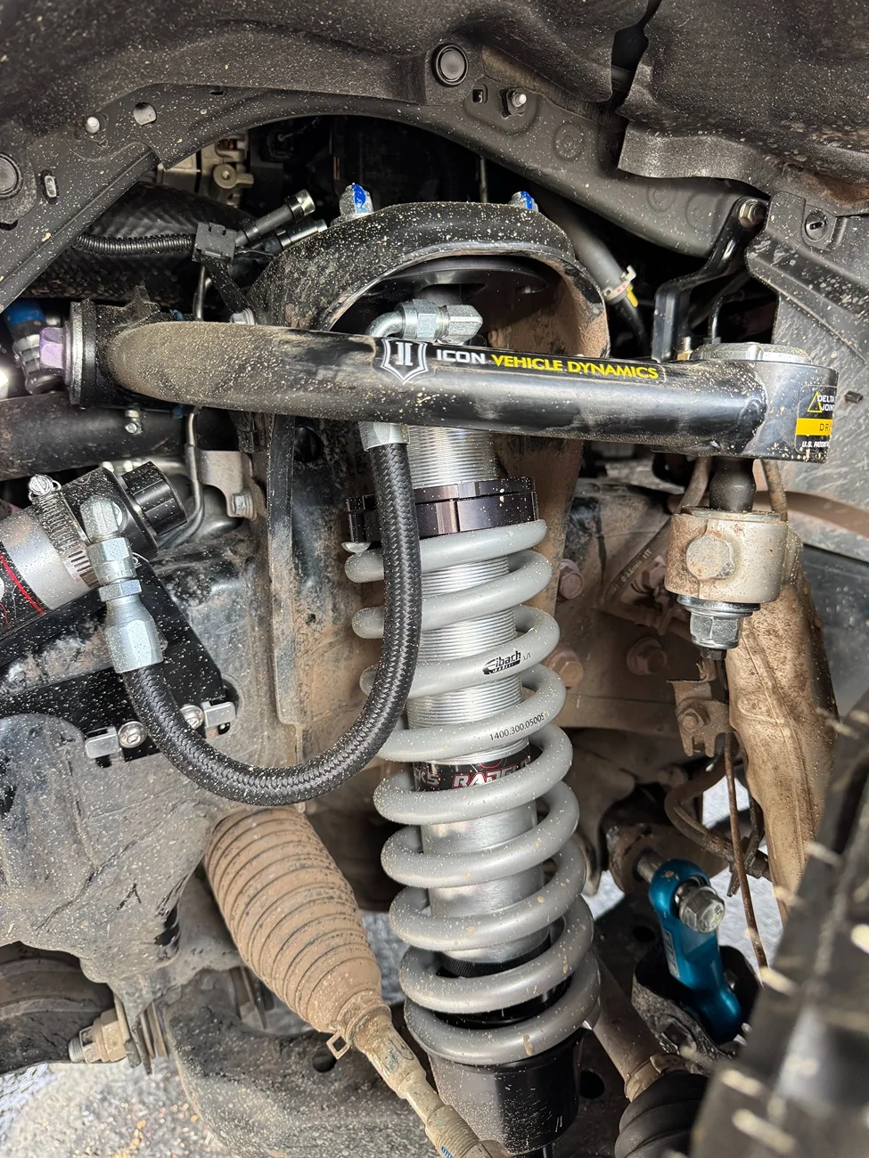

Very nice build! I'm looking at something similar. Same CBI bumper. Trying to decide what suspension to swap. OME MT64 2135K, ICON 2.5 Stage 8 (as I like the adjustable compression) and I've looked into the RadFlo 2.5. I'll be curious how you like the Radflo's?
JuliusBrown
Julian
Mar 25, 2025
42
Denver Colorado
Jeep 2020 Trailhawk
I like the Radflo's but I'm not sure I love them. I'm glad I did not go with a spacer lift (as I get the long travel) but the Radflo's are not as plush as I hoped for. Maybe they will open up in time. The stiffness is likely due to the preload and higher spring rate they used to get the lift and handle the weight of winch, bumper, & sliders.
