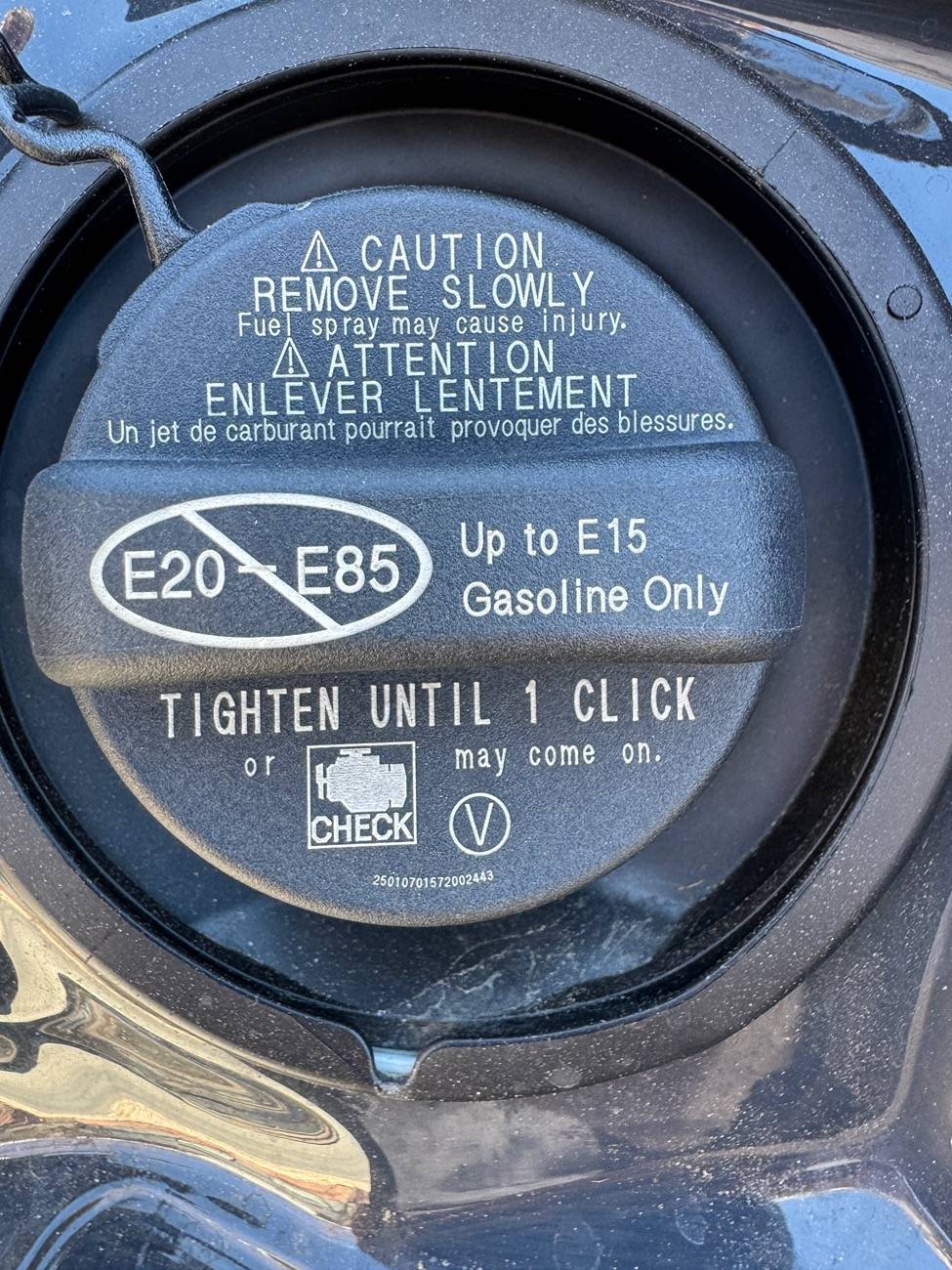

To make a point, you shouldn't be using 85 octane in turbo charged cars at altitude.
It's fine if you're running around town doing 2-3k rpm tops, but up in the mountains under load you can suffer some serious engine problems.
I'm planning on using 89 or 91 octane exclusively.
Is stick with what the gas cap states

Sure, like the video says.
Not a problem in day to day traffic in Denver when you're barely putting load on the engine while commuting.
But putting 90 - 100% load at altitude in a turbo car may cause problems.

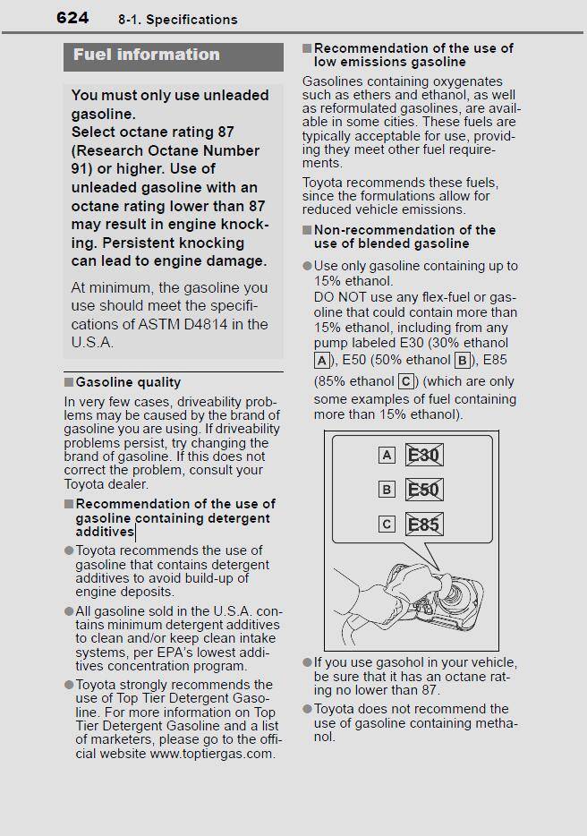

Owners manual says minimum 87 octane, regardless of what the fuel cap says.
Toyota can and will void your warranty should you cause a problem, if they wanted to - just like Ford explicitly will if you're putting 85 octane in your 3.5 Ecoboost.
85 octane has no place in a modern vehicle, it's a cheat devised in the 1960s - as your AI synopsis states.

I heard that the new 4 runners require premium fuel as stated in the owners manual and it is quite a bit more expensive where I live, but also living in the mountains I was always told this: Due to lower air density at altitude the running compression ratio is lower than the mechanical ratio and lower octane is sufficient to prevent detonation so 85, 87 and 89 octanes at several thousand feet do equate to 87, 89 and 91 at sea level.
I'm curious where the manual states that it requires premium fuel?
