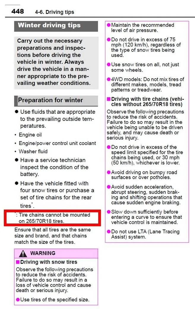

What tires did you have? Were they 4 peak snow rated? Most of the tires Toyota puts on the new 4Runner are not snow rated and Toyota also says you can't put snow chains on tire size 265/70R18 which is the standard size for the OR and ORP.
Is that in the manual? I don't remember tripping across any recommendations related to chains, but I will look for this later
Below is the page from the 2025 4Runner Owner's Manual with the information about not using tire chains on 265/70R18 tires which is the OEM size for the OR, ORP, Trail Hunter and Pro. The ORP is delivered with Falken Wildpeak A/T3W A 265/70R18 SL tires which do not have the 4 peak snow rating and the SL load rating is for Standard Load with no extra reinforcement, thus not a reliable off-road tire. What is needed is the BFG KO3 LT265/70R18 with a C load rating. Proven very tough for off-roading, 4 peak snow rating, and great reviews. BFG has this size with a very stiff E load rating. Sometime in 2026 BFG plans to release this size with a D load rating. Their schedule for releasing more tire sizes/ratings does not include this size with a C rating which would provide a less jarring ride than the E and D load ratings. We need to get lots of people to get BFG to add the 265/70R18 Load rating C tire to their plans for the KO3.
Thanks. That's interesting. I don't think I've ever seen a stock vehicle not recommended chains. I've got a set of KO3s and a set of KM3s for my Jeep. I've been impressed with them in ice and snow. I'll put some freeway miles on the 4Runner stock tires this summer before I get new ones, but KO3s are probably what I'll get.
