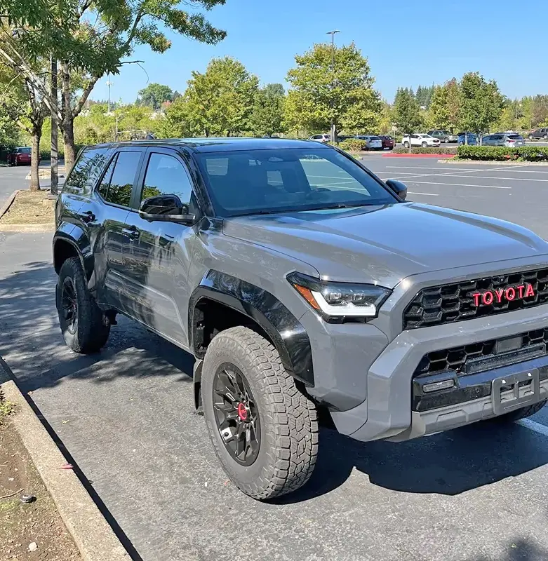

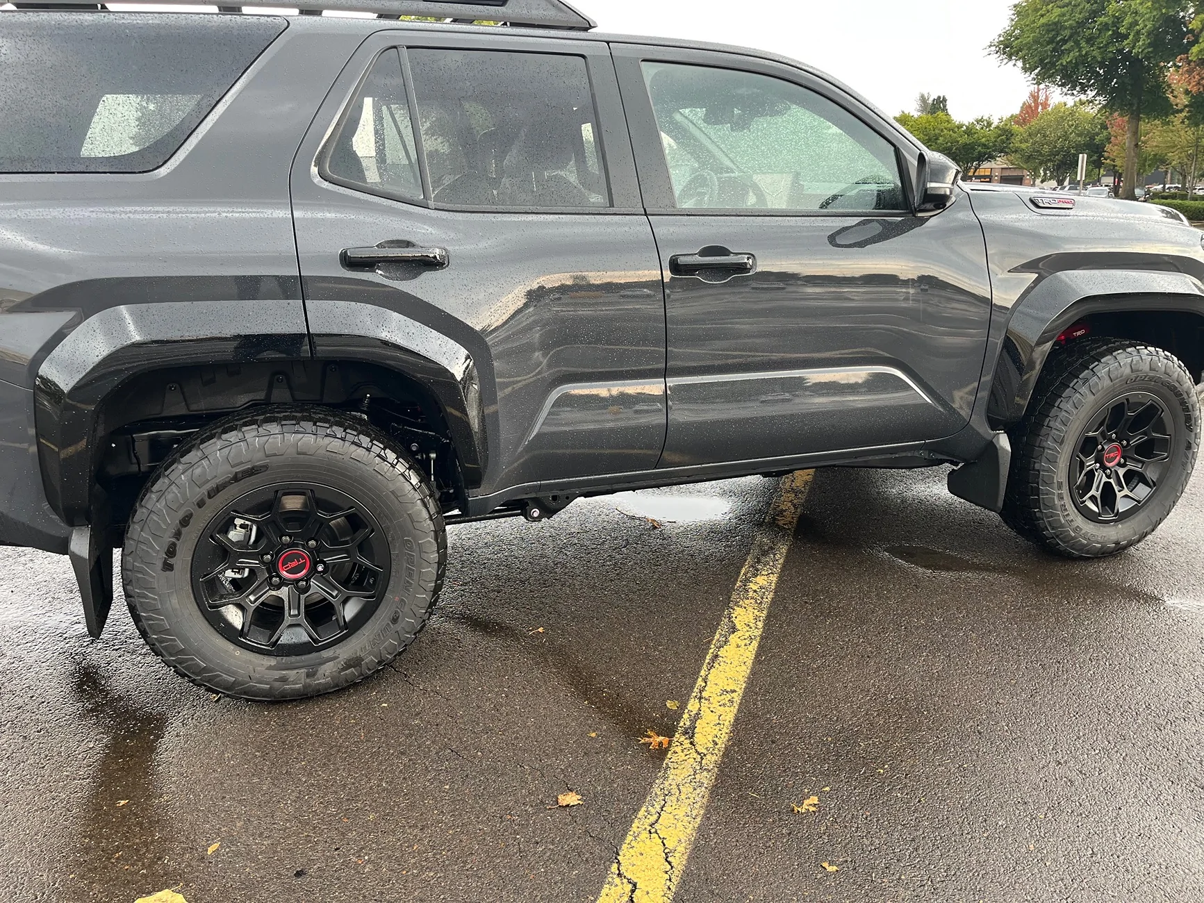

I decided to remove some things asap.
Steps gone. Hood swapped. Roof rack is back on for now but it’s coming off again.
For what it’s worth, the brackets for the roof gutter clips are the exact same ones used for the 2025 LANDCRUSHER so if you’re looking to clean up the roof then you gotta get those parts. Toyota didn’t have a listing for the pro on their schematics at the time I made the call.

Curious why swapped the hood? You selling it?

nice! trd sport tag on hood, original? (or where did you get it from?)

Looks good nice and clean. I've been thinking of taking those roof rails off as well. But I was stumped because after removing them aren't you left with a gap where the rail sits? I'm guessing that's what you're referring to as the part for the Land Cruiser? Thanks in advance

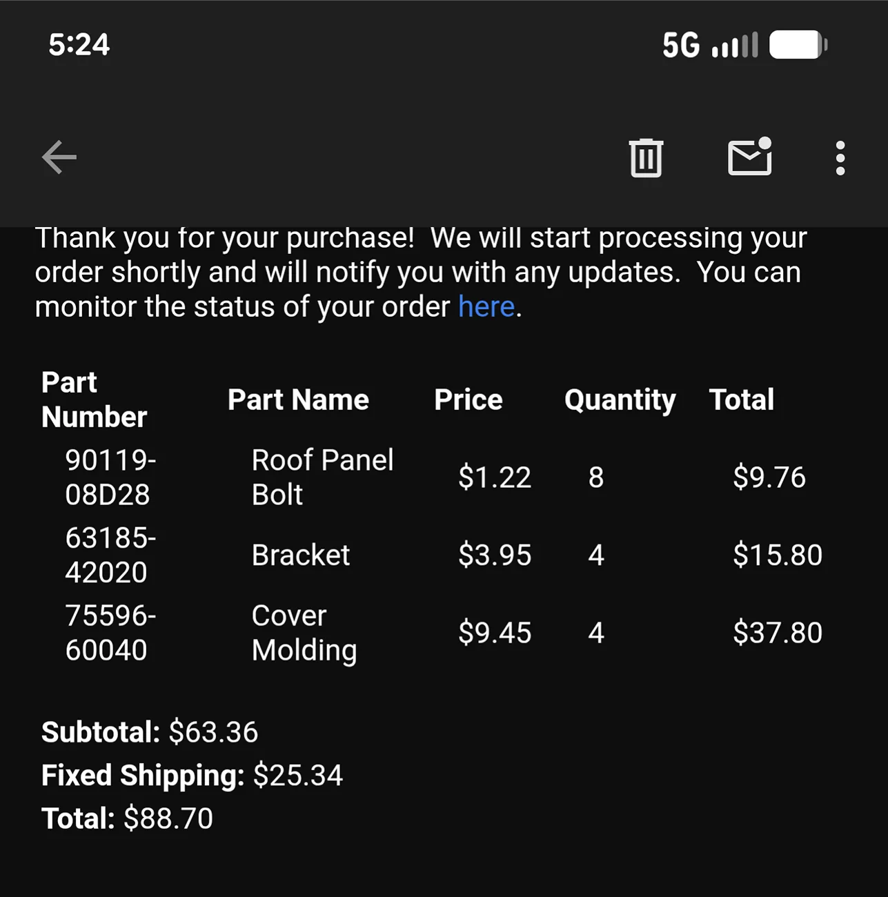

Roof rack Delete Kit below as per other member!
Didn’t like it. Another owner wanted it so we agreed to swap hoods months ago
Yes. Exactly. Yota Expeditions on YT has a vid on the parts needed.
no, swapped hoods with another owner of an sr5
Much like the others, what you doin with that scoop hood? I'm in Oregon as well.
swapped it with another owner of an sr5

Looks very clean. I like it very much. Good job!

Thanks! It was one of my goals from the beginning. Wanted a trd pro, didn’t want all the flashy cosmetic crap. Just got my recovery points (black) in the mail yesterday. Next is the ARB air single motor brushless compressor since the twin is too large for the engine bay (driver side. Trust me, I sized it up.) Need a flag for the Oregon dunes and then off to have lots of fun.
