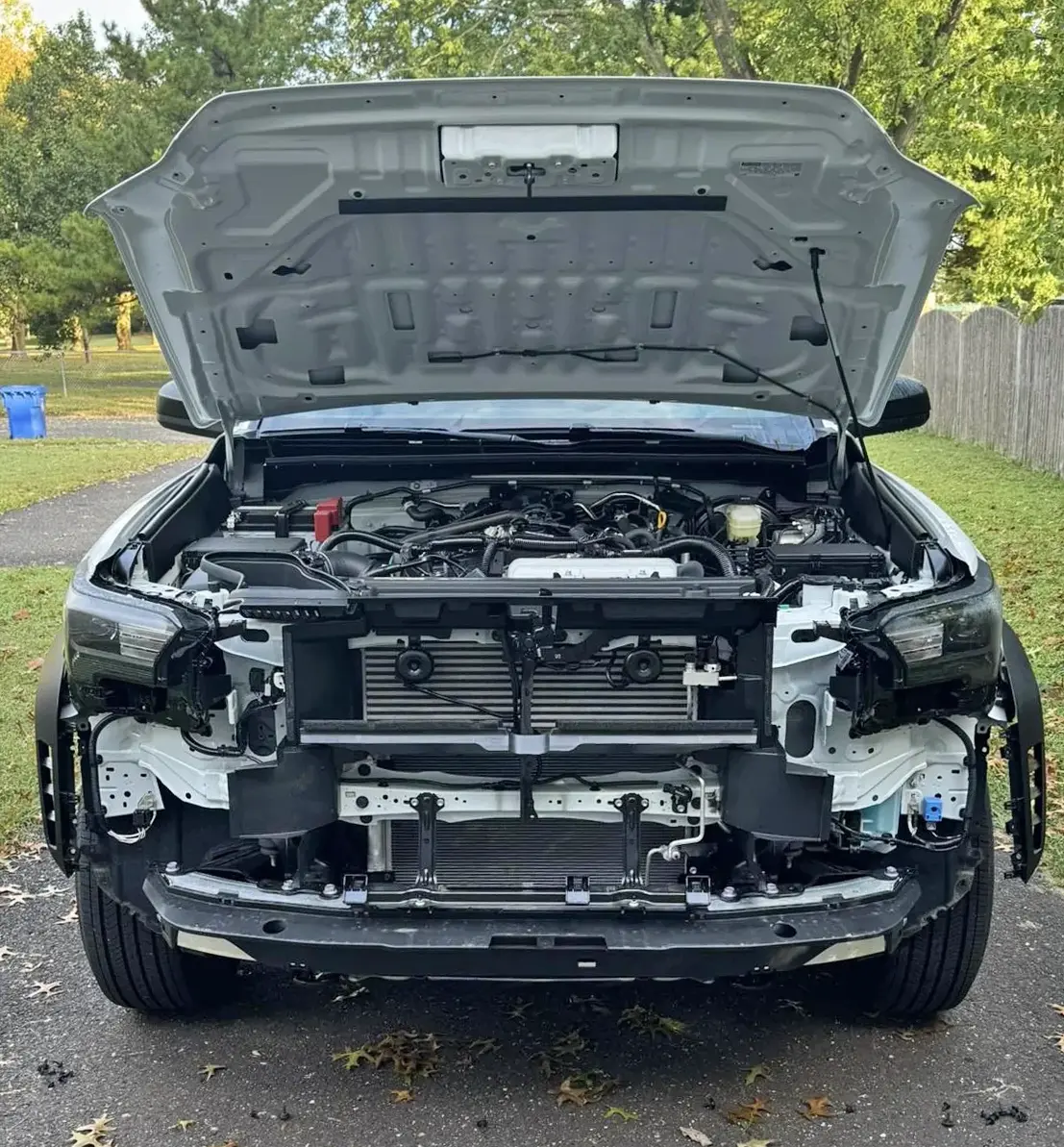

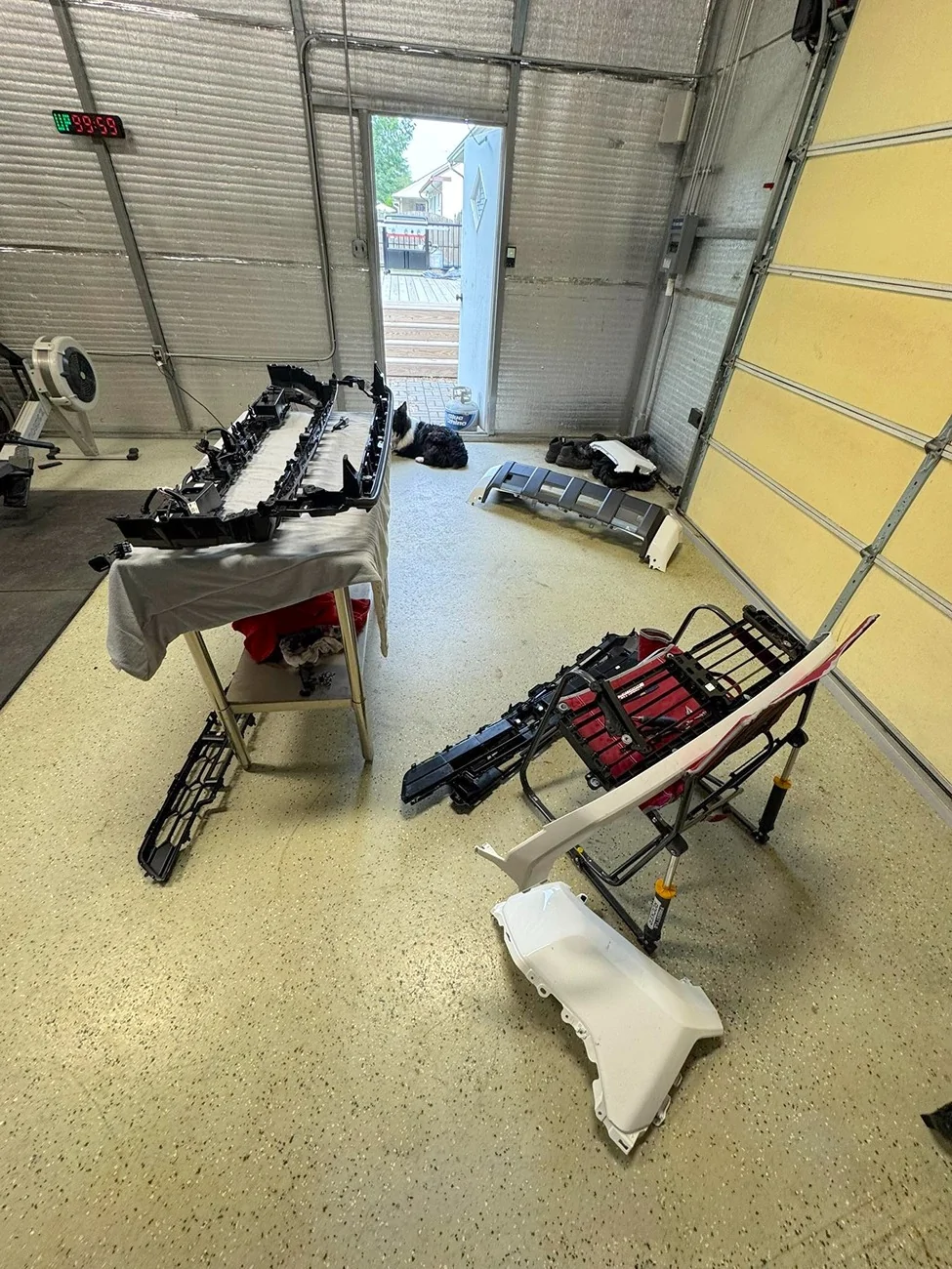

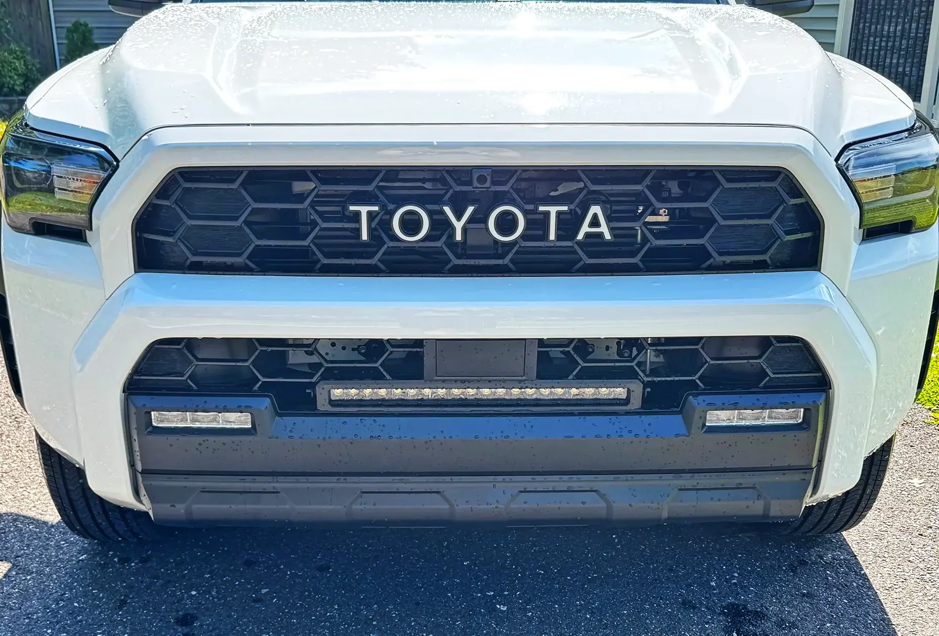

Wasn't as bad as it looked watching the swap on youtube. Got the white ‘TOYOTA’ overlay letters to match, installed Rough Country 20” LED light bar with the Rave bracket.
Upper grill OEM part number 53101-35160
Lower grill OEM part number 53113-35030
2025 2026 4runner 6th gen TRD Pro/Trailhunter Heritage Grille Swap (Upper & Lower Grill) on SR5, with part numbers TRD Pro:Trailhunter Heritage Grille Swap (Upper and Lower Grill) Complet
2025 2026 4runner 6th gen TRD Pro/Trailhunter Heritage Grille Swap (Upper & Lower Grill) on SR5, with part numbers 2025 4runner TRD Pro:Trailhunter Heritage Grille Swap (Upper and Lower Grill) Complet

wow, did you install it yourself? I'm thinking about doing the same thing. How is that RC light bar, is that the
RC: 20 Inch Black Series LED Light Bar- Single Row
Rave: Universal 18-21" Light Bar Mount for 2025+ 4Runner Grille

Yeah I did it myself, took about 2 hours taking my time. And yes those are the light bar and brackets I used.

How was the camera relocation. I read you need a new cable, is that true?

Oem part number PT948-89250-15

You do not need a new cable. You can cut the existing one out of the existing harness to reroute it but buying another cable eliminates that step. You just leave the OEM cable in place and install the new one to the new location.

For me I wanted the lightbar. I needed more forward light and the OEM setup is the cleanest way I've seen it done. I also don't like how the non pro lower wasn't the same pattern as the TRD trims. This way it all matches. And lastly, I couldn't see doing the work to swap the top and not just doing the couple more steps to do the lower.

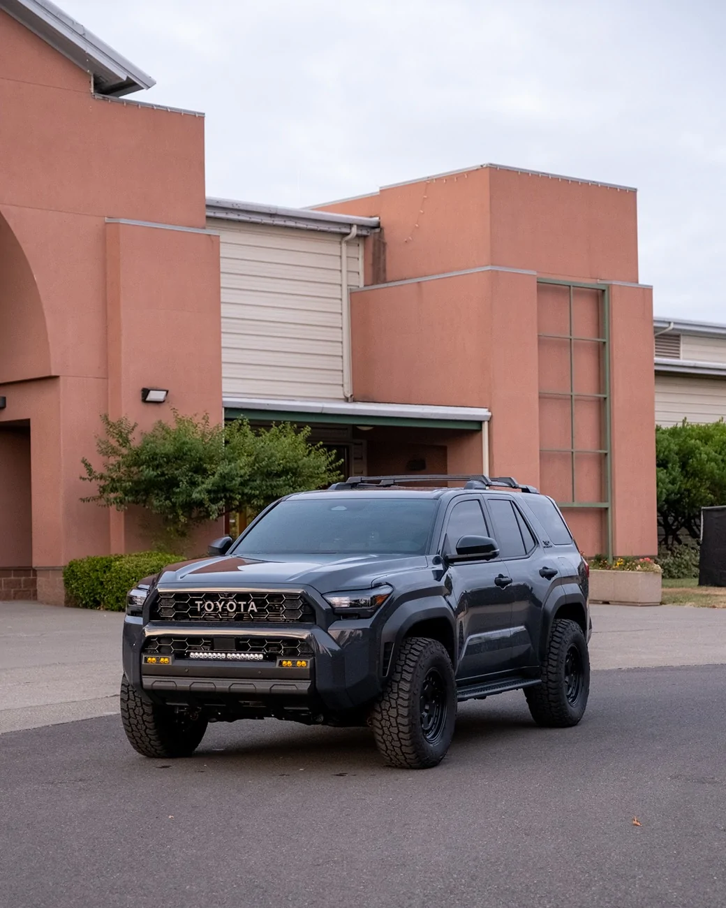

Any pics or thoughts on the rough country light bar for this use case? I keep eyeing that one but stick between that and a pro diode dynamics ss20

Agreed. This looks amazing. I’m even digging the double dual look in each oem fog position. Wish diode made a kit like this. Wonder if it would look stupid if I ran one white and one amber c2 on each side. 🤔
