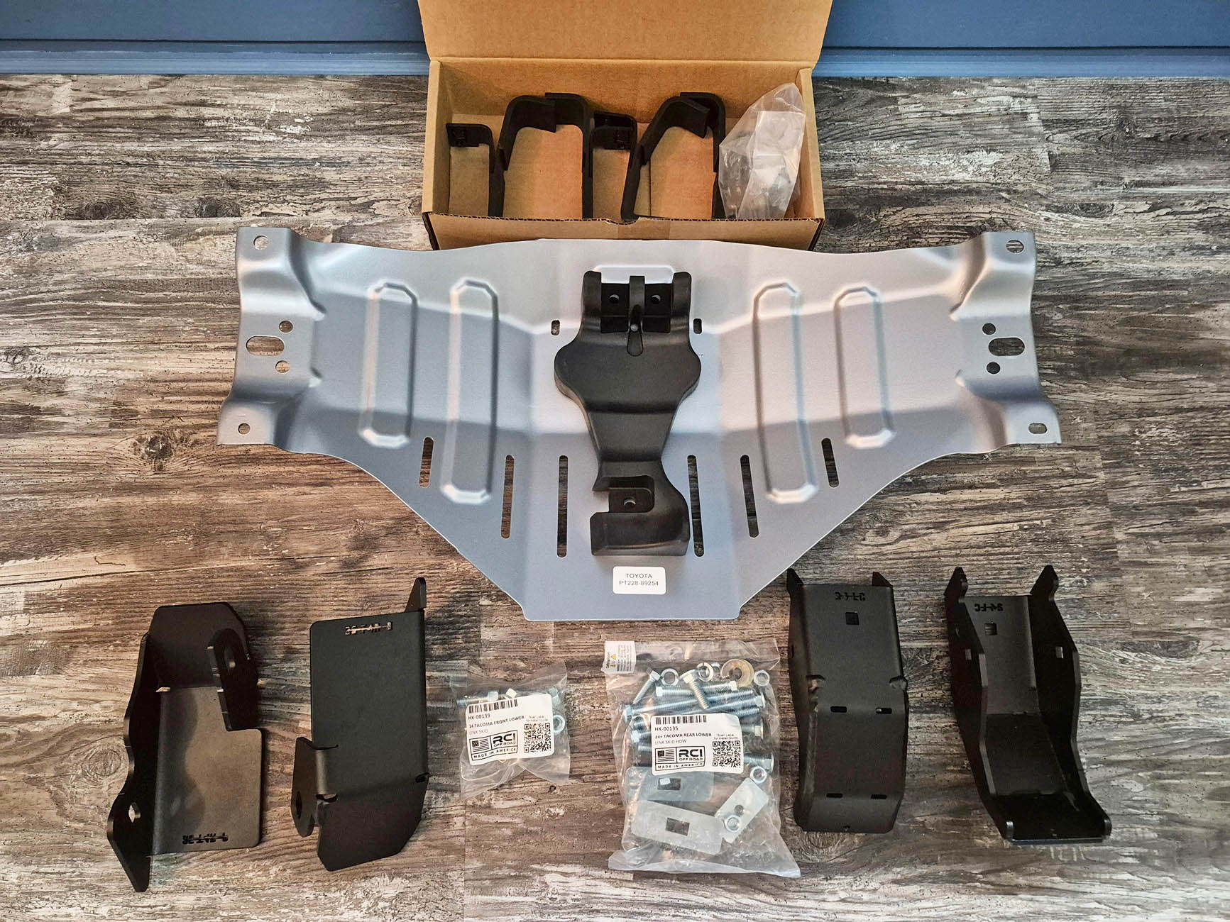

Part# and cost for the differential plate? I just installed the front TRD skid on my ORP yesterday and was considering adding the differential next.
NM, part# is PT228-89254 and price was only $253 with the sale, nice!

Sorry if I missed it but who makes the trailing arms skids ? is it RCI ?
Archer
Archer
Apr 23, 2025
735
720
Orwigsburg, Pa.
2025 4 Runner TRD Pro

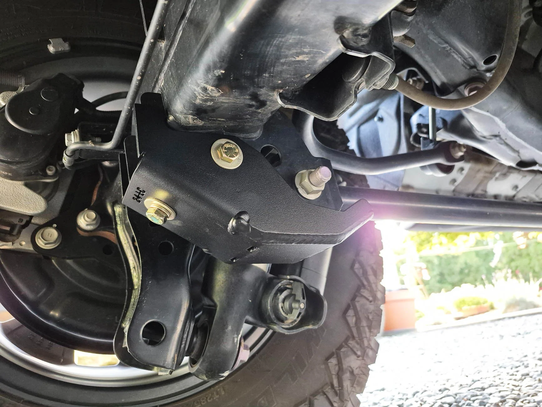

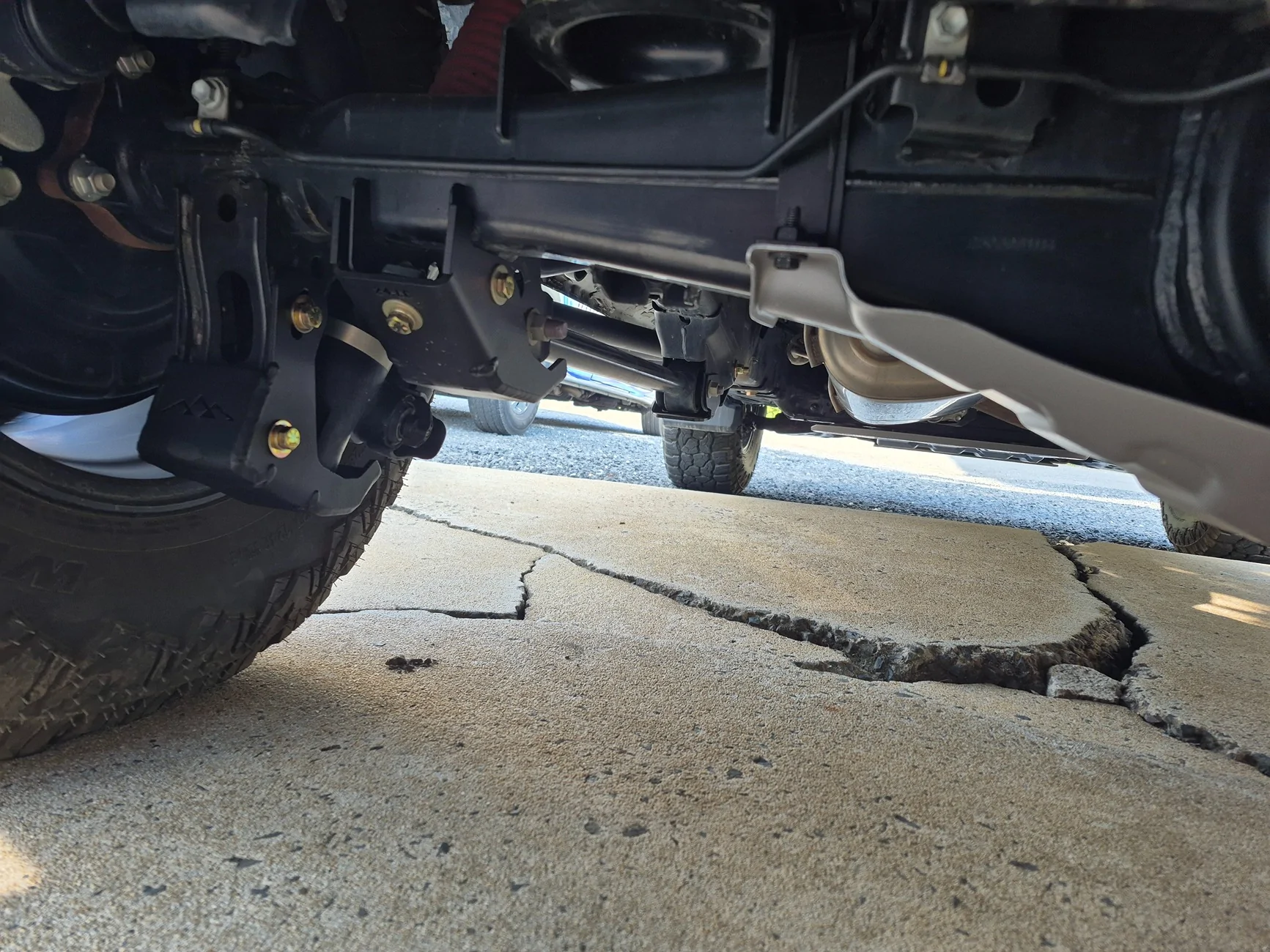

Yes, RCI, everything I've gotten from them is shipped same day and arrives within a few days. Quality is solid. Install, easy.
https://rcimetalworks.com/product/front-lower-link-skids-25-present-4runner/
https://rcimetalworks.com/product/rear-lower-link-skids-25-4runner-24-land-cruiser/
https://rcimetalworks.com/product/rear-shock-mount-skids-25-4runner-24-landcruiser/
hoping these fit the Fox shocks on my Pro.
https://rcimetalworks.com/product/a-arm-skid-plates-25-4runner-24-land-cruiser/

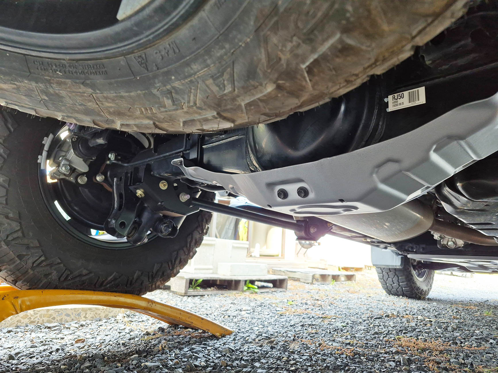

To Tarekieth:
Just to clarify for you before purchase…
Do you have hybrid or non-hybrid? The 254 is for non-hybrid.
PT228-89253 -
TRD PRO/TRD OFFROAD/TRAILHUNTER HV Models
PT228-89254 -
ALL Gas Models and LIMITED/Platinum HV Models

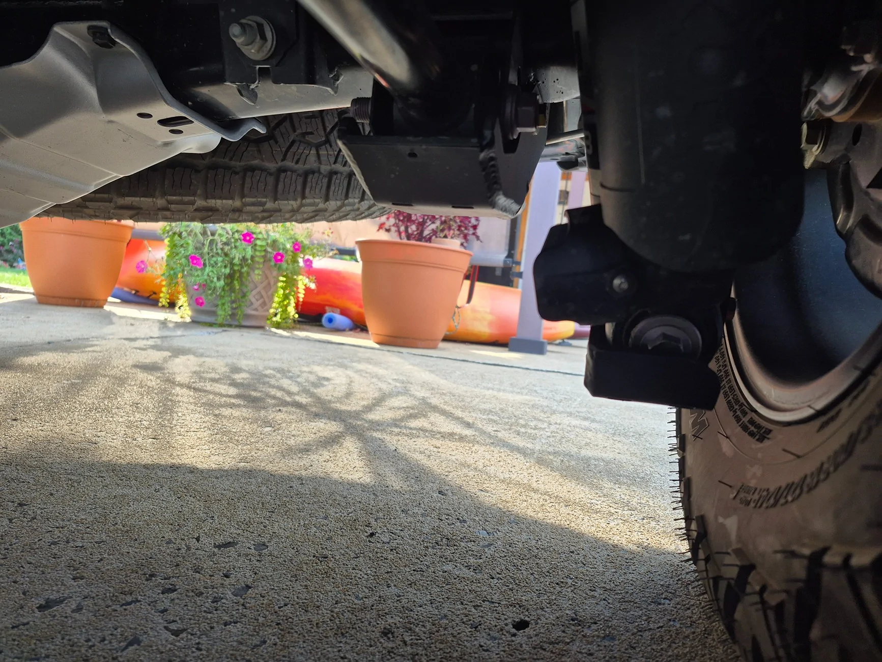

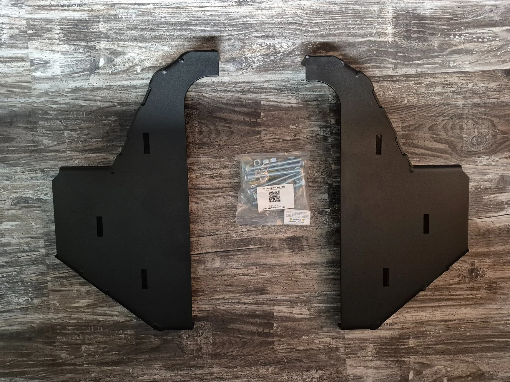

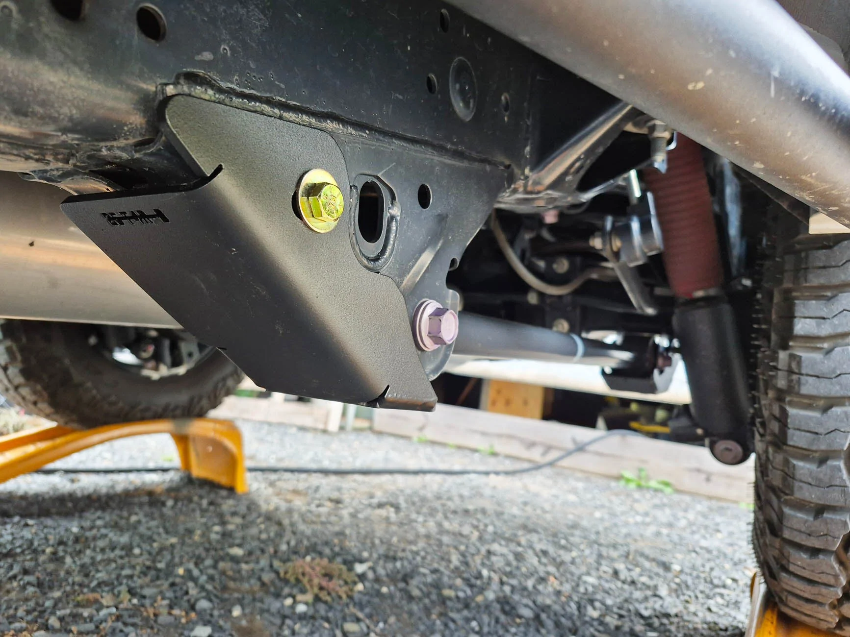

Got the shock skids installed, tight fit and minimal ground clearance lose. Only complaint is the Grade 5 hardware, had to replace it all with grade 8. Ran out of time to get the LCA skids on, hopefully find time tomorrow.
