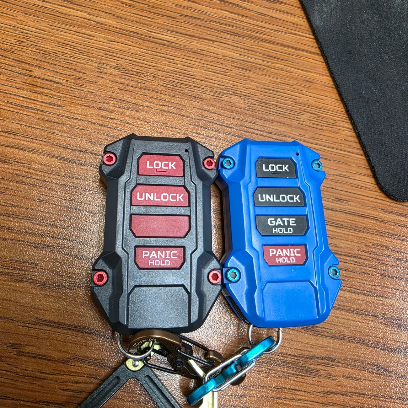

i have a ajt design fob, that conveniently gives you the option to blank out the button for the rear door open.
also turned off any ability to open the rear door remotely outside of pushing the button to open.
so you can decide which avenue to take to ensure you dont accidently open the rear hatch

I have (minus the scrape and gouge!). I found it open once when I came out of a business I went into--not nice having wide open in a public parking lot. I know it is the key fob. As I recall that can be disabled but, for some reason, only the dealer can do that (probably carista but never checked). I have been looking for another option (thanks, @Nodak, I had not found that one). I thought of 3d printing a housing or guard of some kind. I would prefer it to remain accessible in the rare cases I need it but unable to hit inadvertently, but permanent disable is ok too. I did try a silicone cover as someone at my dealer suggested, but as I suspected it probably helps a little but not much. I have mine in my pocket most of the time and at some point it will be pressed.
