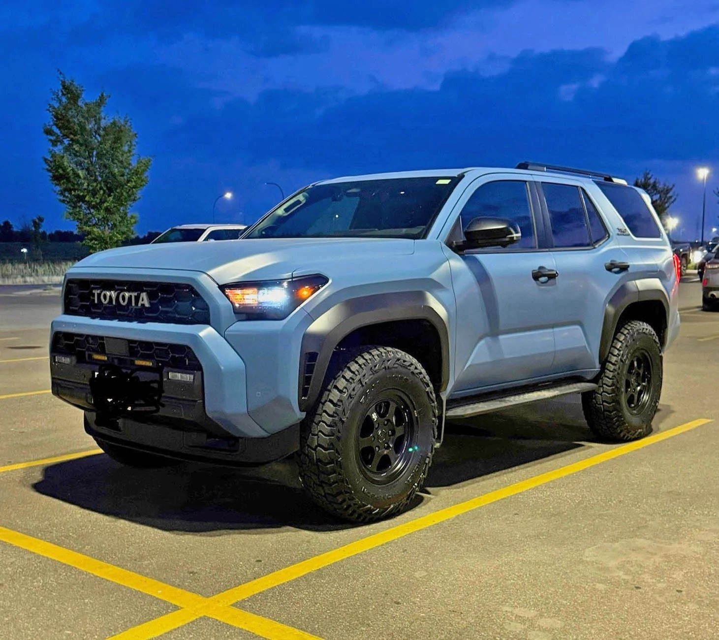

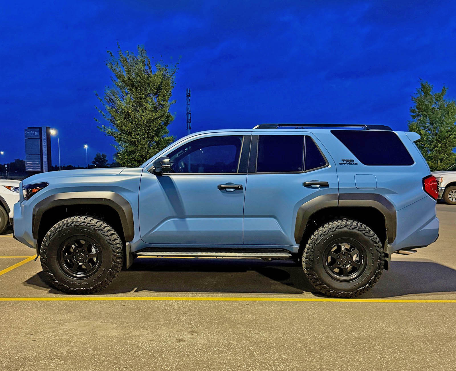

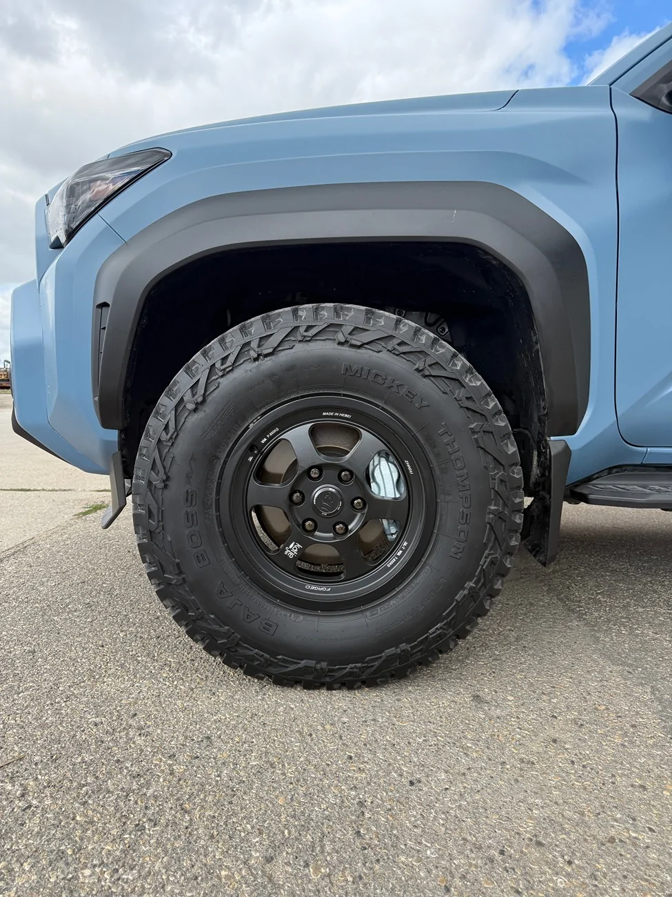

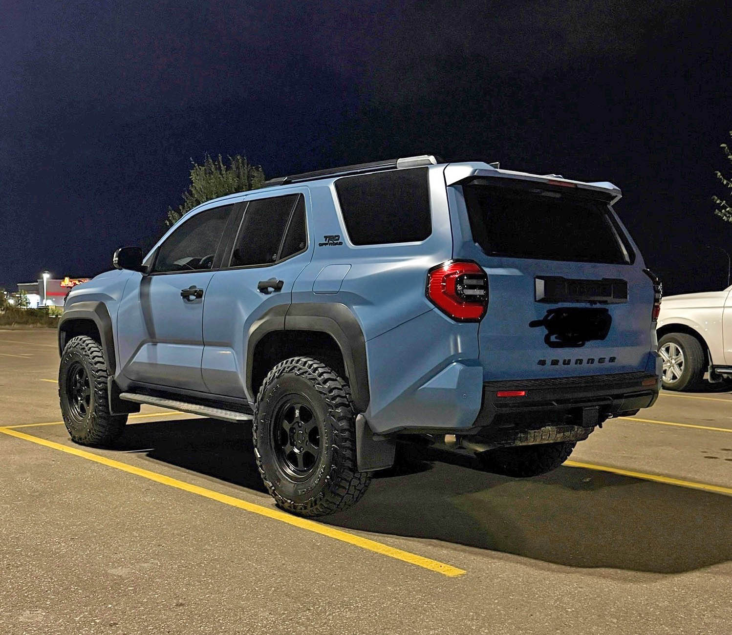

Yeah! That video swayed me into pizza cutters.
Running 255/85R17 Mickey Thompson Baja Boss R/T tires
34.5” x 9.9”

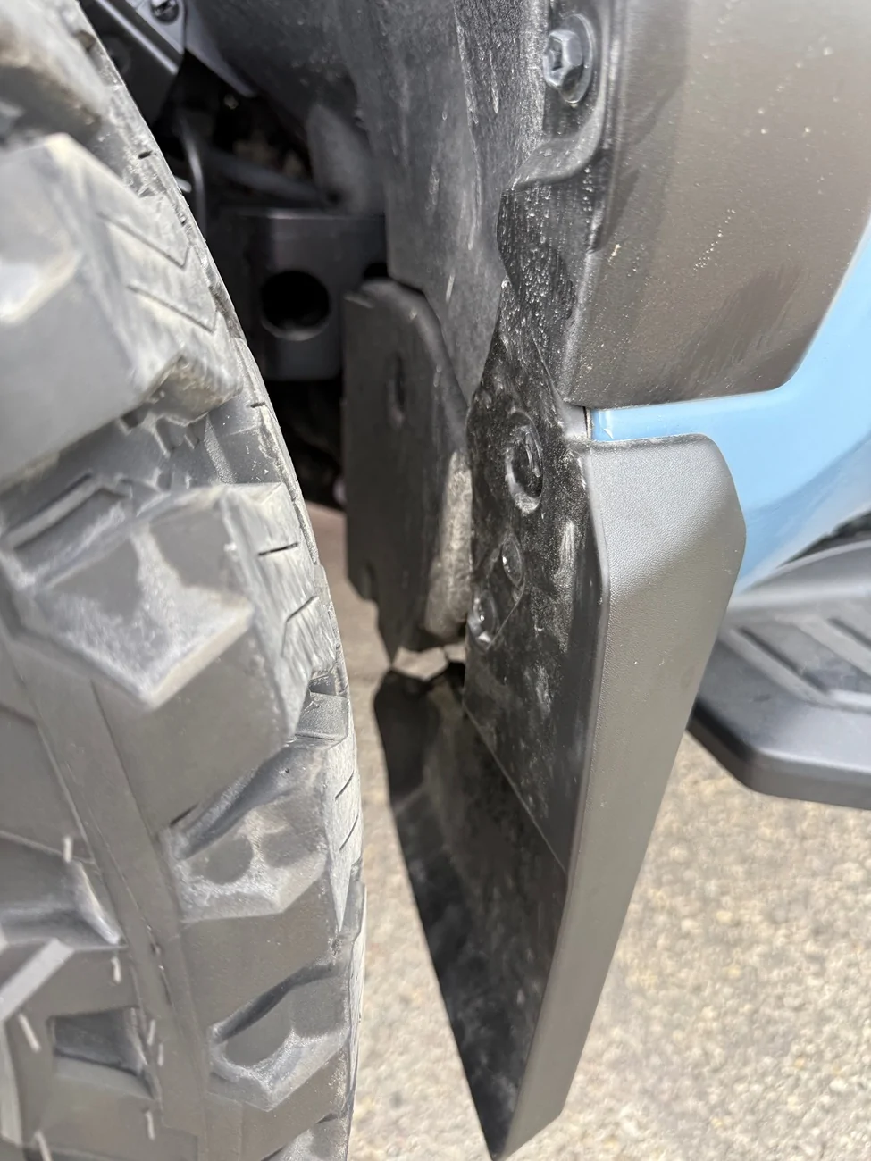

Only had to trim mud flaps to fit. Caster 3.1 degrees

Sweet ride! I've got a blue ORP as well.
Man I don't know how many times I've compared sizes/weights/load rating for the Baja Boss ATs. I wish they made some C loads in more options. How are you liking those pizza cutter 35 E's? Quoted at 64lb which is much lighter than than 315/70/17 (71), 295s (72) and only 1lb more than the 285's (63) which is only a 33" tire. The standard load 285/70/17 is only 48lb but less durable and less aggressive side biters/shallower tread so I'm a little more concerned with that.
I would love to know any changes to:
- fuel economy
- ride quality
- by "fit" I assume no run at full lock and suspension stuffed?
Thanks!

Went from 21 mpg in city to 18.9 (I didn’t account for difference in circumference. So likely the mpg is better than what the dash said)
Ride quality is great!
No rub at full lock, small trim on mudguard, got to keep them on so I’m very happy!
If you’re thinking about it, get them.
It was this or Toyo C load 34x10.5 or 285/75/r17.
The narrowness on these tires allow you to fit a 35 with almost no work to wheel well

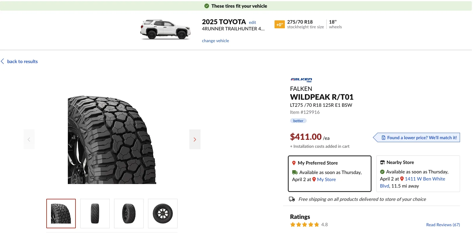

One thing that could get me to go up to 275 is you can get the Falken Wildpeak R/T01 tire in that size. 265 I can only get the AT4W. The BGF KO3 you can also get in D and E load in either 265 or 275.

Two capable choices in the Falken and BFG. Always surprised how heavy those tire can get. I’ve been looking at the Cooper Road and Trail or Bridgestone Dueler Ascent. Want an AT with good road manners but can get me through a mess when needed. Heck, a contrarian pick would be the Pirelli Scorpion XTM. Hear it’s a damn good tire too.
