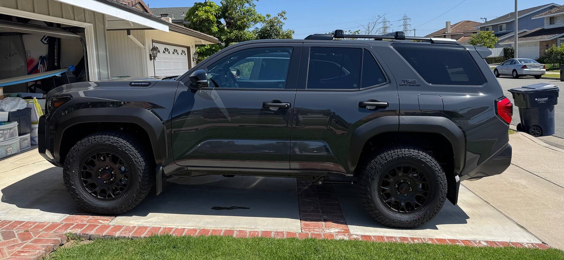

My Off Road Premium Hybrid is 265/70R18 stock (black wheels). Yours are 245? I just put on Falken Wildpeak A/T4W of the same size as stock. I know this doesn’t help you, but I was surprised to read 245 tire width on yours. Anyway, this is how it looks with 265/70R18 Wildpeak A/T4W’s.
Thanks! Looks great!
I’m not in the US. Toyota sells with different specs here (Chile).
How is the road noise with the Wildpeak A/T4W’s and did you notice a MPG hit ?. I'm thinking of those tires or going a little bigger @ 265/70/R18
Did you go with the E Load (LT265/70R18 124/121S E) or SL load? (265/70R18 116T SL). Looks great.
