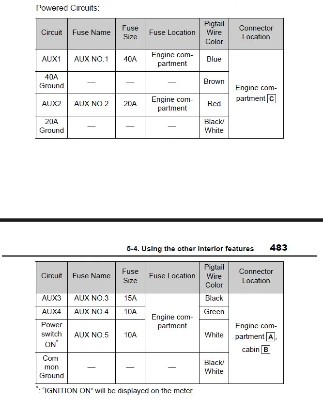

Using the pre-wired auxiliary switches made this super easy. Here are the pages from the manual.

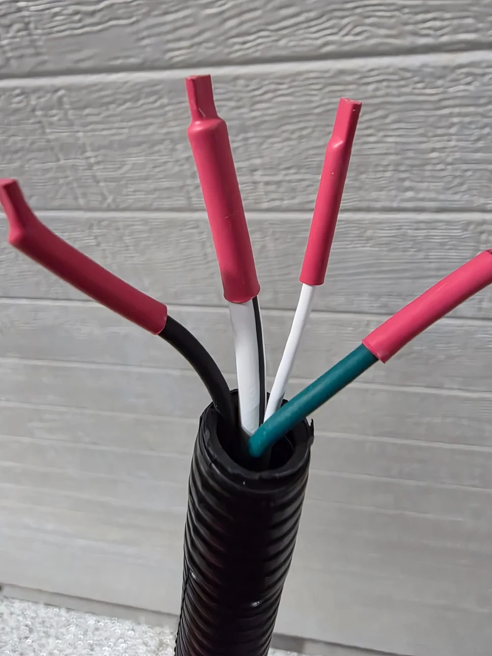

1 - Cut the 2 light connector wires away from the rest of the harness
2 - Connect white to white (hot) and black to black (ground). The pick below is both ends of the light connector wires. Thos are all the connections you need to get power through the OEM pigtail.

3 - Connect the wires to the pigtail of your choice. I used the smaller pigtail, plugged into port "A" near the washer fluid reservoir. I connected white to green for hot and black to black/white for ground. This means I will be using the "Aux 4" switch which has a 10A fuse. I'll use the other switches for bigger or more power hungry equipment later.

(If your lights have a backlight function you'll typically have 2 hot wires and a ground. If that were the case I would wire my primary light function to the black wire on the pigtail, the backlights wire to the green wire, and the grounds to black/white. This would give you primary lights on "Aux 3" and backlights on "Aux 4")

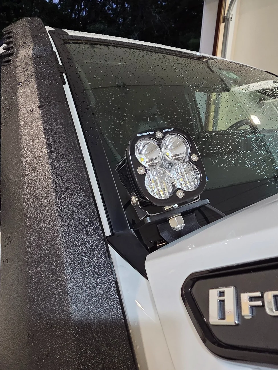

5 - Mount the brackets and lights per the instructions. I saw that some folks were worried about the snorkel interfering with the light when the hood is open. As you can see the light is no where near the snorkel and my hood is open at the higher setting in the pic.

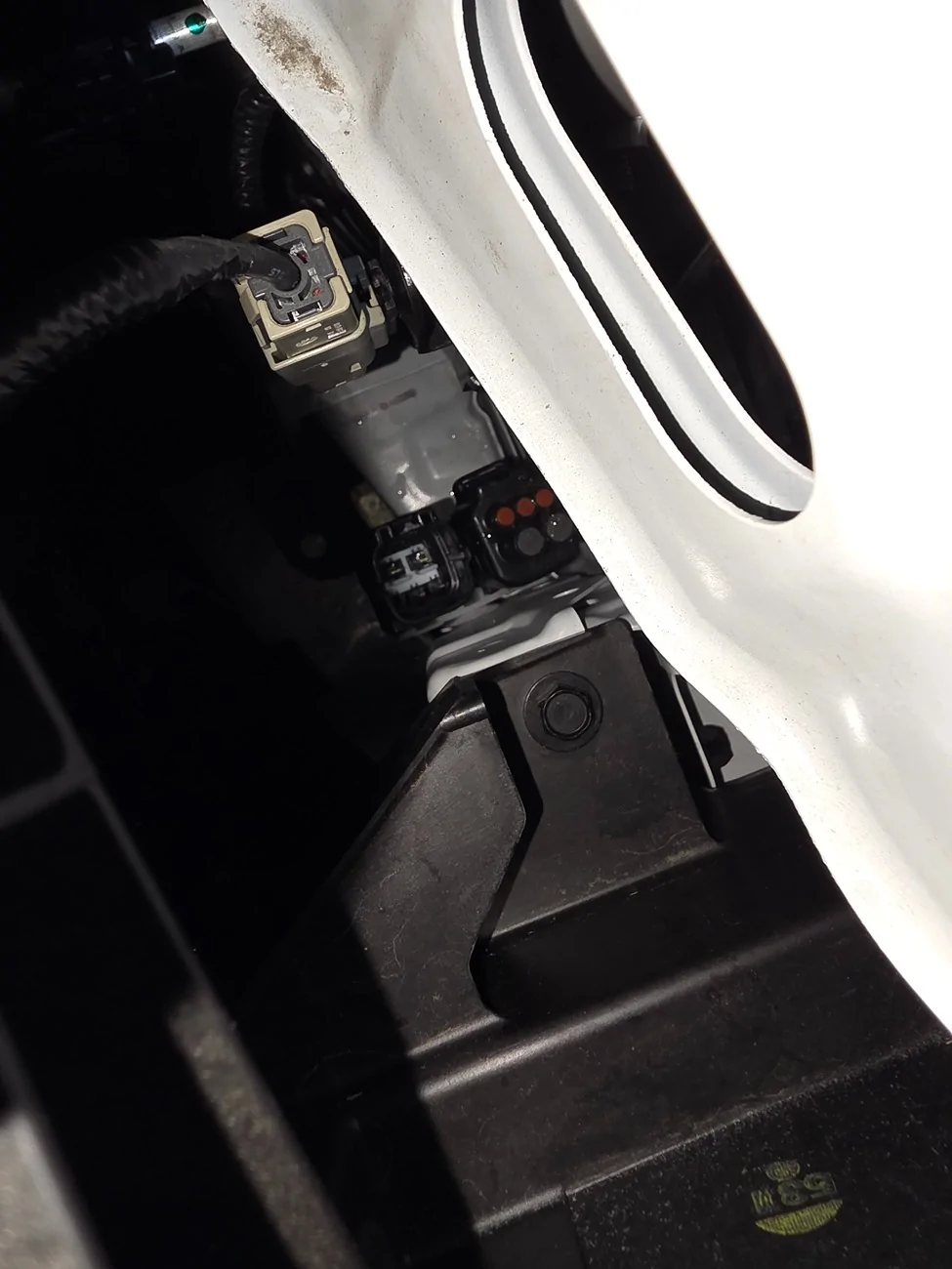

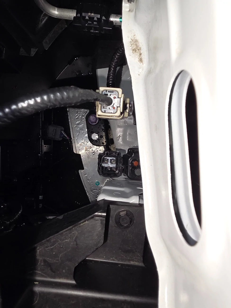

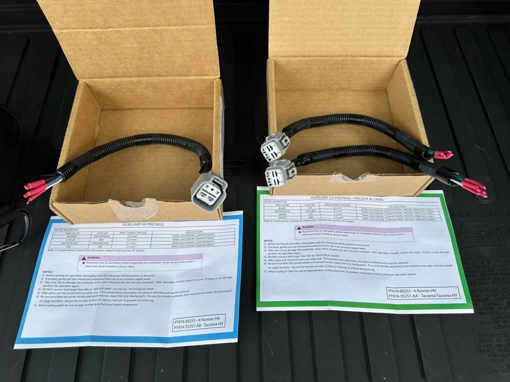

The trailhunter has the pre-wired aux switches in the cabin. You connect to the switches using pigtail adaptors and hookup points in the engine bay and the cab. Toyota has taken care of power and switching for you.
This is the two front hookups that are on the driver's side near the washer fluid. I took the plug out of the one I used and you can see the metal contacts.
2025 2026 4runner 6th gen Baja Designs Squadron Sport Ditch Lights installed using AUX switches - DIY writeup 2948

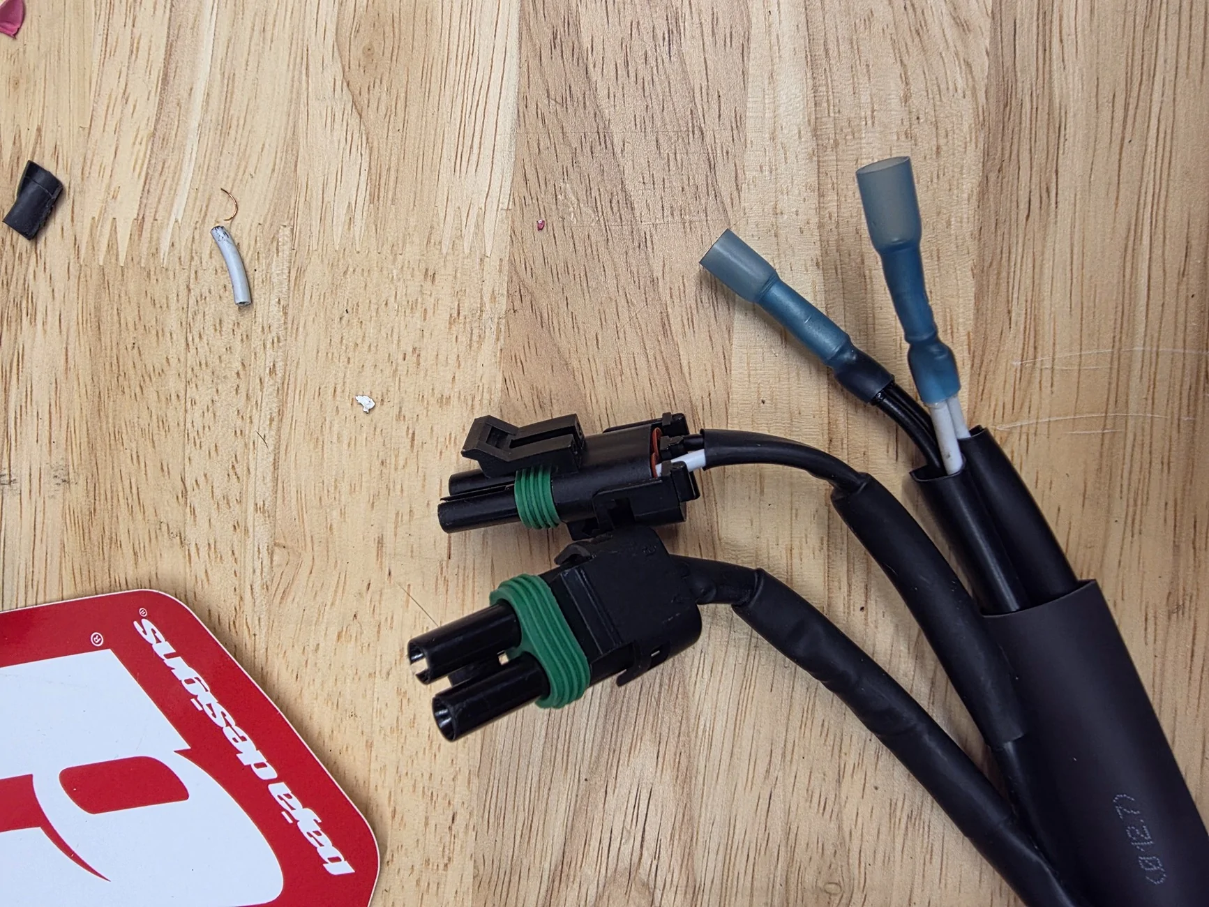

The pigtail connectors that plug into the port came with my car as a set of three, like in this pic.
2025 2026 4runner 6th gen Baja Designs Squadron Sport Ditch Lights installed using AUX switches - DIY writeup 2964
I used one of the smaller ones.
Outside of this there is no need to hookup a switch and the power separately. The wiring harness I got with the lights had a relay, cables that take power to the lights, a cable for bringing power from the battery, and a cable for the switch. With the pre-wired aux you can cut away everything except the cables that take power to the lights and wire them directly to the pigtail.

How in the world did you get the cap off the Aux wire connector harness under the hood? Ive been trying for an hour.

Ha! Yes it is a pain. I used a set of those extra long pliers. It took me a minute too. I have seen a couple of videos where people remove other pieces to get to those ports, but I didn't need to do that once I figured out that I have to use the pliers.

I finally got it. Thanks!!
