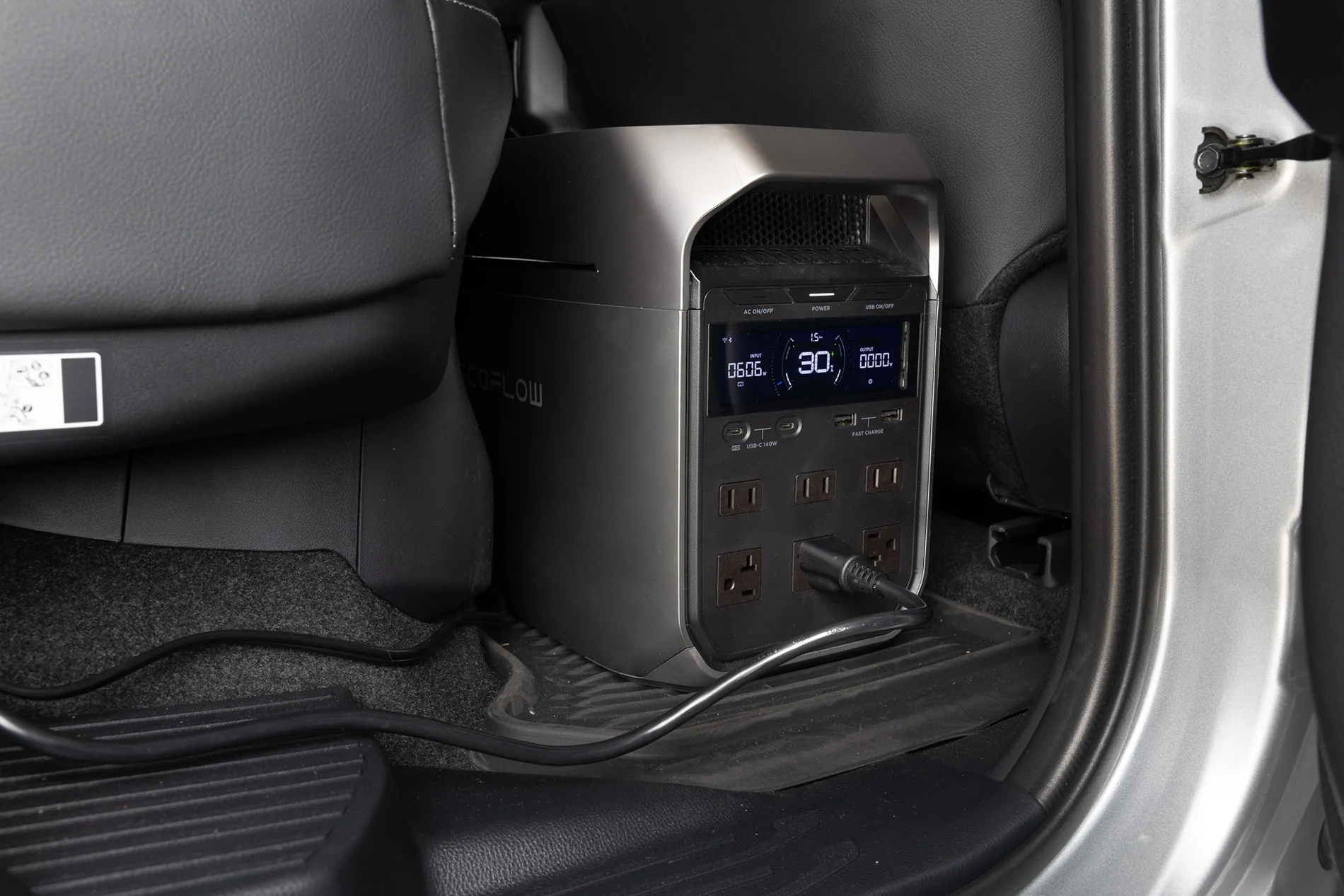

Same here. I use the 2400w Inverter to charge my Ecoflow (which i put behind the passenger seat and charge it from the center console plug). From there, I just run/charge everything directly off the Ecoflow. My Dometic fridge will run comfortably for 3 straight days off the Ecoflow, so it's a great way to go.
I'm using the Ecoflow Delta 3 Plus which is on sale right now and has 1024kWh of capacity.
2025 2026 4runner 6th gen Real-world use of 4Runner’s 2400W Inverter Power Outlet: gear, tips & cautions _W0A4999
My only complaint about the Toyota 2400w Inverter is the noise! It's located under the center console, and anytime I'm drawing more than about 500w for a sustained period, the fan noise starts to ramp up. See my related post/video about that here:

Interesting! I always thought that was the fans on the EcoFlow! The Delta 2 with 1024wh is also on sale right now for $500
