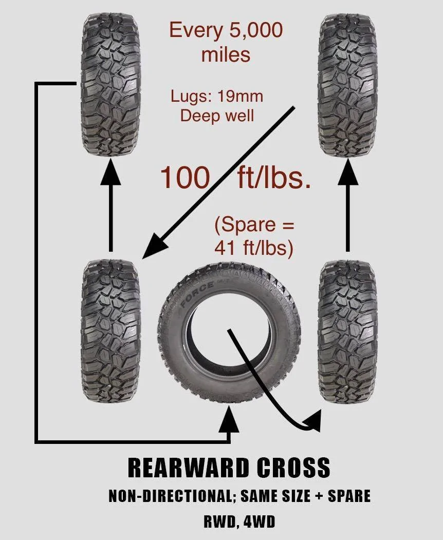

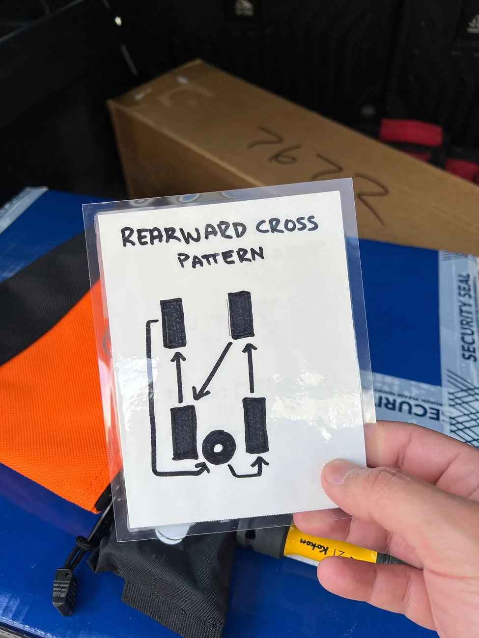

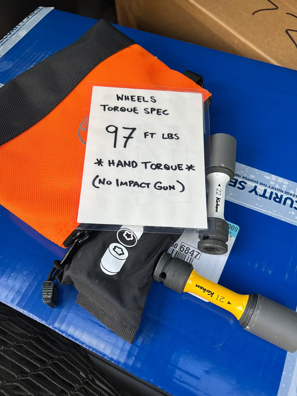

I followed the Rearward Cross tire rotation pattern (second photo in @spelingbeachampeun's post). And as a reference, I laminated the rotation pattern + torque spec to include in the small tool bag where I carry the wheel lock key + lug nut sockets (I need both 21 mm and 22 mm because the wheel lock key is 21 mm and the black lug nuts are 22 mm).
