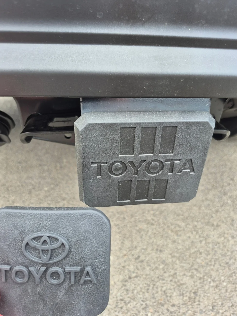

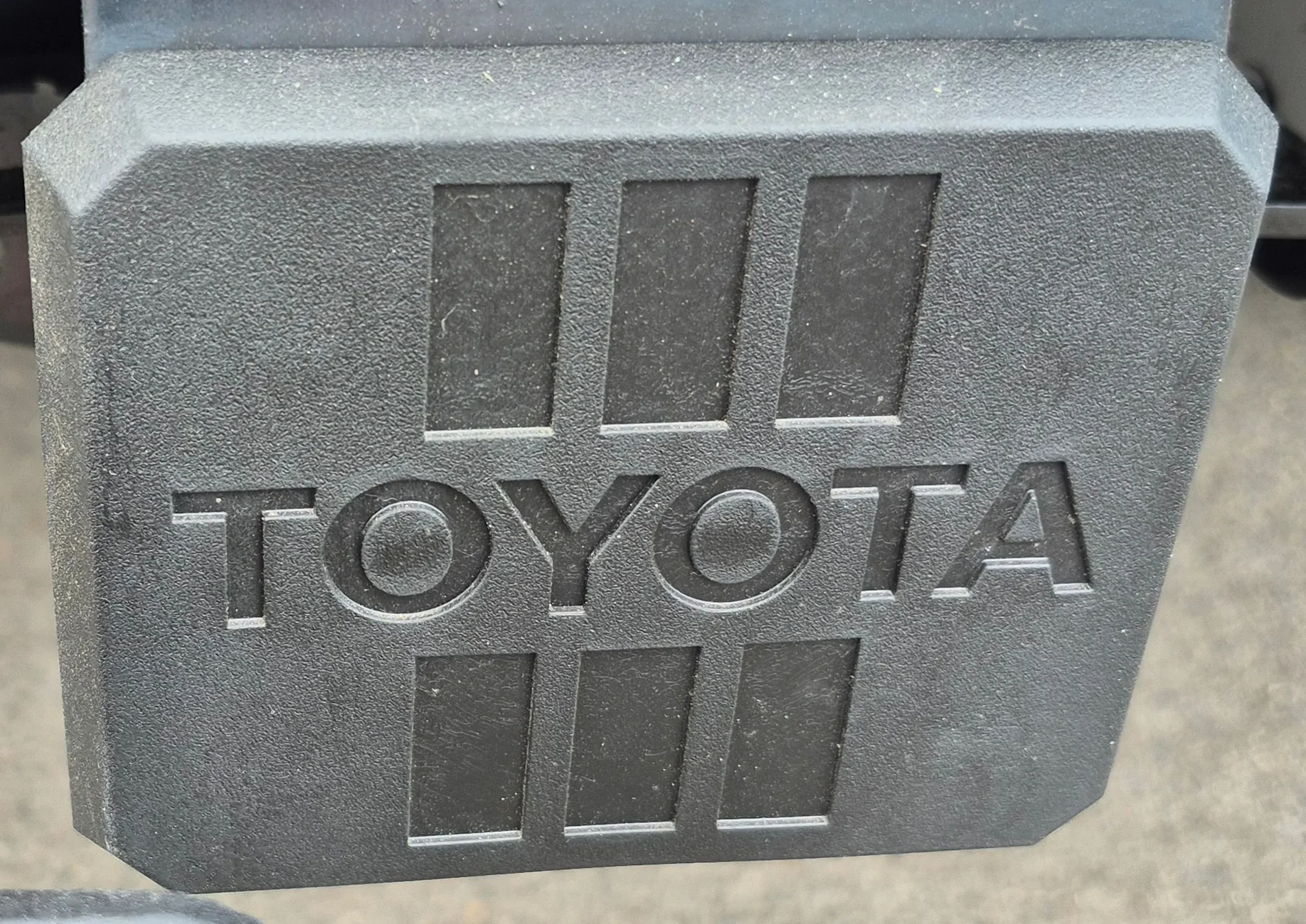

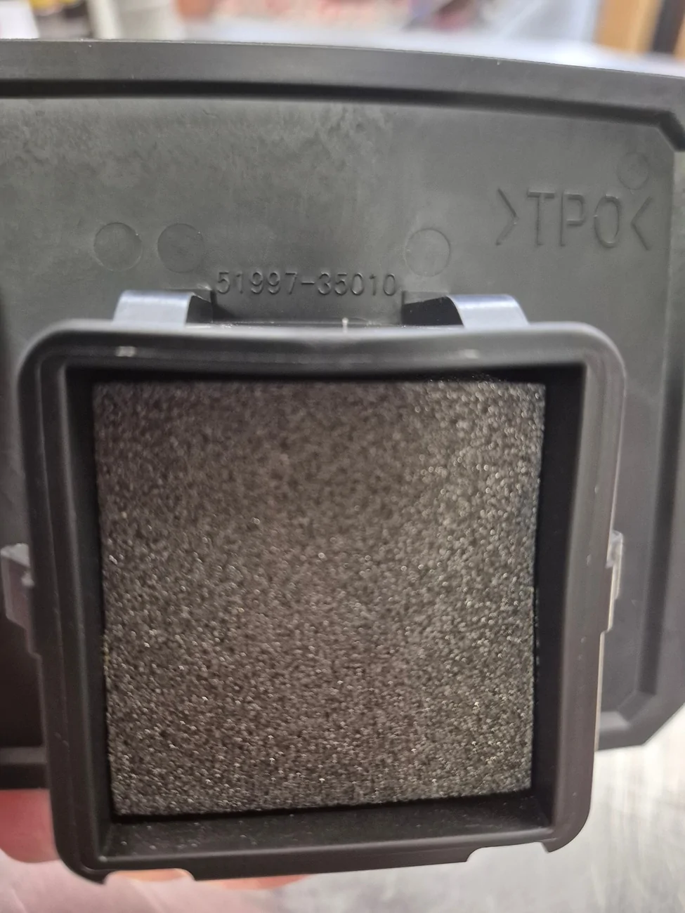

This may seem silly, but I thought it was worth mentioning. Someone stole my black rubber hitch cover out of a parking lot. Without much thought, I ordered a new one on Amazon for around $12. But when I received it, I realized that it's much smaller than the one that came with my 4Runner. So I went down to visit the dealer and looked at the one in the showroom. Sure enough, ONLY the 4Runner has an oversized "faceplate" with three vertical lines on the logo. Then I asked the dealer for the price. They quoted me $86.00 !!! I've gone online with the part number, and the cheapest I've found is 45 plus 15 shipping. I'll post pics below comparing the two.
The part number for the new 4Runner Plug is 51997-35010.
The smaller one for all other models is 00214-34936, with a number of variations out there.
Again, I know this is only small change, but maybe someone out there has a better idea.... I liked the way mine looked better than the smaller replacement.

I've removed mine a month ago and put it the garage just for that reason. It's expensive because of the radar absorbing foam. Cops can't see you from behind LOL.

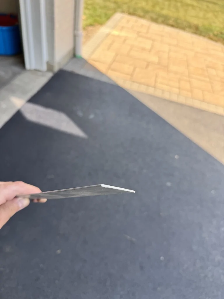

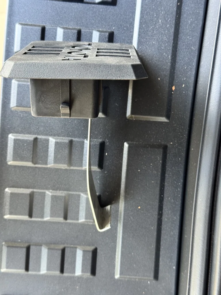

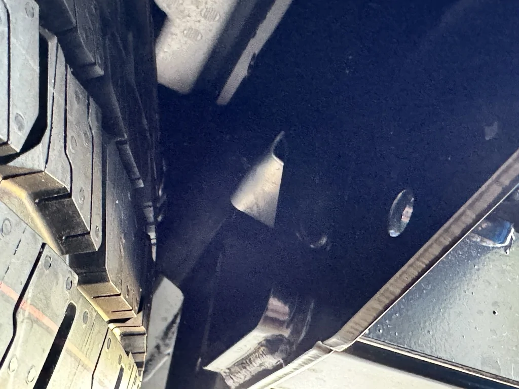

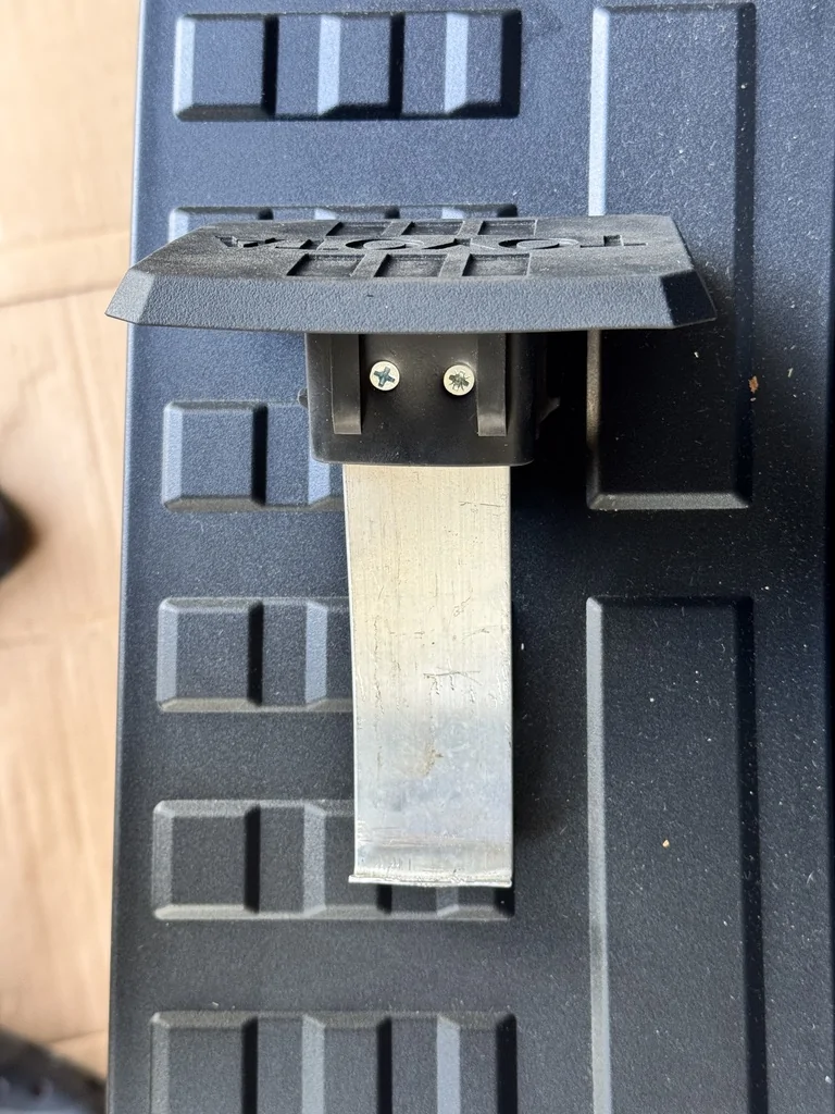

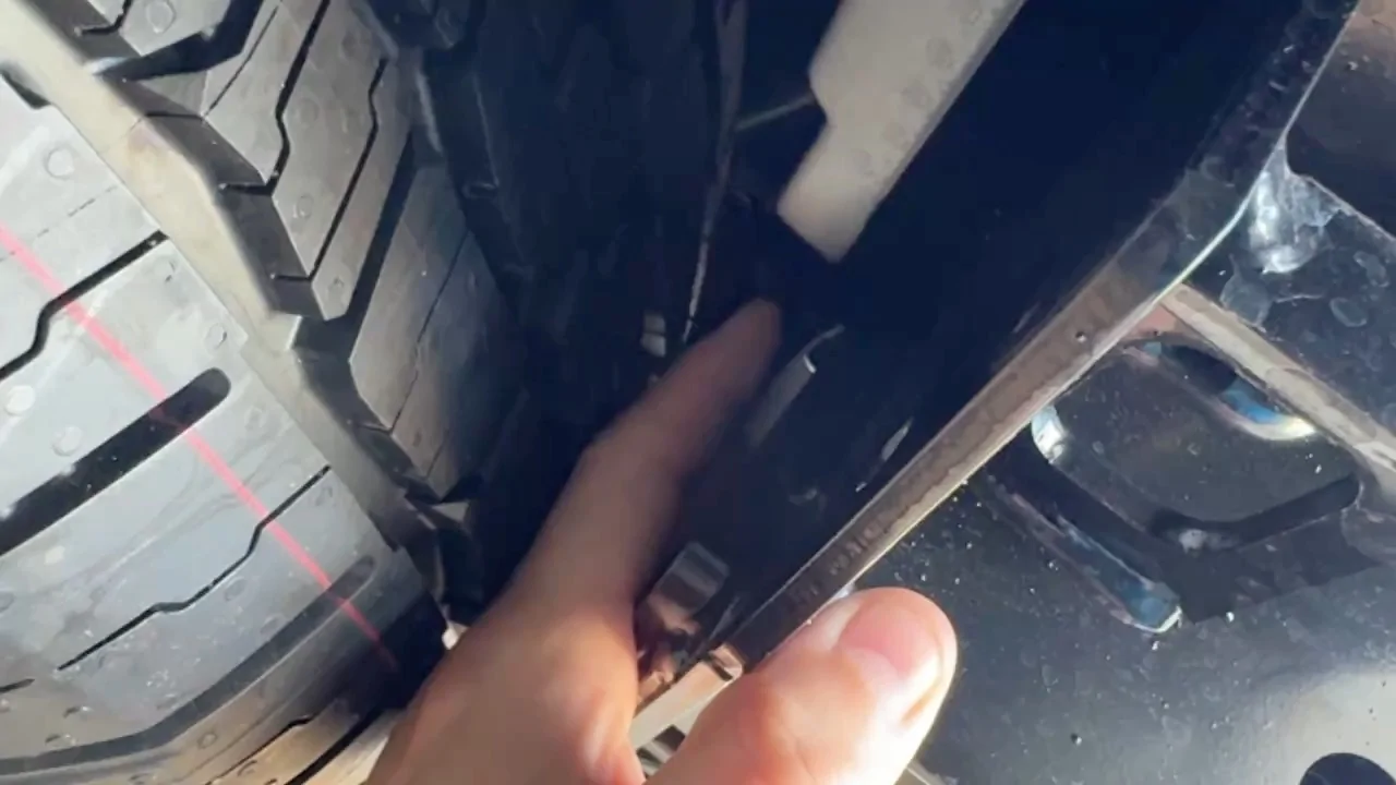

I came up with a little 'security' for the rubber hitch cap.
I had this piece of 1 1/4" x 1/16 aluminum stock. The stock fit nicely in the cap.
So I put a bend in one end of the stock so that it would catch the hitch tube in the back by the spare tire, cut it to length, and attached it to the hitch cap. Thus providing a 'lock'.
All I have to do is reach up by the spare tie and pull down and then give it a little push the cap is off. The cap is on there really tight. My 16 year old couldn't figure out how to brute force it off.

Looks stock when installed.

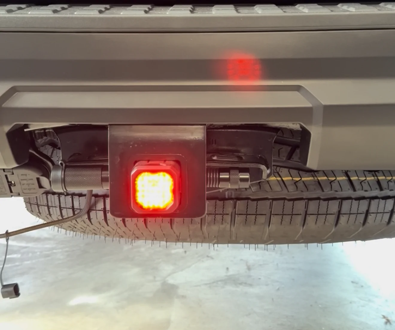

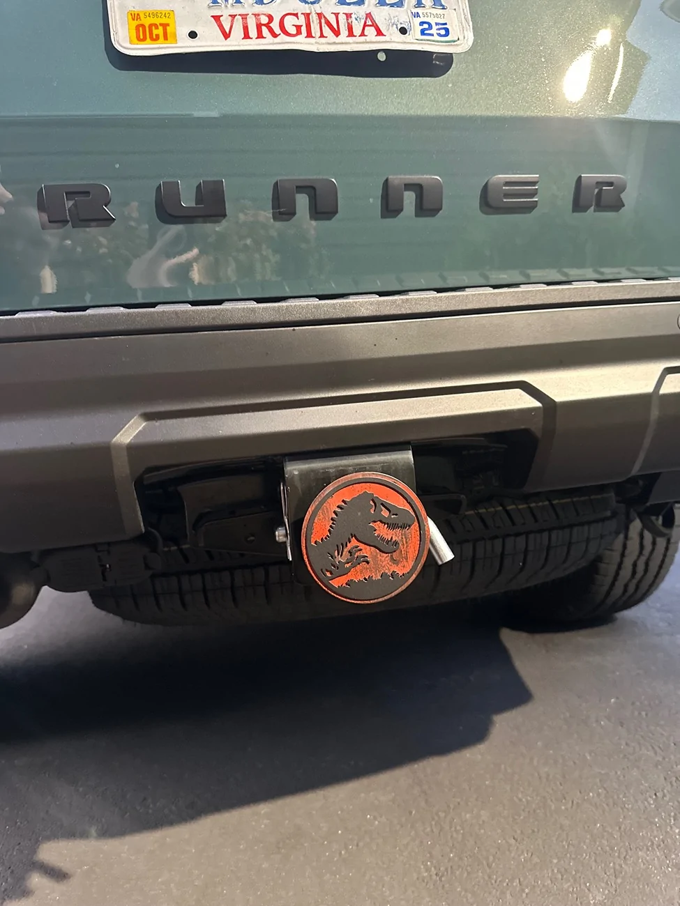

I have the diode dynamics installed with this
Extra Long Trail Hitch Lock
works perfectly!
2025 4runner 6th gen 4Runner Hitch Cover / Plug very PRICEY (replacement part number inside) IMG_9254
if this is what you are looking for!

Yes I think that PIN will be the right choice to keep my hitch ball.
I have not had my hitch receiver rubber plug stolen yet but I could see my trailer hitch as it is also worth about $100 being easily removed.
I do like that diode light system you have is that a brake light? and is it plugged into your trailer connection I can't see the wires.
Thanks again for that info.
