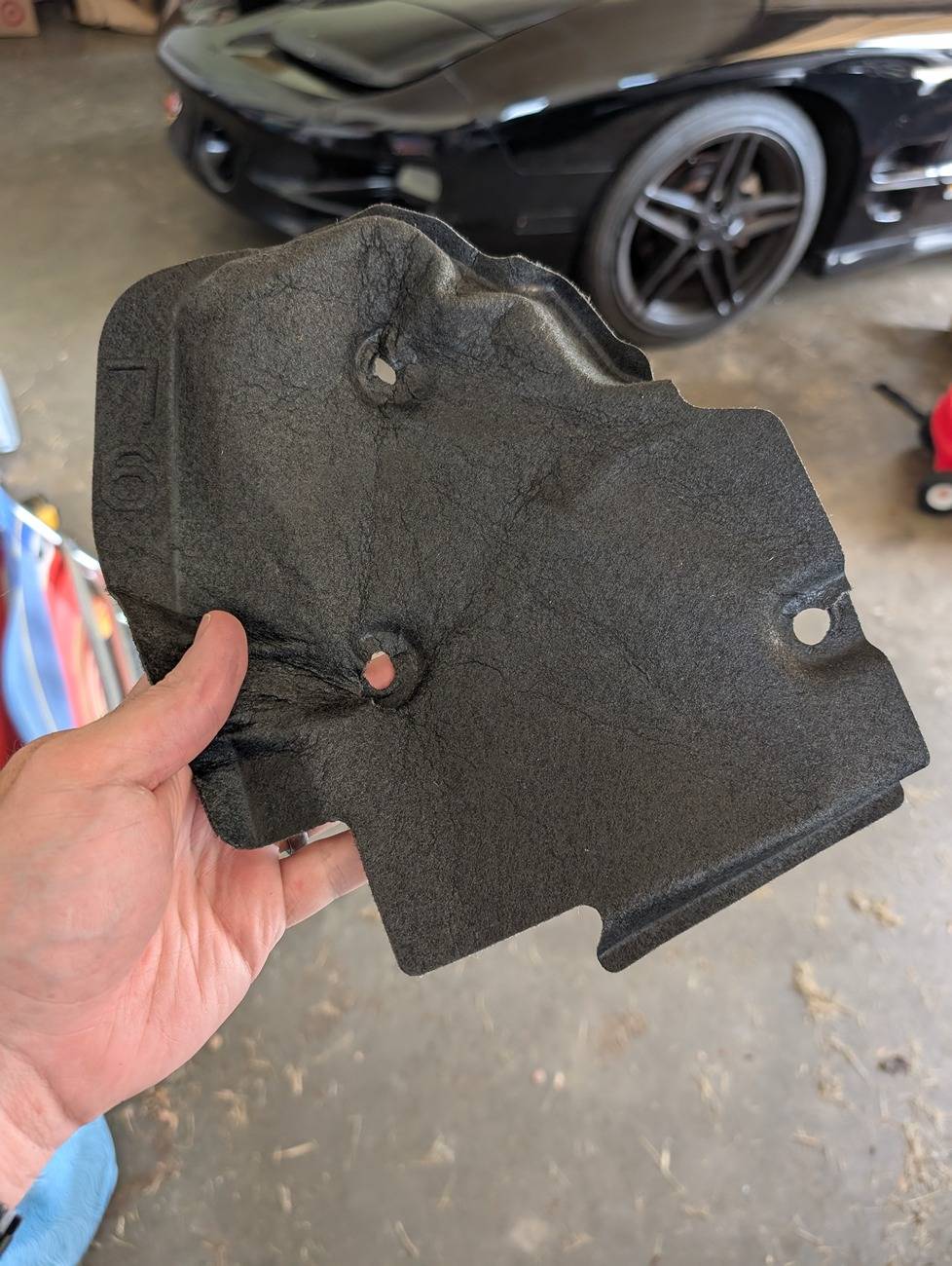

  • Remove the fabric covers held by (3) plastic press pins. I can’t show these on the car because they were torn off when the tire shop backed the truck out into the parking lot.

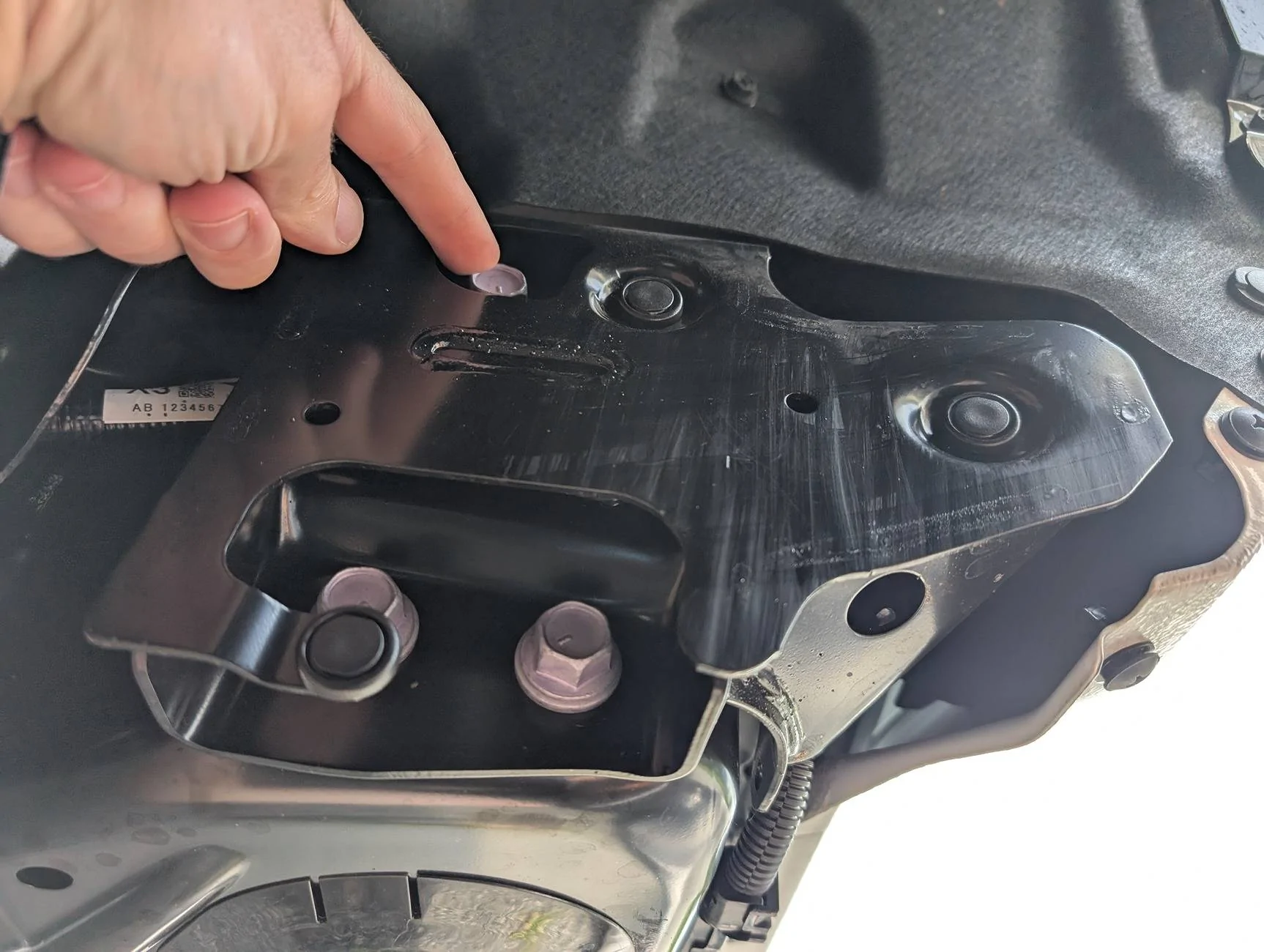

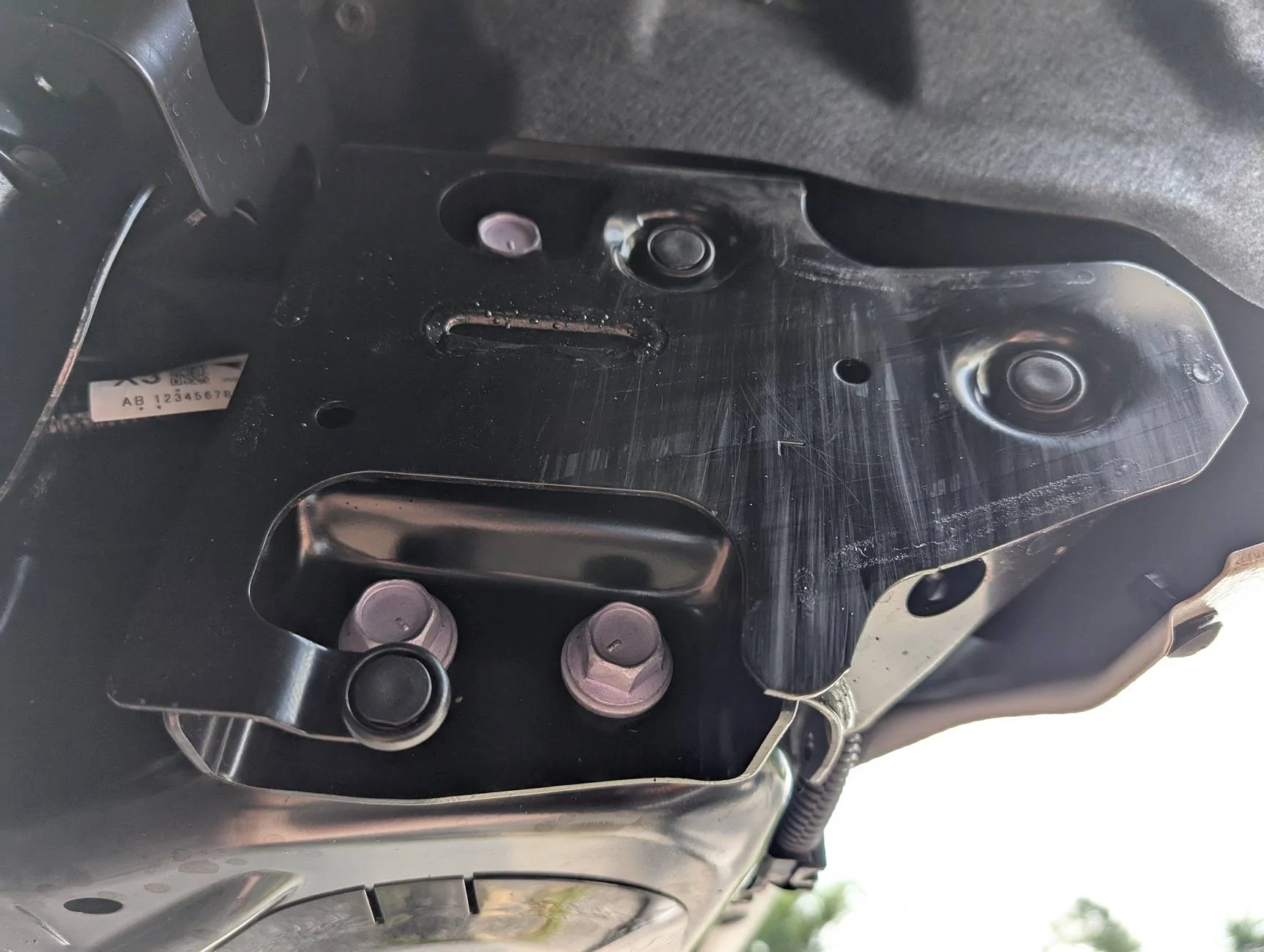

  • Remove the frame crash plate held on by (3) 17mm bolts.
(1) photo showing the fabric cover
2025 2026 4runner 6th gen 285/75R18s on stock TRD Pro (No Lift & Zero Trimming), but you have to remove front flaps and crash plates (Photos included) PXL_20250630_151455330

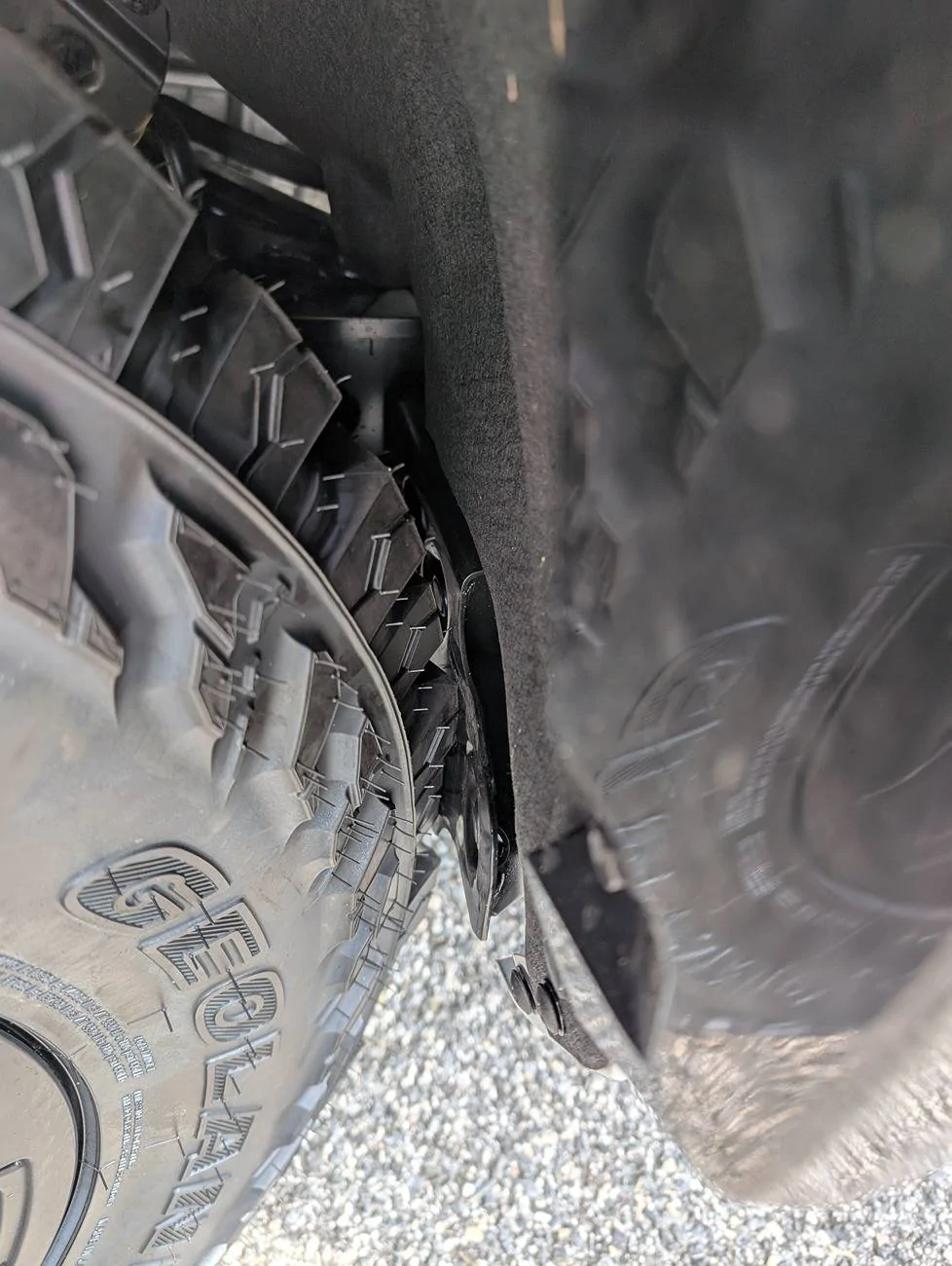

(1) photo of the tire hitting the frame crash plate
2025 2026 4runner 6th gen 285/75R18s on stock TRD Pro (No Lift & Zero Trimming), but you have to remove front flaps and crash plates (Photos included) PXL_20250630_150319106
(3) photos of the plate and the (3)17mm bolts to be removed.
2025 2026 4runner 6th gen 285/75R18s on stock TRD Pro (No Lift & Zero Trimming), but you have to remove front flaps and crash plates (Photos included) PXL_20250630_150415911
2025 2026 4runner 6th gen 285/75R18s on stock TRD Pro (No Lift & Zero Trimming), but you have to remove front flaps and crash plates (Photos included) PXL_20250630_150420981
2025 2026 4runner 6th gen 285/75R18s on stock TRD Pro (No Lift & Zero Trimming), but you have to remove front flaps and crash plates (Photos included) PXL_20250630_150426134

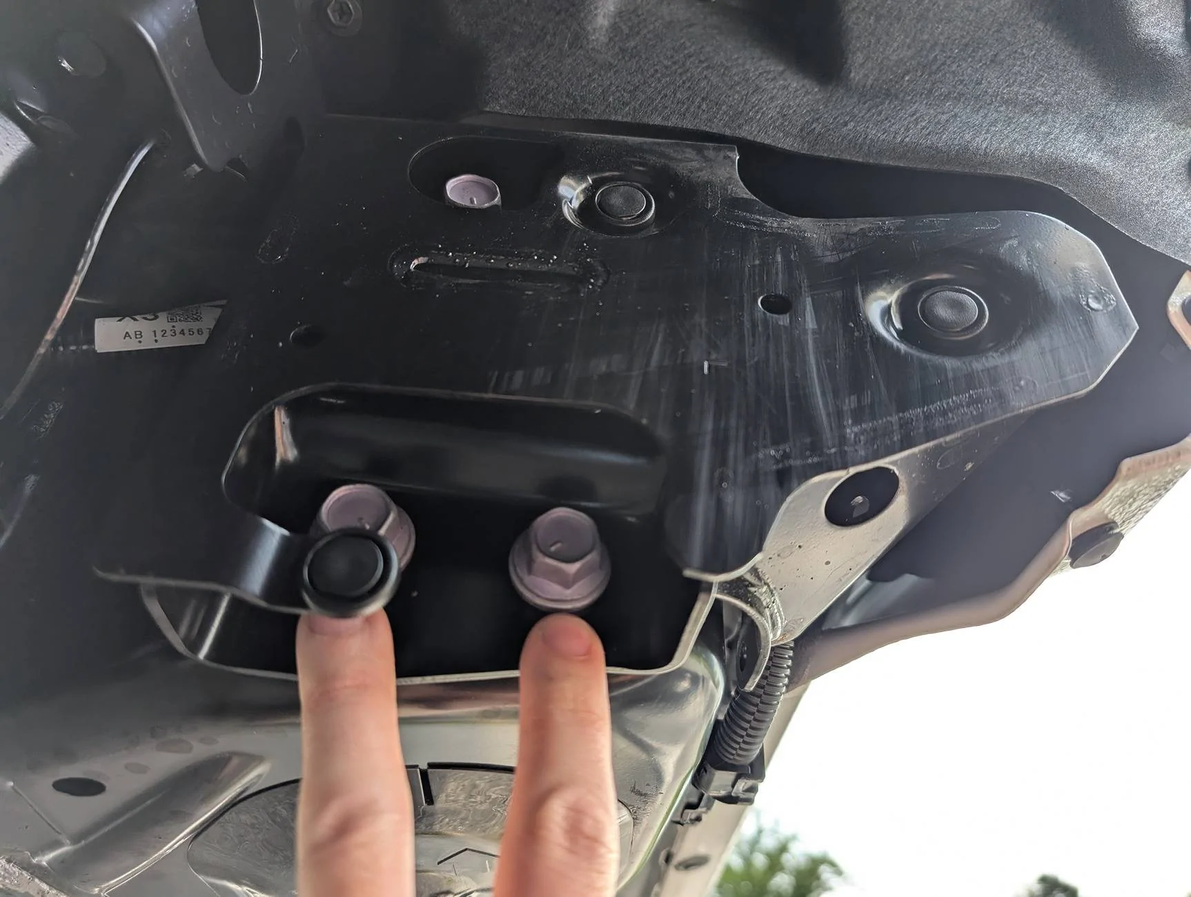

(1) photo showing the wheel clearing, I put the (3) bolts back into their holes, I consider this best practice anytime I remove parts, including the mudflaps, fills holes and saves time if I ever need to reinstall for some reason.
2025 2026 4runner 6th gen 285/75R18s on stock TRD Pro (No Lift & Zero Trimming), but you have to remove front flaps and crash plates (Photos included) PXL_20250630_150903840

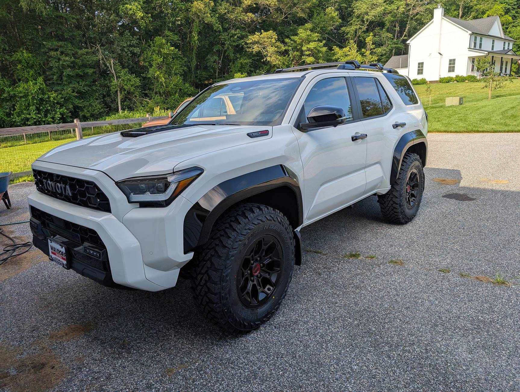

(2) photos of the truck on the tires
2025 2026 4runner 6th gen 285/75R18s on stock TRD Pro (No Lift & Zero Trimming), but you have to remove front flaps and crash plates (Photos included) PXL_20250630_002020041
2025 2026 4runner 6th gen 285/75R18s on stock TRD Pro (No Lift & Zero Trimming), but you have to remove front flaps and crash plates (Photos included) PXL_20250628_212618400

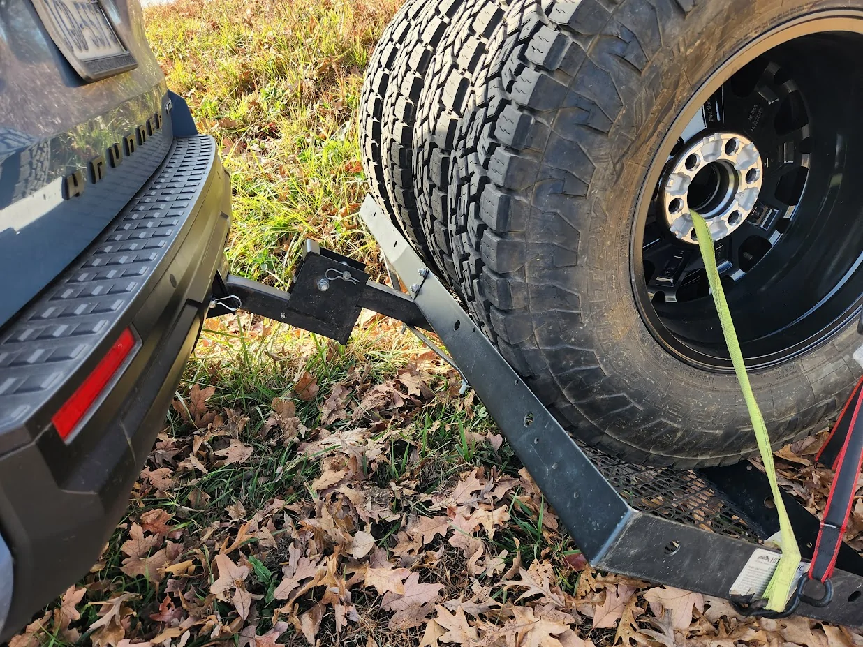

I stumbled on this thread today and decided to try to answer this question since I have what is probably some unique experience.
First the summary answer to the question (Note: this applies to a Hybrid. Non hybrid would be MUCH easier): Yes, a 285/70 can be stood up in the cargo area. BUT the rear seats will likely need to be rolled forward to get it into place. Tire does not fit vertically through the space between the floor (top of hybrid battery) and interior roof at the opening. It IS possible to angle it in and then tilt it back vertically, but with rear seat in its "normal" position the seat will prevent that tilting. With both rear seats rolled forward its not too hard to get one tire vertical on one side of cargo area. I'm not sure if the rear seat can be put up - but am almost certain that you won't be able to tilt it back to a normal comfort level - which is fine if you put it on the driver's side and limit to 4 total occupants.
One tire will fit relatively easily lying down and that is what I am doing for my spare when off-roading.
Now why would I know this much detail? Because I fit FOUR mounted 285/75s into the cargo area.
I was transporting my mounted off-road/snow tires on a hitch rack and they were just too much for the rack. Fitting them into the cargo area was .... not fun. But I did it. (two will fit vertically in the space where the rear seats roll up from - with one of them wedged in at an angle to be able to close the rear door. Two others semi vertical at different angles.) I thought I had photos of this but apparently in my frustration I forgot to snap a picture. Best I can offer is a shot of the failure that led to my packing experience:
2025 2026 4runner 6th gen 285/75R18s on stock TRD Pro (No Lift & Zero Trimming), but you have to remove front flaps and crash plates (Photos included) 20251114_124619
