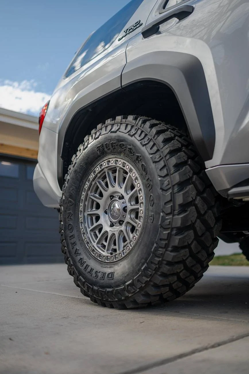

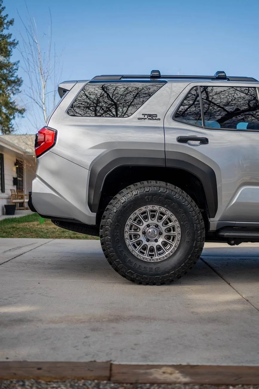

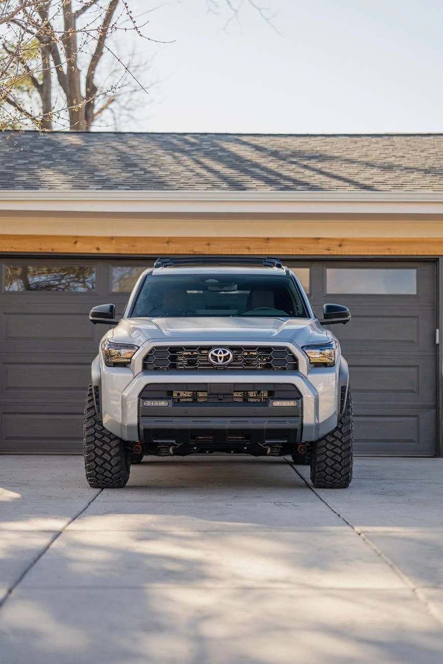

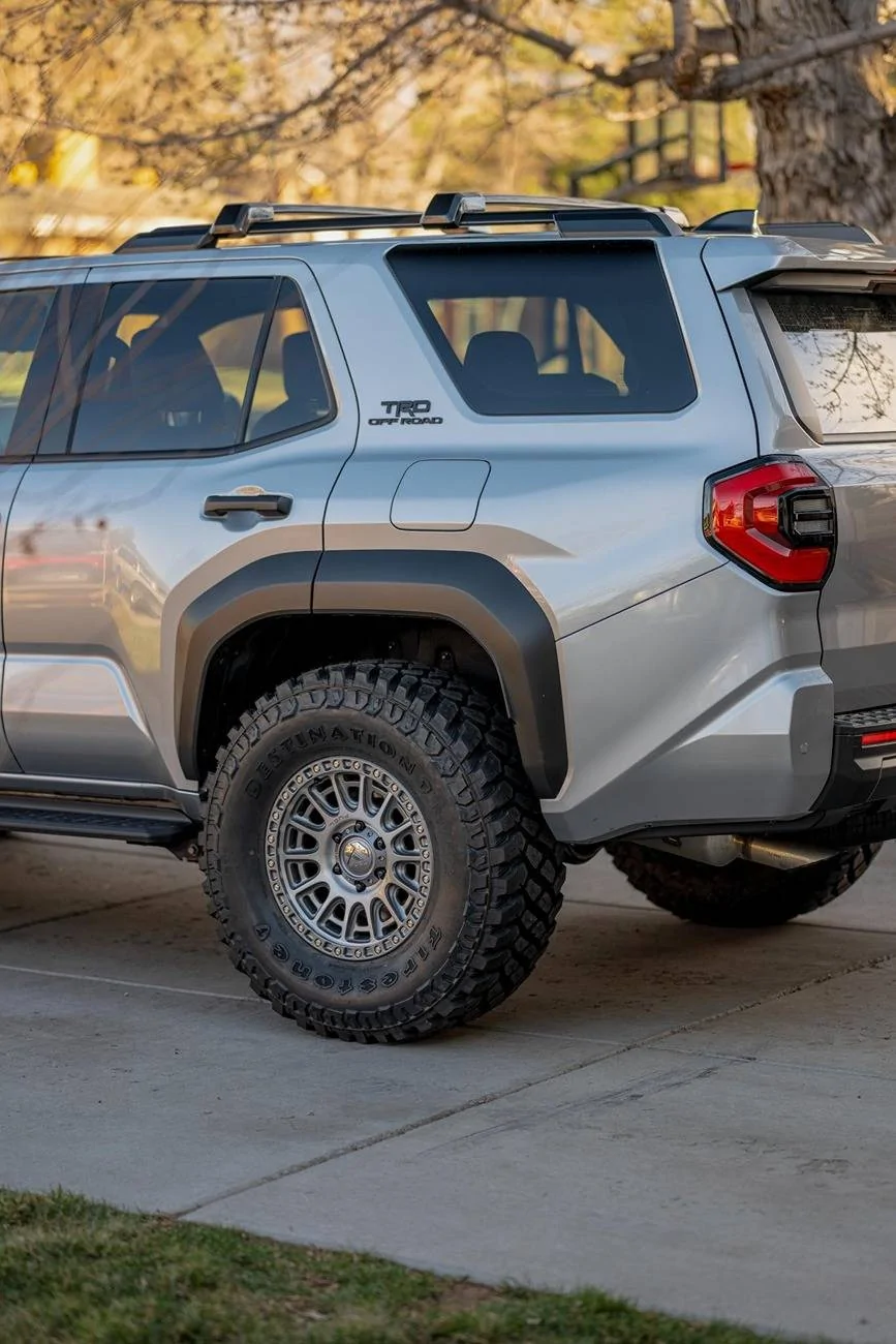

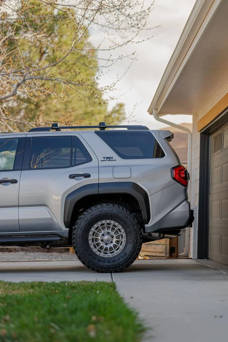

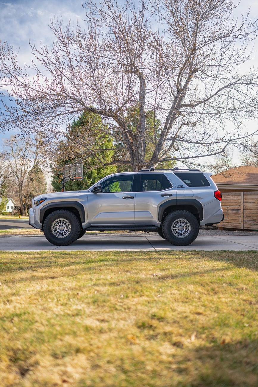

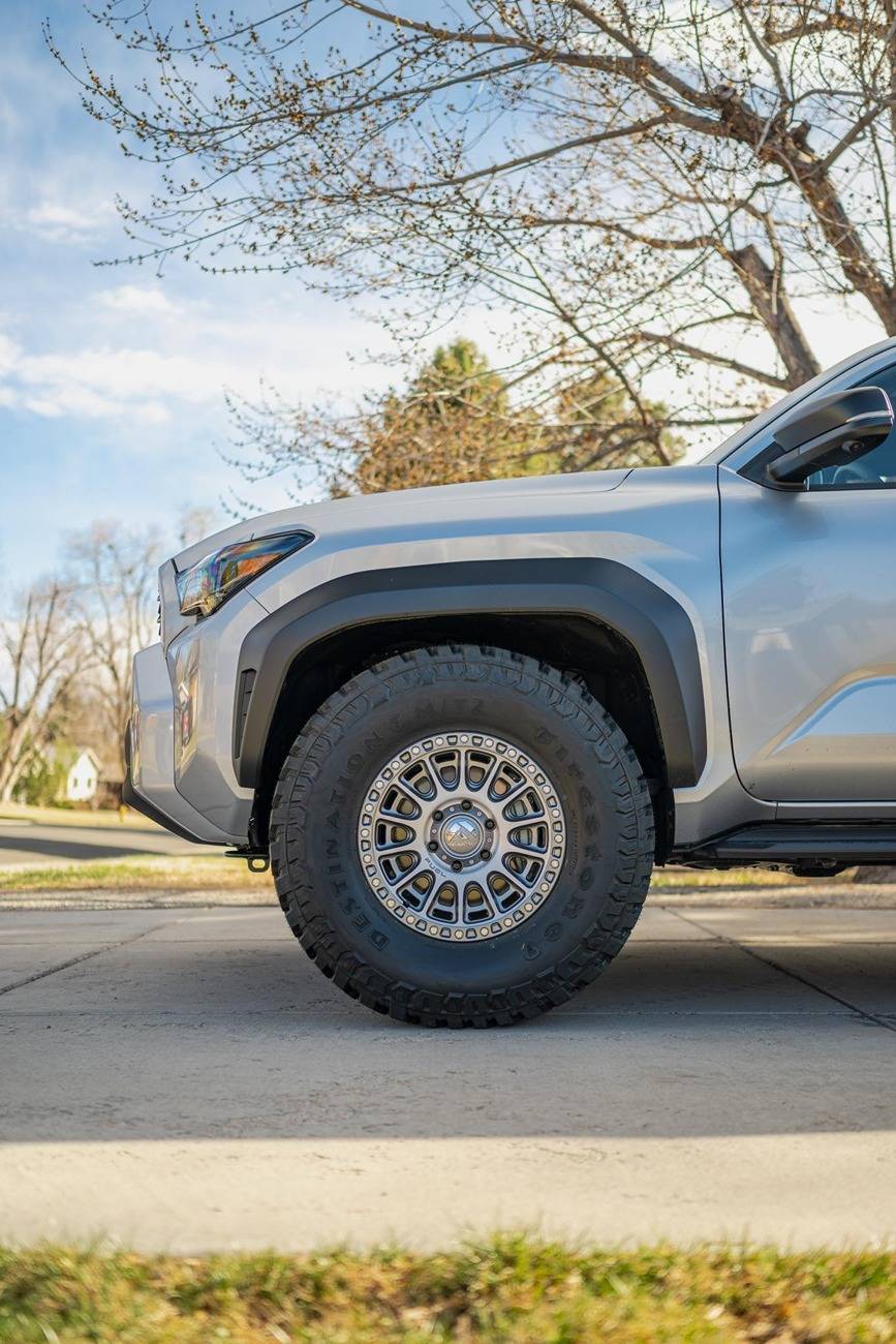

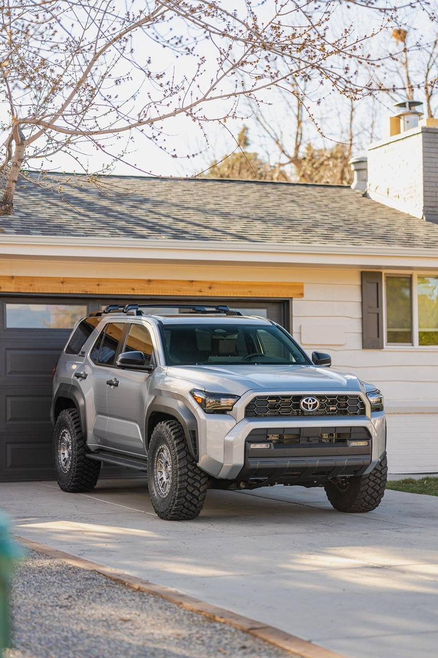

Installed & posted by Team 4Runner:
  • 35" Firestone Destination MT2 Tires (35x12.50r17) 35s
  • 17" Fuel Off-Road Cycle wheels +34 mm offset
One of the best parts about these new Toyotas is you are able to fit a much bigger tire with very little work. Some slight trimming of plastics and gutting the wheel wells, you can fit 35s without issue.
