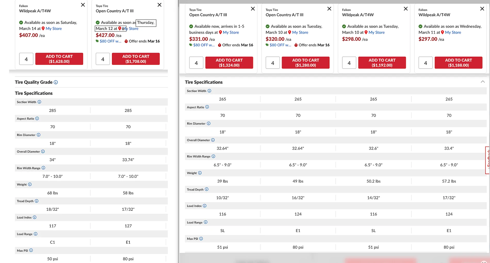

Sorry, at a computer now. I wanted to see the full comparison side-by-side.
OEM is the first column in a group of 4, the three after it are also 265. Factory are SL, 4-ply, E is 10-ply, in the 265. Going up to 285 you get less choices. The AT4W only comes in C load, 6-ply, where the Toyo comes in at E, back to 10-ply.
I watch a lot of Driving Sports TV videos. He put the E load AT4W on his Land Cruiser to prevent punctures when off-roading alone, not caring too much about the hit to MPG. He also says the ride is still pretty good on the E load tires and he makes cross-country trips in that thing.
I saw another video by some guys that say E load are overkill if you are not going to be putting a lot of cargo weight on your car. They showed them aired down to like 15 PSI and they were barely squatty at all because the load on the vehicle just wasn't there. Just one data point though.
The factory Toyo being 39 pounds each and the AT4W being 68 it quite the jump per tire on the car, which was why I was considering staying at 265 when I change tires. If I went 275 on the AT4W, those are 60 pounds each so I save a little. The KO3s in 275 are also 60 pounds in the E load. Those are my top two right now. I think the AT4W is a better tire, but I love the look of the KO3s.
If I stay 265 on the KO3s, I can choose from D load, 8-ply @ 54 lbs, or E load, 10-ply @ 57 lbs.
Anyway, my comments were definitely not meant in a judgmental fashion. I am having the same debate on my end when these Toyo's eventually wear out, which I hear they do quite quick being SL rated. So I was basing my questions to you on the same ones I am asking myself.

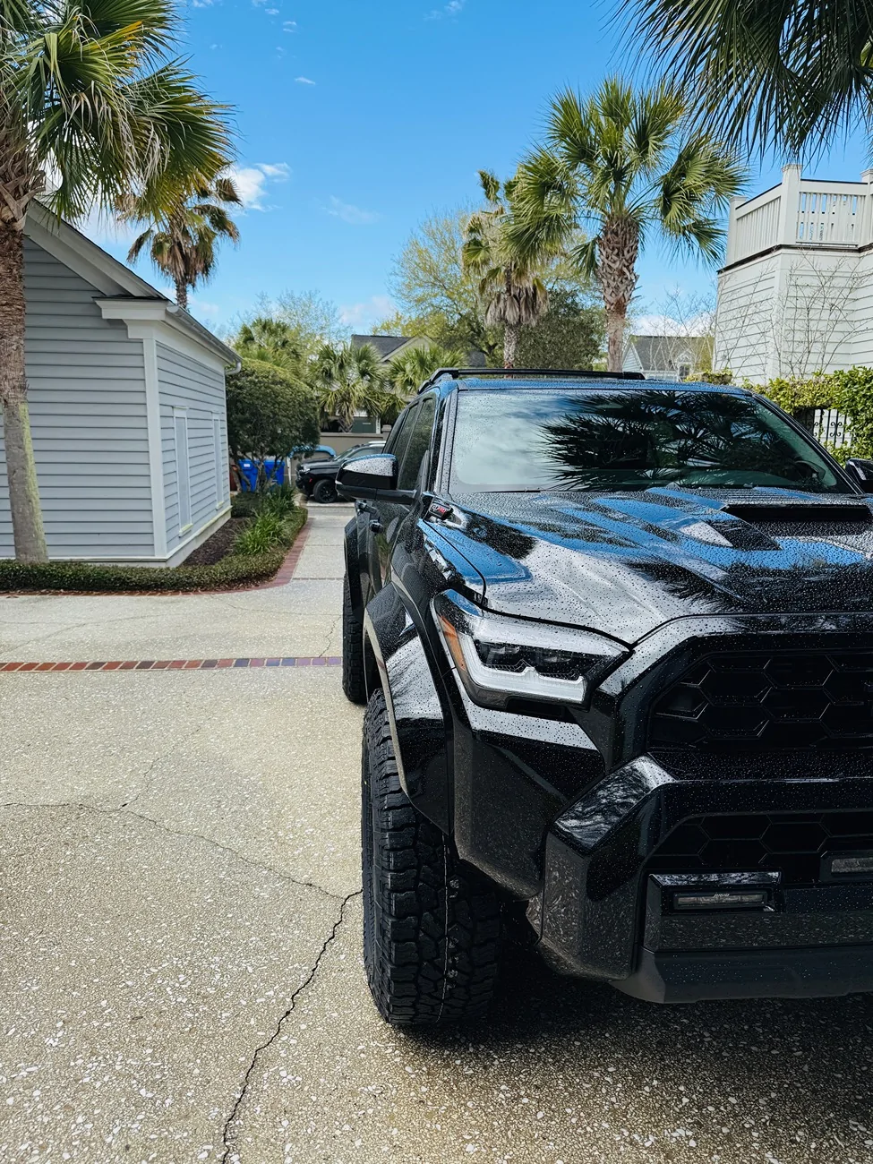

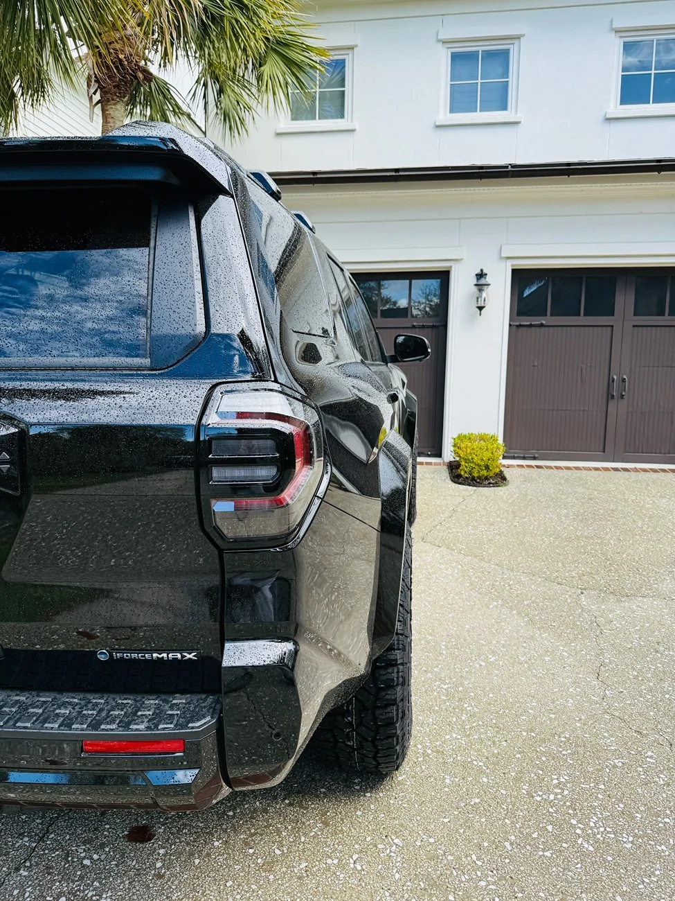

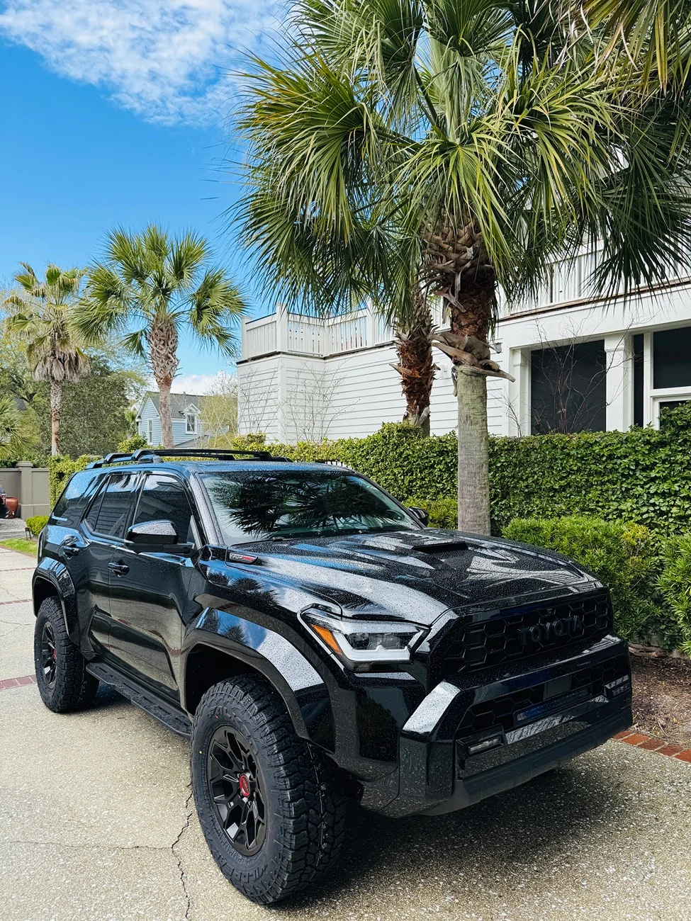

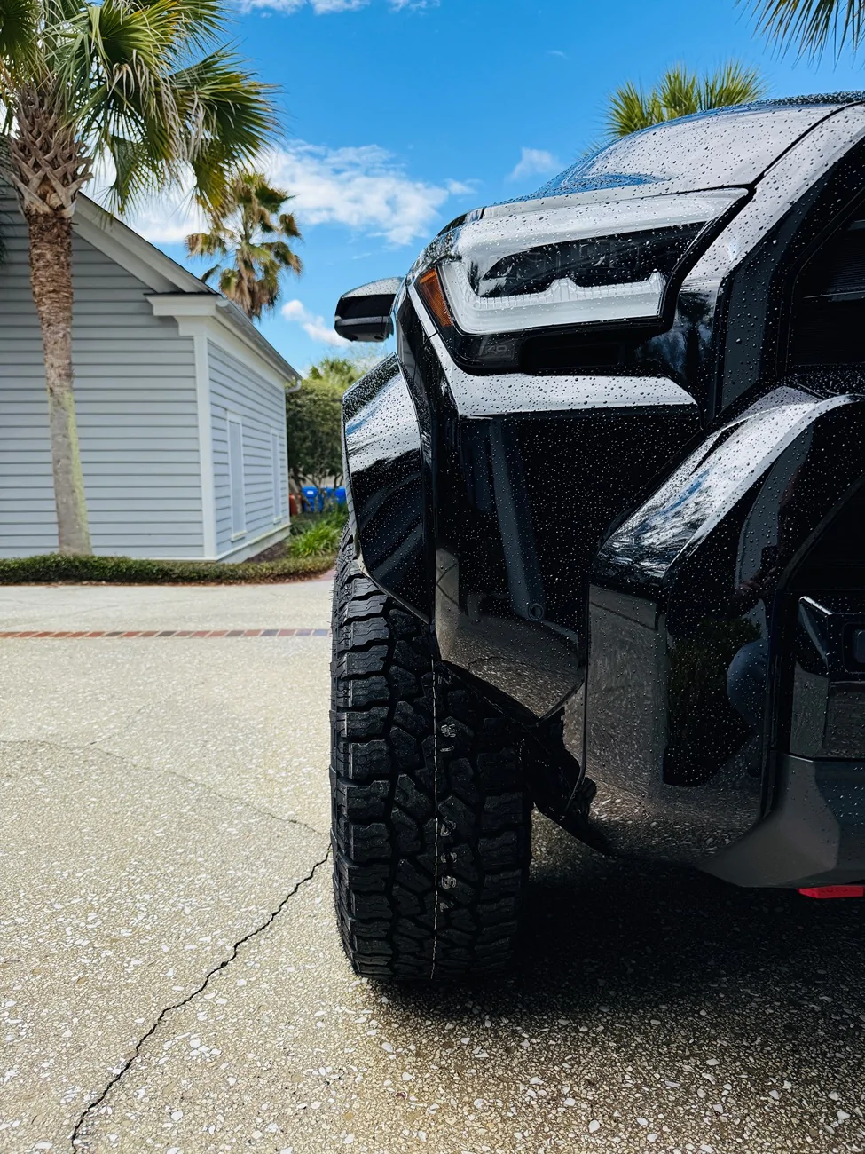

Falken 285/70/18 are on. Here’s few quick pics, sorry truck is filthy but rain and an inch of yellow pollen are not a great combo. :)
Haven’t had a chance to drive it yet but I’ll give some feedback when I do. Looks wise it looks the way the OEM setup should have been. It’s not crazy aggressive, outer edge of the tires is basically flush with the fender edges, or maybe a couple of mm of poke. Did take the crash plates off just in case. Figured might as well have them taken out whilst the wheels are off rather than have to go back, but now I’ll never know if it needed to be done. 🤷‍♂️

I think that might decide it for me. I am pretty sure I am going to go 275/70/18 on the AT4W E load. I should be able to leave the vehicle unmodified to roll those no issue without rub even off-road.

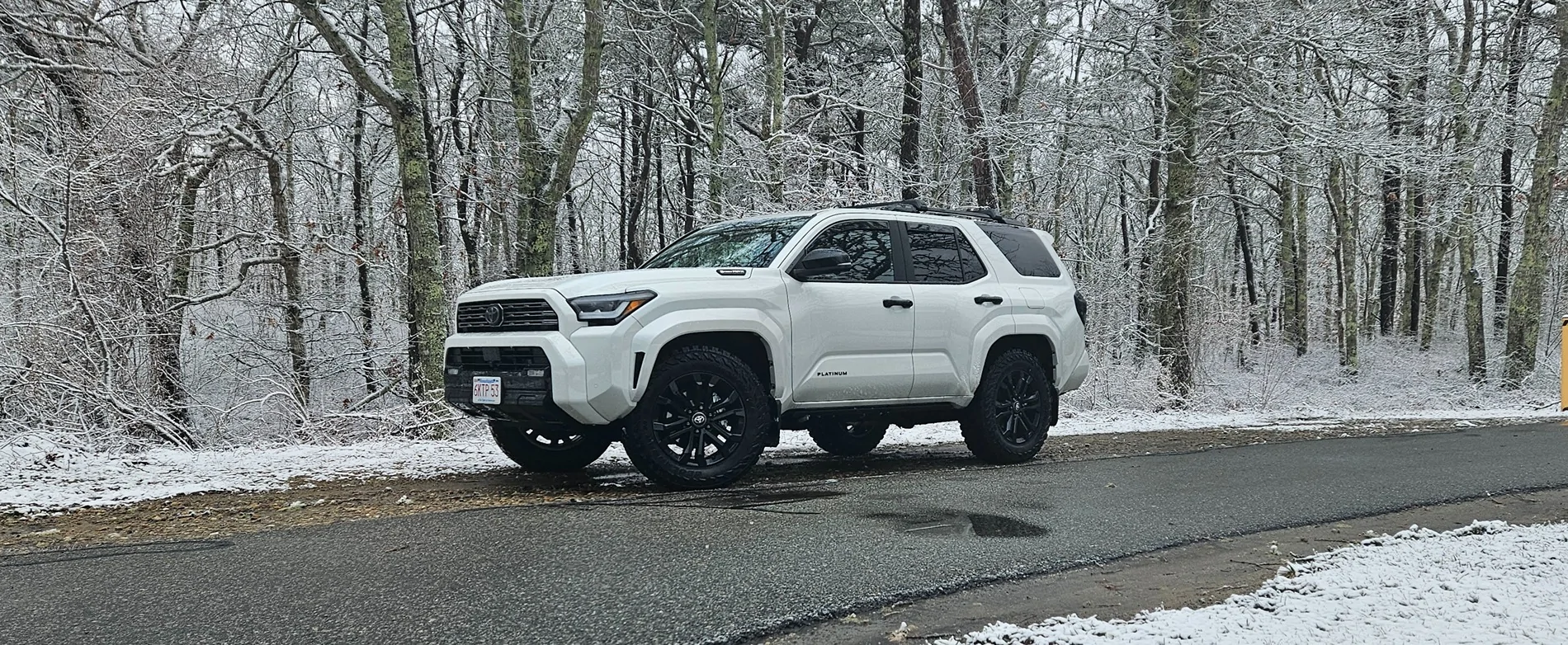

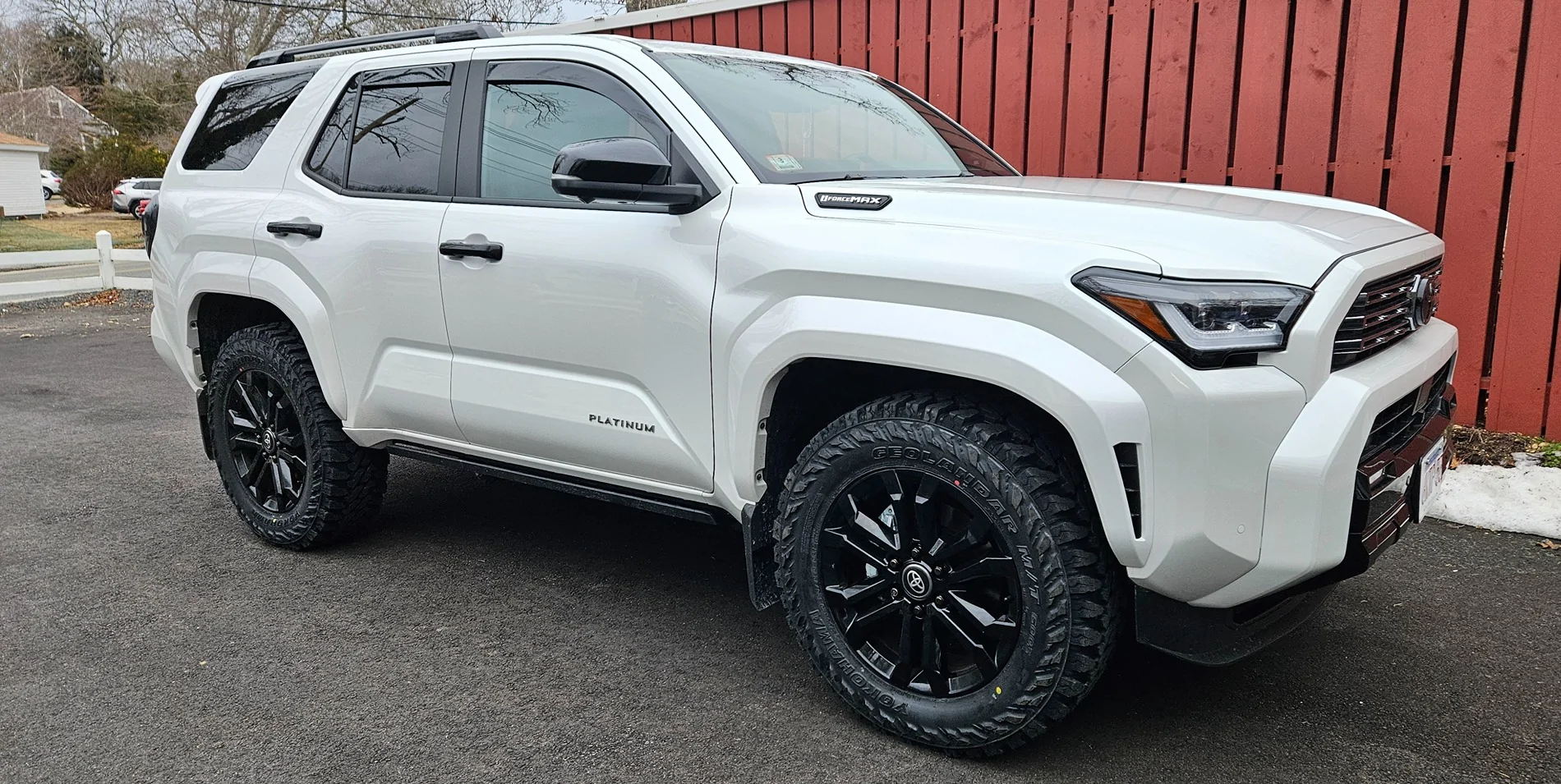

We have a Platinum with stock suspension the OEM rims are 20"s we ended up putting on 275/65R20 Yokohama Geolanders MT G003.
It's a perfect fit, zero rubbing at full lock in forward or reverse no trimming on anything.

so these would be 34's right? do you know the offset on the wheel?

Yes they are 34 & change the OEM off set is 55 (so chat gbt states) I honestly do not know and not going to lie,but I can tell you that there is zero rubbing at full lock.
