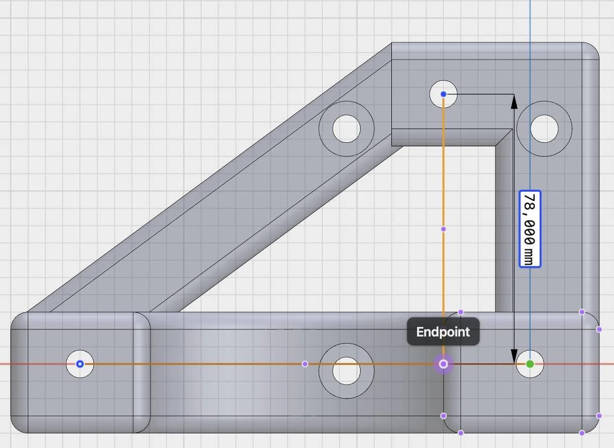

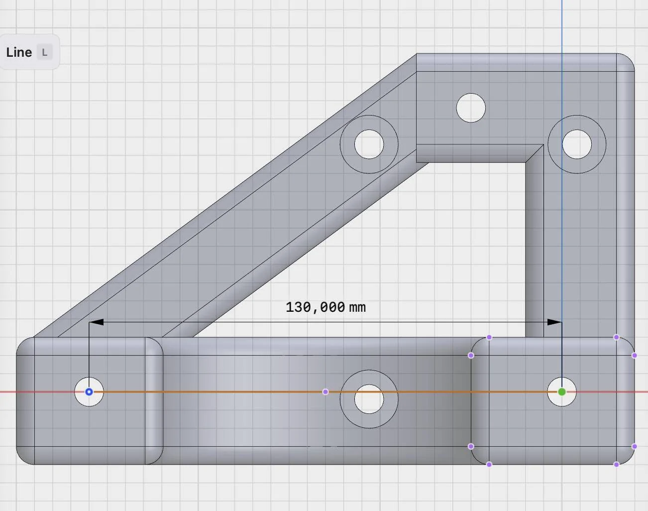

Here is the google drive link to the .stl file. Full disclaimer I am not a professional at creating parts like this. I am giving the file to the community and anyone is free to use it as they will. I accept no liability in how it is put to use or for any completed prints. Feel free to modify and improve on the design. When I printed my bracket I used ABS+ at 80% fill. The length of the bracket is 170mm for scaling. I just drove 700 miles round trip to Laramie Wyoming and have had no issues.
The bolts to attach this are M6x1.0mm. I used lock washers and some blue loctitie to keep it from rattling loose. It's easier if you mount the compressor first and then use a long handle screw driver or extension to secure the fasteners. You can also mount the plate and then refasten the compressor but getting the bolts started is a pain in the ass. Also due to the bolt pattern and tolerances in the space only 3 of the plate bolts can be secured. If someone wants to rearrange the compressor there may be a way to get all four to attach and still be able to access the bottom bolts. I didn't feel like it was worth the effort.
Let me know if there are any issues with downloading the file.

AMAZING writeup, and as an engineer with 3D print experience, super helpful to have an STL file to work with.
One thing I will say, the STL file has dimensions in the *thousands* of millimeters (15,000mm = 1500cm) and the model ended up being gigantic. Not a problem as I can just scale it down 1000x in Inventor, but worth a note!

Thank you I had a lot of fun doing it and I am glad you're taking advantage of it. I realized that I had saved it in thousands when I went to print it myself and forgot to update the STL file.
This is an awesome model. Saved it for later use as I am going to look at new 4Runners tomorrow.
Do you happen to know what final dimensions are or some reference points in MM so I can figure out the correct scaling? Maybe overall length of the long side or one of the other sides?
