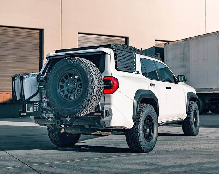

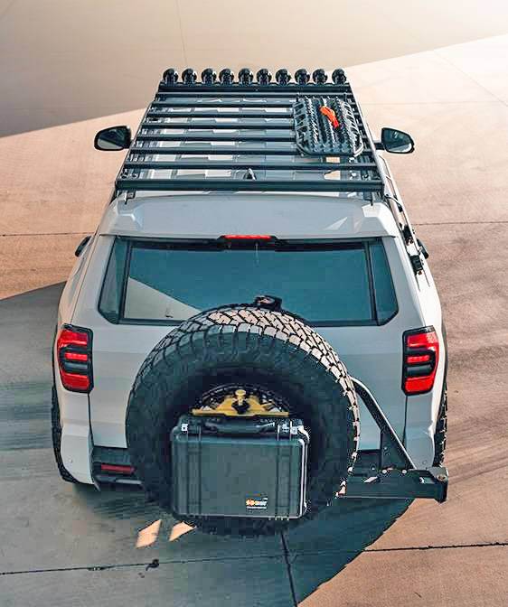

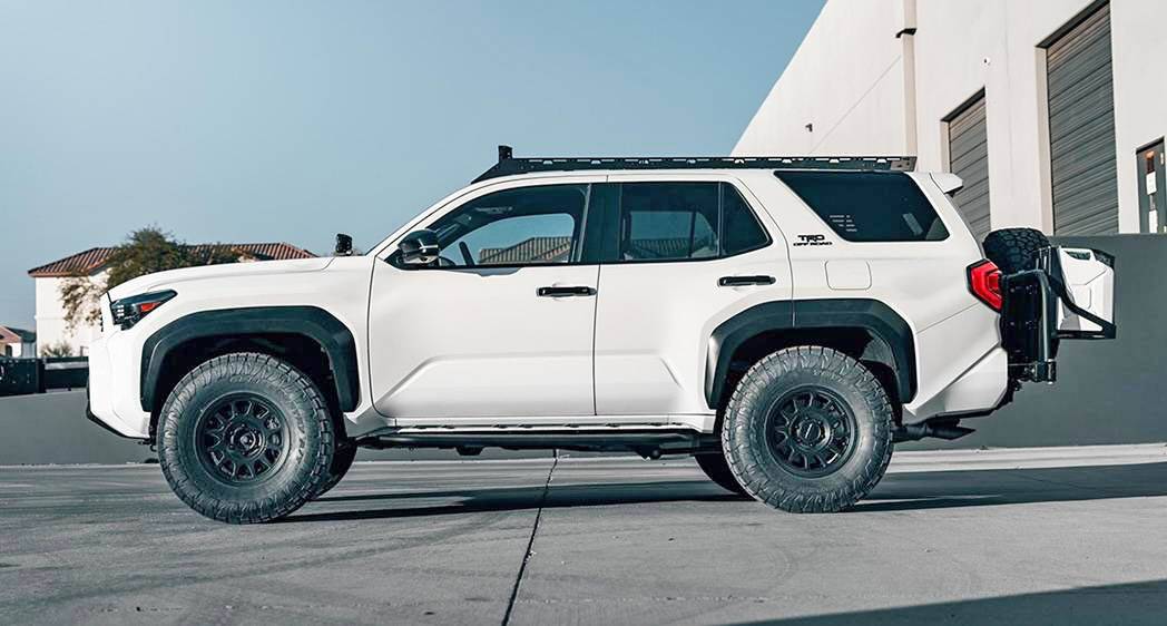

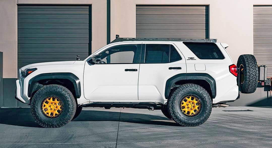

You can't fit 35
Seems you've kept the stock tire as a spare? That's gonna feel pretty odd on the freeway should you have a flat, no? Does the MT wheel fit underneath?
Also, seems the King's won't be fitting the 25....
No 35" spare tire won't fit underneath the 2025 4Runner. There's a width issue - front to rear, but also an issue of the spare tire hanging too low.

So the 35" spare tire will need to be stored inside the truck?

I see. However, I saw that the total payload of the hybrid 4Runner is only 895 lbs. With all those heavy bumpers (easily 200-300 lbs each + tire) and racks and tools, not much will be left for passengers...

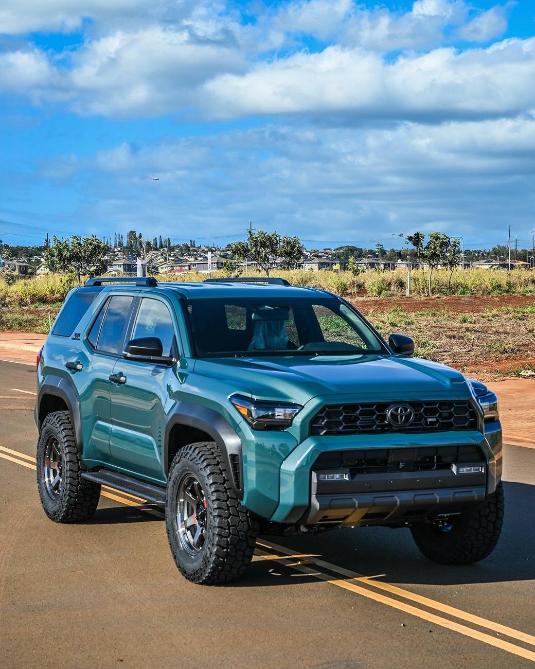

I was skeptical when I saw "35s on a 4runner" but that actually looks like they fit really well on the Everest pictures. 33's seem more appropriate for a midsize SUV, but if those 35's work with zero rubbing, nice job Toyota.

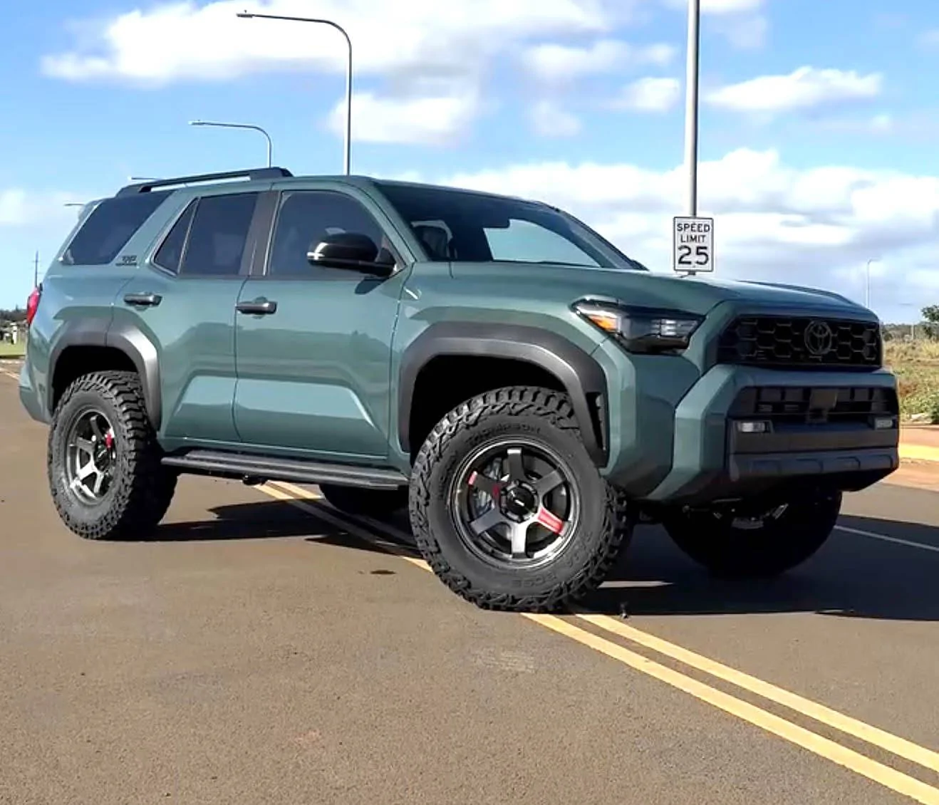

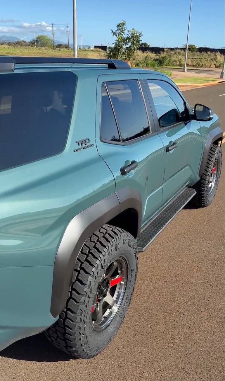

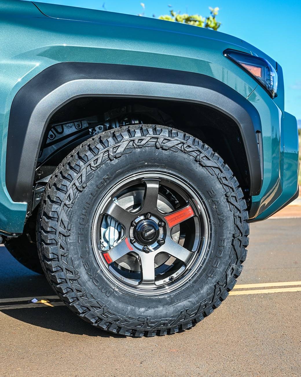

Here's a video / pic look which shows how much tires poke out. Also shows unedited / unprocessed look at Everest color.
VIDEO
Tire Poke
35s level lift kit aftermarket wheels on 2025 4Runner TRD Off-Road -- Mjmotorsports808 6th Gen...jpg
35s level lift kit aftermarket wheels on 2025 4Runner TRD Off-Road -- Mjmotorsports808 6th Ge...webp
The 295/70 R18's (34.5" D x 11.7" W) look and fit so much better IMO than the 35x12.5 R17's! They will be easier on the transmission too. Great choice!

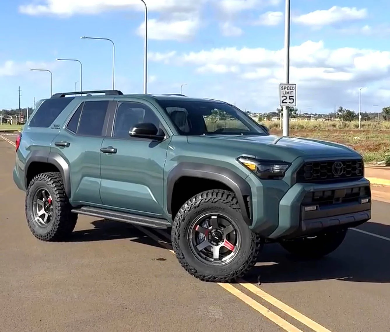

2025 4Runner TRD Off-Road 6th gen build by MJMotorsports808 ?
Mods / specs so far:
  • Rays Volk Racing TE37SB SL Pressed Graphite 18x8.5 +22 Offset Wheels
  • Mickey Thompson Baja Boss AT 295/70/18 (35s / 35" Tires)
  • Ready Lift 1.5 Front Leveling
  • Minor trimming required
  • Air dam removed
Kings Suspension and Seibon Hood to be installed next they say.

Added a video look and some pics showing tire poke and Everest color unedited / unprocessed.

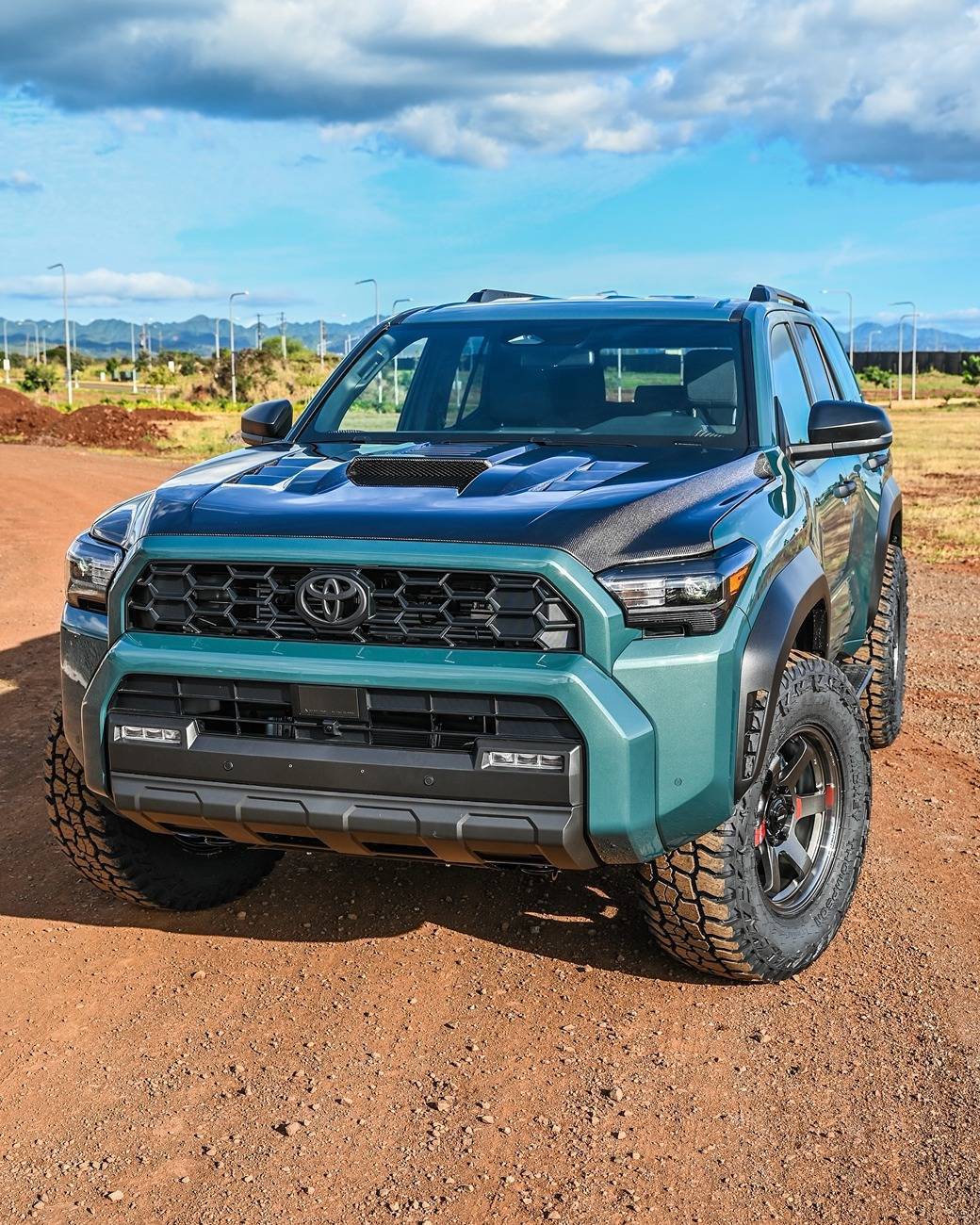

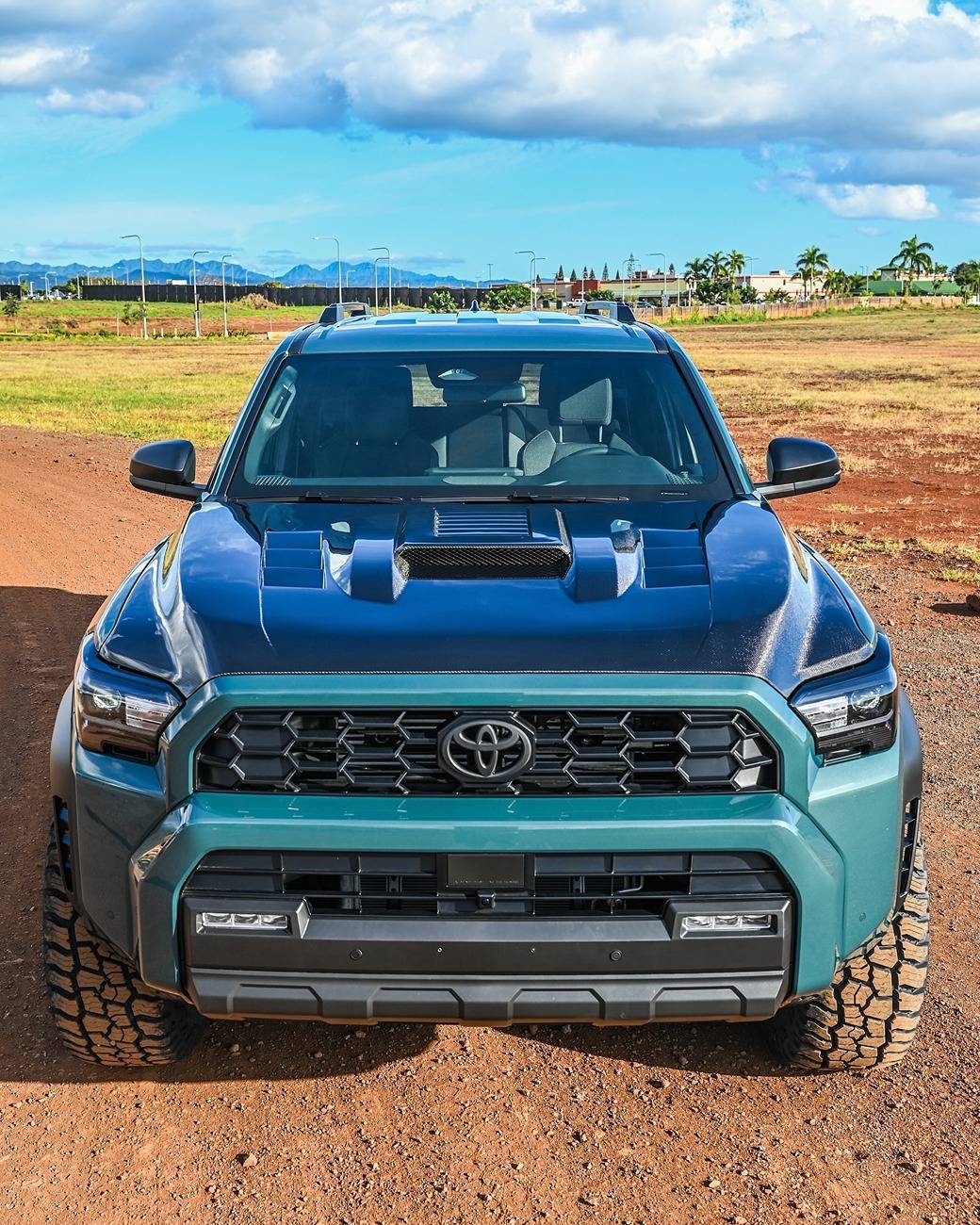

Update: Seibon Carbon Fiber Hood installed
Dang! 295/70/18? Those the tire touch the upper control arm? What was needed to be trimmed?
