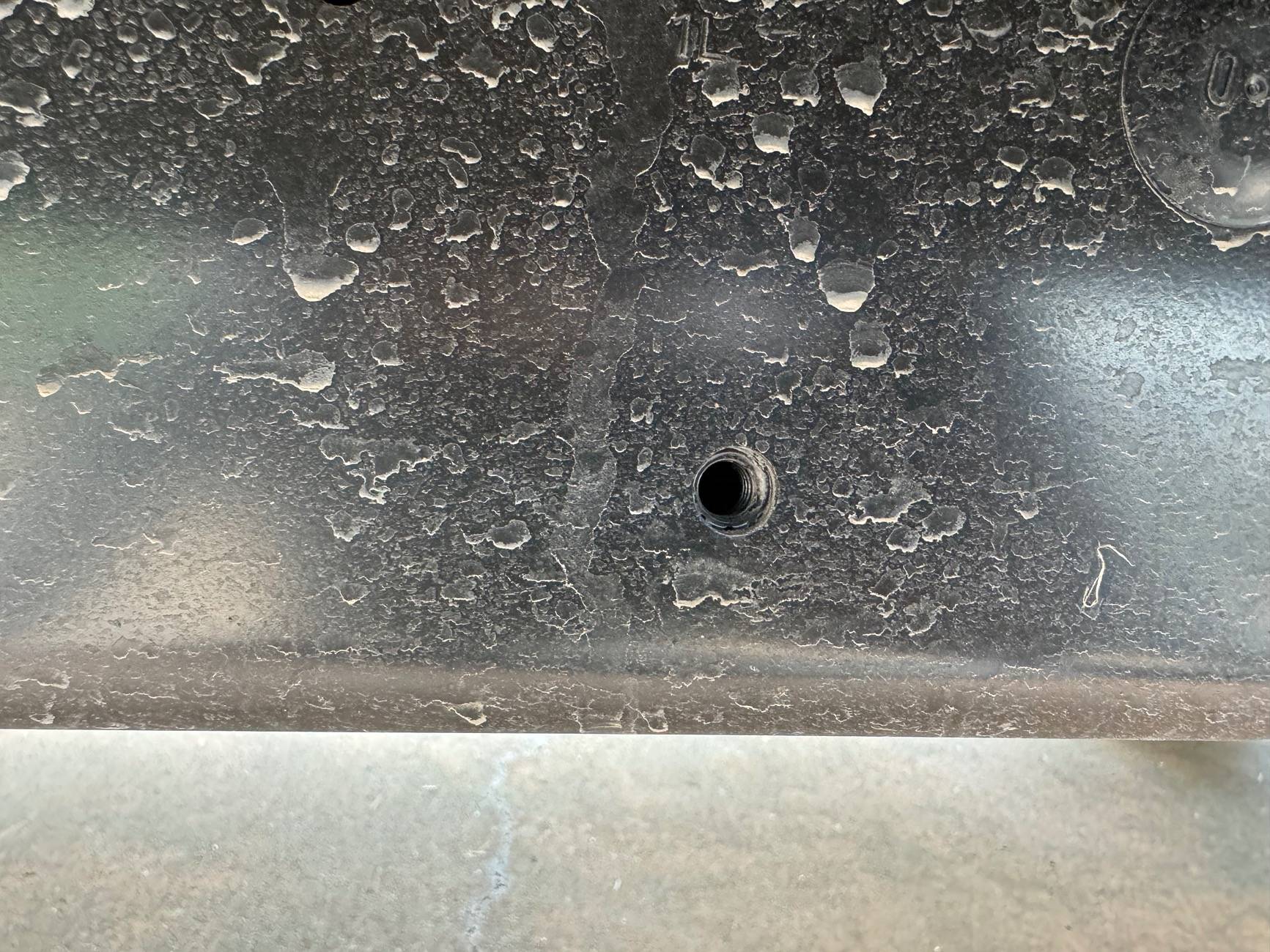

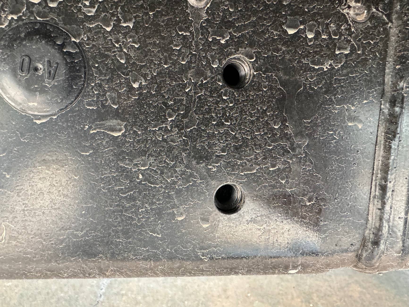

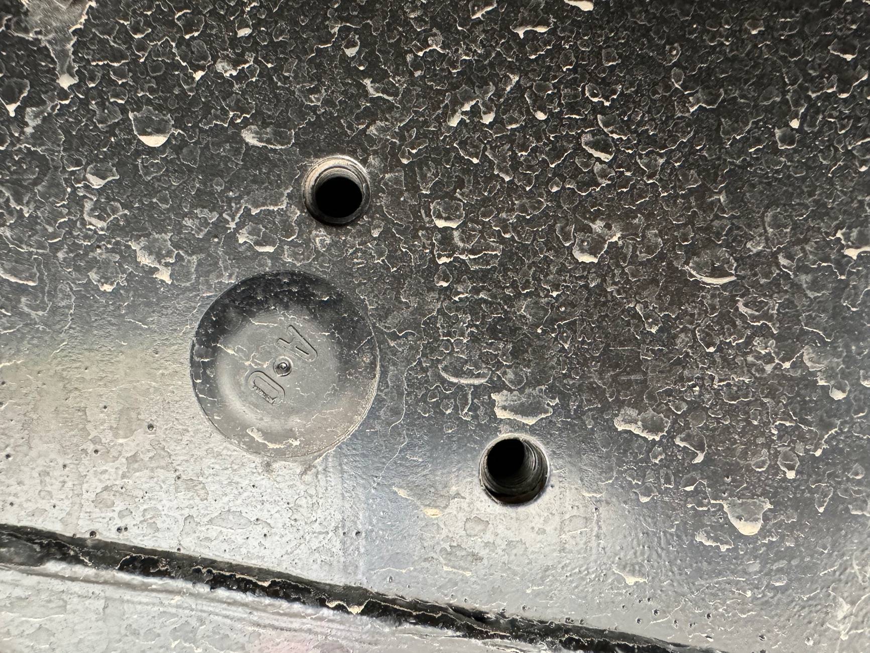

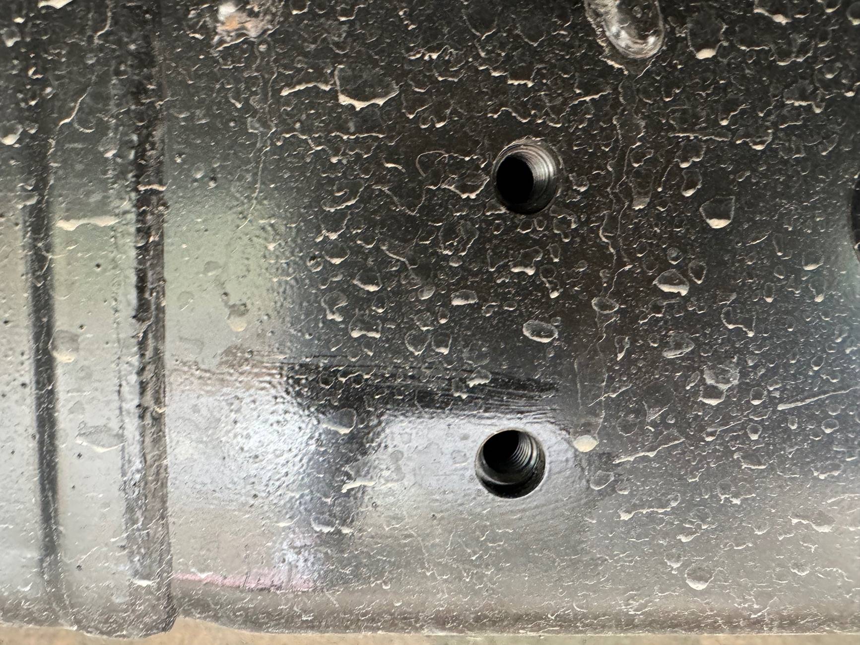

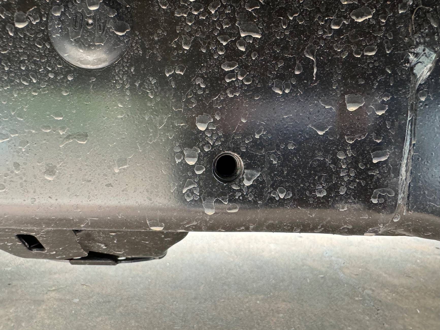

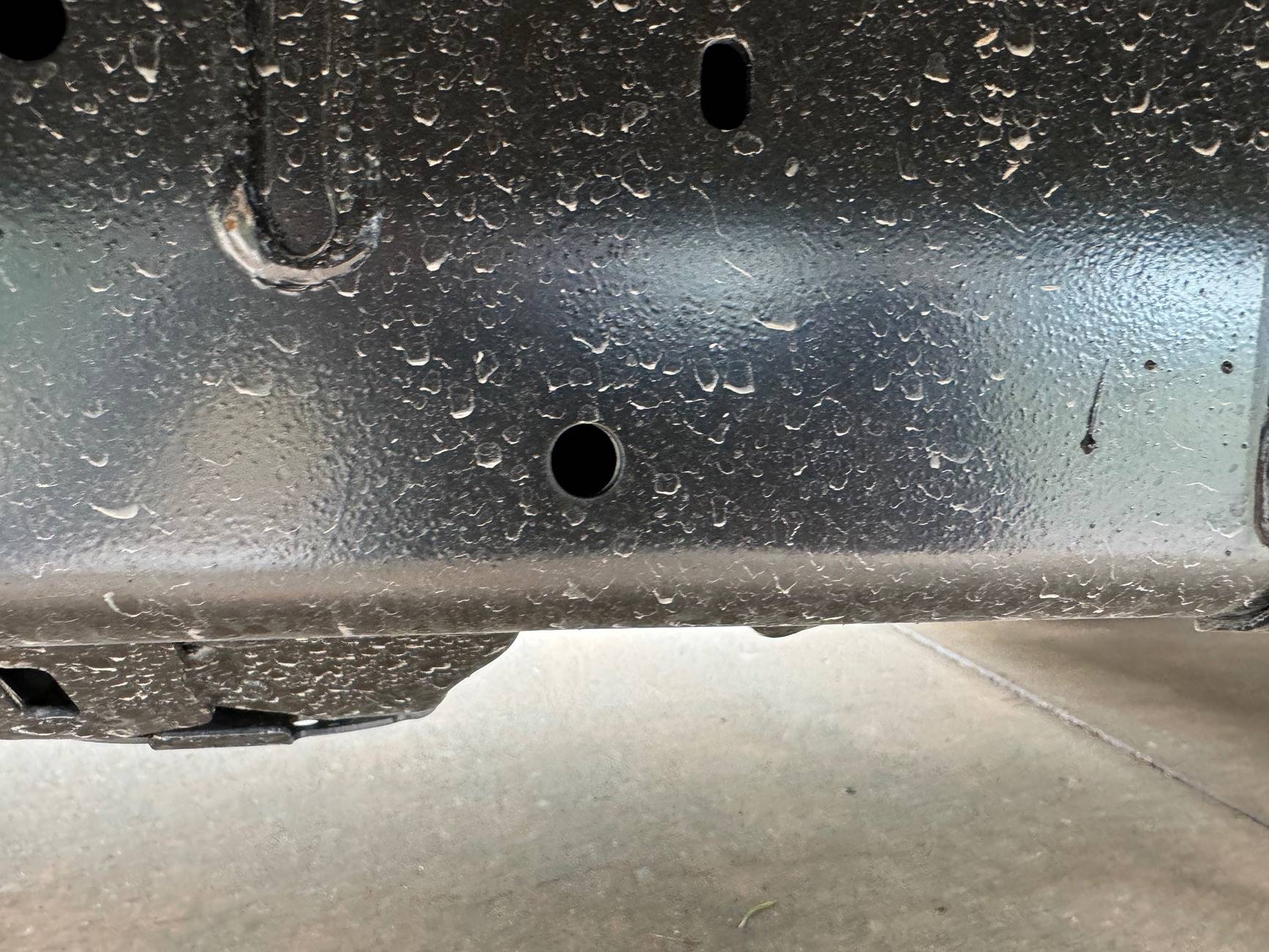

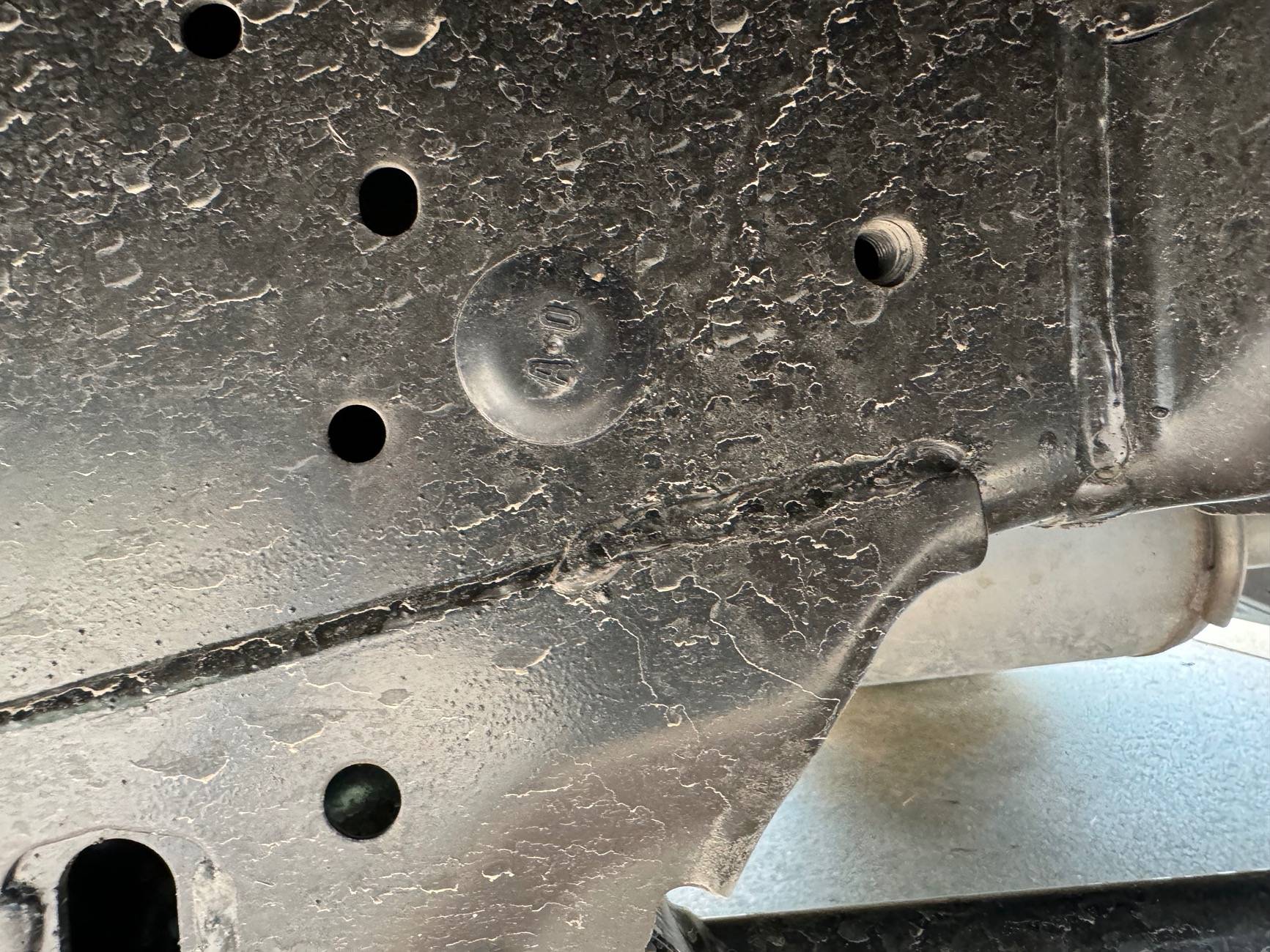

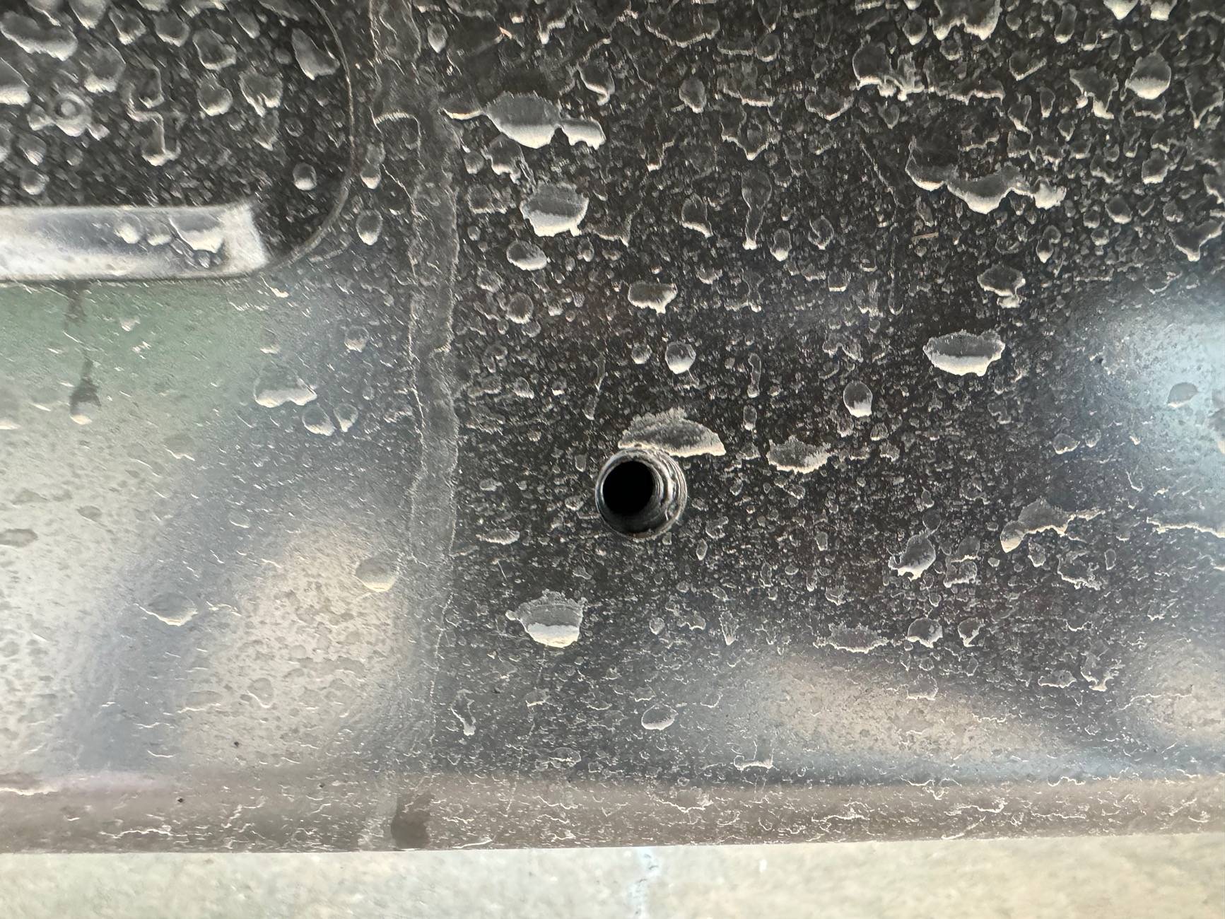

So, this seems to be a pretty big QC issue. The left and right side of my PRO have different threaded holes. Not all are the same and it seems a bit random. Below are pics for the Driver side, from front to back and then I'll do another post for the passenger side.
Here is the passenger side, from front to back:
