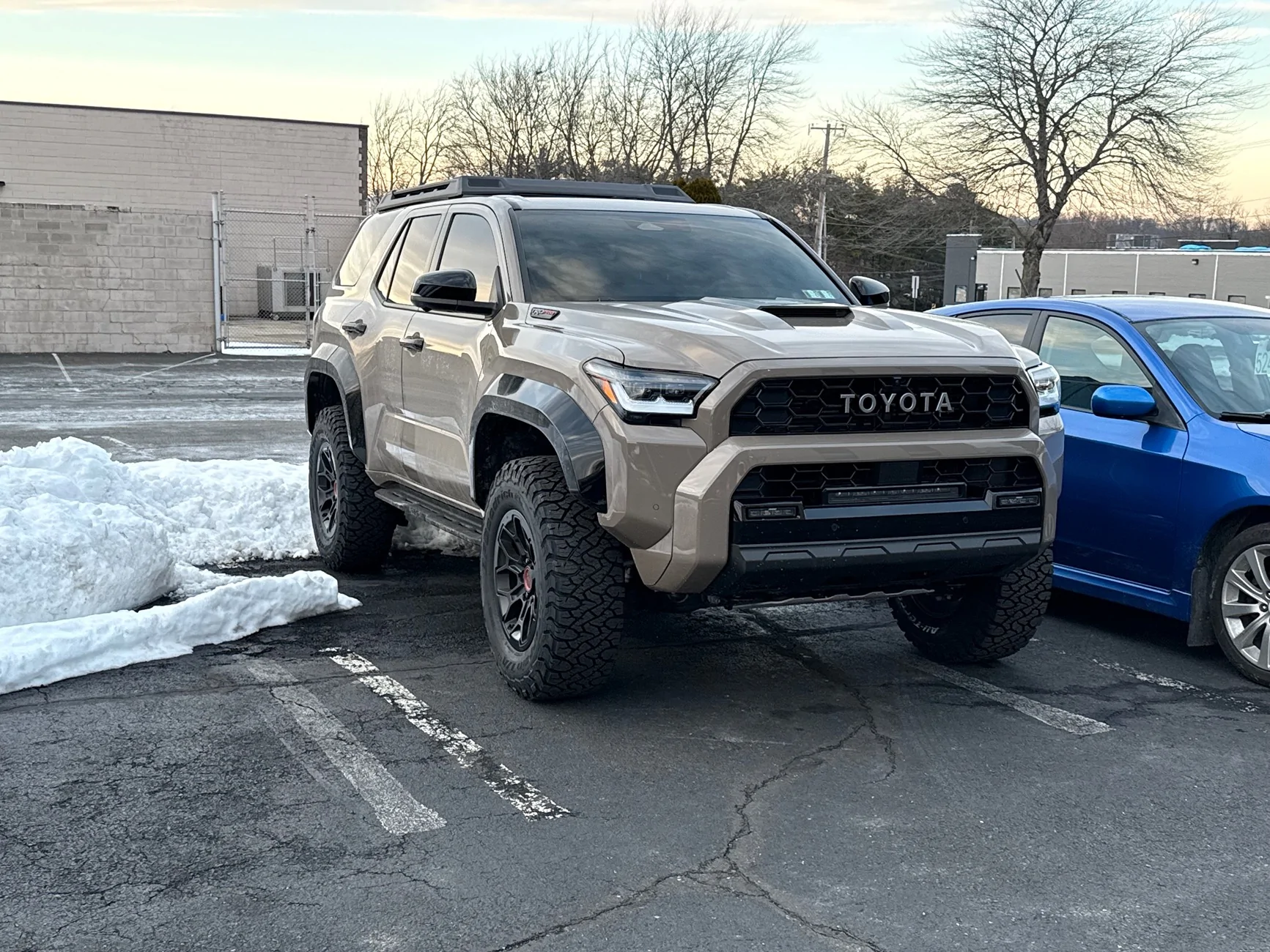

Upgraded to 285/70/18 ko3s. So far so good. Also a 2” lift-level kit to round things out.
Looks sick man! Did you go with the Torq lift? I am thinking about getting it when the current OEM tires need changing. Any trimming or crash plate deletion needed? Thanks in advance.

I did the torq lift for it - yep.
I also got ARK crash plate delete covers and just put those on at the same time as a preventative measure. Not sure if needed but figured for the price just do it.

Cool, thank you Chris. I’m looking forward to doing the same here soon. Are you happy with the way it drives?

Yes, drives well you just need to make sure you run the proper PSI in the tires to get it smooth (~35-37 psi).
As for your other question that I forgot to answer, no trimming needed.
