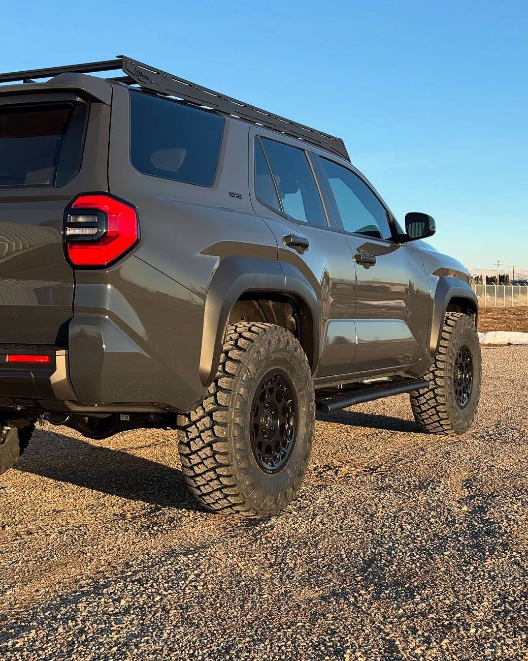

Underground SR5 2025 4Runner 6th gen build with:
Prinsu Pro rack
CBI skid plates and sliders / running boards
Peak Suspension Lift Kit - 2 1/4" (2.25") Lift
17" Black Rhino Wheels
35" Toyo Open Country R/T 35x12.50R17

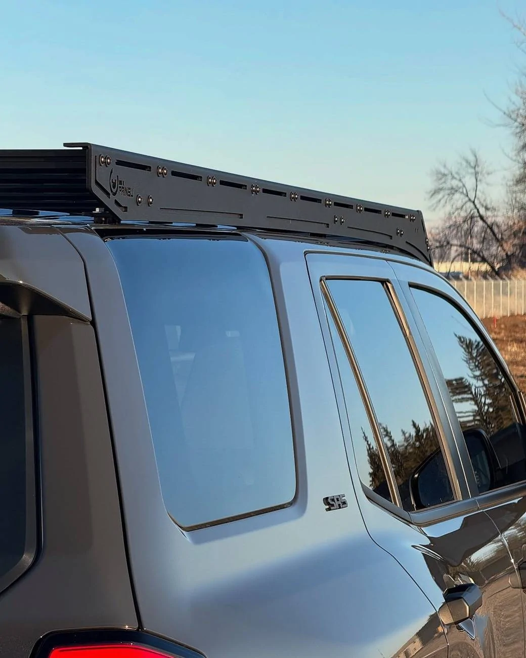

2025 2026 4runner 6th gen 6th Gen 4Runner Build: Peak Suspension Lift, CBI Skid Plates & Rock Sliders, Prinsu Roof Rack, Black Rhino Wheels, Toyo Open Country R/T 35's Prinsu roof rack

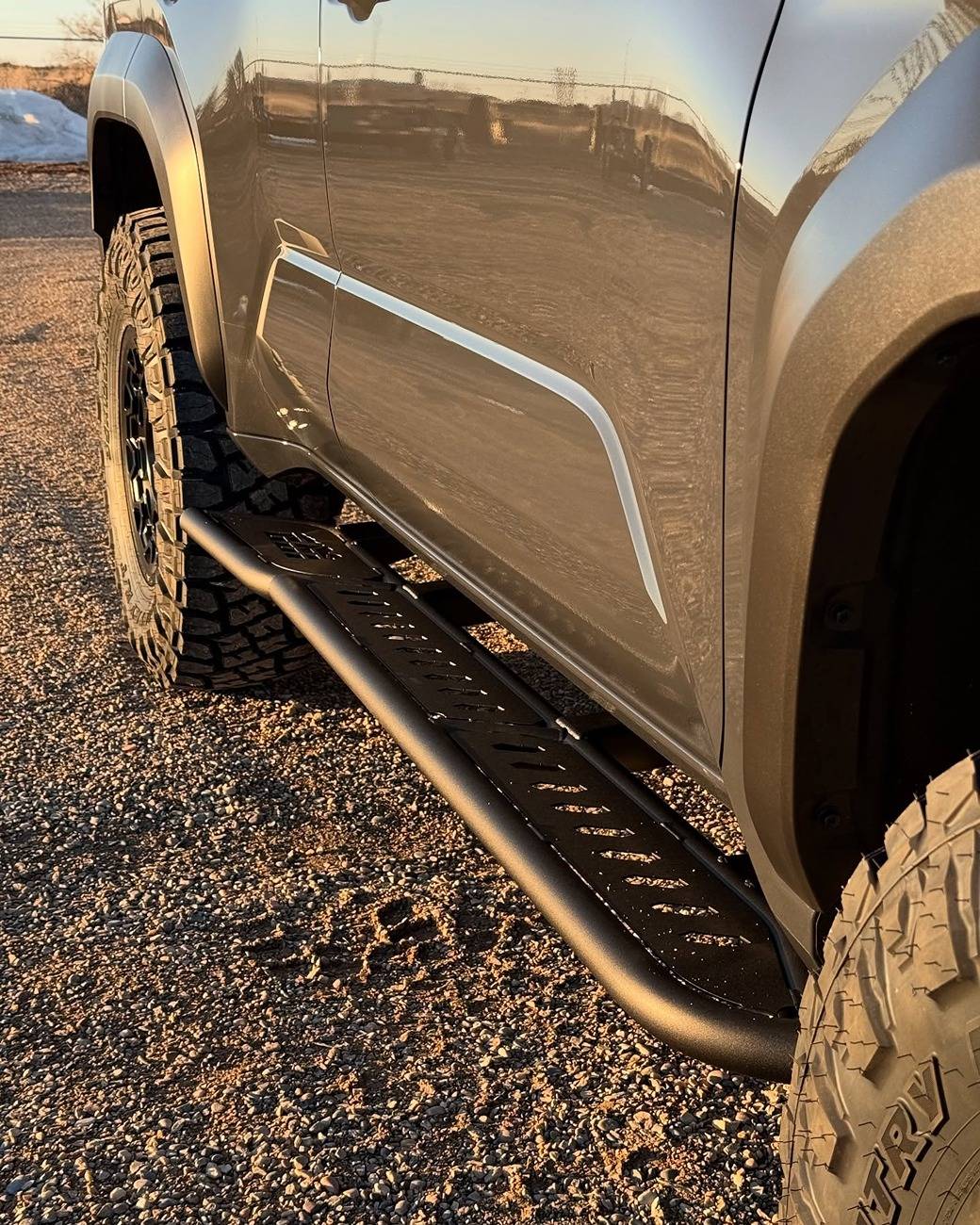

2025 2026 4runner 6th gen 6th Gen 4Runner Build: Peak Suspension Lift, CBI Skid Plates & Rock Sliders, Prinsu Roof Rack, Black Rhino Wheels, Toyo Open Country R/T 35's CBI rock sliders

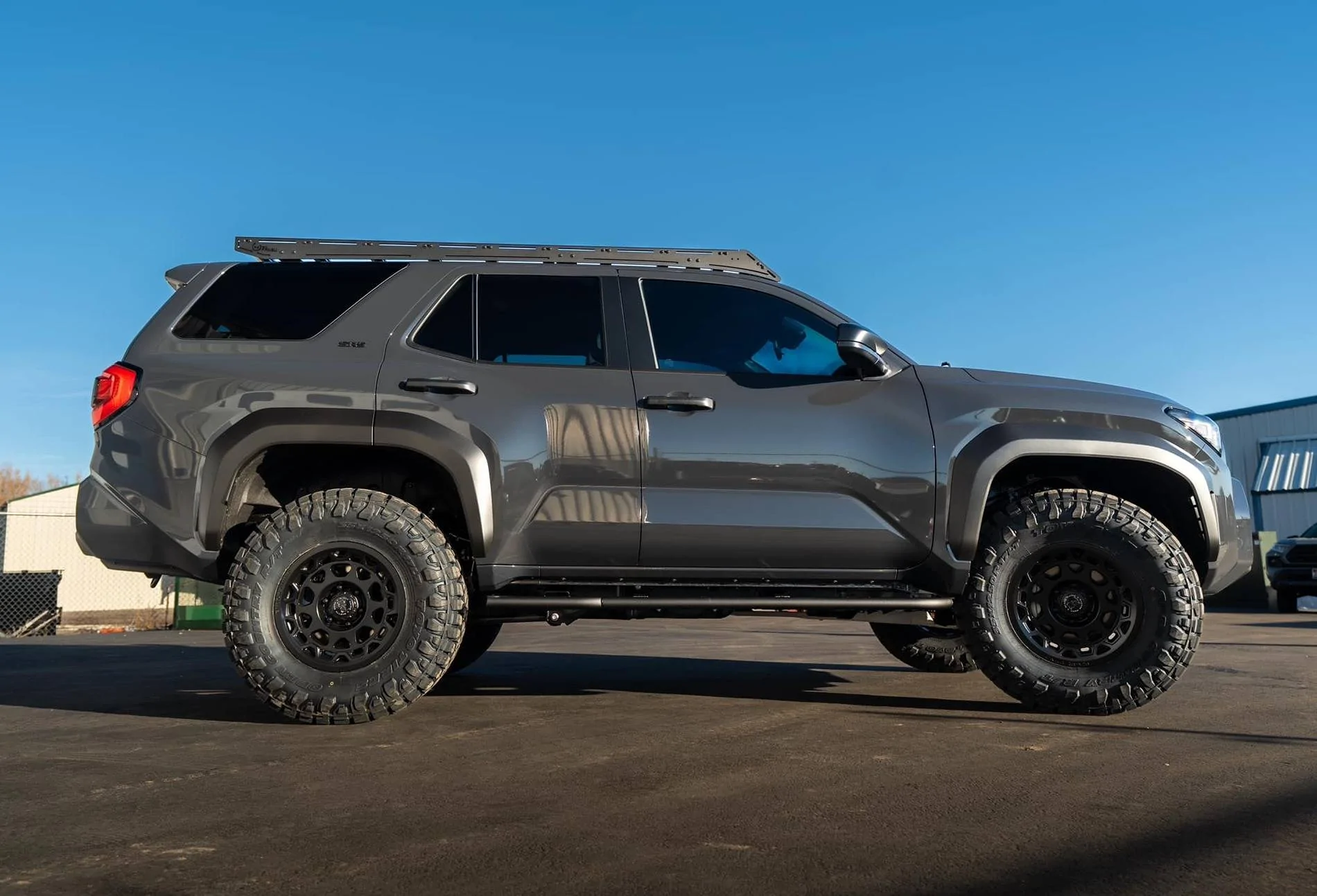

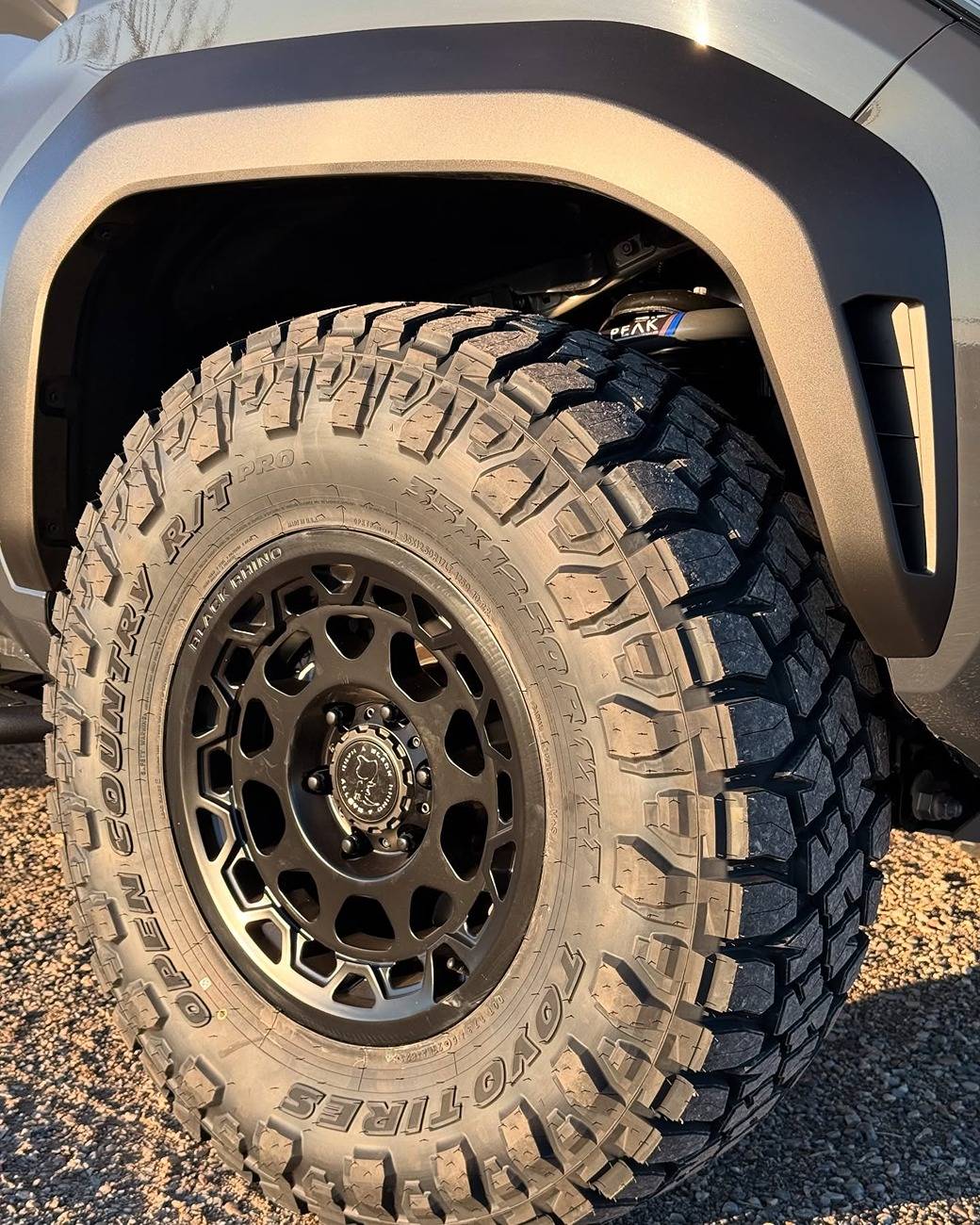

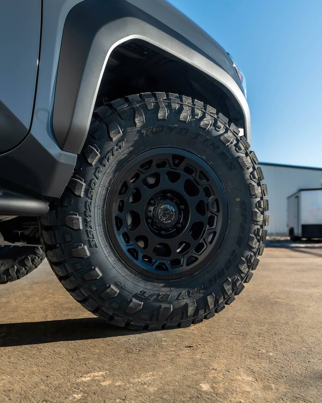

Looks sick Mark! Very cool. Did you have to do any trimming for the 35's to fit? Or all good with the lift? Thanks!

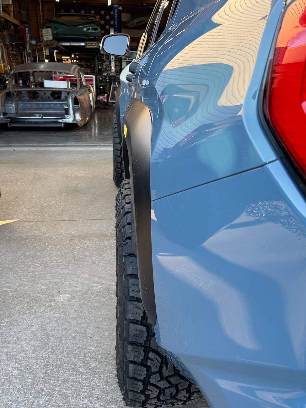

Build looks great! Same question here regarding wheel offset. I’m looking to run same 35” tire size. Heard positive offset 25-35 is optimal for 6th gen’s but still keeps some poke.
just installed the same peak lift on mine today, with a. +25 offset 17x8.5 with 35x12.50 toyo at3. perfect amount of poke. I removed etc rear plastic and brace, in the front I will trim up some tomorrow, it does rub on the front little bit when flexing on reverse like going out a drive way.

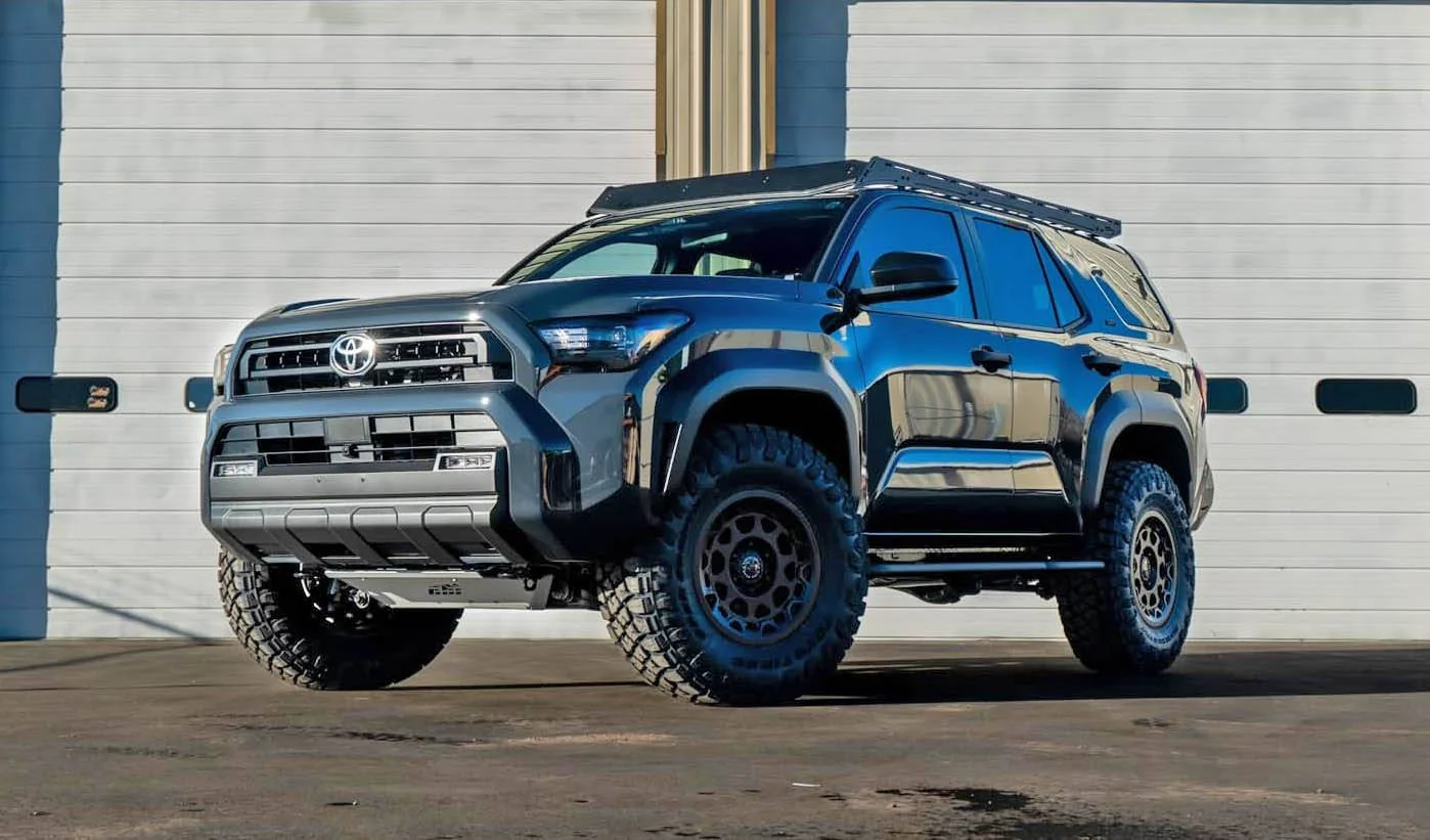

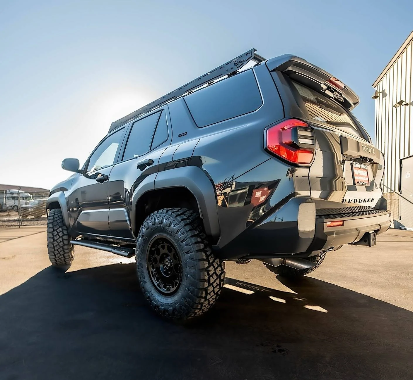

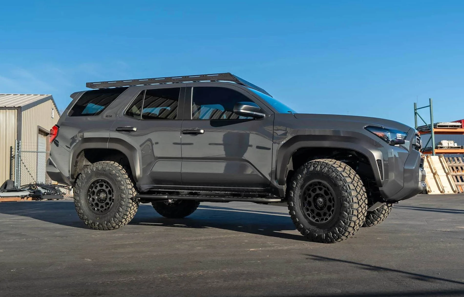

it looks great! How does it ride with that Peak spacer lift?

Mine rides Great! little firmer then stock, and way more planted feeling, less body roll. Highly recommend
Did you replace the upper control arms or any other parts to do the lift? What about shocks?
