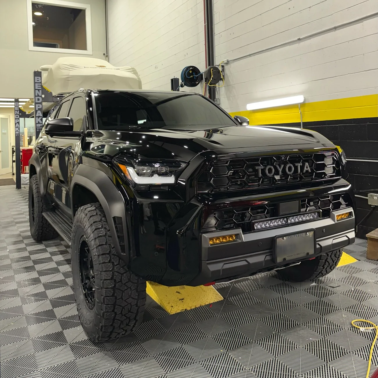

Wha exactly did you have to do to get those 35s to fit? Crash played, mud flaps and pin felt? Plus any trimming / viper cut?
thinking of going 295/70/18 to try and avoid trimming
Only the front mud flaps and crash plates were removed - no trimming or cutting required. That said, I haven't taken it off-road yet, so I'll provide an update if I notice any rubbing on the trails.

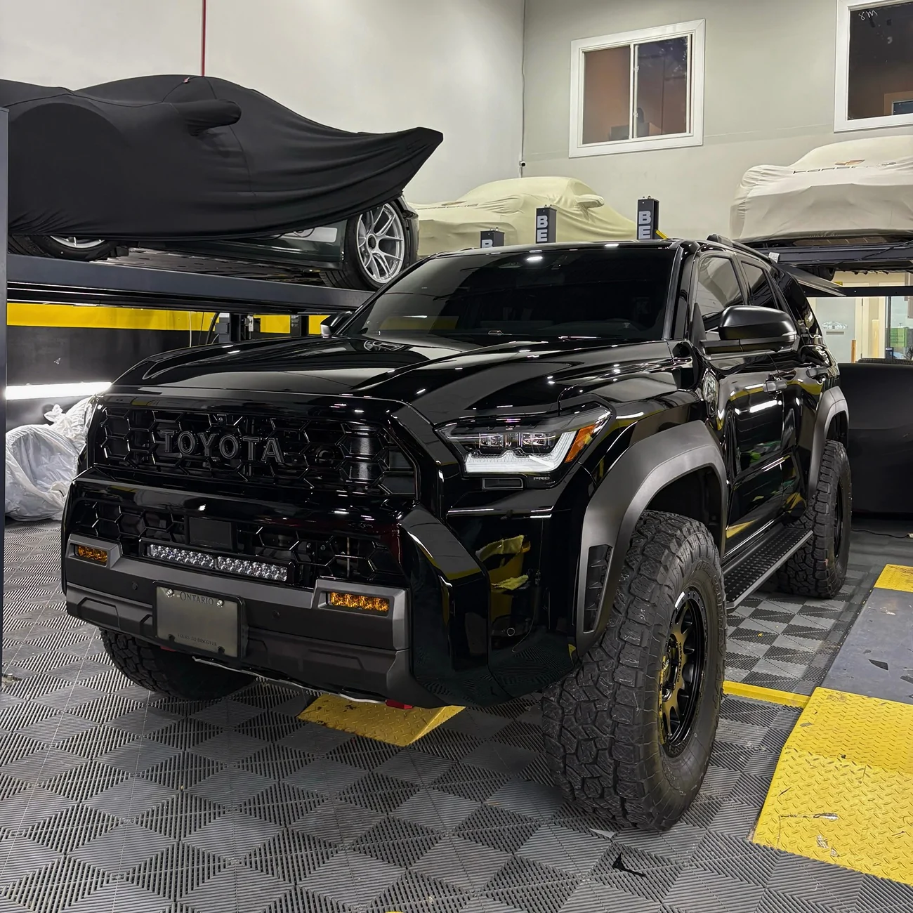

Some more photos post-PPF below. Went with XPEL PPF and ceramic coating.
Some thoughts for when you do get off-road...
I'm also a TRD ORP. Running "pseudo" 35s: 285/75R18 Toyo A/T III - so 34.8"x11.2" - vs. your true 35x12.5. When I had them on +20 TRD Pro wheels the rear tires rubbed the fender flairs at articulation up. I switched to +45 TRD Flat Black option wheels so they would clear. Without lifting your rear I am fairly certain your 1.3" wider tires will contact the fender flare with your +25 offset and 12.5" wide tires. Just something to think about before you try that level 6 trail:>)
My 34.8" tires now clear the flare but do contact the inside of the wheel well at full articulation when going uphill (over rocks) under power. No apparent damage potential but this has me contemplating a bump stop plus extended shocks to not loose articulation (which the bump stop would do).
On the front I am surprised you are not contacting the air dam screw tab - it does bend up easily out of the way, but I needed to do that with the +20 wheels (no contact with the +45) - and again, the wider tires would seem even more likely than mine to make contact. (caveat: I've got the 1.25" peak level spacer but am not sure it matters much to this minor rub).
Build looks great. No criticism meant with this post - just offering info from my experience.
