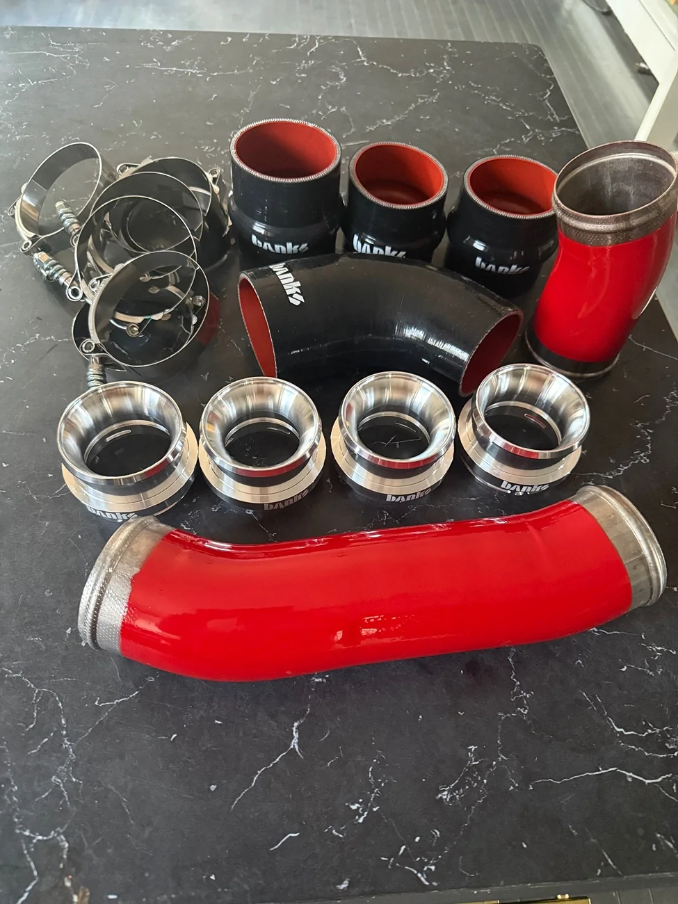

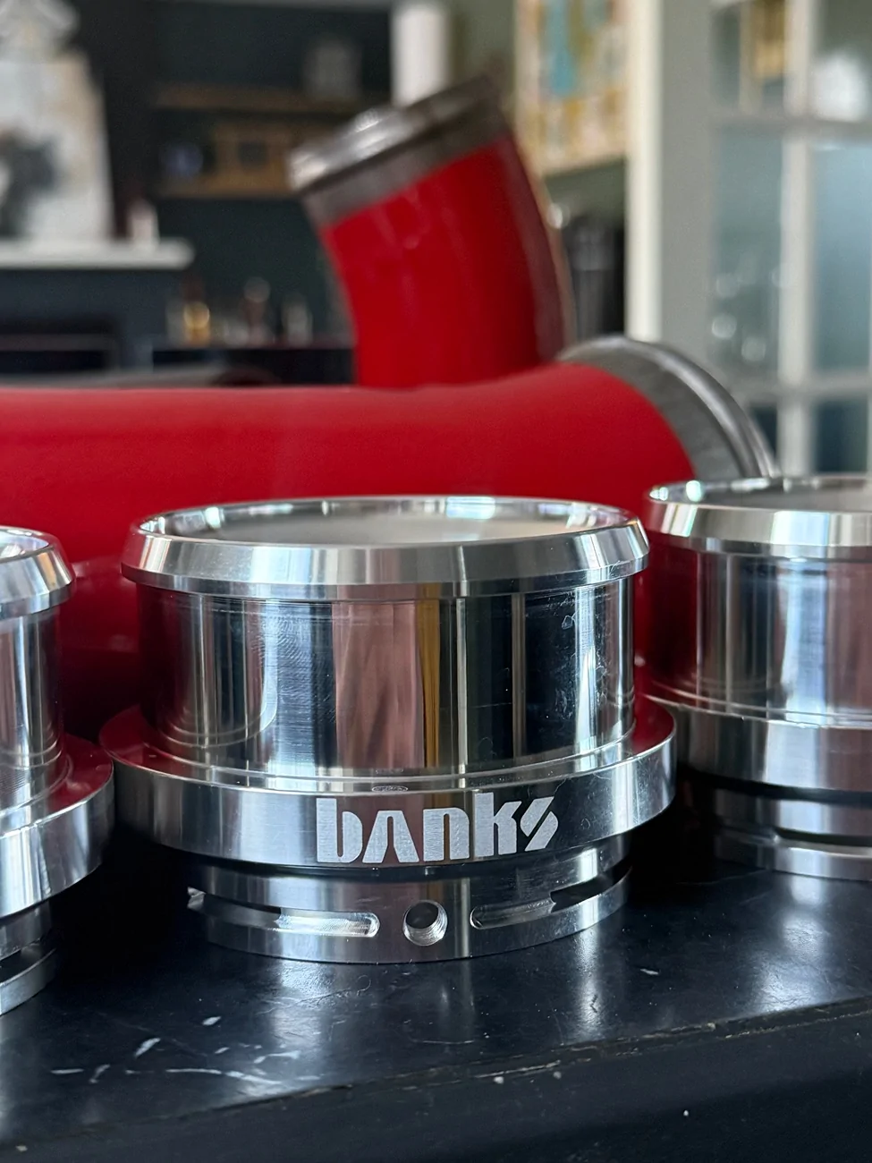

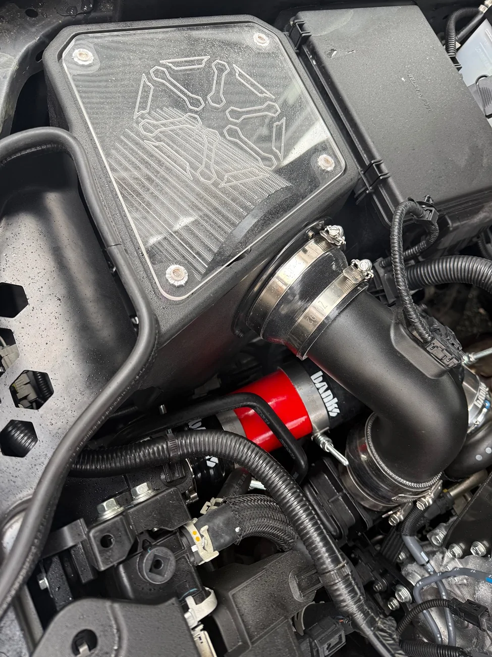

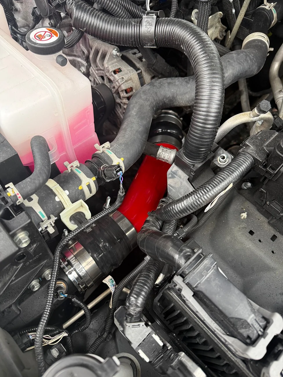

I can’t get over the quality and care that went into these. Crazy impressed
Install was very straight forward and provided instructions and video from Banks. 3 hours total in the freezing cold lol. Toughest was the cold pipe and just feeding the runner coupler on.

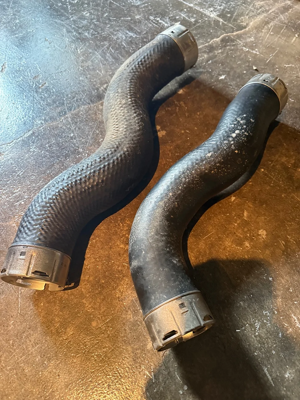

I just don’t see the point. The factory ones do not have horrible bends. The inlets and outlets are still the same size.

They route the intake charge in through the intercooler and out into the intake tract . Stock tubes are rubber hoses with metal connectors, replacements are usually constructed of aluminum tubing with silicone and billet aluminum connectors Aftermarket are usually larger diameter and dissipate heat where rubber won't, and aftermarket tubes shouldn't flex. The reduction of restrictions in the intake tract reduce heat while increasing flow which will make a little more power. Are these a game changer? A little, but when adding a CAI, a better Turbo inlet, exhaust and tune, these items can make a beneficial difference. I don't think these are for our pocket protector, slide rule crowd worried about how to soften their ride. Heat is the enemy of power and these definitely help
