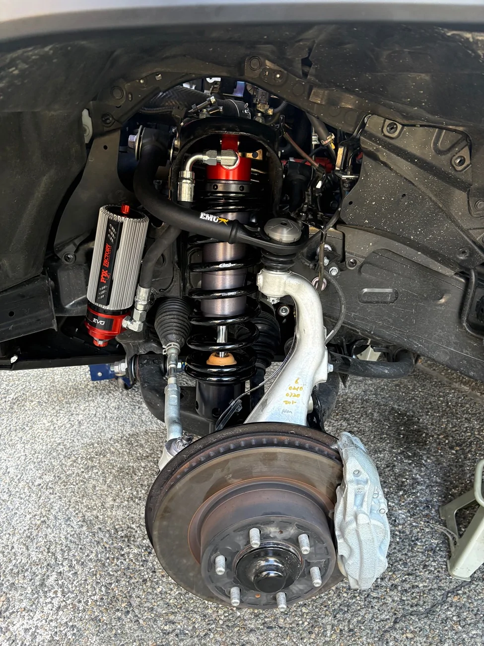

Next up was the suspension. I decided that if I’m going to do it then I wanted a substantial upgrade over stock. I wasn’t too happy with how soft the stock suspension was going over obstacles - it definitely contributed to the running board damage - but I didn’t want to sacrifice all on-road comfort. That meant I was looking at adjustable shocks. I wanted a very mild lift. I did some research and settled on the Fox FRS 3.2s. A bypass shock has some significant advantages. I considered waiting for the Bilstein 8xxx shocks to come out, but I guess I’m a little impatient.
2025 2026 4runner 6th gen 2026 TRD OR Everest Build. White wheels. Fox 3.2 suspension IMG_3258
The install process was not smooth. I strongly recommend avoiding these until Fox fixes the reservoir mounting. It’s over engineered and in trying to be clever and cut costs they designed a mounting scheme that is entirely too hard to install. It’s absolutely ridiculous that they thought it was OK to put this product out.

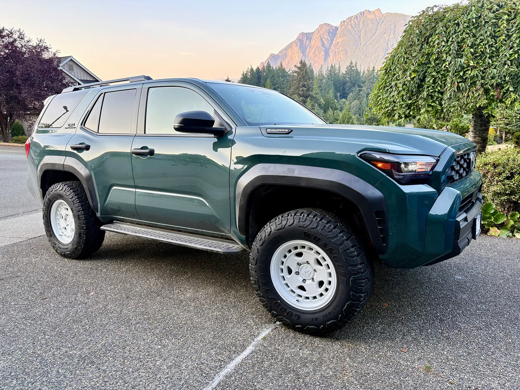

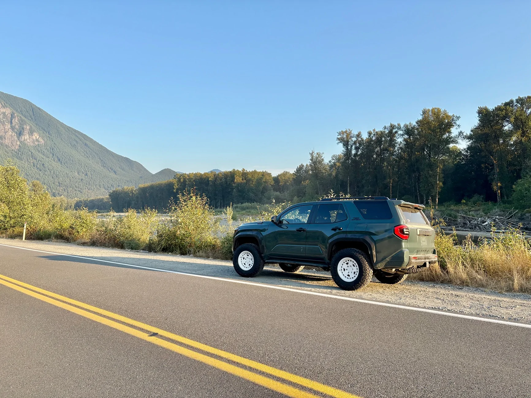

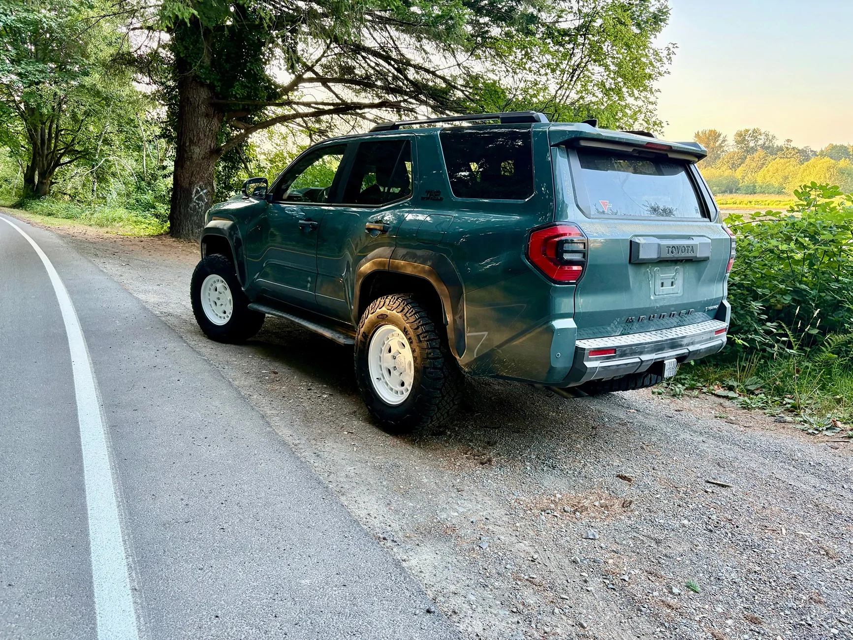

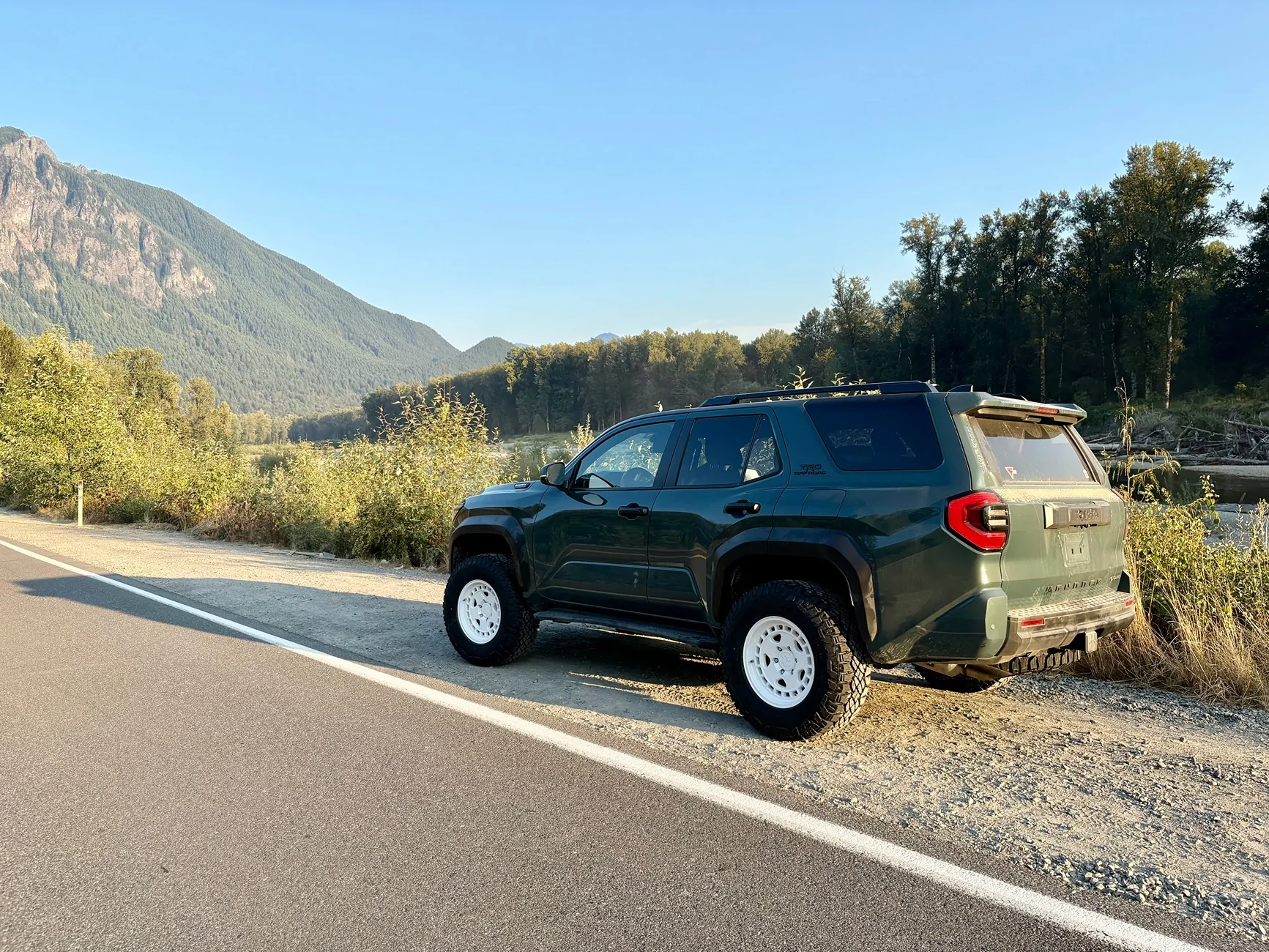

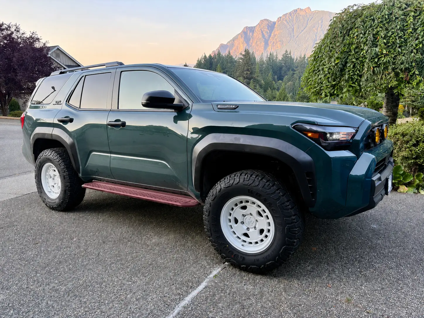

Next up, the controversial piece: white wheels. I really wanted to do something unique. We’ve all seen enough builds with bronze and black wheels. It was a risk but I’m happy with how it turned out. I was going for a retro-ish rally car look. I was considering polished wheels like AR 172s or Procomp Vintage but I decided to take the risk.
Fifteen52 Turbomac HD wrapped in 285/70r17 Duratracs, E rated.
I’ll probably paint the centercaps to match the body.
2025 2026 4runner 6th gen 2026 TRD OR Everest Build. White wheels. Fox 3.2 suspension IMG_3287
2025 2026 4runner 6th gen 2026 TRD OR Everest Build. White wheels. Fox 3.2 suspension IMG_3285
2025 2026 4runner 6th gen 2026 TRD OR Everest Build. White wheels. Fox 3.2 suspension IMG_3284
2025 2026 4runner 6th gen 2026 TRD OR Everest Build. White wheels. Fox 3.2 suspension IMG_3283

Looks good! Those 3.2 looks like they are cutting close for sure, and that’s crazy with the C4 skid plate. I personally like the white wheels and wanting to put some in my new 2026 TRD ORP I just got. I have ā€œCutting Edgeā€ so I’m not sure how it’s going to truly come out yet.

Plenty of clearance for the 3.2s to both the control arms and from the resi to the wheel. I had a bit of rubbing on the resi with the stock wheels at full lock so going to 0 offset was definitely the right move.

Nice build. Looks clean with the white rims. I see a lot of black wheels and yours is a change.

No hate from me. I love white wheels and am still considering them for my next set. Nice build so far!

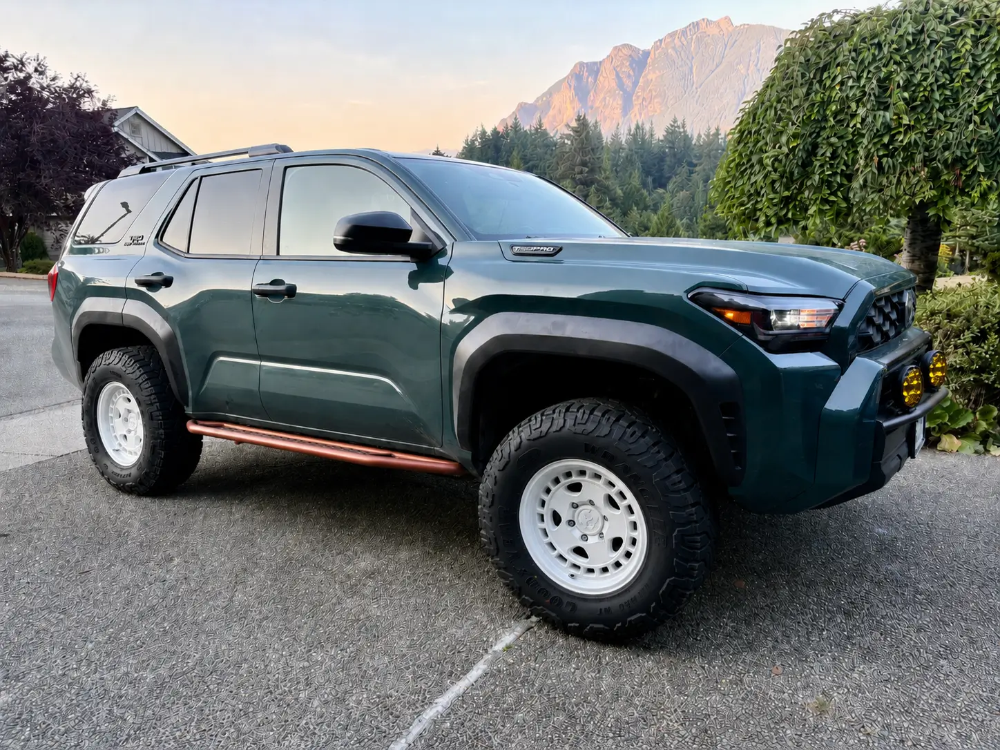

Going to get even more retro when the rock sliders come in. Deciding which color to paint them. (AI render)

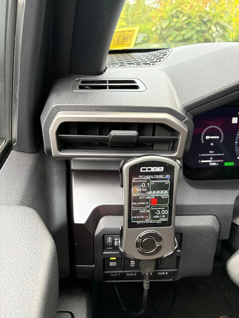

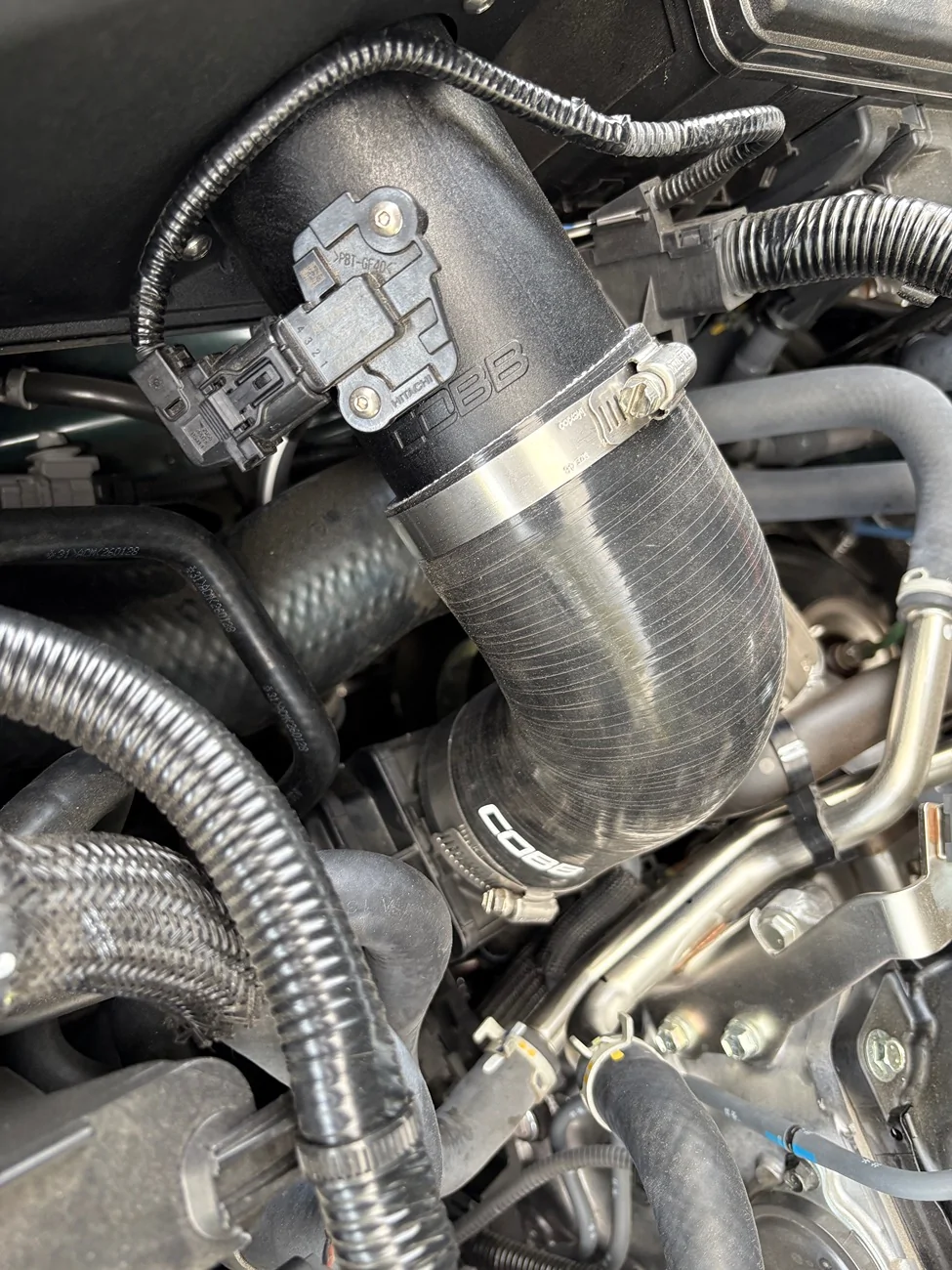

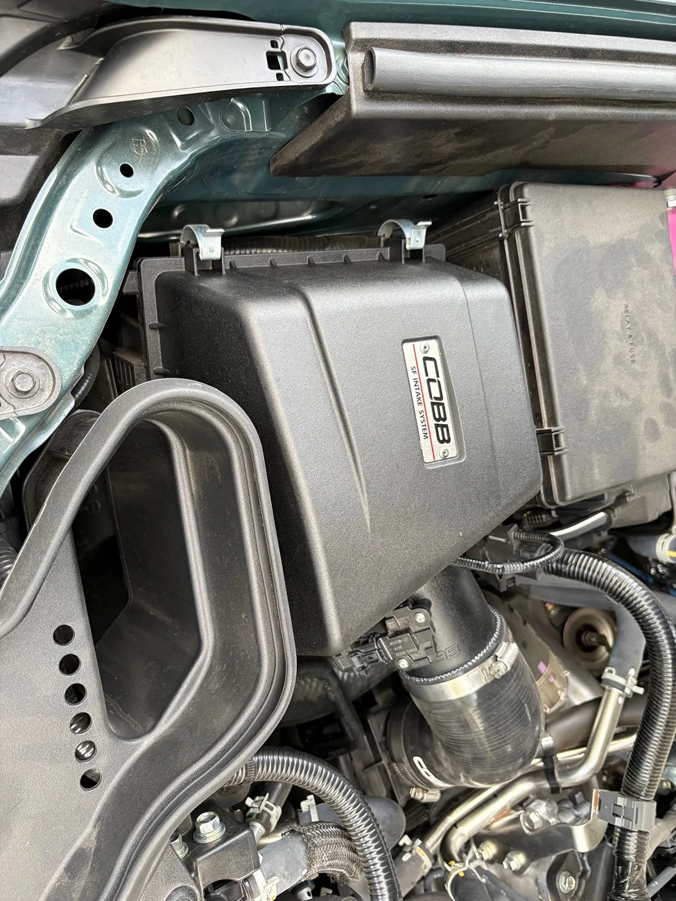

New parts installed! Cobb intake, AccessPort, and a custom tune from CAMtuning.
The tune makes a massive difference. More power, smoother, more responsive. No noticeable changes in mpg.
CAMtuning has been great to work with. Definitely recommend.
