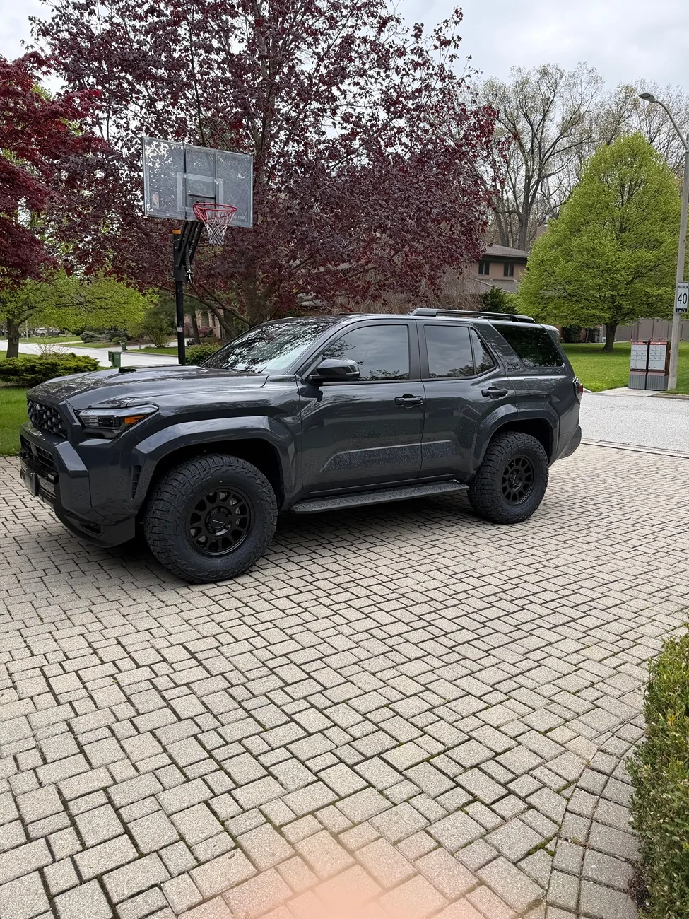

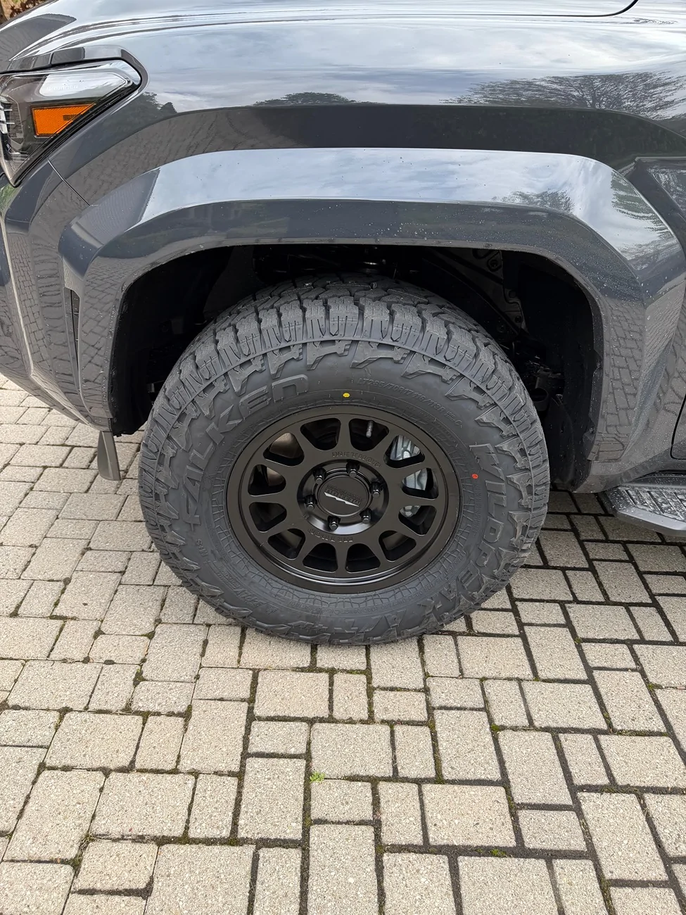

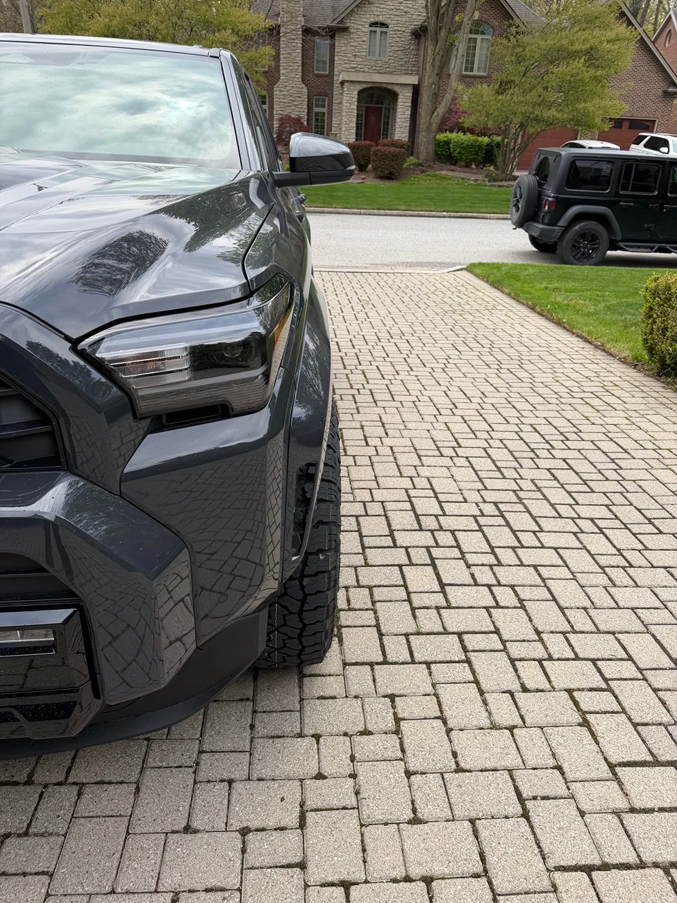

Hopefully this helps someone. I know I wasted a lot of time worrying about tire size, offset and the potential for rubbing without a lift.
Faliken Wildpeak AT4W C rated 285/70/17
Method 703, +35 offset
No rub, no issues everything stock.
Thrilled with how it turned out. Exactly the look I wanted. Aggressive, thick look and minimal poke.
Just won’t pay attention to fuel economy 😏

coming over from a wrangler, I find this car even with the bigger tires drives much smoother. I’m very happy with it. Here in Canada, I need good traction on wet/snow so they’re great for me.

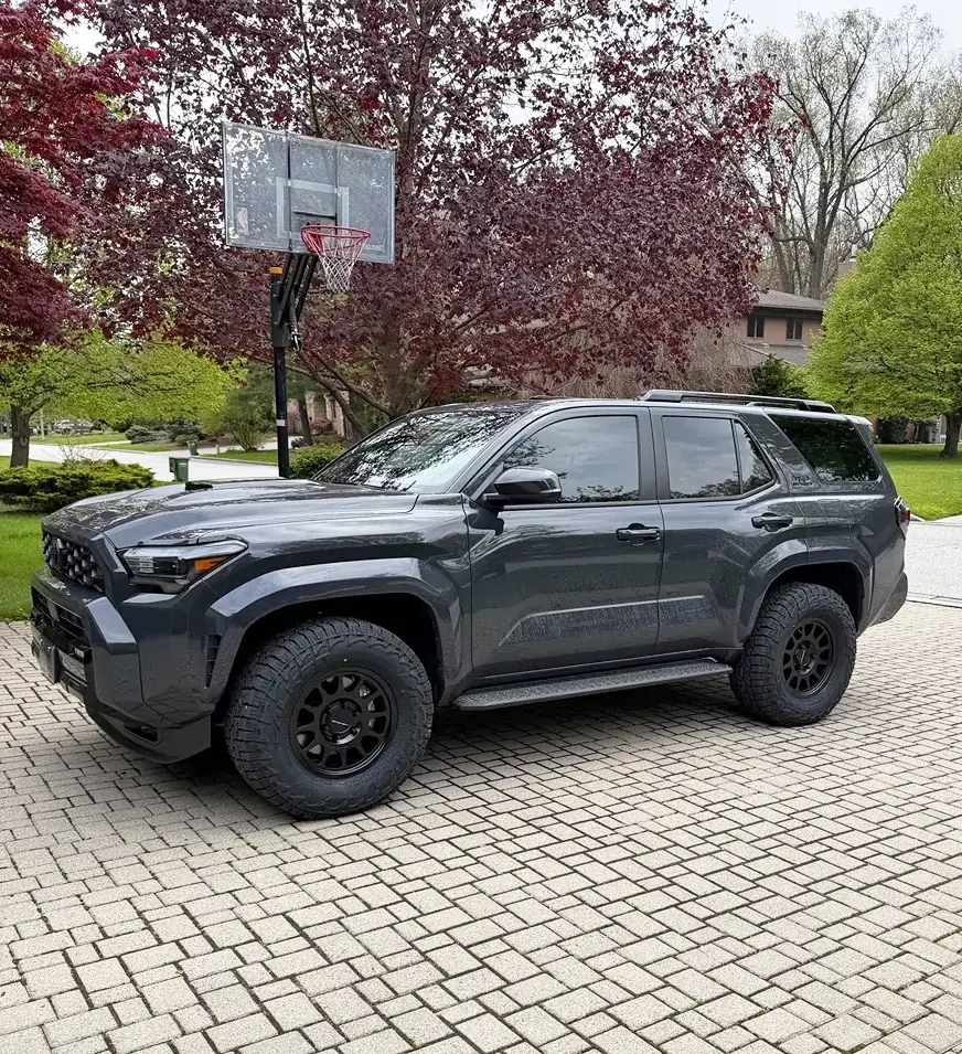

285:70:17 Wildpeak AT4W, +35 offset, no lift, no rub (photos).webp
Super helpful! I'm looking at this same setup for my SR5 but I did level the front end with the Peak 1.25" kit. I think it's going to look nearly perfect!
