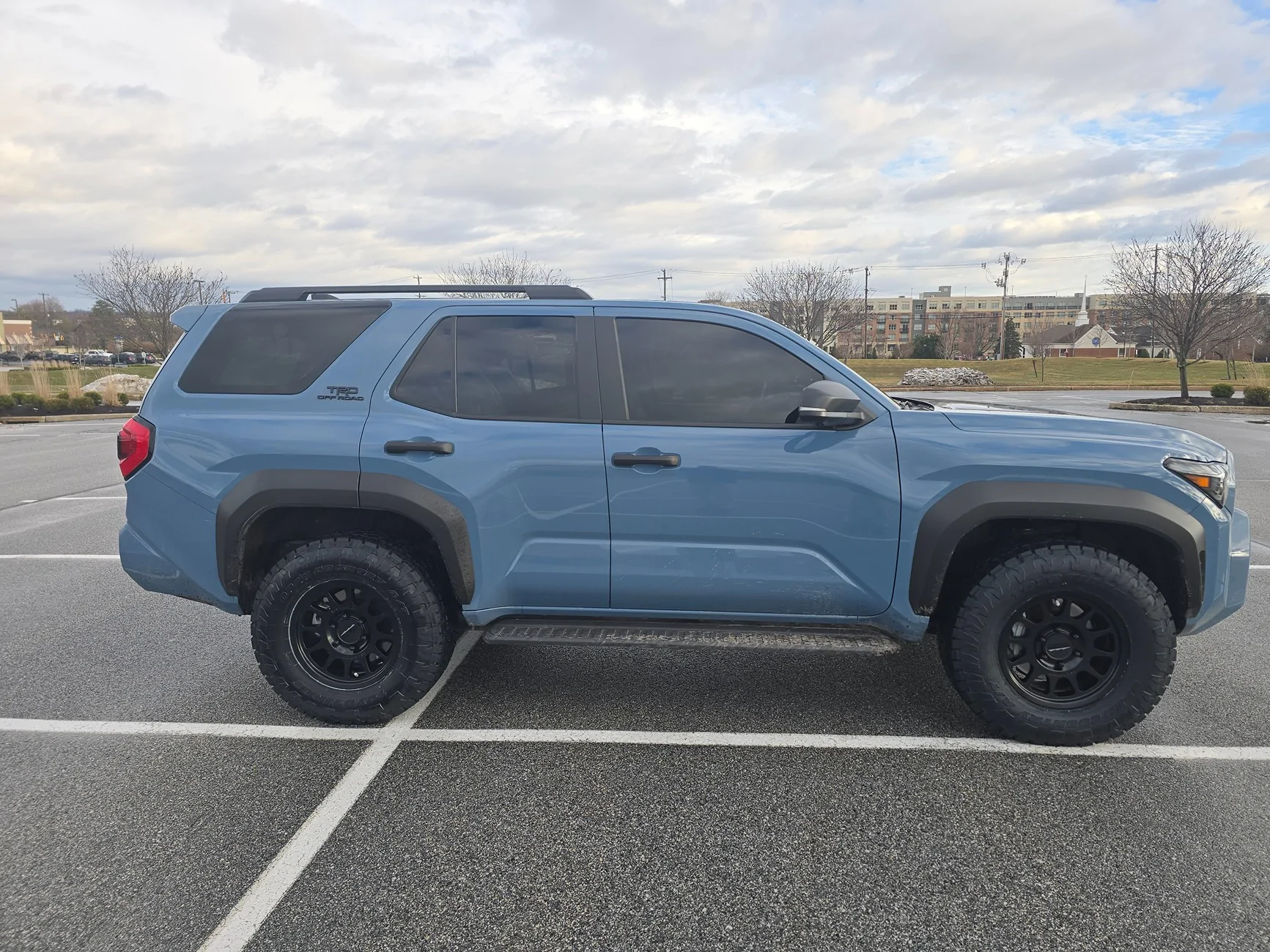

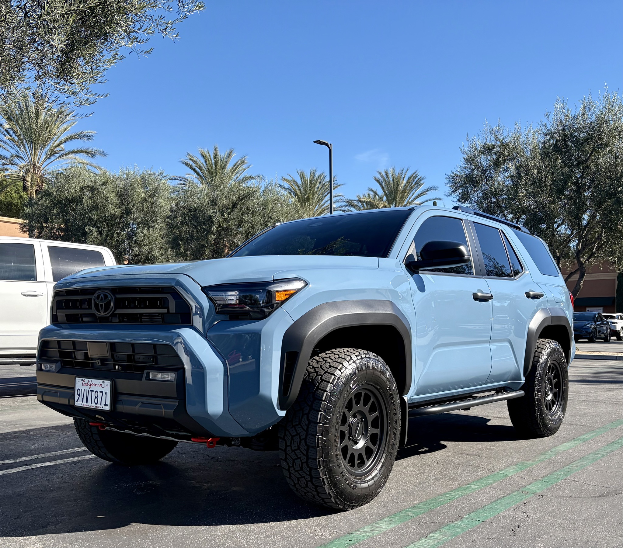

New shoes today. Very happy with how it came out.
Toyo AT3 285/70r17 Load C
Method 703 +35 mm offset
Peak Suspension 1.25" front level

I plan on getting those exact same Wheels. Do you know if the height is going to be any difference than stock? I can barely fit into the garage now. I want to make sure I can still park it indoors.

If you mean tires, pretty much the same diameter as the stock ones so same height. Fits in my smallish garage just fine

I'm getting the same tires and rims .so with 17in rims instead of the 18in stock rims would it actually sit lower?

No. It sits about the same. With the 17” wheel you get more sidewall of the tire than the stock 18s.
Stock 265/70/18 is 32.6” diameter
285/70/17 is 32.7” diameter

Just to confirm they won't rub in stock suspension? I'm reading on the 5th gen They rub but it seems on the 6th gen they do not?

I never had them mounted with stock suspension, I had the peak 1.25" level kit installed first. The 5th gen was much harder to fit 33s than the 6th gen though. The main thing that's going to affect rub in this scenario is offset. Since the factory tires on the Off-road trims are ~32.5", you are keeping the same diameter, but wider, and offset will make them sit wider from the frame, potentially causing rub.
I'm sure someone on here has done 285/70/17 tires on +35mm wheels with no rub but its not me. That being said, I don't think they are going to rub on stock OR suspension.

Thanks. Did you install those mud guards yourself? If so, which ones did you install? And was there any drilling?
I had the stock OEM ones and swapped them for the Trailhunter/pro ones. Just a little wider. No drilling, just removing screws and re-screwing them in.

My ORP did not come with mud flaps so I'm wondering if the holes are already there. I noticed somebody with a SR5 had to drill holes to fit the TRD Pro ones
