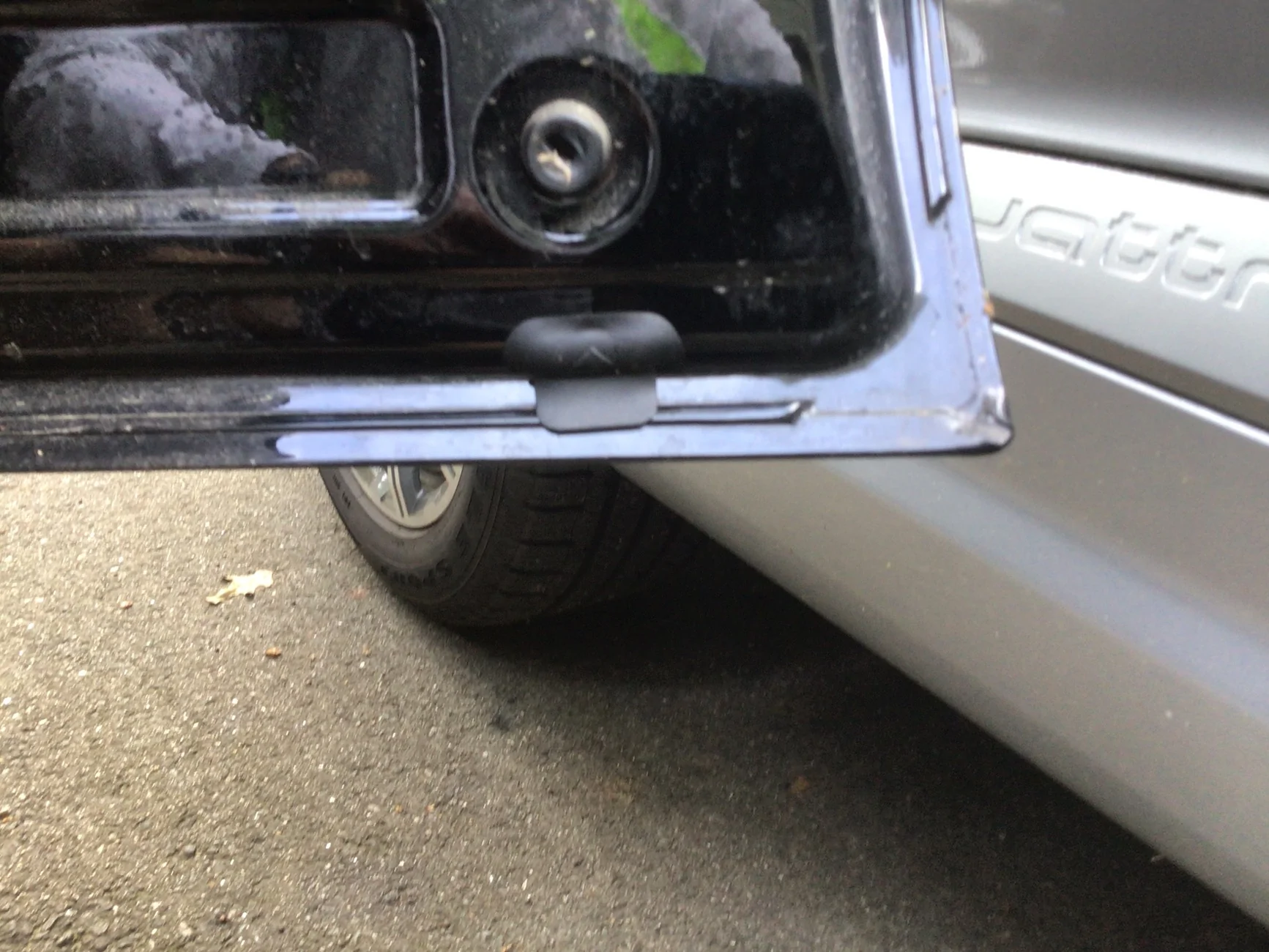

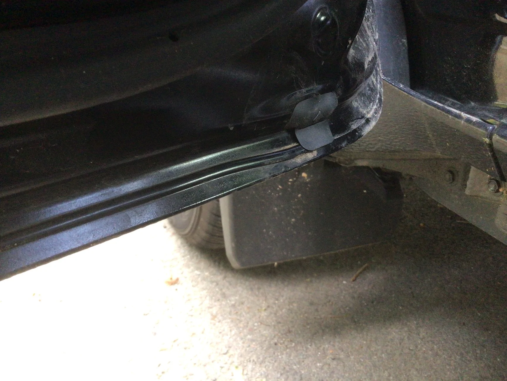

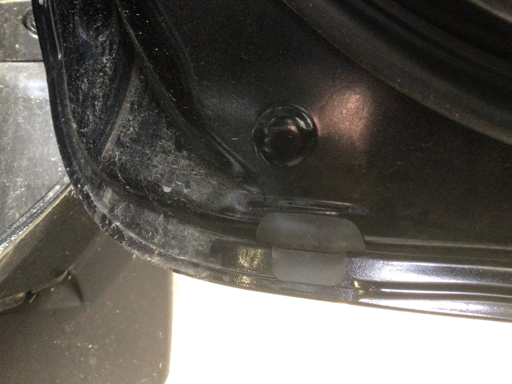

I feel like Captain Queeg chasing this leak down but I think there may be a couple of causes.
First is a bead of sealant was laid down along the bottom of the door. It appears its purpose is to keep the lower flap on the plug from closing completely. If the bead is not placed correctly (which I cannot understand in automation) the flap will seal against the door. One pic shows my driver side door at the most forward seal correctly sitting on the bead.
Other pic shows the passenger door (reservoir door) where the bead ended before reaching the most forward drain causing the plug to seal against the door.
Third pic is a normal configuration.
It is also possibly the other two plugs were improperly installed or were not to spec.
Toyota sells them in a package of six.
