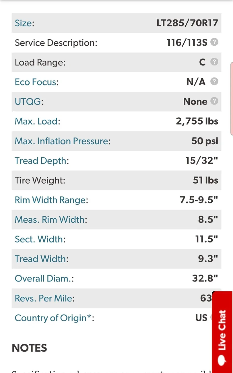

Nope,
Falken Wildpeak RT/o1 285/70/18
That's why I say, you have to look at the individual tire's demisions.
He asked for 17s not 18s. So tirerack could be completely wrong for all their specs but....
Not sure why the rim size would effect if the tire is going to fit or not, it's the overall dimension which you have to check for each individual tire. Not all 285's are the same size despite rim size or what's marked on the sidewall. You have to look at each individual tire specs.
Selected Size
Rim diameter isn't related to profile, its a percentage of the width. So a 70 aspect ratio (profile) on a 285 is a set size mounted to a 16 or a 20. Thats why a 285 70 r18 is ABOUT 1inch larger then a 285 70 r17. Same reason why a 265 75 r17 is the same diameter as a 285 70 r17. Narrow width needs a higher percentage aspect ratio to reach the same diameter of 32.8.
