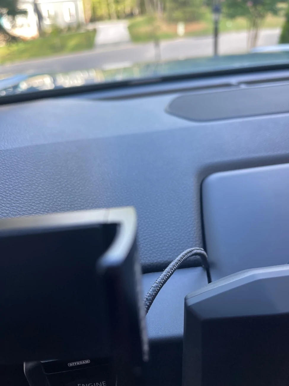

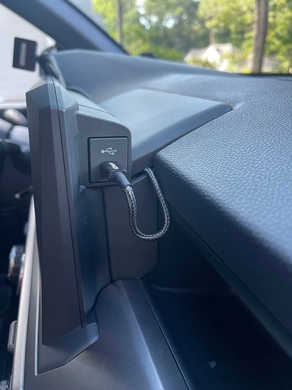

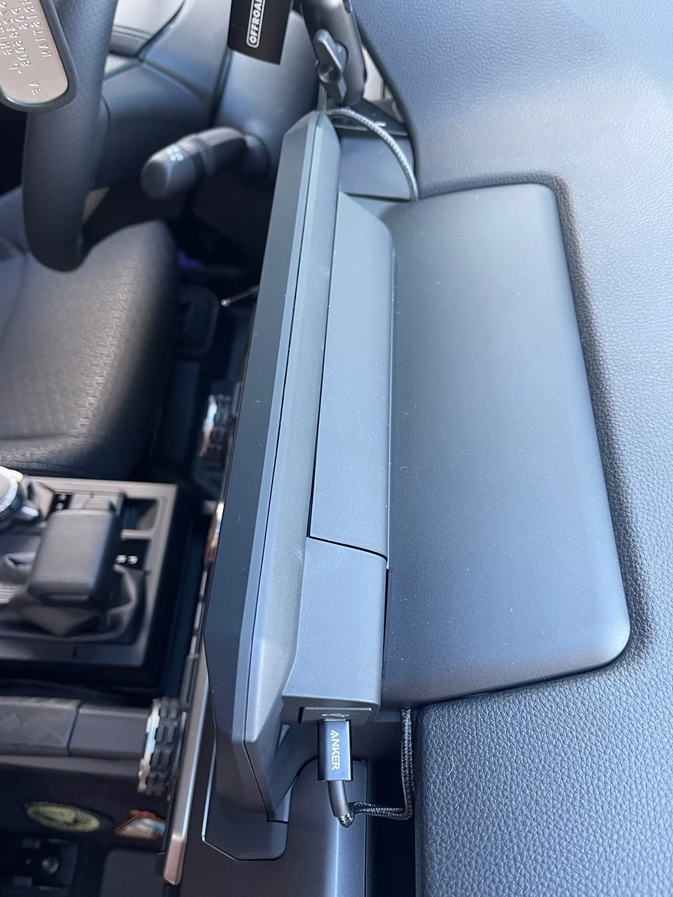

I use the usb c plug on the side of the radio. Apple CarPlay works flawlessly and it keeps my phone charged while driving. You can remove the panel from behind the radio and run a 3’ usb c cord from the right side of the radio under some brackets behind the panel and to the mount (Offroam Mount). Tuck the extra wire in the space behind the radio and replace the panel.
Would you mind sharing some pics of how your wires look with the mod you did? Also what is your door system buttons and how is that affixed to your runner?

The remote for my garage door is mounted with Velcro on the dashboard. The cord I used is 3’ long and I have the extra coiled up under the panel behind the radio. Be careful removing the panel as the clips aren’t very strong and can break. Pop it up with a panel removal tool and do it on all sides instead of just popping it up on one side and pulling it up from that point.
Thank you! Any concern on the pinch of the cable or is it not that clamped down?
