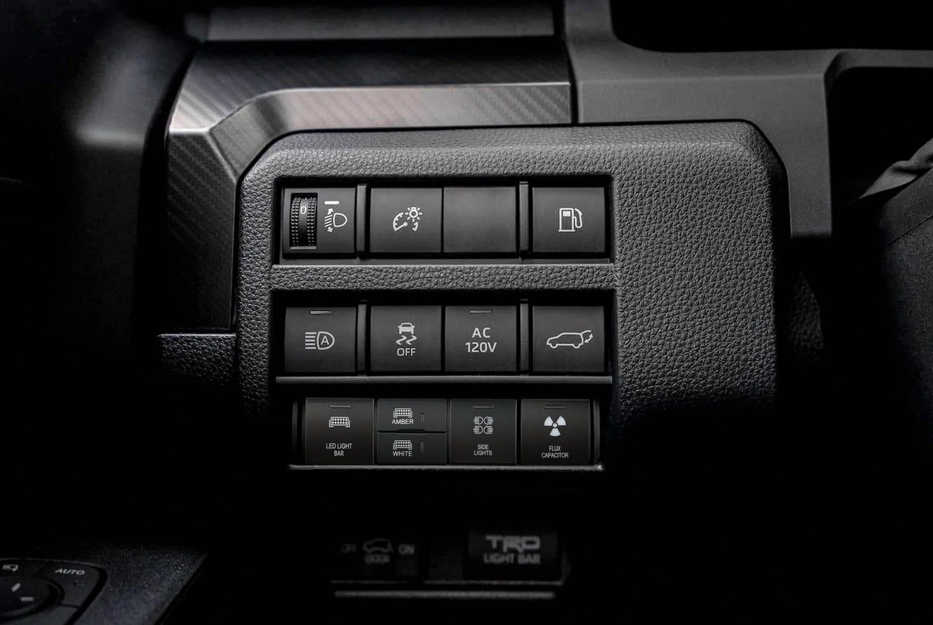

I don't have the factory pre-wired AUX Switches on my TRD Off-Road Premium Hybrid, but I do plan to install some OEM switches like the ones from CaliRaisedLED to control the following equipment:
2025 Toyota 4runner What are you using AUX switches for? _W0A3544-Edit
Switch 1: 40" RIGID SR-Series Midnight Optics light bar that will be mounted behind the half-height wind fairing on a Sherpa Capitol platform roof rack.
Switch 2: Clear and amber fog lights that will go into a C4 Fabrication Lo-Pro Bumper (like this one for the 4th Gen Tacoma) once they become available. They will likely be Baja Designs S2 Pros.
Switch 3: Scene lighting primarily for use in camp. These will be the Baja Designs LED Dome Light with Switch, which will be mounted in the side rails of my Sherpa Capitol platform rack like this. Because they each have individual switches, the lights can be independently turned on/off at the fixture, too.
Switch 4: The "Flux Capacitor" switch will turn on some clear high-vis LIN6 LED Strobes from Wicked Warnings surface mounted in the front grille. I'll have them tinted so the aren't noticeable unless they're on. I use these mainly for safety when I'm on job sites with my work.

Looks awesome man. I am wanting to use "Flux Capacitor" for one of these rock light sets... But my brain can't only have one of the switches taken up! :ROFLMAO: Going to look into those side dome lights you plan to install on Switch 3.
