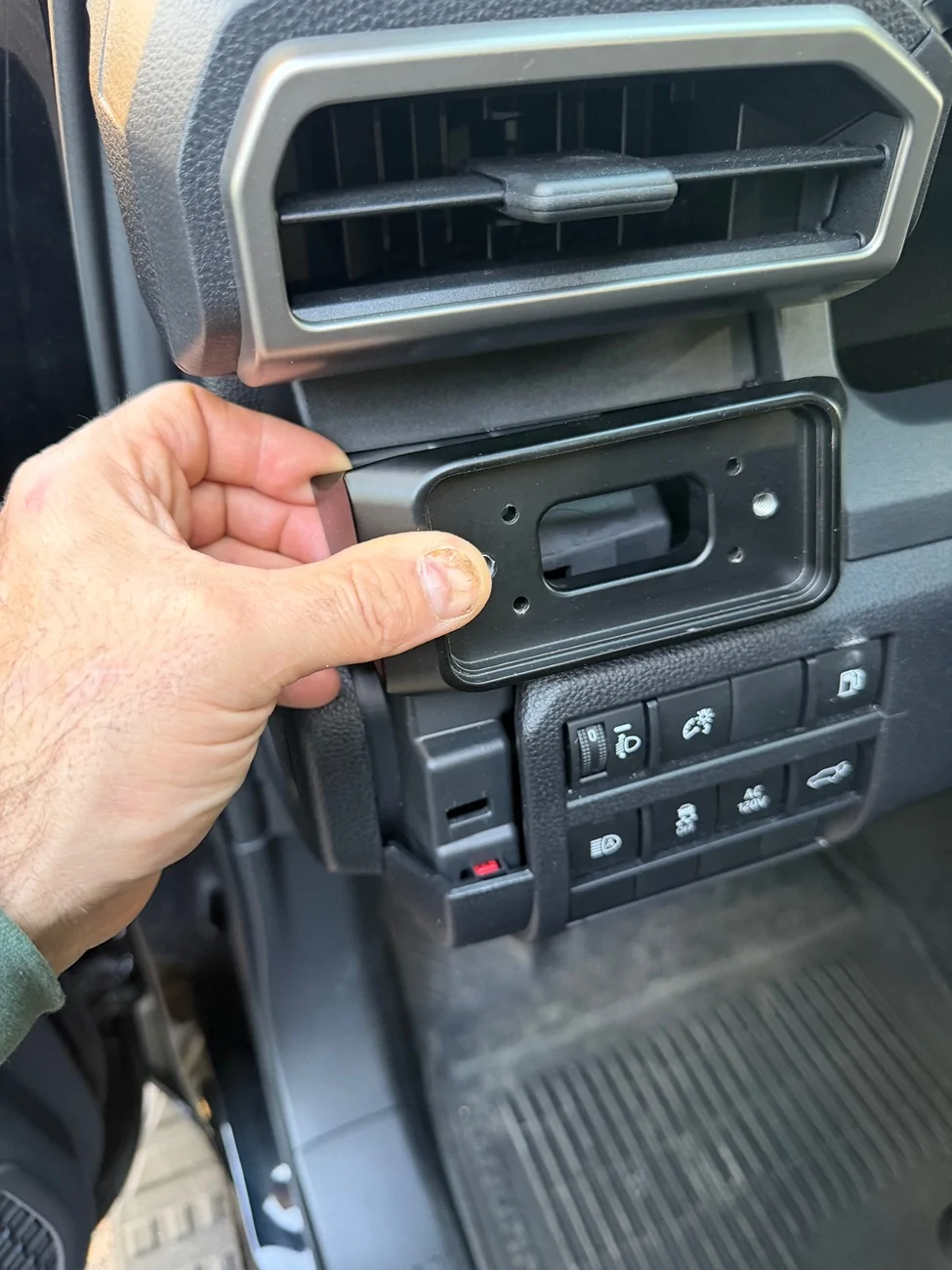

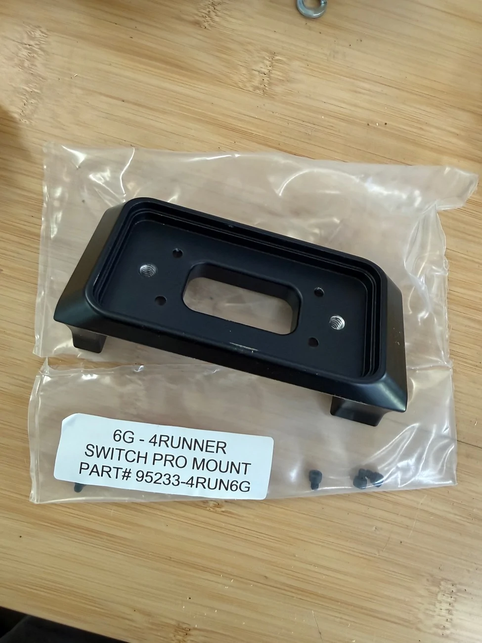

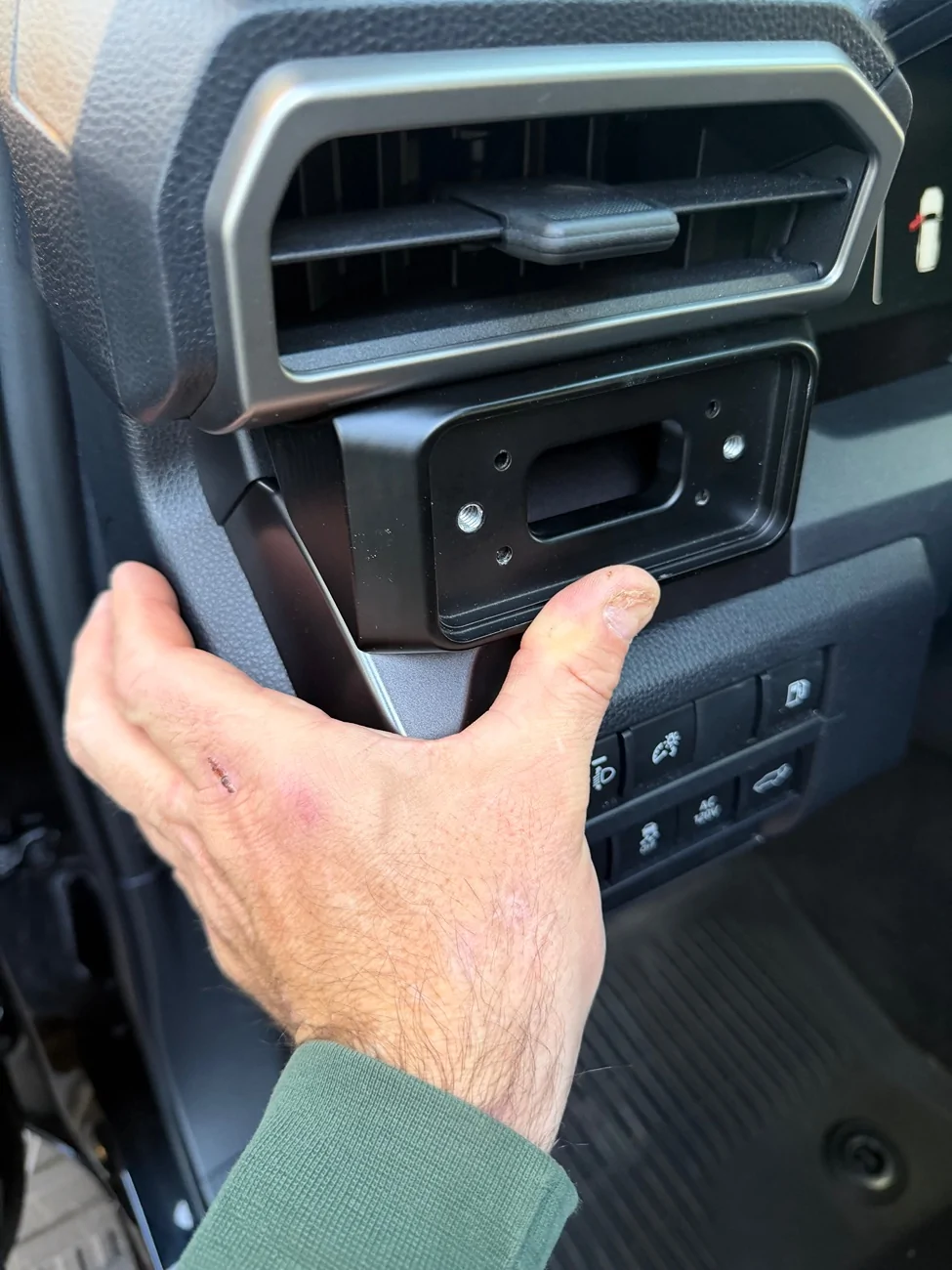

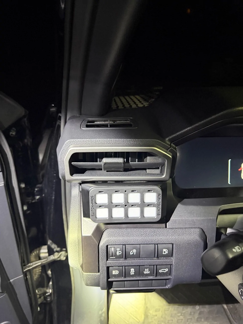

Ah found a FB video and saw it like this. Found some threaded inserts in back for the panel but what are the 2 visible ones for?

A template and hardware to the panel piece would be nice too. Need to get calipers and measure all this out.

See my post here:
https://www.4runner6g.com/forum/thr...-mounting-bracket-from-westcott-designs.7525/

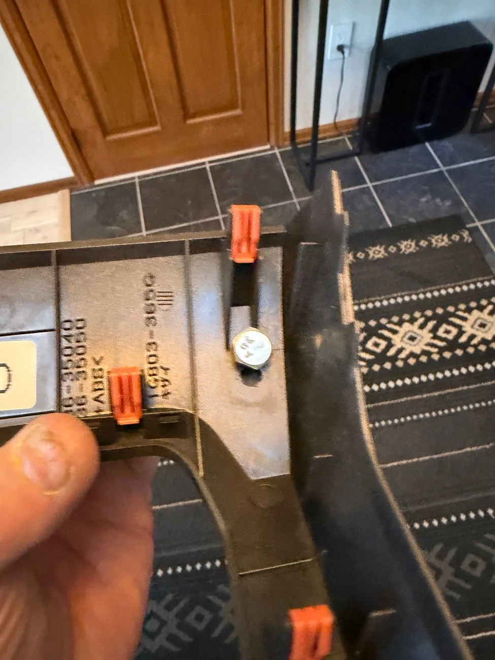

You have to remove the plastic cover panel and measure for the location of the holes for the mounting screws (I agree, a template would have been nice...) but it wasn't that hard to figure out.
The SwitchPros keypad will press-fit perfectly into the billeted aluminum keypad mounting bracket, so no hardware is even required if you don't want to use it. Between the SwitchPros 9100 parts and the Westcott Designs keypad bracket, I had all the necessary hardware for my install.
I just needed to measure and drill the mounting screw holes, and then drill the 1/2" ⌀ hole to route the communication cable down to the footwell and forward through the firewall gasket.
If you de-pin the Molex connector on the Communication Cable (as described in the SwitchPros install guide) you can pull the cable through the nipple on the firewall gasket. Fits perfectly and provides a good seal.
Hope that helps!

Yeah, I had reviewed your post several times. There’s no hardware to attach the mount to the trim. I’ve got everything prepped but need to go to Home Depot to find screws to screw the mount. My only point is a sheet, template and (2) more screws (other than the SP panel hardware) would have been detailed oriented from Westcott. :)
