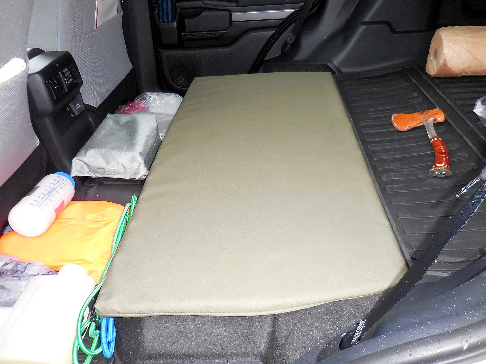

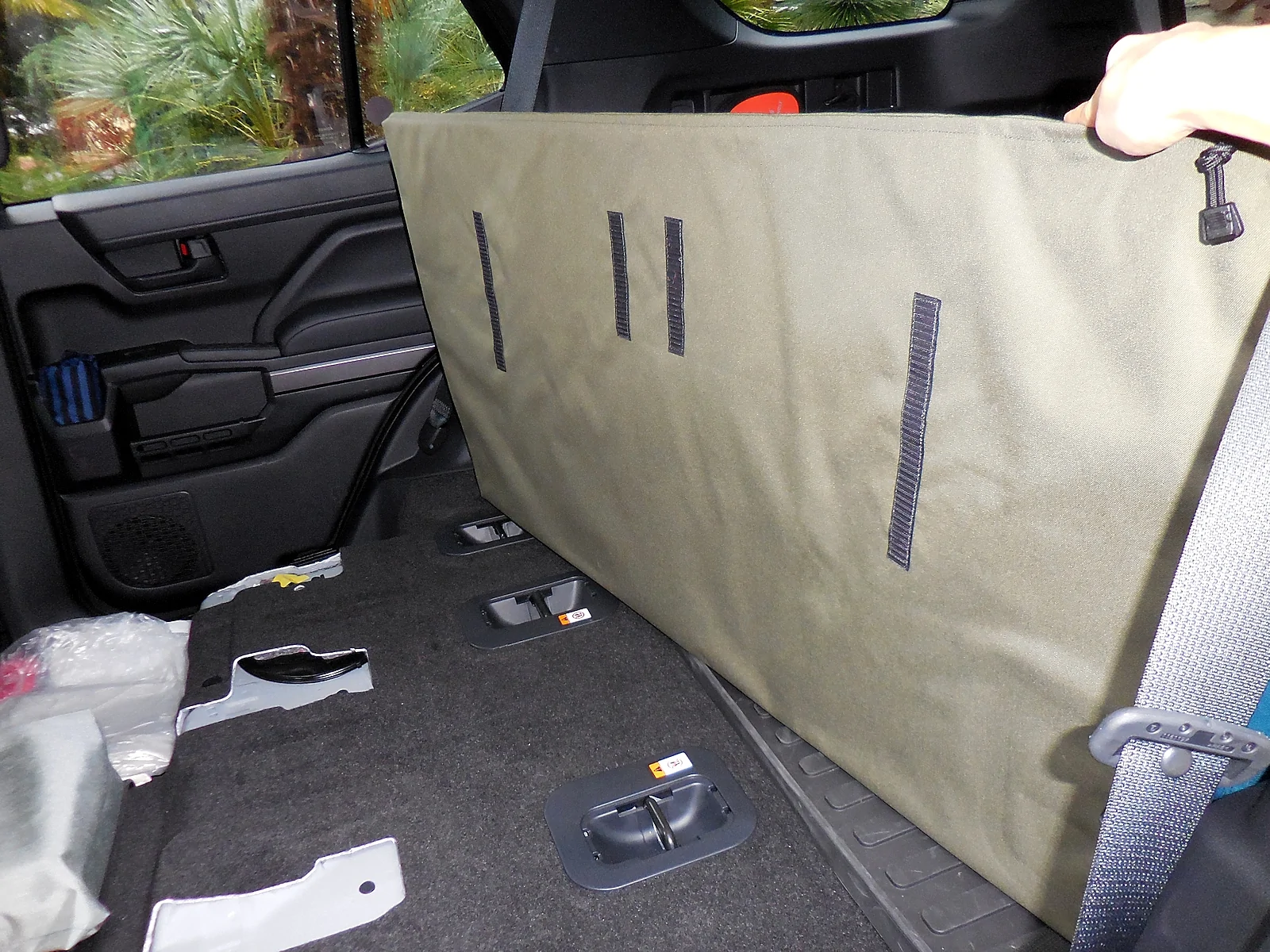

Yep. I also disabled the rear seat warnings using Carista first. And plugged up the bolt holes with silicone 10mm plugs.

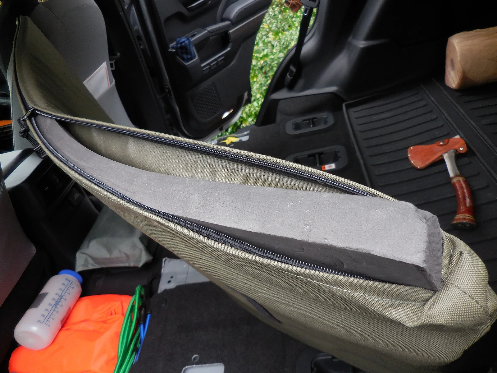

To cover the space, I bought a piece of Minicell T200 closed cell foam at foambymail.com, cut it to shape using electric turkey knife and my wife made a zippered cover for it from 500 denier coated cordura nylon bought at therainshed.com. The bottom has strategically placed Velcro hook strips to attach to the carpet below. It works great and the pad does not budge. It has a bit of an overhang to hide the carpet cutouts.
The foam is firm enough to span the holes and indentations, but has just a bit of a give so that items don't slide wildly on it. The textured cordura helps too.
We chose 1" thick foam to match the lip on the PIO rubber cargo mat, but I imagine thinner foam would work as well.
Version 2.0:
Items were still sliding on the original design pad, so we replaced the top panel of the cover with non-slip fabric. Now cargo does not slide on it no matter what. A worthwhile improvement. The look is essentially the same.
