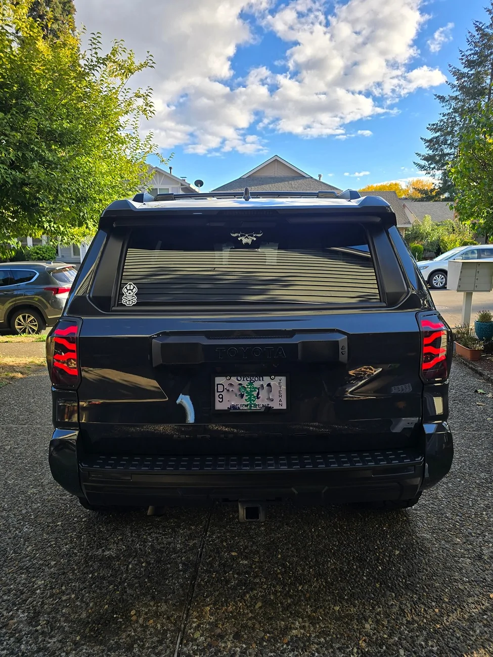

Today, my 4R got a bath and so I finally got the chance to use my new detailing section I created in my garage. I also installed my pair of new Alpharex Luxx led tail lights which I ordered from YotaWolf Off-road. I also ATTEMPTED to install the Aspire Auto Accessories wide view mirrors. Below I give some detail regarding today's wash and install(s).

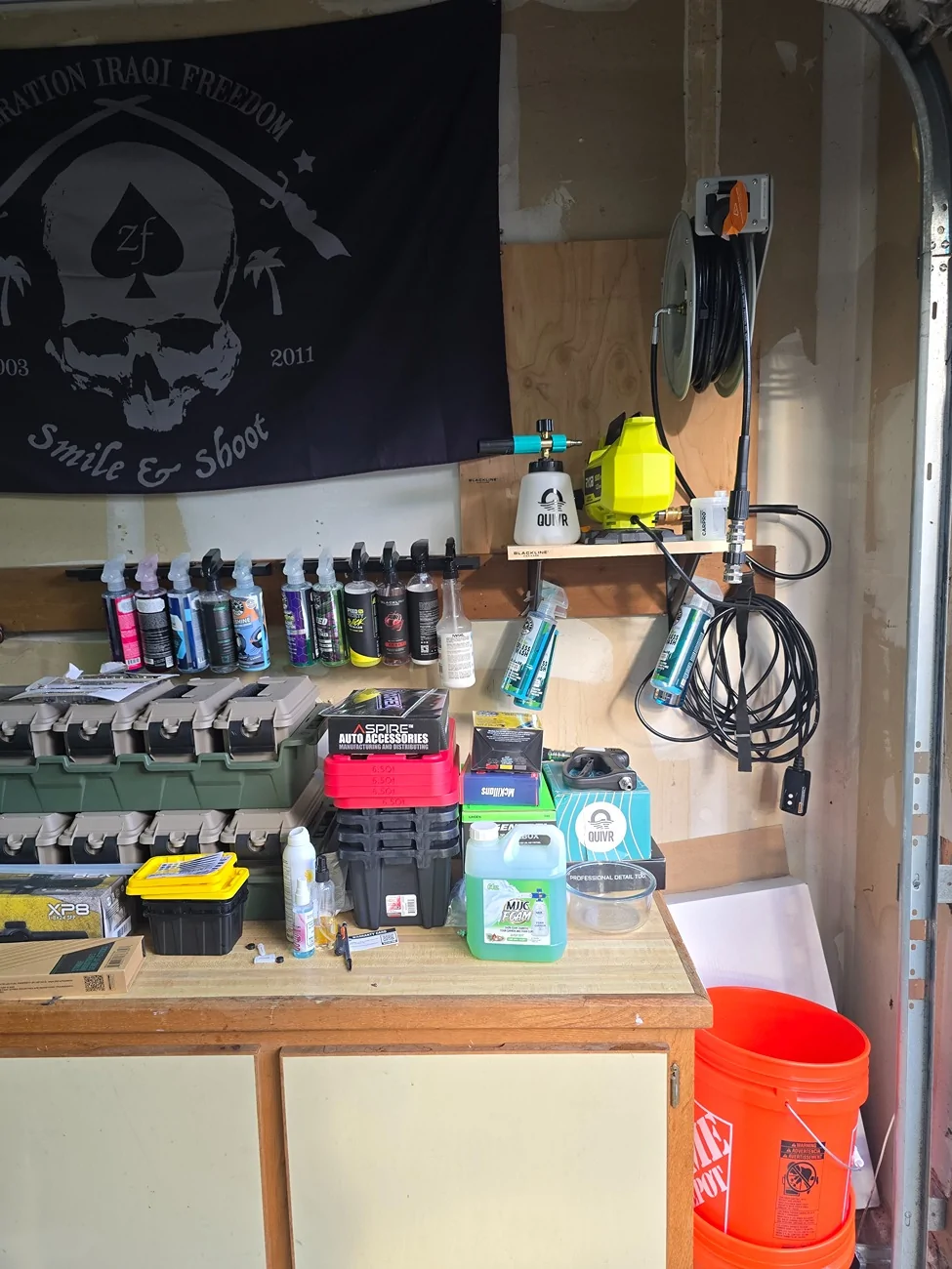

The car wash set-up:
RYOBI TOOLS USA pressure washer, McKillans quick connect kit, Giraffe Tools retractable hose reel, QUIVR Foam cannon, DiDiWash swivel pressure washer gun and MJJC Ultimate Snow Foam (THICK FOAM!).
I use Chemical Guys products for the tires, trim, windows, and I use Blackline Car Care Reset interior cleaner (Oasis scent) and their drying towel.

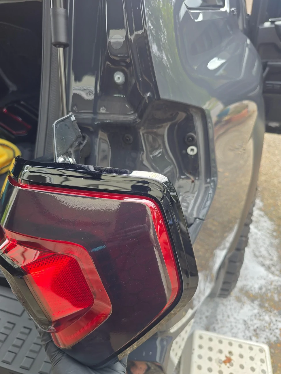

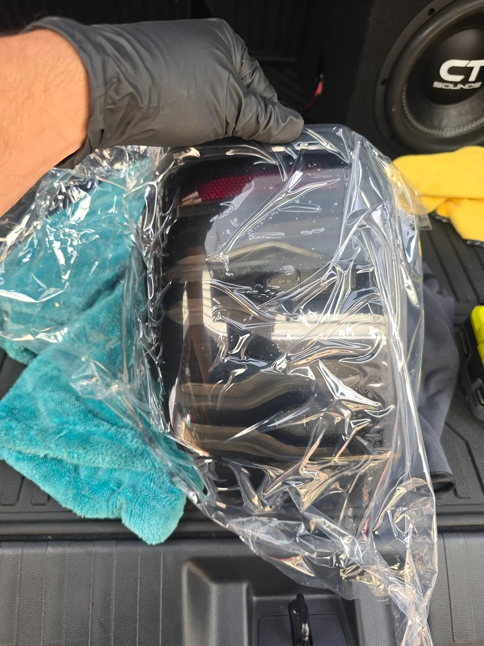

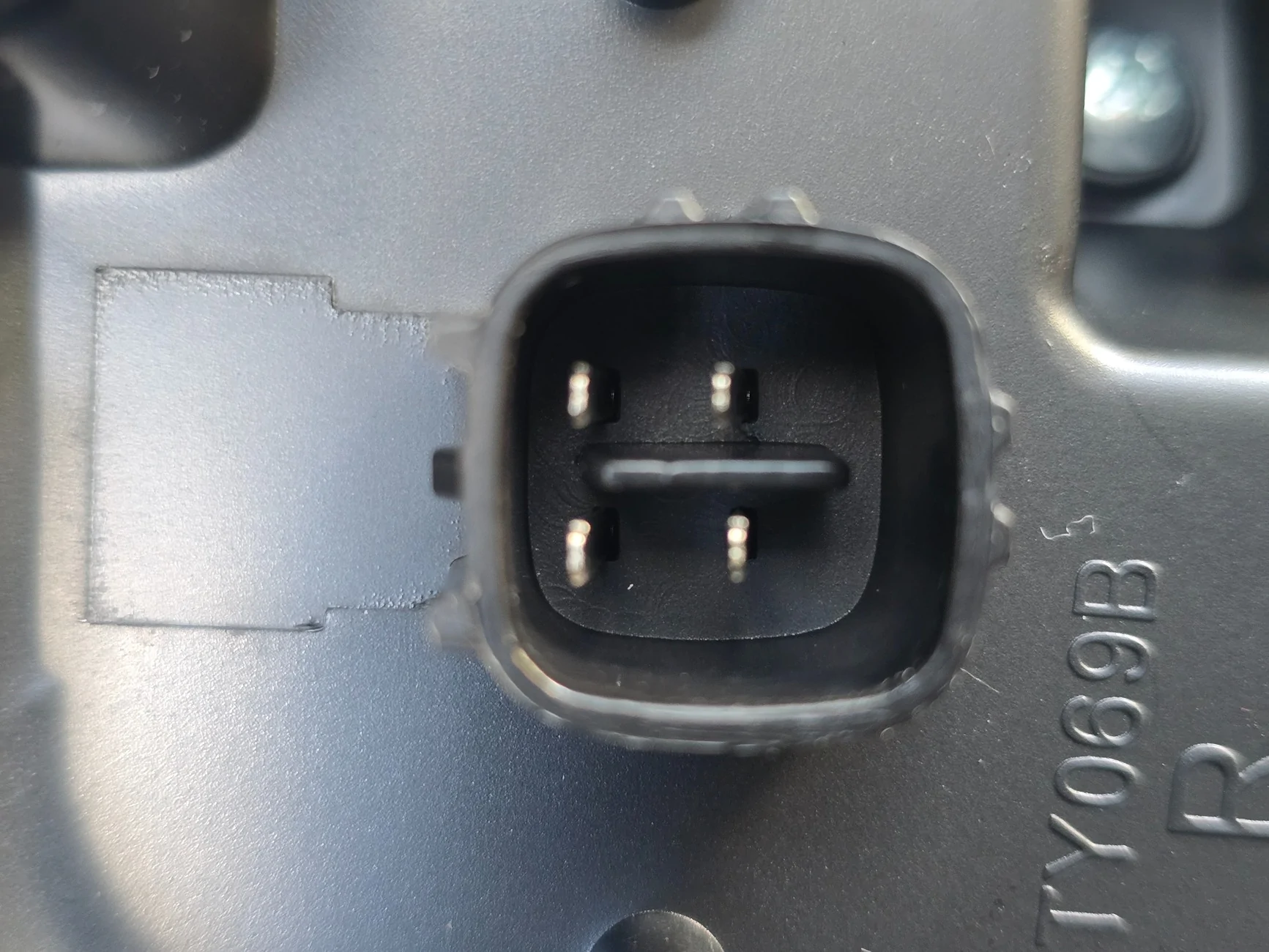

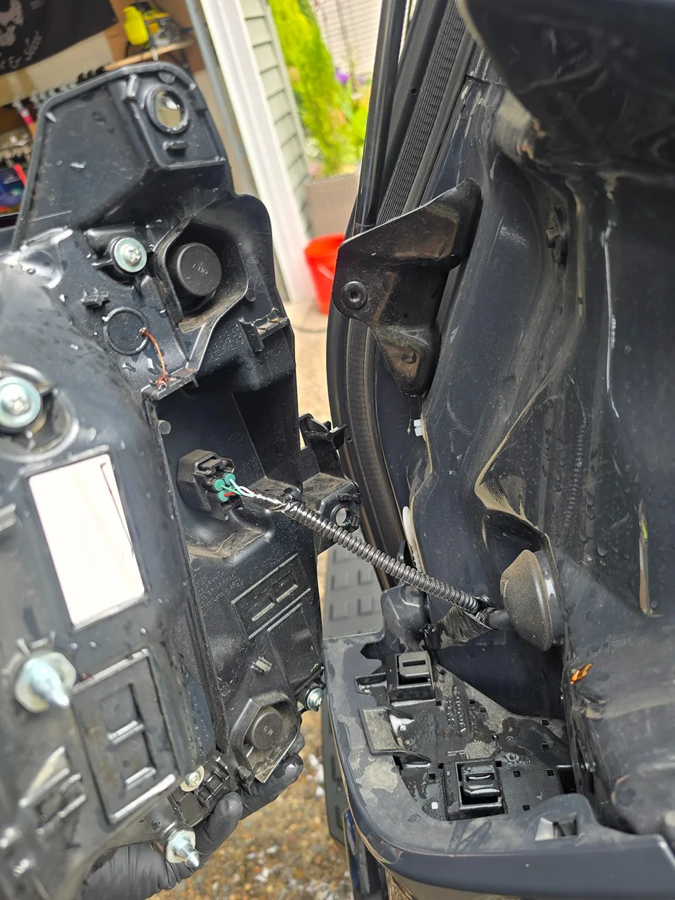

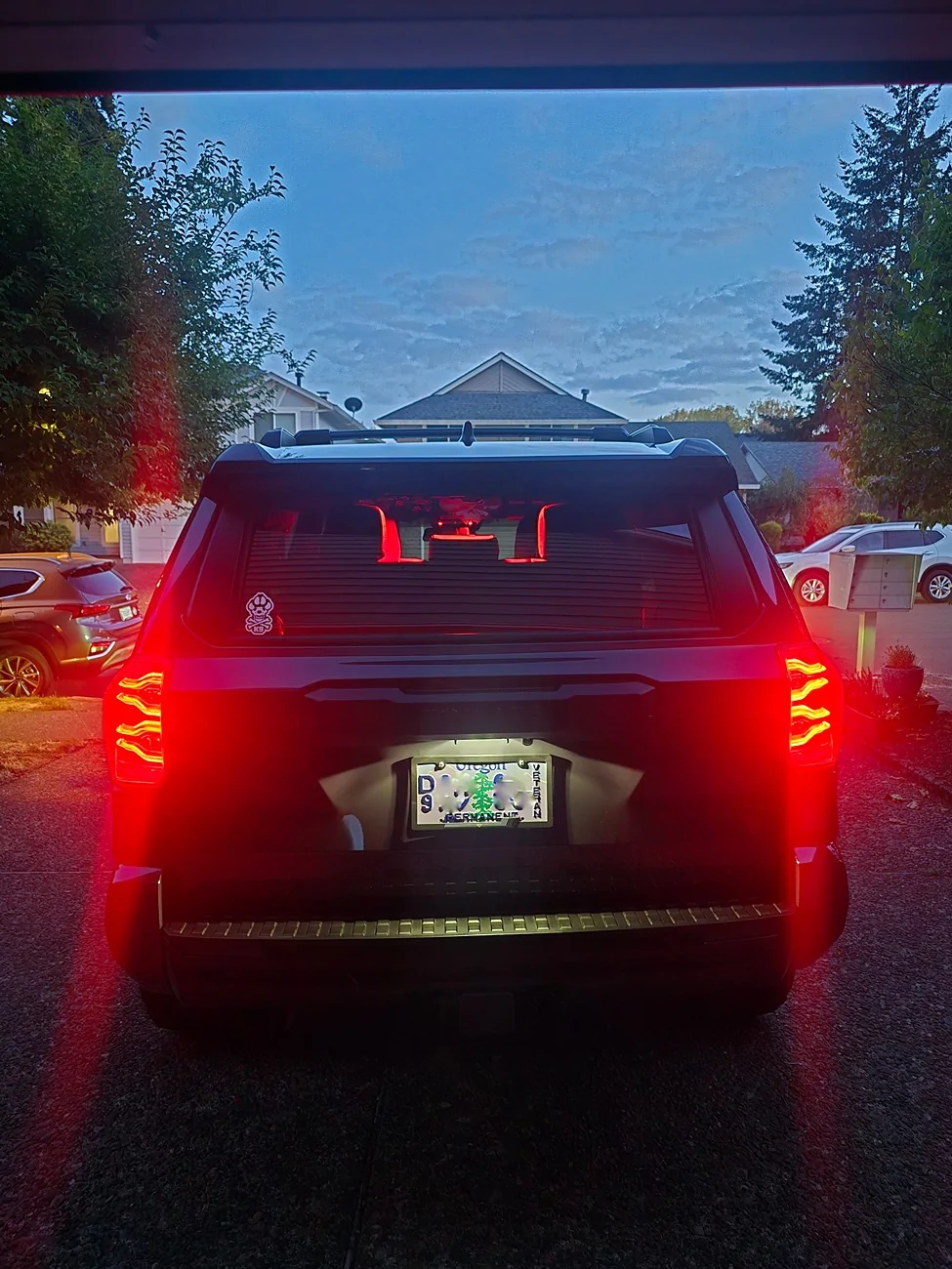

Alpharex Luxx led tail lights. Install instructions can be found on their site. Removing the OEM lights are easy but I did use pliers to disconnect the single connectors. When installing the new lights, make sure the prongs are flush with the connector ports; after my initial install, they would not turn on, so I called customer service and they helped me figure it out. You will know all the prongs are inserted correctly because there should be an audible *click* when you plug them in.

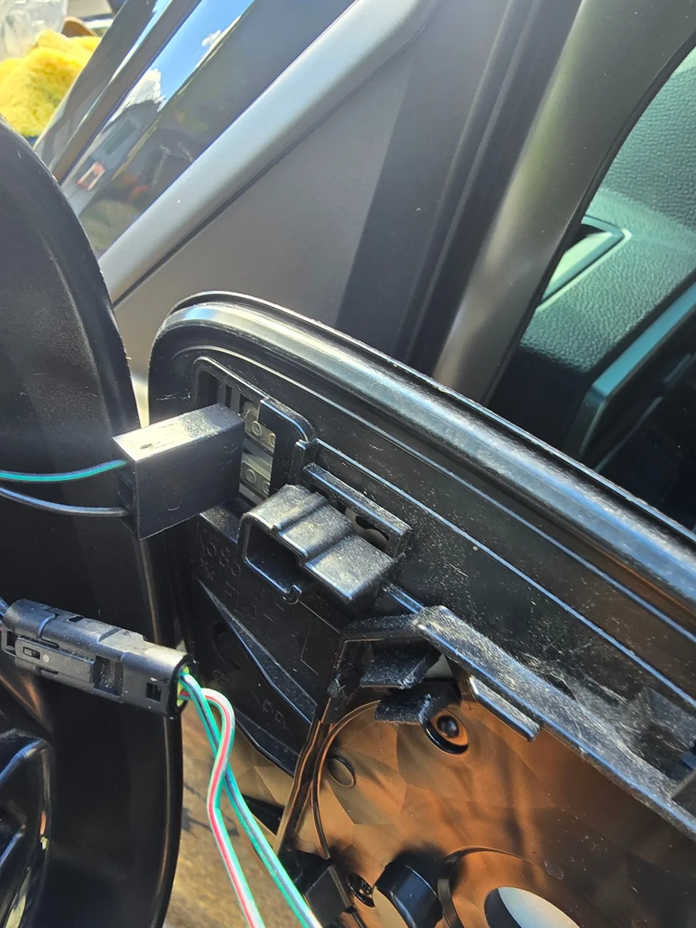

Aspire Auto wide angle side mirrors. This was a tough attempt. There is an install video from Aspire but unfortunately there are differences in the mirror components. The removal of the plastic cover is a bit tough and you need to be careful not to muscle it too much or chances are, clips will break. Removing the actual mirrors is not too tough but when it came time to disconnecting the wires, that's where I could not continue. There are no instructions I could find to help me remove the existing wires, nor could i find anything to assist me with connecting the blind spot wires. I did call their number but no answer (left a message). This one will have to wait.

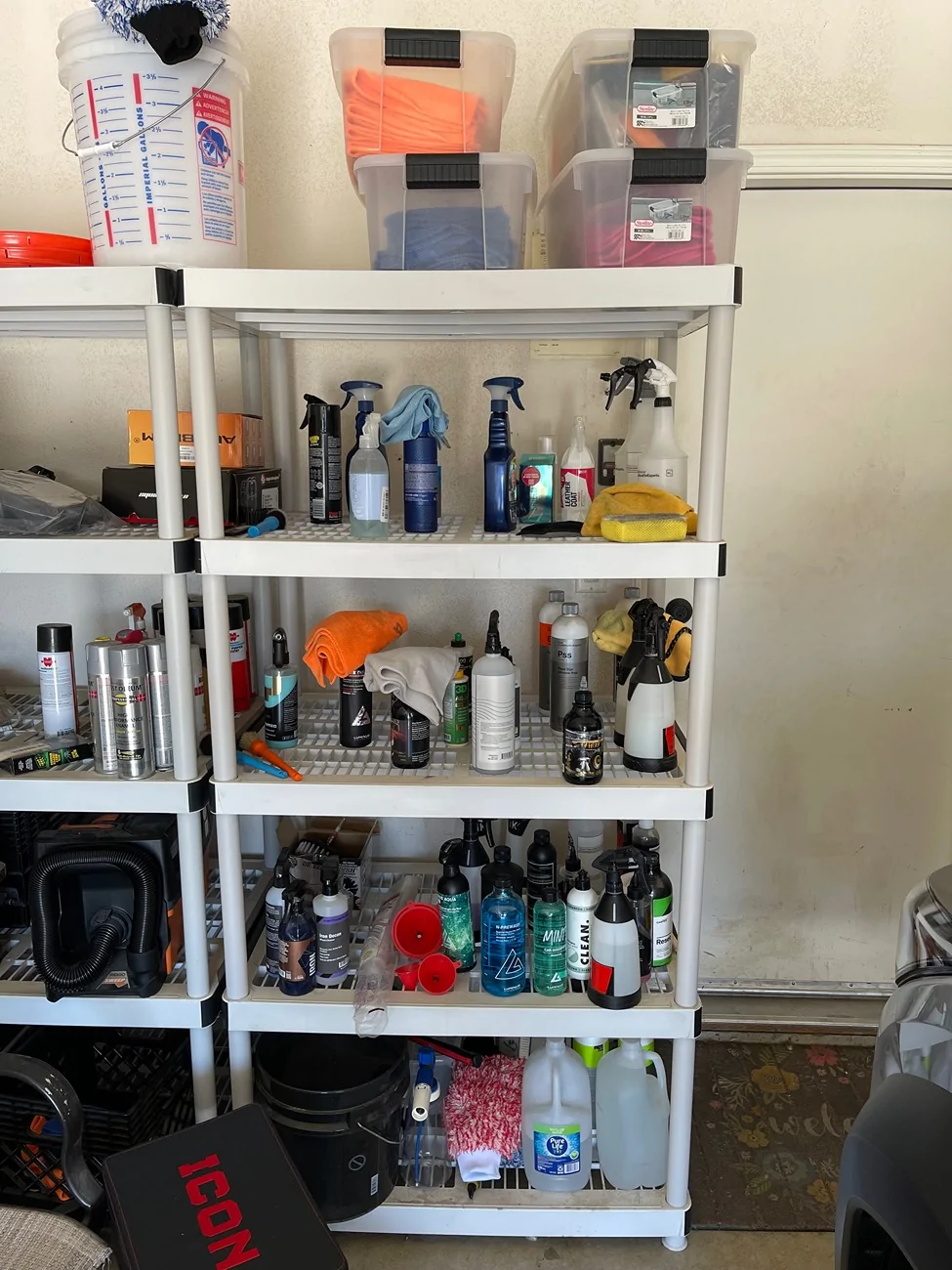

Im always messing around with car cleaning stuff. Lol. Uou did a nice job! This all my cleaning products (need to reorganize)
